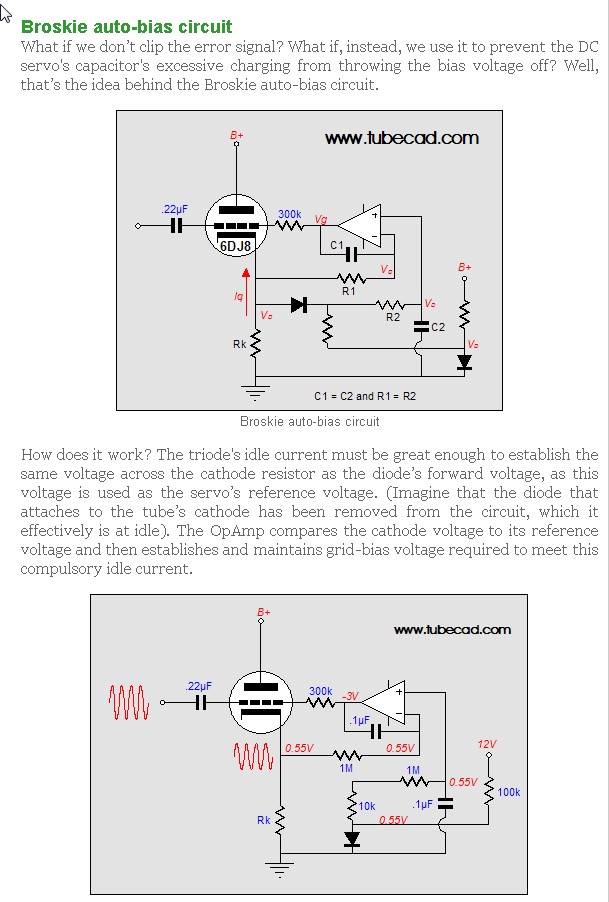

As for the auto bias, in the article here she do use diodes when she go conduct the autobias is effective disconnected.
Here some more explaining how it is done with tube stages, a circlotron is extra difficult because of floating character anf swing signal is present everywhere.
https://www.tubecad.com/2005/May/blog0045.htm

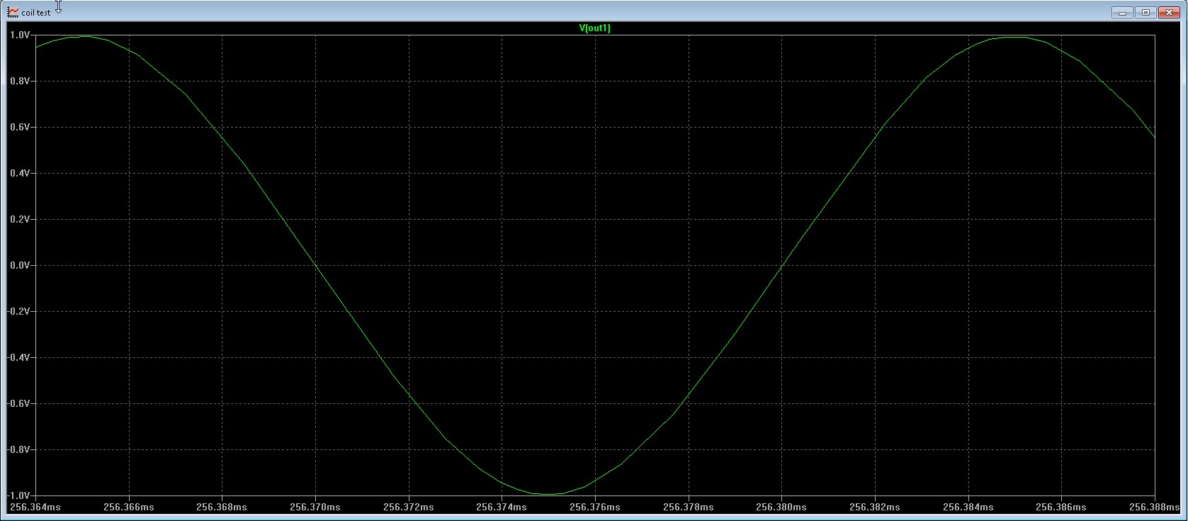

Did sim your coil idea, if I did it right I do not now.
I have mother in hospital who has a stumach bleeding after some weeks there, so busy with mine 85 years old mother, I do things between my spare time.

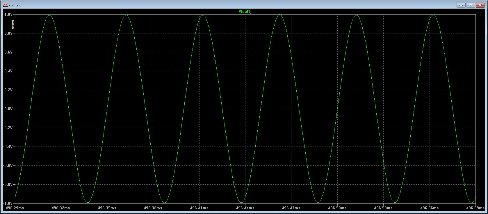

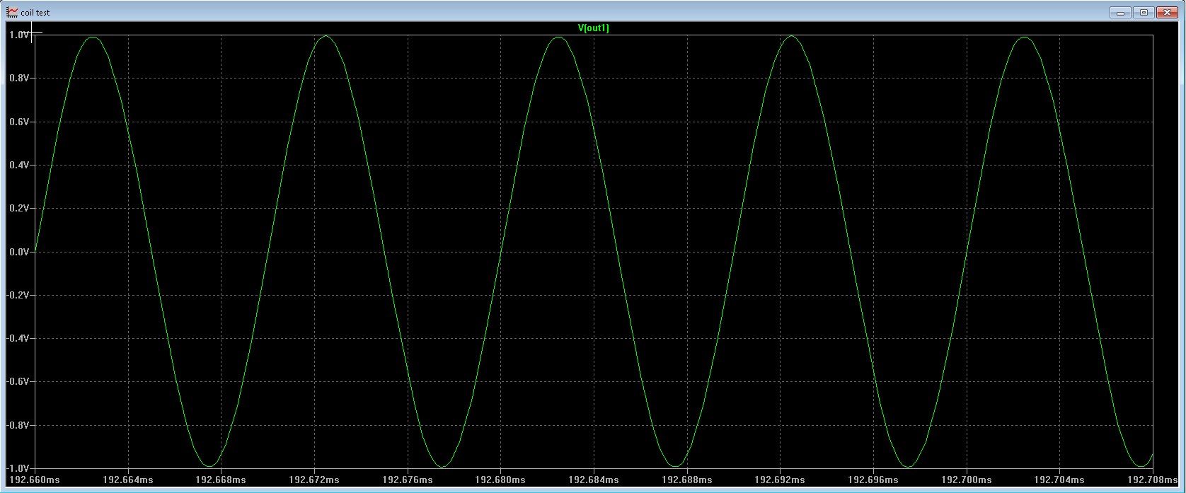

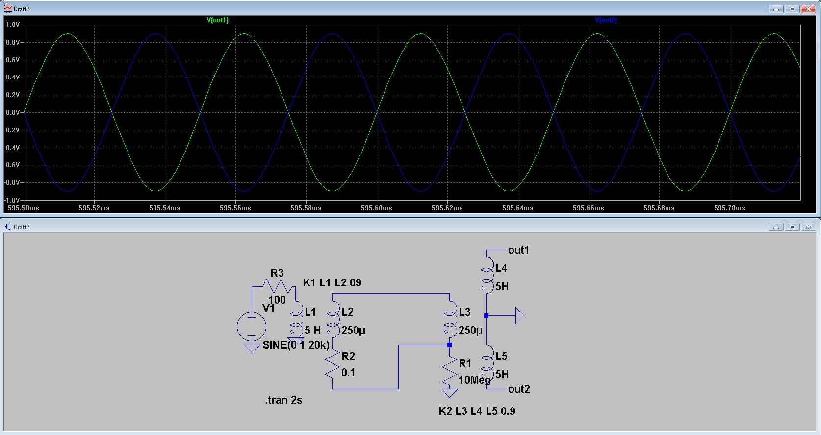

I have made a schematic witih three stacked coils and magnetically connected with a single winding idea.

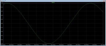

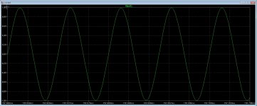

However I do loose signal on the 30 Hz region and below..
picture two is on 50 Khz, and I see it do from 1K to there very nice, but under 800 Hz it drops signal, on 20 Hz just to 200 mV

What 0.1 Ohm? Where did you get it?
And 2.5 Henry is loo small inductance for 100 Ohm. The coils that I use have inductance 50-90 Henry.
The 0.1 ohm is because LTspice complaine about short coils,' and needed a serie resistor, I did just drawn a idea to let you see if I right, the small indcutance is a shorted winding like you did to get signal over to the other coils, so high to low and low to high again.
I did not now how high the inductance was of the current transformer, so I did guess that.
regards
You mean 100 Hz and not 100 Ohm?
I did some more tests, but take in account that I did use perfect coupled coils, in reality things like capacitance and such things will degrade the transformer.
When I do use a couled winding who is 1 H then the coil do work from 10 Hz to 100 Khz in sim afcouse.

I did make the resistor 0.1 ohm 0.0001 ohm, it was needed, and that give a lot better result on 20 Hz, I can now lower the single winding to 100 uH and with 3 henry coils I are close to wished result so 50 henry is quite overdone already making maybe impedance to high.
Changing couple factor in LTspice do however give losses very fast.

The question is, what inductance of 1,000 turns on such a core?
If the claim that she do go from 20 Hz do mean she have high inductance, but I thought I have seen also somewhere , the easy thing is also it can put on pcb easely.
So I wait for Indra what he get,s🙂 and in the meanime wait until mine are here from shipment, the ones wavebourn did advice.

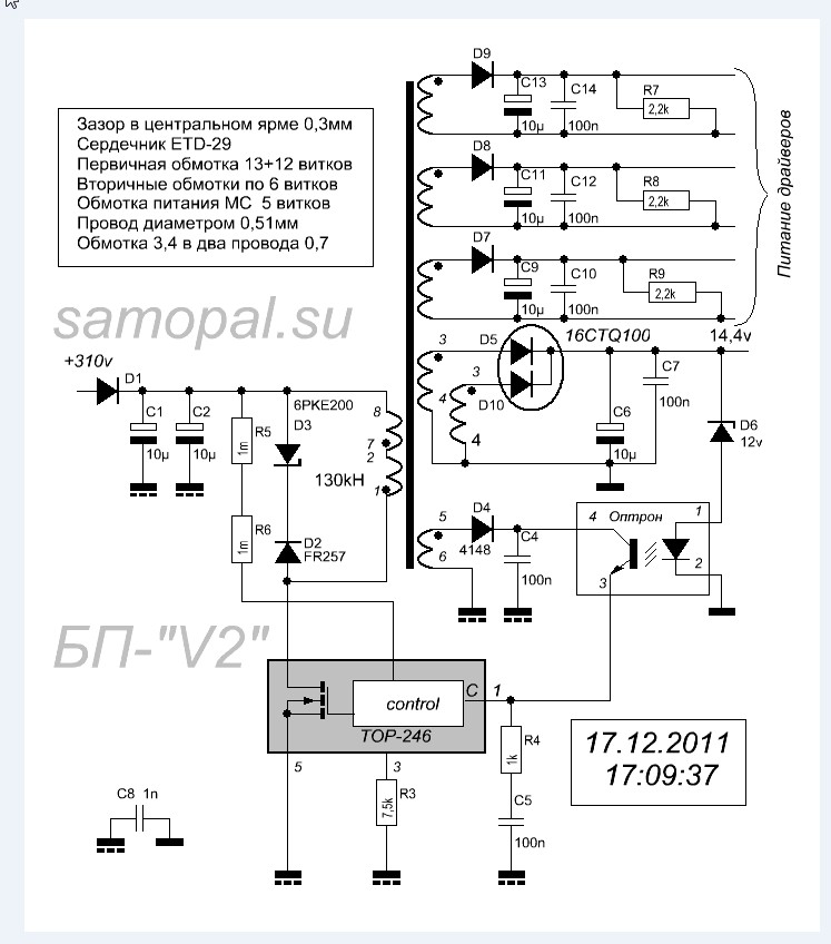

Ohh Wavebourn you can read russian, can you translate for me the little piece of tekst on the picture about the windinds, I am busy with build a inverter for the mig welder,
is better then transformers the normal way, and she are broken also.
