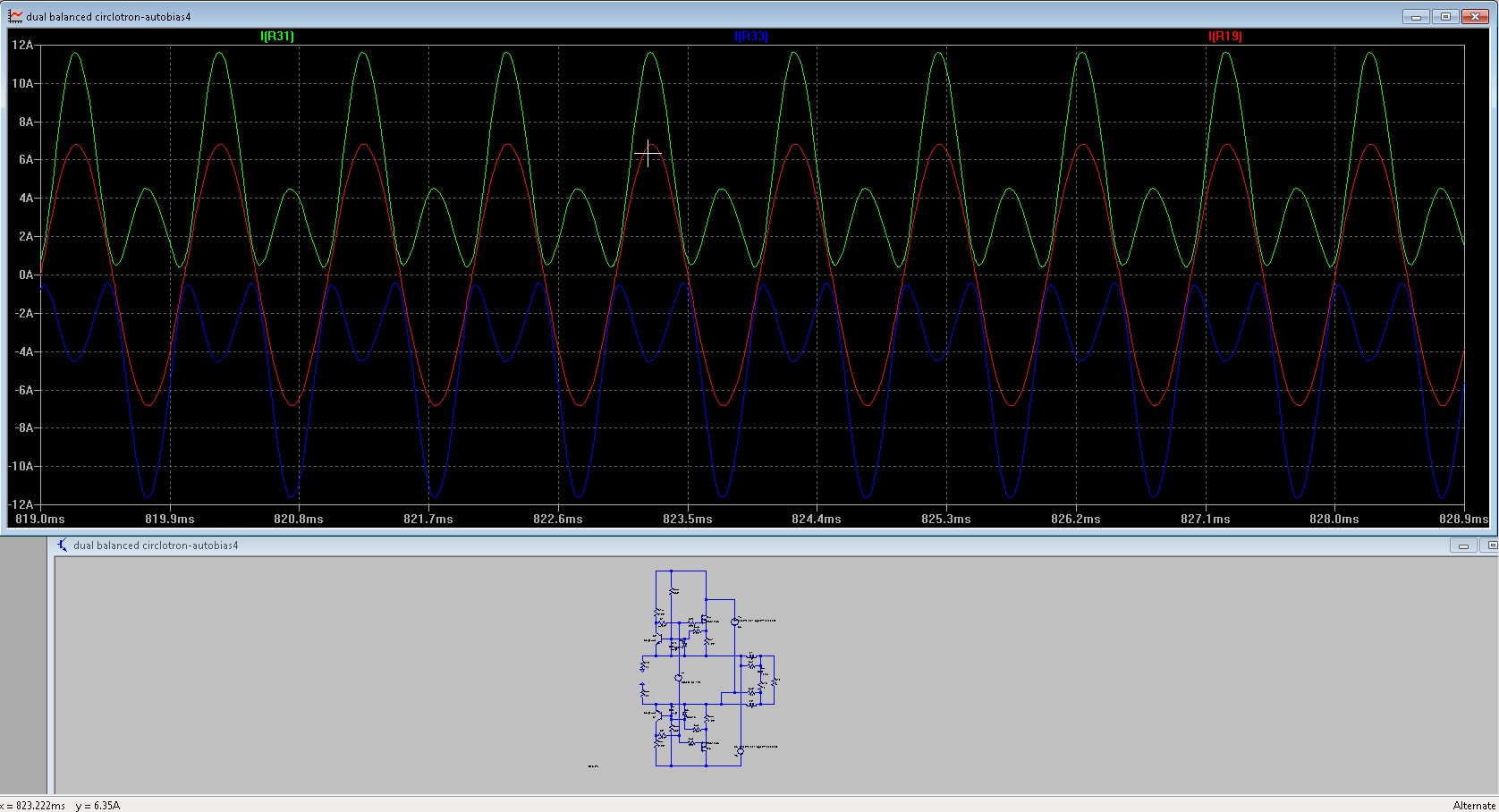

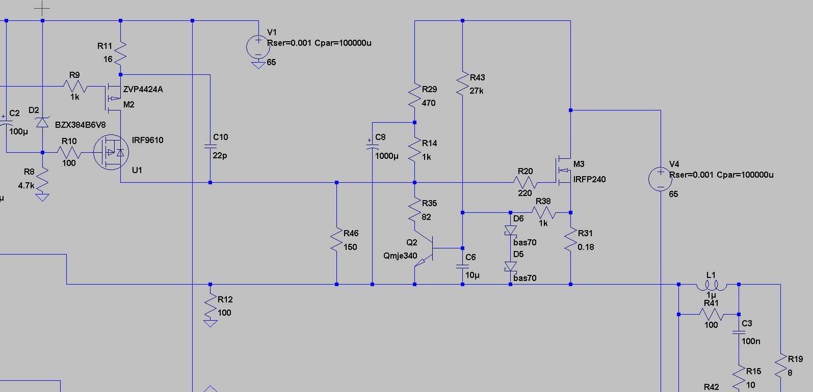

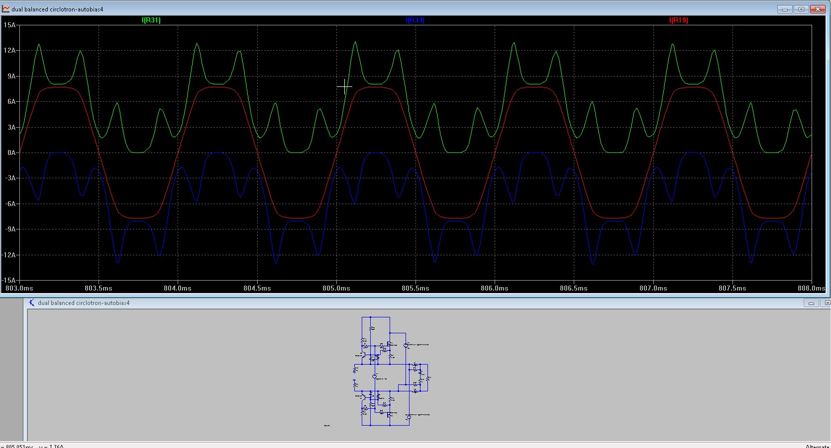

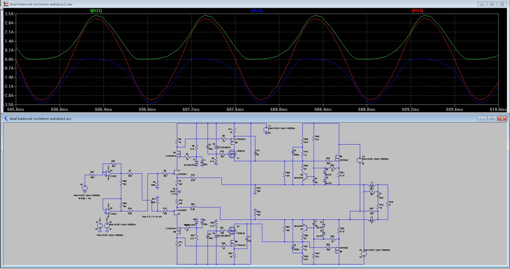

THis is not the hybrid, but the allfet, but place it here for info, little offtopic but I have here done a autobias with just one bjt, it keeps a minimal idle current very well, the diodes are used for this so it clipps when overdrive the amp, however have pretty high oneven harmonics, while even are -80dB or so.
Green and Blue are 0.18 ohm source resistors and Red is output signal.
regards
regards

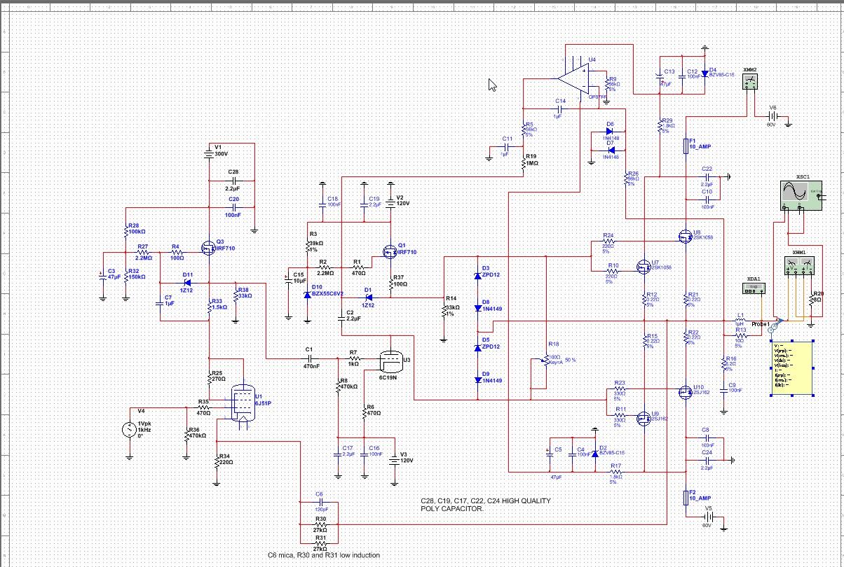

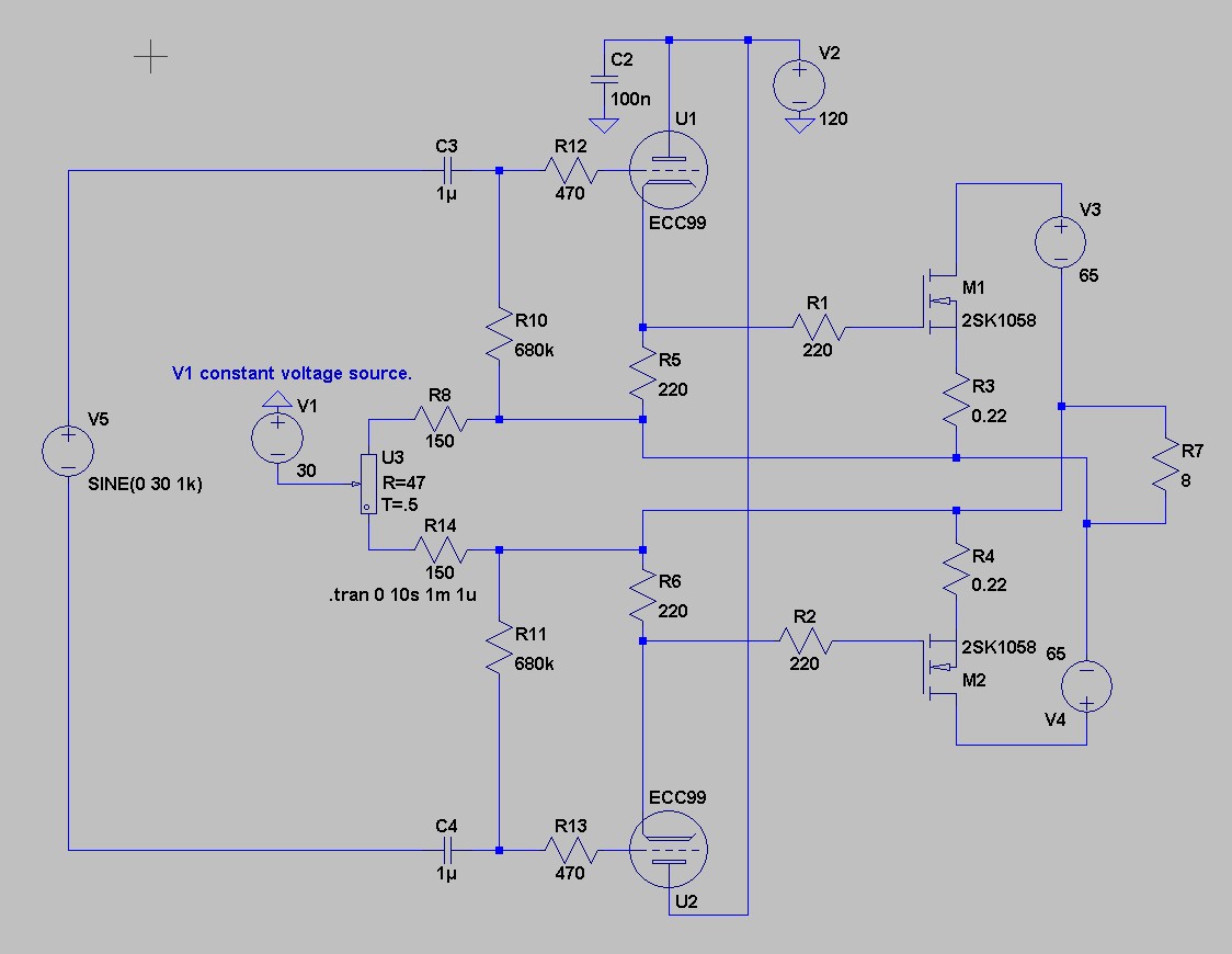

For the hybrid attempts, I did see that I had per accident made a TEM 3200 amplifier like mosfet drivers. I did read there but I ask myself a 800 watts 300 amps motor module who is used in that TEM amp who is driven by a small tube who can never output enough current, that is why I did use a extra mosfet to drive the irfp250 types of mosfets, for 2sk1058 it do well drive it for max 2 each side because have low gate capacitances, so that man did something clever in that REM amp.

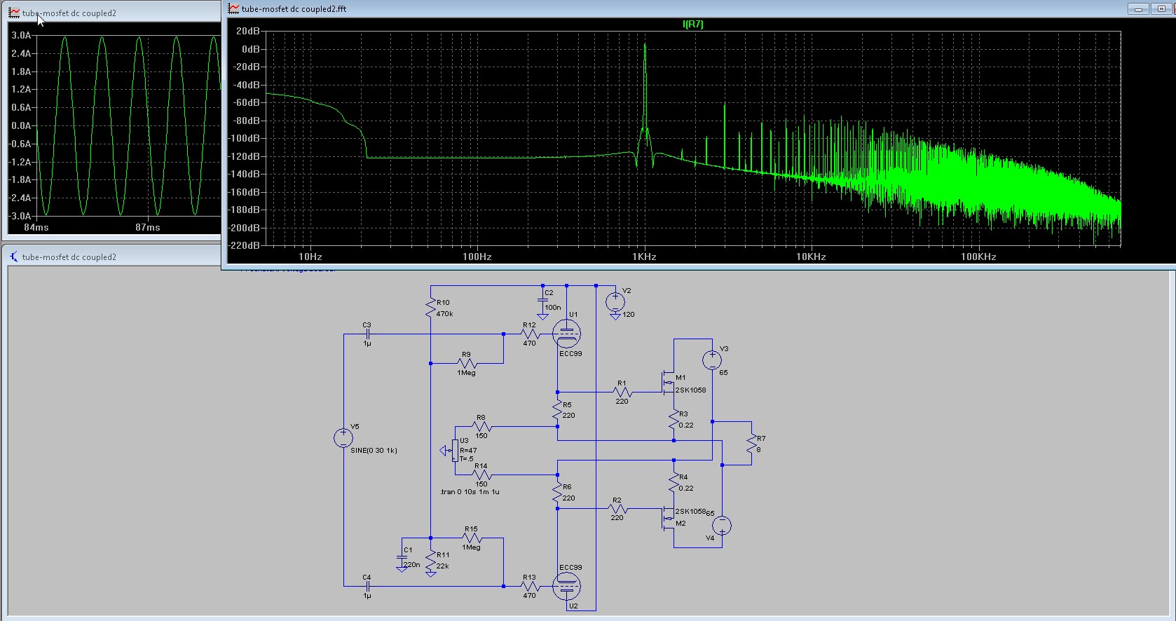

Oke, I go a other route, except the driver section I do keep that way, it do output -80 dB harmonics with 750mA idle, witghout feedback, no wrong it has local feedback because it are followers, but still nice.
V1 is a constant voltage source, here I do adjust idle current, more negative voltage is more current however the output give both also higher voltage for 1.5 amp it is 56 volts on each side, who afcouse in bridge do cancel out to zero volts, I think the REM amp do the same, so carefull with touching case and speaker leads.
regards
regards

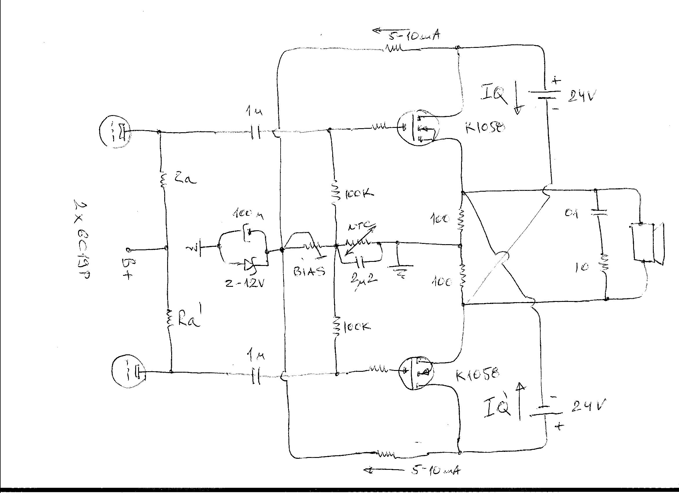

I like 6C19P tubes as drivers in anode follower mode driving one or more pairs of K1058 connected in Circlotron power bridge biased in A class , I think that for one pair of K1058 optimum B+/B+ is around 24VDC , for two pairs is around 35VDC and so on , any way I will try and go with AC coupled variant ,where 12V zener diode provide relative stable bias source , and yes , related to servo unit , advantage of Circlotron power bridge is that consist from same Lat-Fet devices ,K1058 ,which is not problem for precise matching , both device IQ will drift in the same manner in function of temperature ,output DC offset will be minimum , so single servo unit have to work in common mode for both OPS active device controlling only IQ`s ,
in my schematic that servo can be placed instead of NTC , but I think that NTC placed on main heat sink is just sufficient for relative stable OPS-IQ`s .

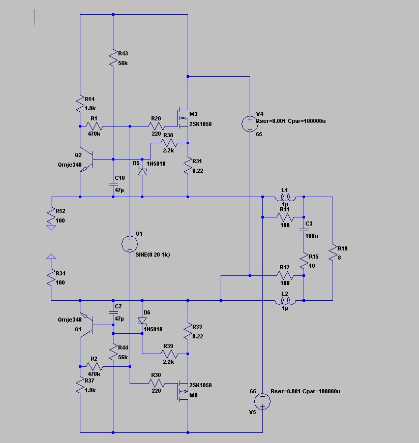

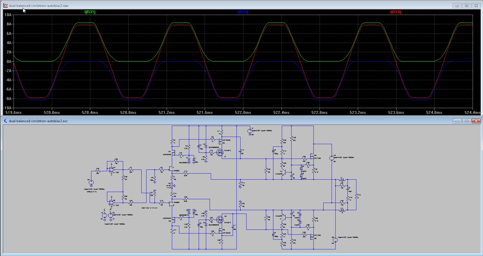

I have done some tests with auto bias runaway tracking, now I did chane some so it stays high impedance for tubes and still do auto bias with a single transistor what I did see on tubecad, I get 600 mA, and this get higher when drive harder with clip it is some more then 1 amp, maybe this is better then dropping, when I clip the amp it looks like idle current drops also. the small diode on the base do clip the signal so the bias stays on level.
For me, ? a autobias system is terrible difficult, to sense the dc component in the soruce resistor is very difficult, special for the circlotron, but maybe a clocked sample and hold and a pic do wonders.

You need S/H instead of limiting bias, to avoid dynamic distortions caused by bias modulation by envelope.

Yes I did mention this, because the dc compnent is what is needed, nice challence to make it, I have indeed more distortion when do the system with the bjt, special oneven ones but that can afcouse also result of balanced amp cancels even harmonics.
What concerns sample and hold circuit, it needs probe dc component in a 10 to 20 Khz audio signal so need a fast clocking..

No need for fast clocking, you can use integrating RC instead, like in your limiting regulator, but disconnect R when the output voltage goes above certain level, instead of limiting the voltage in the current feedback loop.

I think I stick with a Vbe multiplier, that is quite more easy and do work fine also keep bias on a stable level. The autobias systems are not much used, and when used quite protected.
