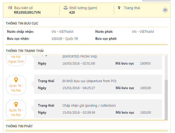

Quanghao, have you found anything about my pcb's? There is no sign of them here in Romania. Thank you.
Hi!
it still go to you, please see: VNPost | Mã xác nh?n
Status: Accept sending (posting / collection)
Date: 15/03/2016 - 02:39:36
ZIP code: 100100

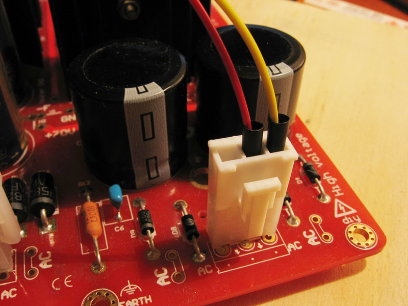

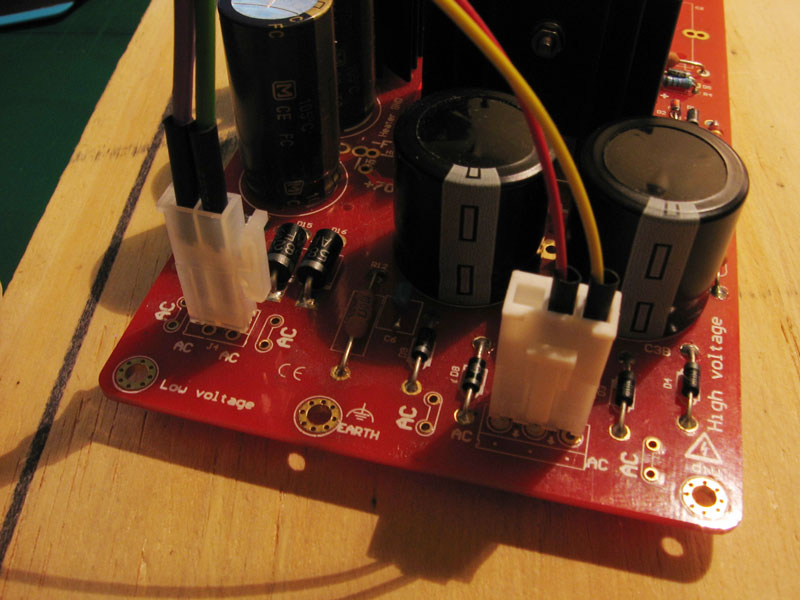

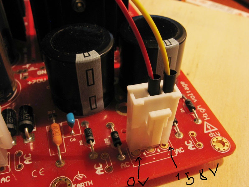

Quanghau can you tell me if I am connecting the transformer correctly:
In the pics purple/green = 12V, red/yellow = 158V.
My transformer gets very hot so there is a problem. In the pics above you are using a centre tapped transformer for the HV rail but only two diodes for half wave rectification?
you wrong!
see my image
thanks

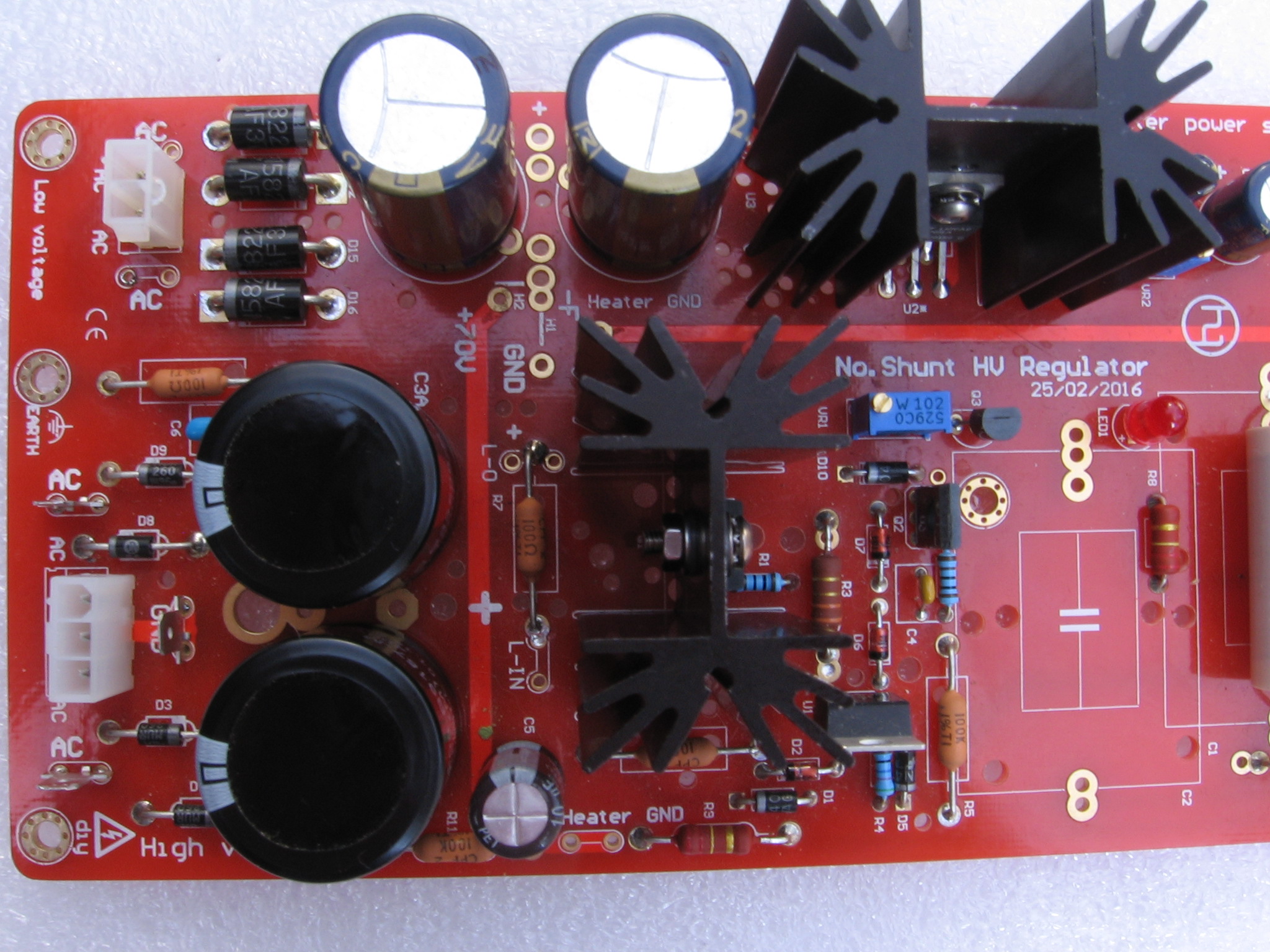

I am having problems with the regulator board.
The 12V rail makes the transformer get very hot, I have tried with two different transformers and both heat up alarmingly quickly. All components and soldering are correct.
Also I cannot get over 158V DC output on the HV rail, VR1 does not seem to work. The LED lights up fine though.
Has anyone got their supply boards working?

Do you have one trafo that do both hv and filament? if so, disconnect first the HV and trouble shoot the lv first. Isolate the HV and LV, trouble shoot individually.
Yes I tested both rails separately, the HV works in that it's converting AC to DC but I'm not getting the right voltage output. Not sure if VR1 should be adjusting current or voltage.
The filament rail was tested with two separate transformers and both got hot immediately, as did all four diodes.

On the filament, I highly suspect there is something wrong with the build. Make sure diodes are installed correctly, and the regulator chip, which one are you using? There was something wrong with the board, I believe in one of the regulator chip. If the diodes gets hot right away, make sure also that they were not damaged, because of the initial error.
The way I do it is that I do it in steps, I would install the diodes first and fire it up to see if the install is right, then the regulator, and test again, until I get to the last part of the circuit. This way, you isolate the problem, if any.

I think VR1 should be adjusting voltage. What voltage are you getting?

If someone else can confirm the supply works ok then I know it's something on this board. No components overheated but it was the rapid rise in temp that was all wrong.
Diode look correctly oriented with Cathodes going to positive lead on capacitors and Anodes to negative.
I'm getting 245V DC at C3 filter caps. Output is 153V DC!
Somewhere the circuit is dropping 90V but the heatsink isn't even warm and VR1 simply does nothing. I'll probe around the reg and get some readings
I'm hoping you can get yours to work. That's something to go on.
