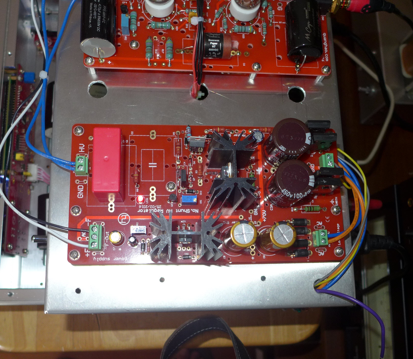

Passive420, I started my ps, installed the diodes, hv and lv, and its filter caps, connect the trafo, and I got 320v on the hv, and about 18v on the lv, no load though, but so far so good. I was able to finish the lv and everything works, was able to zero in at 12vdc (again no load), with the pot. Tomorrow, I will finish the hv. Hope you got yours to work.

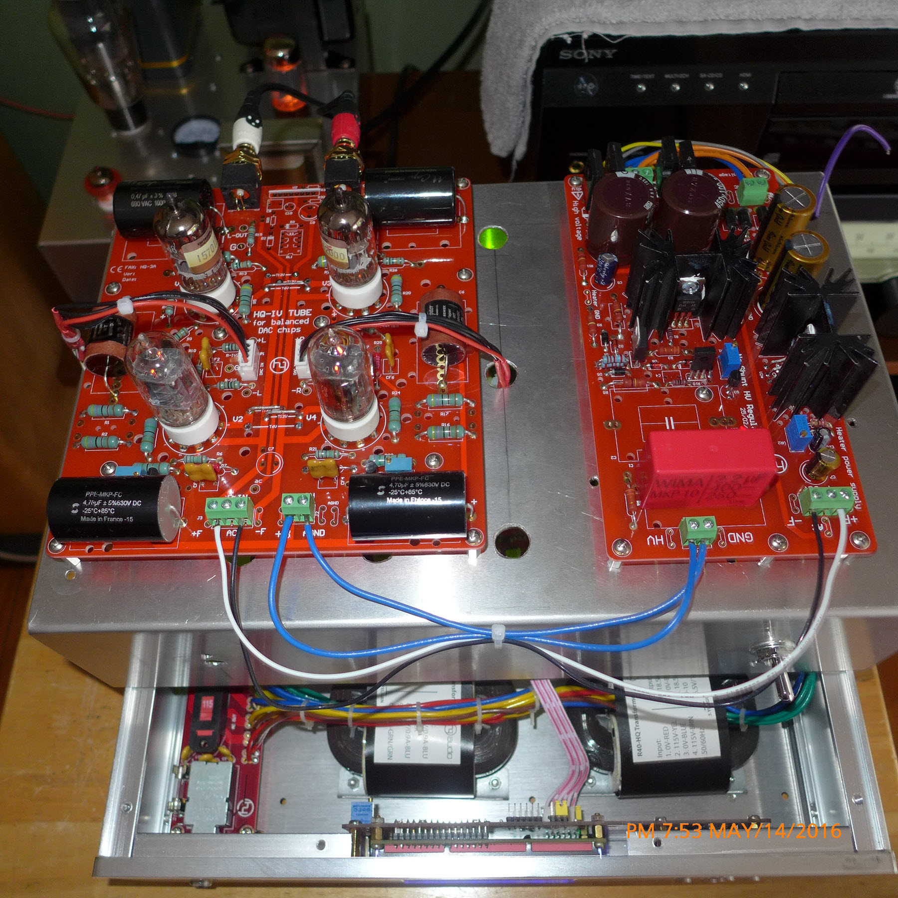

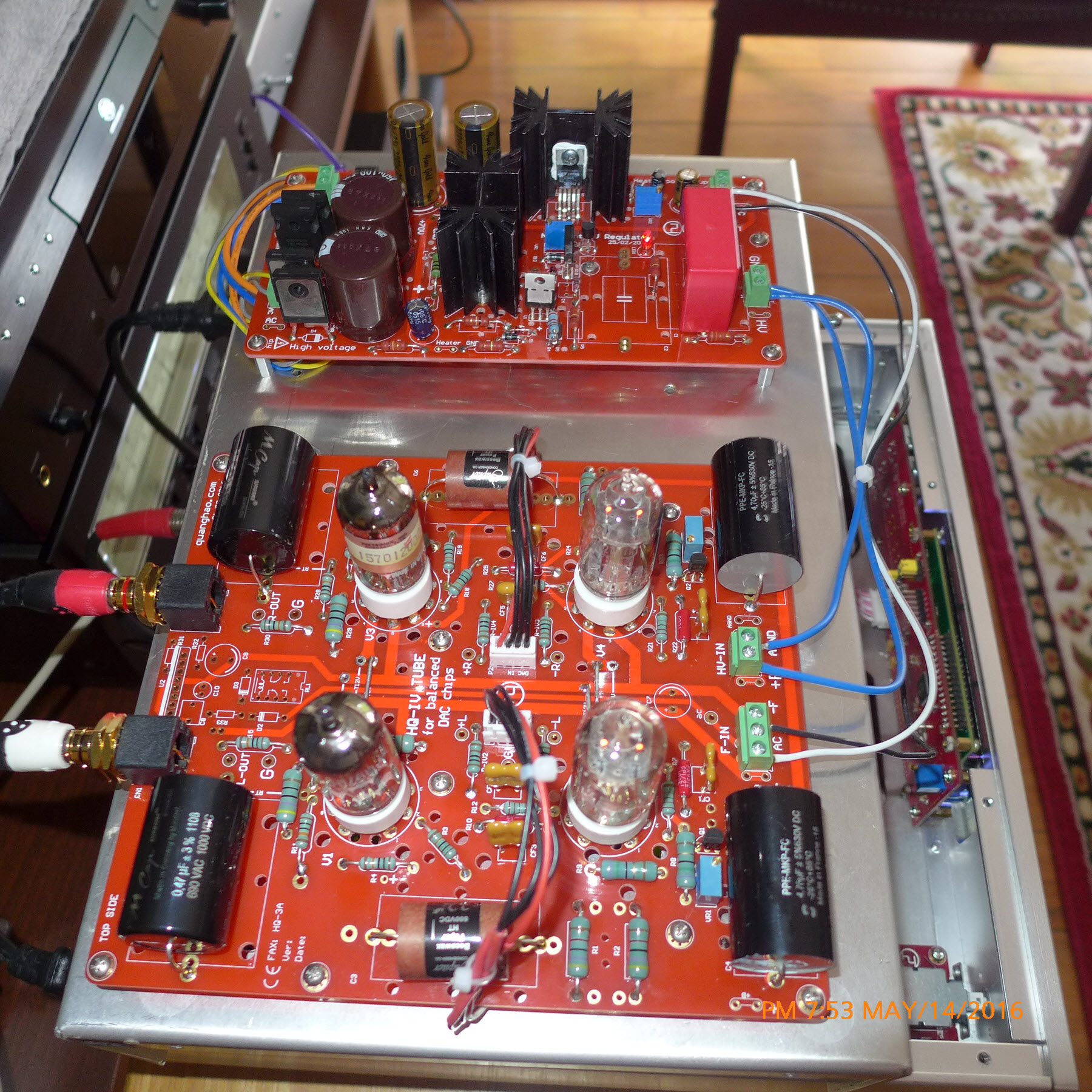

Tube Output stage build
For anybody interested, I just finished my build and used quanghao's DAC-END R Dac. I used 12AU7 and 6DJ8 tube. This set-up sounds excellent, sound is very open, relaxed and detailed, fast but not hard or mechanical sounding, extremely musical.
