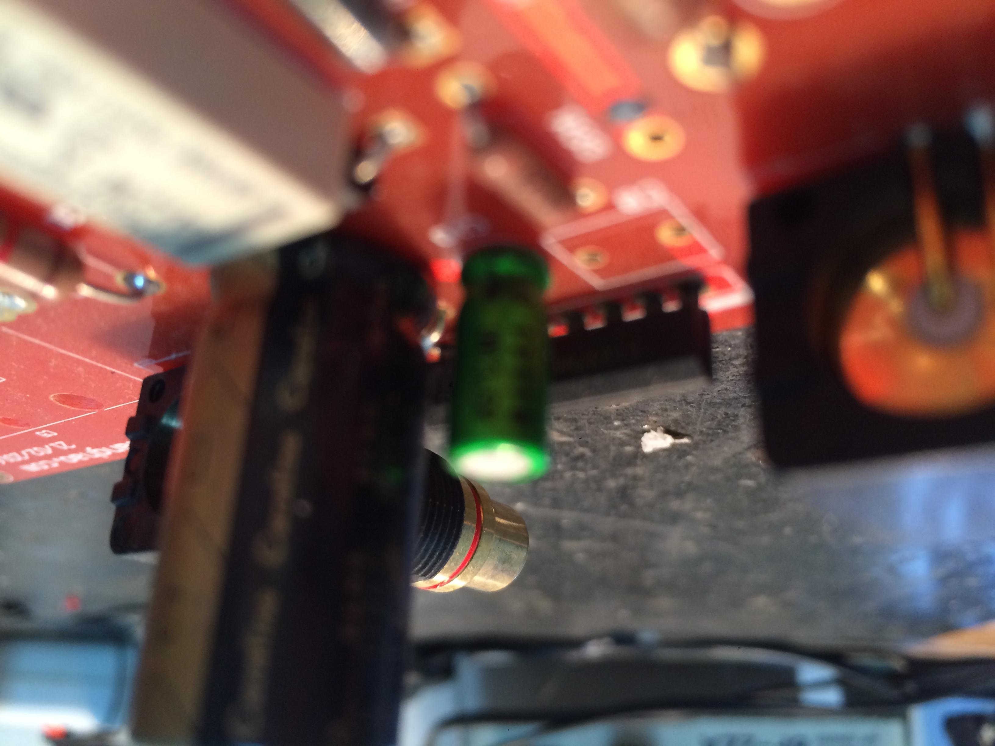

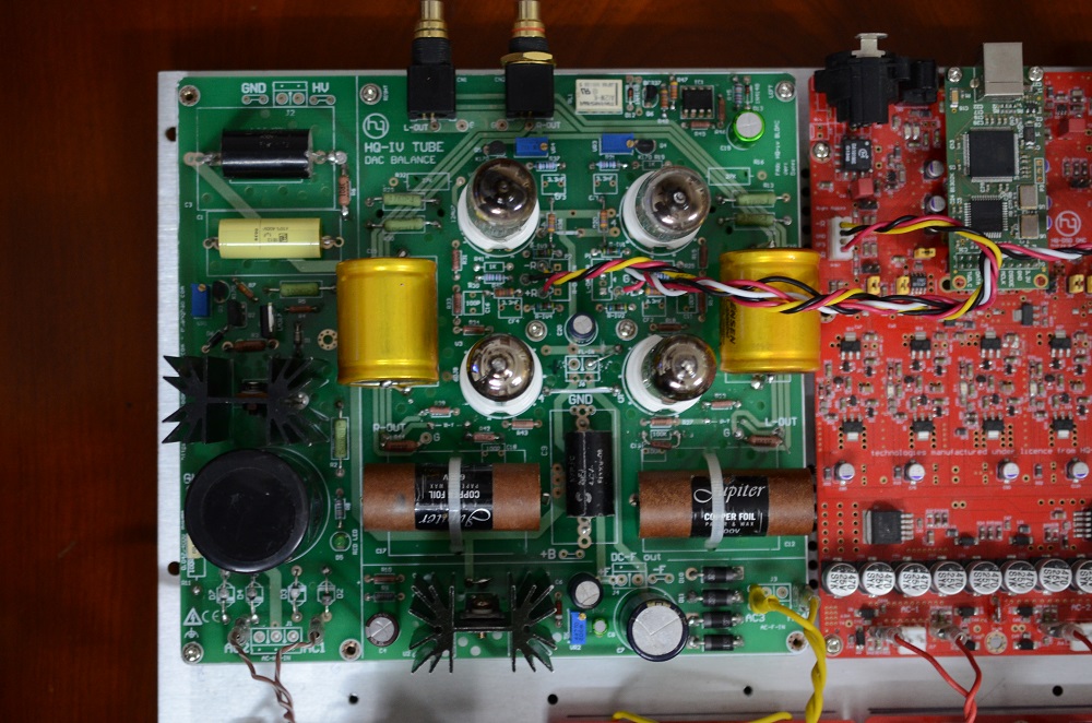

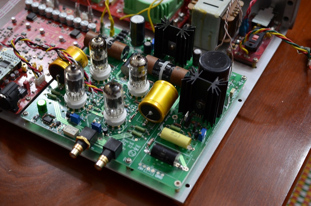

The DAC is playing (AK4490) allthow the gain is a little to high...
But I must ask again the delay for the relay is waaay to long.....How long is it for you other that have built this?

I´ve changed the UPC1237 to another one and c9 1uf and I get about 1 minute,all components seems right.
excxept I use +F and-F 6,3v instead of 12,6v does it matter for the upc 1237?

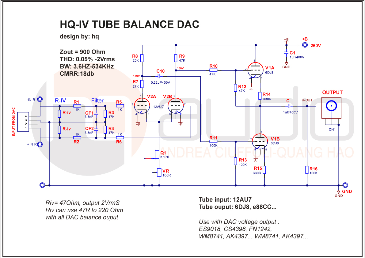

Those of you who built the tube output board,what DAC are you using and how is your gain?
The reason I´m asking is I get a little noise (when music not playing) in my 6E6p -->SE EL36 amp and the gain is way to high,I use the Squeezebox Duet and its volume control.I can bearly touch the volume before it gets to high..
How have you managed this? :scratch:
Edit:I use ECC88 and 12BH7
Ryssen: If you are using AK4490 as you told before that is the problem. Because all info i find by googling around is that AK4490 is a voltage output dac, not a current output as this this output stage is supposed to be used with. So your dac shouldn't even use a I/V stage, just a buffer, if anything.

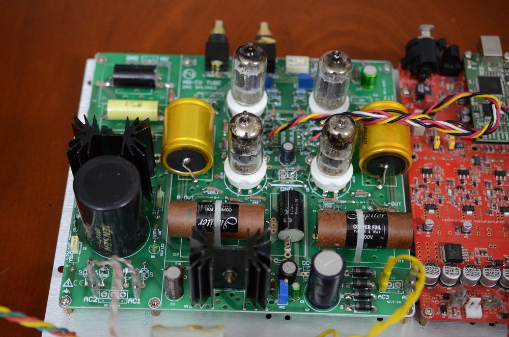

I know it has been sometime, but I have managed to populate the boards. I stii have the same problem as PASSIVE420 with the Power supply. The lv is working, but the 12V I can get is in the edge of the trimmer (I am using the LT1764 regulator). For the HV parte the only output I can get is 154VDC, with 220VAC input. Also the trimmer doesn't seem to modify anything. Passive420 how did you manage with the power source? Thank you.
I cannot edit the post once more so I post again
I have solved the two problems
For the HV section I had a problem with LM 317. It was somehow out of order. Changed it and the HV part worked as expected.
For the LV part I had to change R13 from 220R to 10k and after this I could fix the LV output to 12V or any other value.
I've just been troubleshooting a low filament voltage, and (quite separately) discovered that the left and right channel input labelling is inverted on different sides of the IV board, i.e. what's labelled left on the bottom is labelled right on the top. Just noting that here in case it catches anyone else out.
