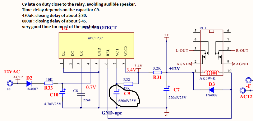

The DAC is playing (AK4490) allthow the gain is a little to high...
But I must ask again the delay for the relay is waaay to long.....How long is it for you other that have built this?
Hi!
C9 late on duty close to the relay, avoiding audible speaker.
Closing time lag depends on the capacitor C9.
470uF: closing delay of about $ 30.
680uF: closing delay of about $ 45.
very good time for most of the pre tube.
