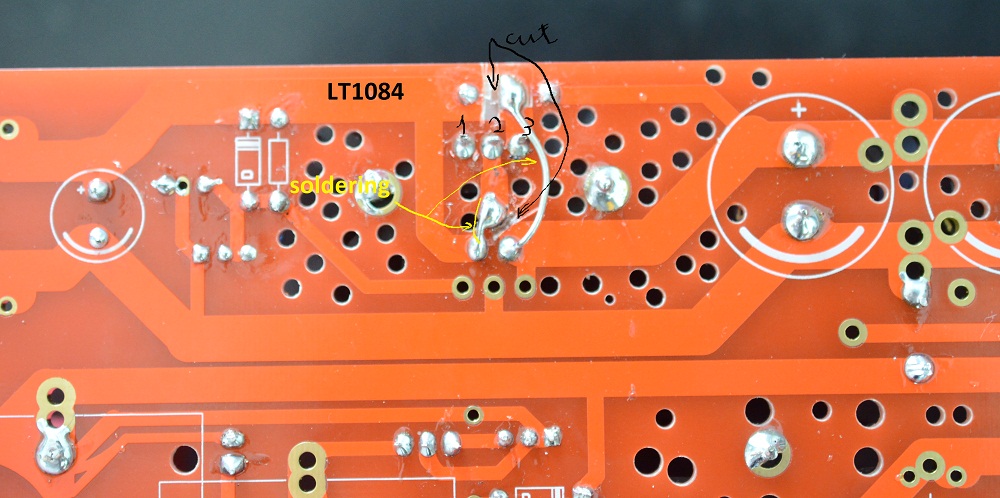

Are you sure the LT1084 is incorrect pins?
pin 1 = Adjust, pin 2 = Out, pin 3 = in
http://cds.linear.com/docs/en/datasheet/108345fh.pdf
Yes!
yes, I'm sorry about this,
please forgive me. I'm so sorry.

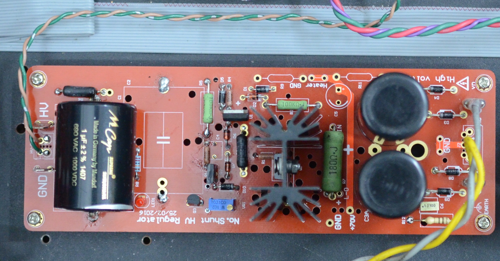

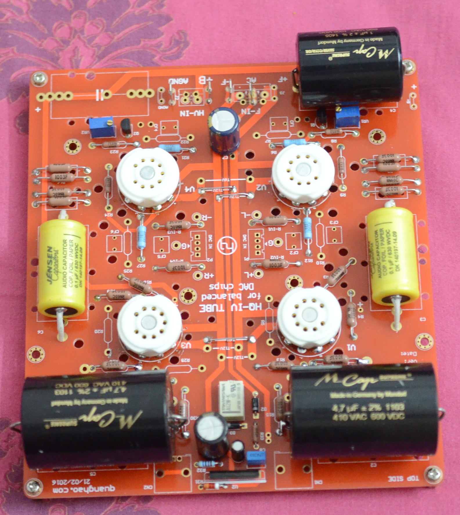

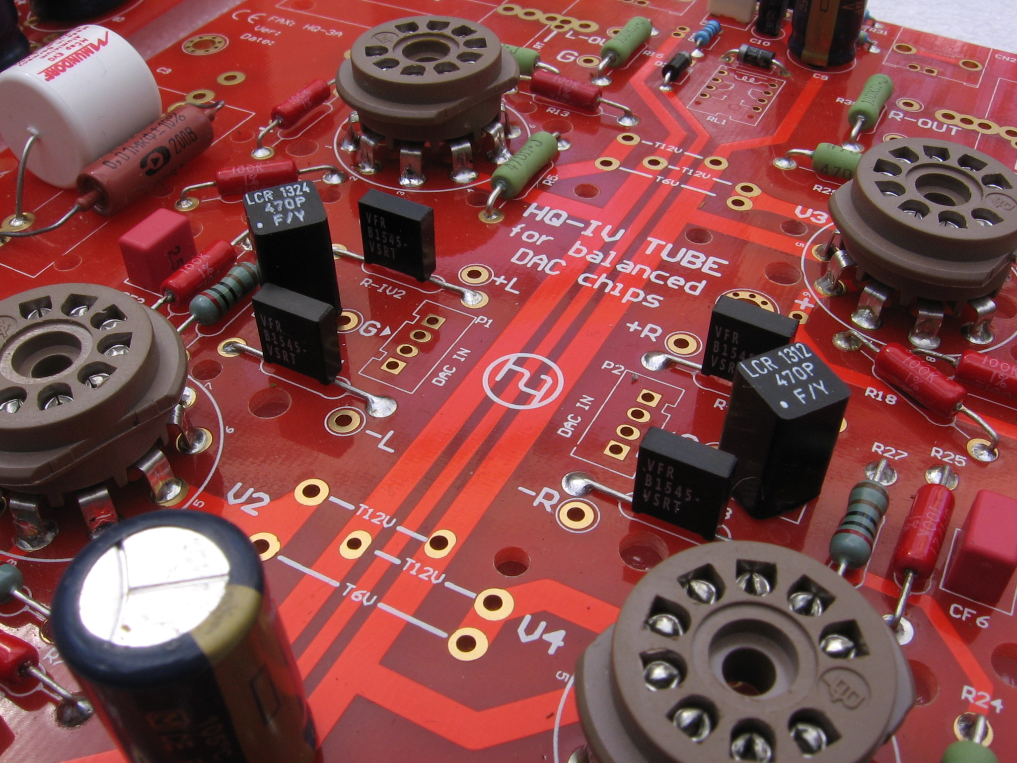

Some pics of my boards as far as they go for the moment. Waiting for shunt heat sinks and Russian polystyrene output caps. Have ordered balanced sets of JJ gold tubes - ECC802 & ECC88 to start with.
Went the distance and bought Vishay precision S-foil resistors for I/V, Takman metal film for signal and KOA speer carbons for plate and cathode resistors.

Wow, those Vishay S series are pricey! I thought the audio note tantalums were expensive, but they're a different league! Thanks for sharing the photos. What are those bypass caps on the Mundorfs, and what have you used them?

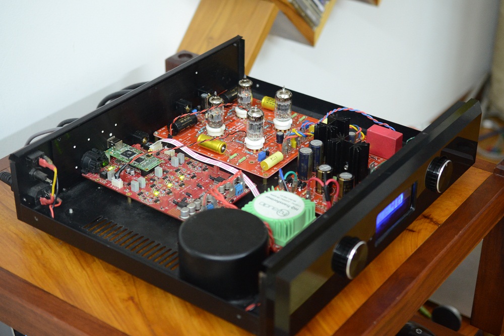

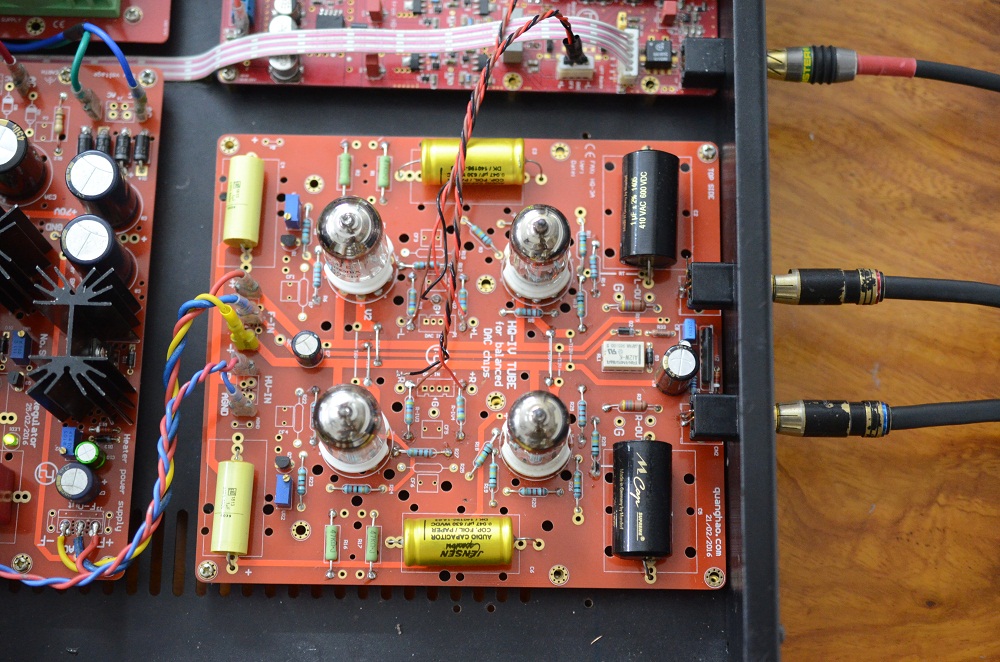

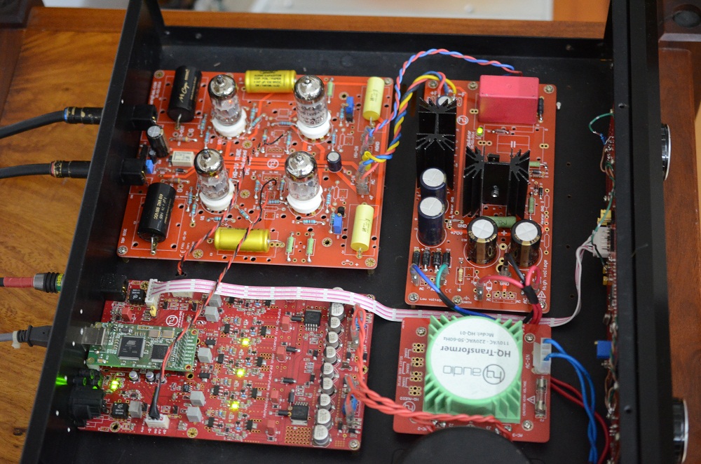

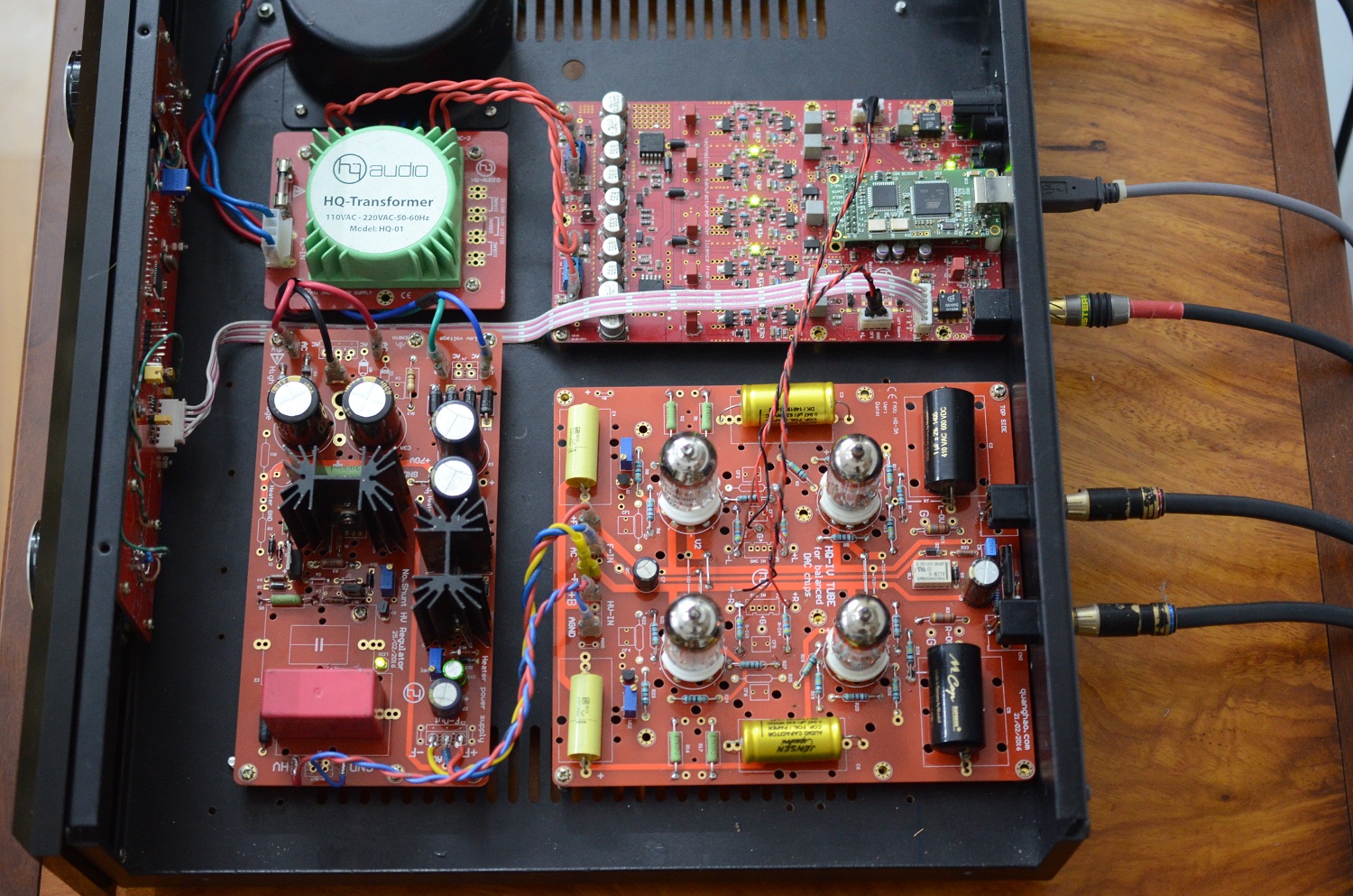

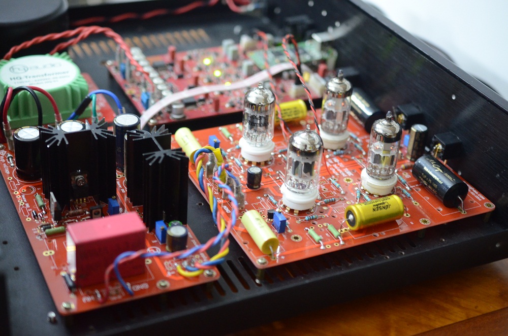

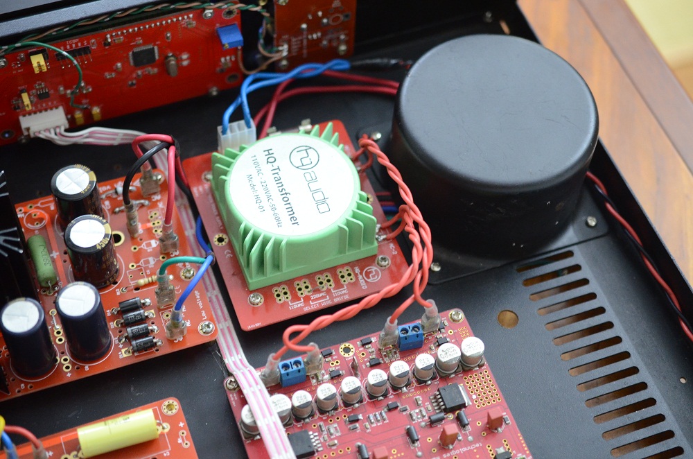

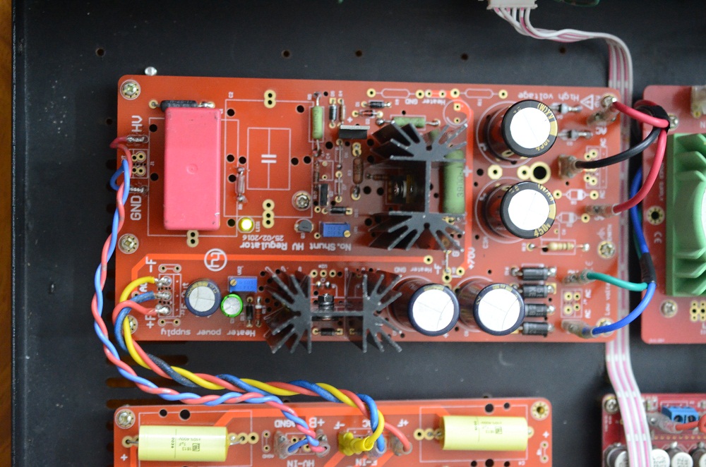

Hi jonwhitear and all!
some image IV finis with DAC, please see it
thanks
thanks

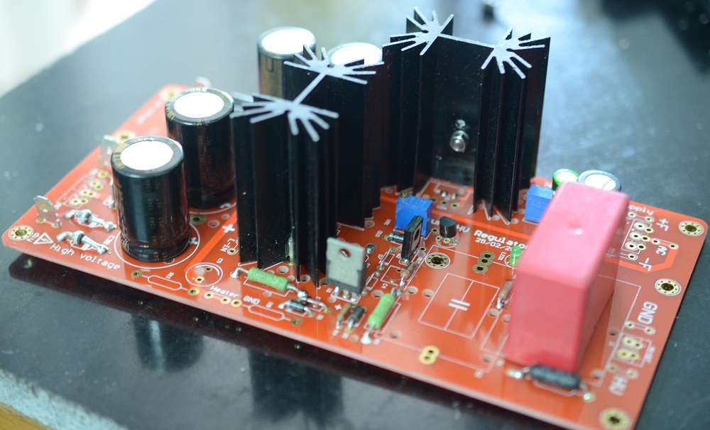

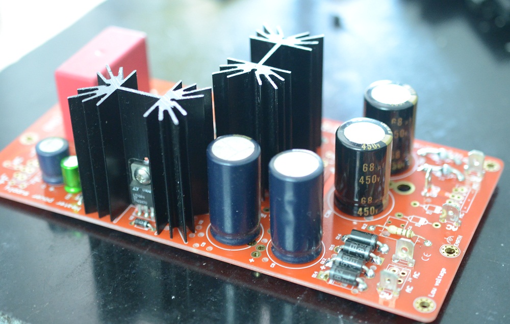

One wronng PCB LT1084 and fix
A small PCB with the LT1084 error, and this is the image to fix the PCB, and uses Lt1084
I am very sorry for you, and please do me!

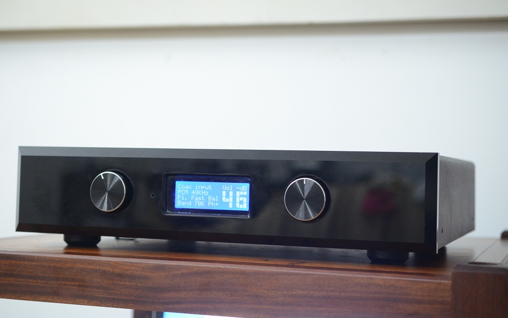

Quanghao, I see you are using a different case on your finish pictures. Not the one you on the original DAC II. Do you sell or do you know where we can purchase that same case(chassis)?
Yes . Because tube big pcb and hot .
Ok if you like I can have chassis for this iv and dac 32 of me.
Yes, that would be nice Quanghao, how much would it be? Also, do you still have another DAC board, for sale? If you could have aluminum color(not black) that would be nice too. This case is the last thing that I need, we need case to put everything together.
