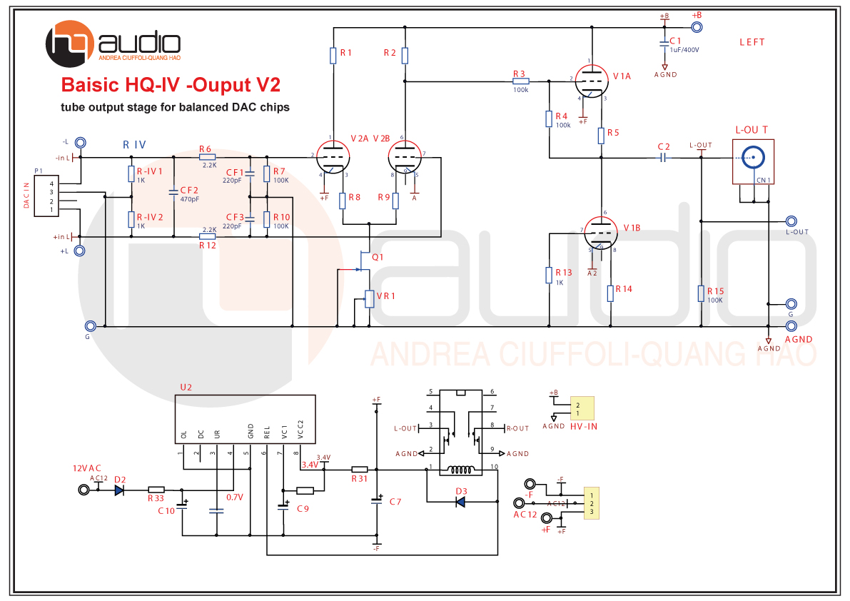

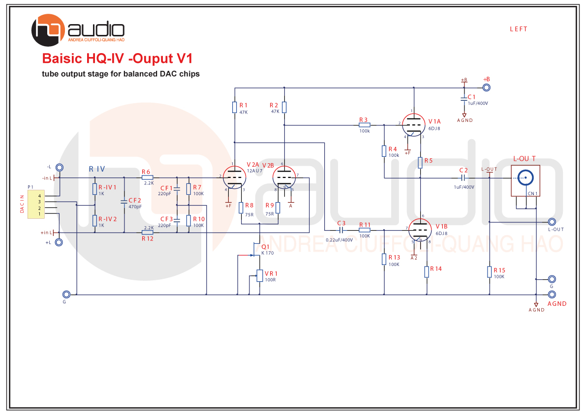

And this is my circuit diagram!
Quanhao, I am studying the schematic and the pcb, you have two different schematic, can you please post again which one is the correct one? I am a bit confuse. The one you said was yours, it does not have C3, R11 (left), but the pcb has it?? Please clarify

Quanghau, can you tell me what C3/R11 and C6/R26 do in the circuit? I cannot see them in the schematic posted. Just wanted to choose the right components for the job.
It looks like they decouple the diff amplifier stage from the output stage?
Adeveza -I already asked this. Also why the 4 pin connector and the stray trace that stops dead. Seems a waste of copper.
Quanghau - For ECC99 tubes R5, R14, R20, R29 = 470R? Same as 6DJ8?
Is it possible to use other tubes for V2/V4 ex: 12AX7, 12BH7 if we calculate R8, R9, R23, R24 and R1, R2, R16, R17?
Or change R8, R9, R23, R24 and adjust VR's?
yes, 6DJ8 can change by Ecc99.
12AX7, 12BH7 , i not test this tube, but 12BH7 you can usre
R5, R14, R20, R29 = 470 - 1K, set curent = 10-15mA at 260V +b
and all shema for two options output. An HV supply

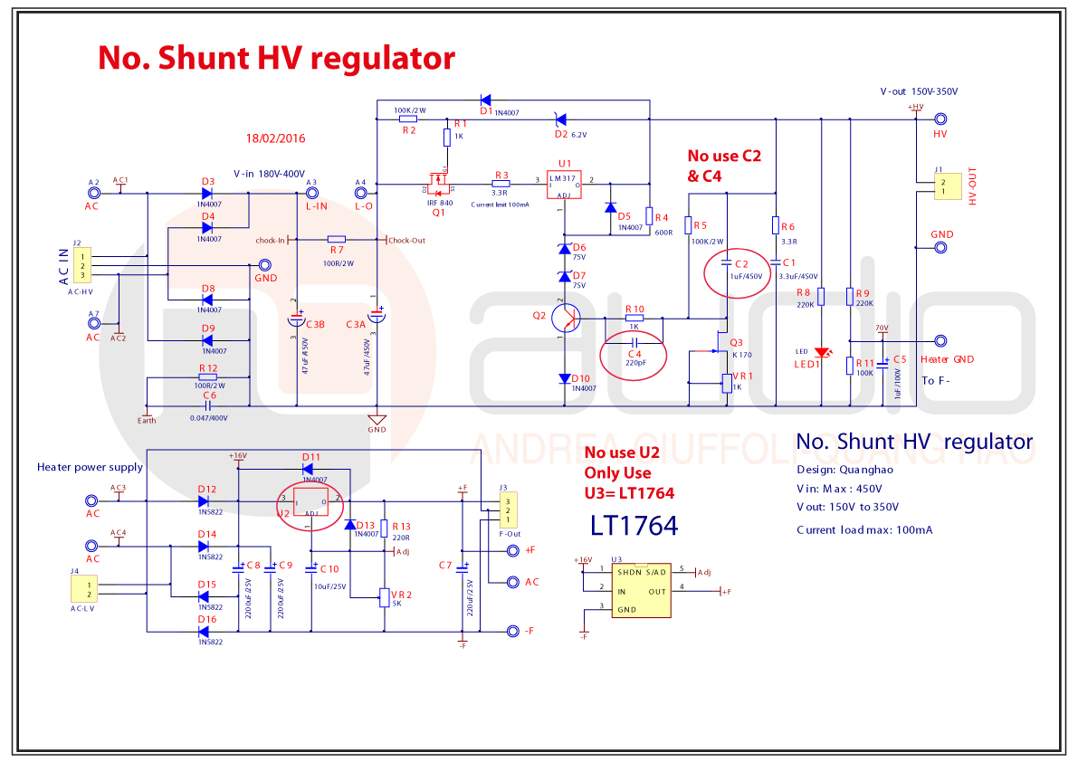

Diodes and a Cap??
hi my friend, please see this: #175
thanks
quanghao
Quanghao, the PS pcb has diodes and a cap labeled, D5, D6, D7, D10 and C4, but they are not on the schematic. Can you please clarify where they are in the schematic? Please
See all shema post 175.

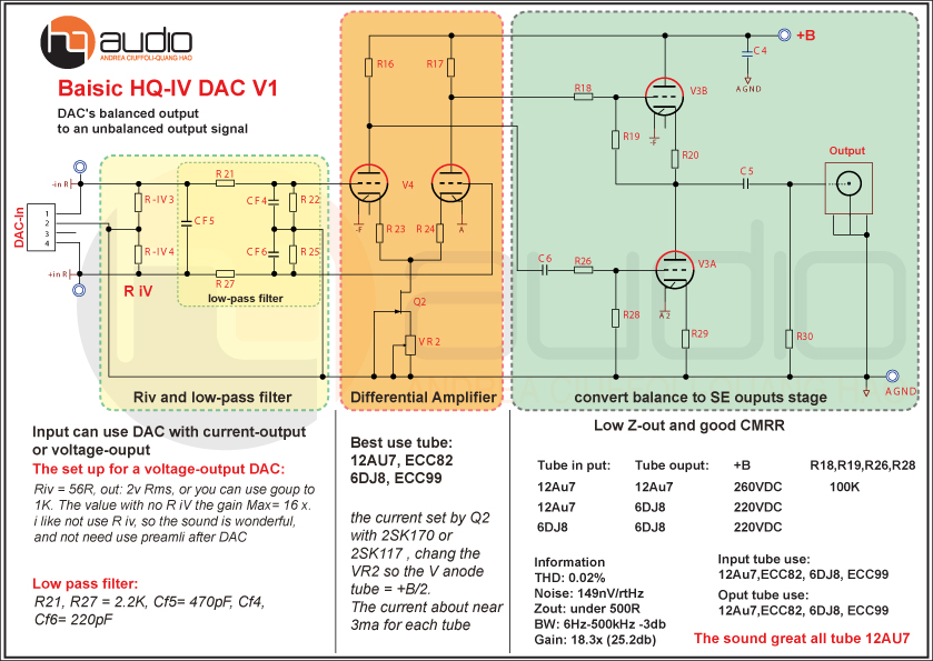

Quanghau - I would like to use Shinkoh resistor for R6,R12 & R21,R27 low pass filter but no 2k2. Can I use 2K4 with 470pf for filter?
Can we reduce value of 2k2 and increase 470pf for same frequency filter?
Is this correct?
Cut off Frequency: 2K2 & 470pf = 153999.67968067 Hz.
We can also use 1k3 & 800pf for same frequency cut off?

yes, you can get the value you like!
