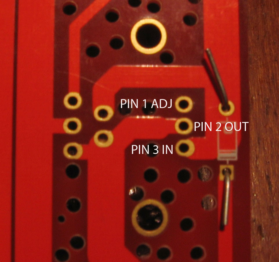

Note the filament use LT 1764 .
Can not use let 1084.
Yes, I got it, but just curious, why cant we use 1084? its cheaper too.

Adevaeza - I too have both LT1084 and LT1764 ready but also considered using 1084 simply as I did not need the ultra low drop out, it can handle more current and as you say - it's cheaper.
There appears no reason not to use LT1084 unless we get a definitive explanation. The pins are correct for use and as long as you have one volt for the drop out then you should be good to go. 12VAC in will give you over 16VDC out which is plenty.

Don't know why some parts are omitted in the HV PSU (I guess the 2SK170 did not live too long) and why LT1084 can not be used in the LV PSU. I received my boards only a few days ago and I am building the LV part to check if it works OK with NOS tube transformers with their standard 6.3V windings.
You will likely need LT1764 when using 6.3 V windings and 6.3V filaments. The fact that LT1084 is cheaper is eh...a non issue considering the total cost and the probable need when 6.3V windings are the only thing you have got. LT1084 won't cause an issue with 12V windings as far as I can tell but maybe Quanghau can elaborate ?!

yes, with LT1084 , i found on wrong pin off it.
Change of the pin 3 and pin 2 as LT1084
im very very sorry, it is bad off me!
thanks
thanks
Thank you Quanghau.
Are you sure the LT1084 is incorrect pins?
pin 1 = Adjust, pin 2 = Out, pin 3 = in
http://cds.linear.com/docs/en/datasheet/108345fh.pdf
