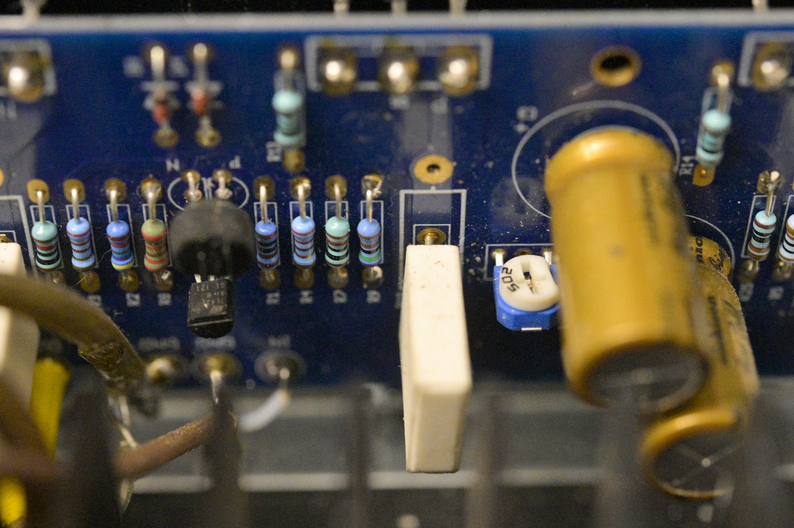

I raised the bias a little but it won't go past 182mV while trimming down DC to around 0 🙄 the pots by the way only allow about one turn, my guess is the thing has to be dismantled and checked values but too strange the other channel doesn't raise past 70mV and in fact, finally, the almost working channel is finally getting warm which has never happened before.
Working channel is slowly raising from about 180mV to past 190mV.
Switched it all off, measuring along the six mosfets on the working channel the voltage was from 190 to past 200, this thing definitely not just a matter of trimming up and down.

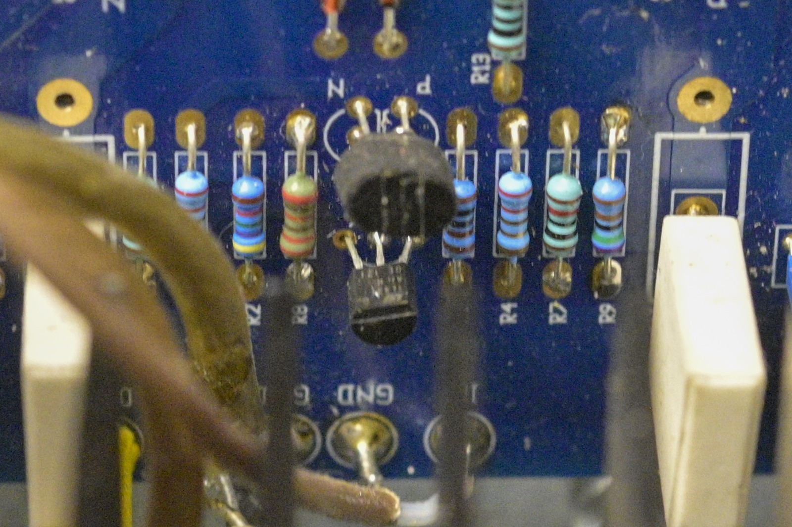

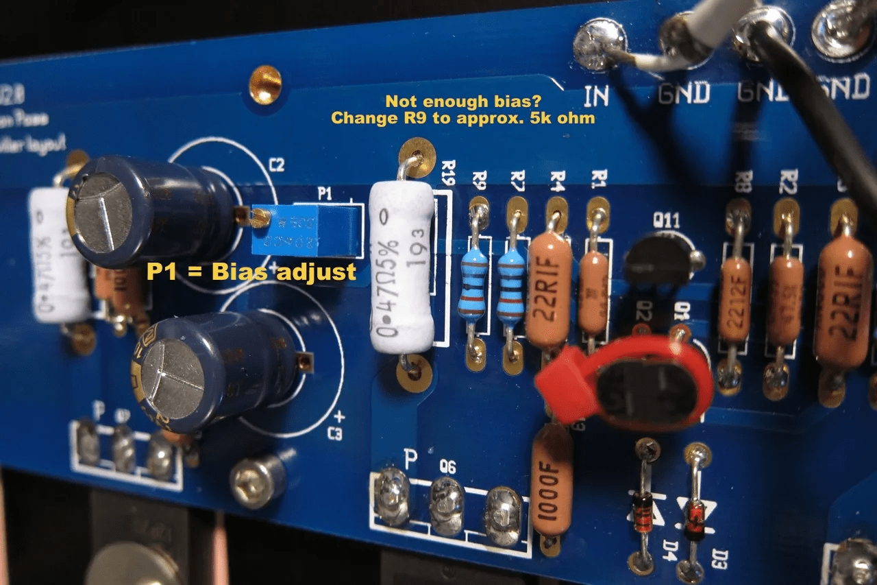

Please check (visually) for both channels resistor values for R8 and R9. For each channel, try measuring the voltage with one probe on the Gate (left) pin of one of the mosfets on the N side and the other probe on the Gate (left) pin of a mosfet on the P side. We want to verify the TL431 setup is correct. It seems like you are not getting enough voltage from it and quite likely you will need to change out R8 to something higher.
As for why one side only goes to 70mV, that has to do with variation in the Vgs voltages of the mosfets. (So for a given voltage, one mosfet might turn on harder than another.)

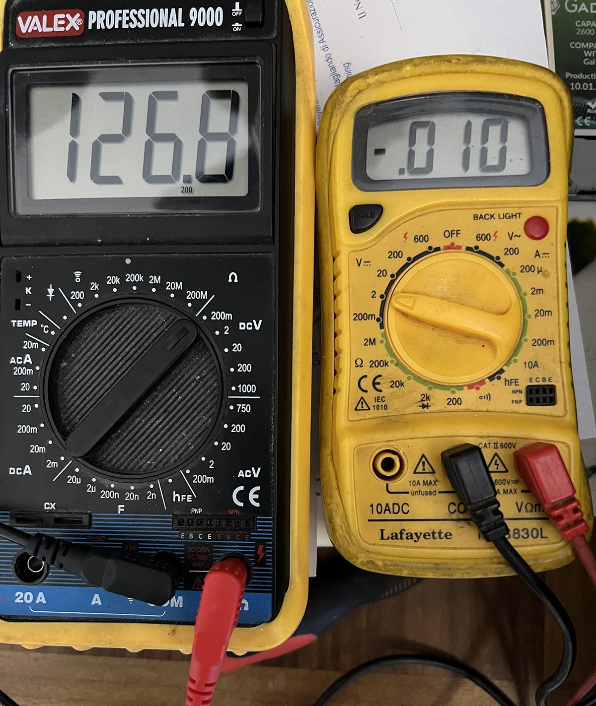

Let me give a resume, first and foremost I shortened the inputs with an RCA cable, then measured the offset on the apparently working channel with the two probes connected to the speakers output, on the positive I put the probe of the second DMM and the other probe on either the P leg of the mosfet or by the pinhole right above the R17-18-19... resistor, tuned P2 to get the closest to 0 for DC offset and then slowly raised P1 to bring bias from 120mV to 175mV after which bias started to raise quickly and could definitely feel heat raising too. P2 needed a very slight adjustment as it increased a bit.
these are R8 and R9
here I can tell something is wrong with Q11, a leg is not soldered even tho I think it still does an electrical contact

Even perfectly matched triplets can have this problem. It really depends on the Vgs of the particular parts. There's a range and some just needs more voltage to get at the desired current level.
If my eyes didn't fool me you have 22.1K for R8. Notice that in the last published schematics in the F4 manual, that value is 27.4K which allows for more adjustment room for increasing the bias.
