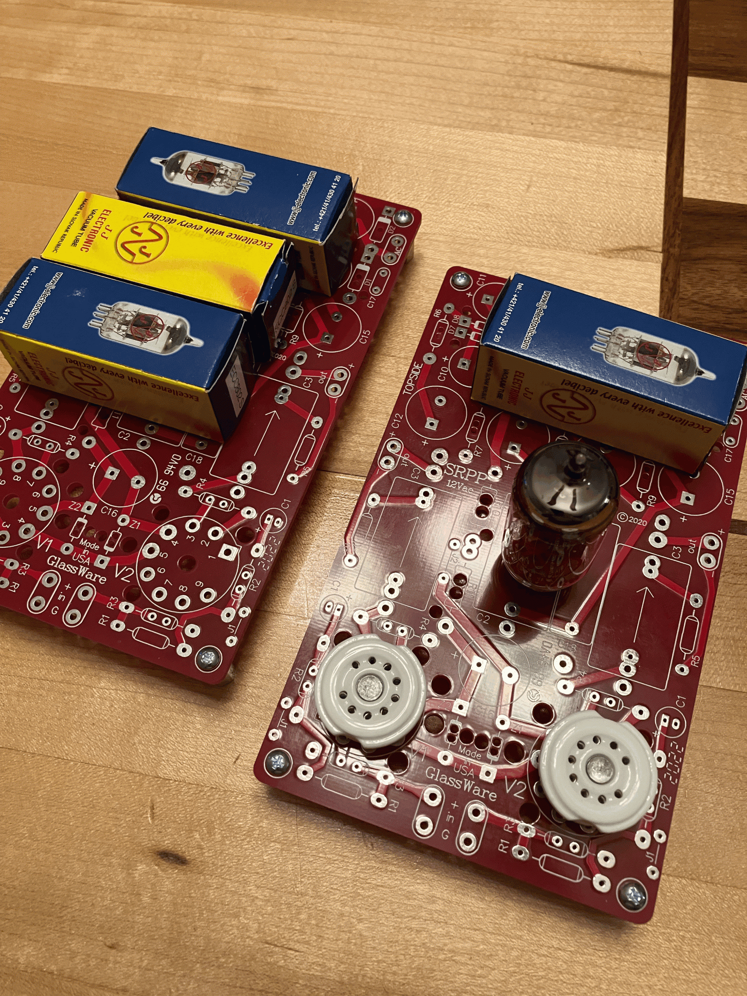

Currently, I'm adding some tubes (a pair of Glass-ware SRPP boards) to my setup for two reasons:
1.) a little more gain
2.) I want to hear how different front ends sound.
I look forward to reading how the BA3 sounds compared to the SP9.
