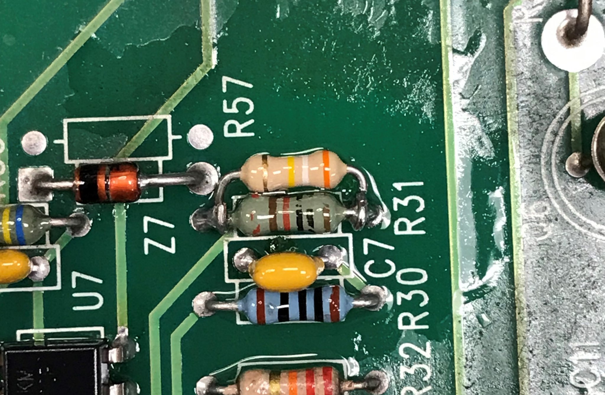

Something else I would mention, and I think ZM brought this up too.... We normally recommend a large round washer to secure the power MOSFETs to the heatsink on these projects. Gives a more even pressure on the part. Look at my picture at post #25 for an example.

I'm a little lazy and impatient sometimes. If that was mine I would just piggyback another 10k resistor onto R9, which gives you 5k total there. Way faster and easier than a bunch of teardown and disassembly.... In fact I did that on something at work today to lower the value... see R31 on this picture. If there was another resistor in the way, the piggyback could go straight on top.
