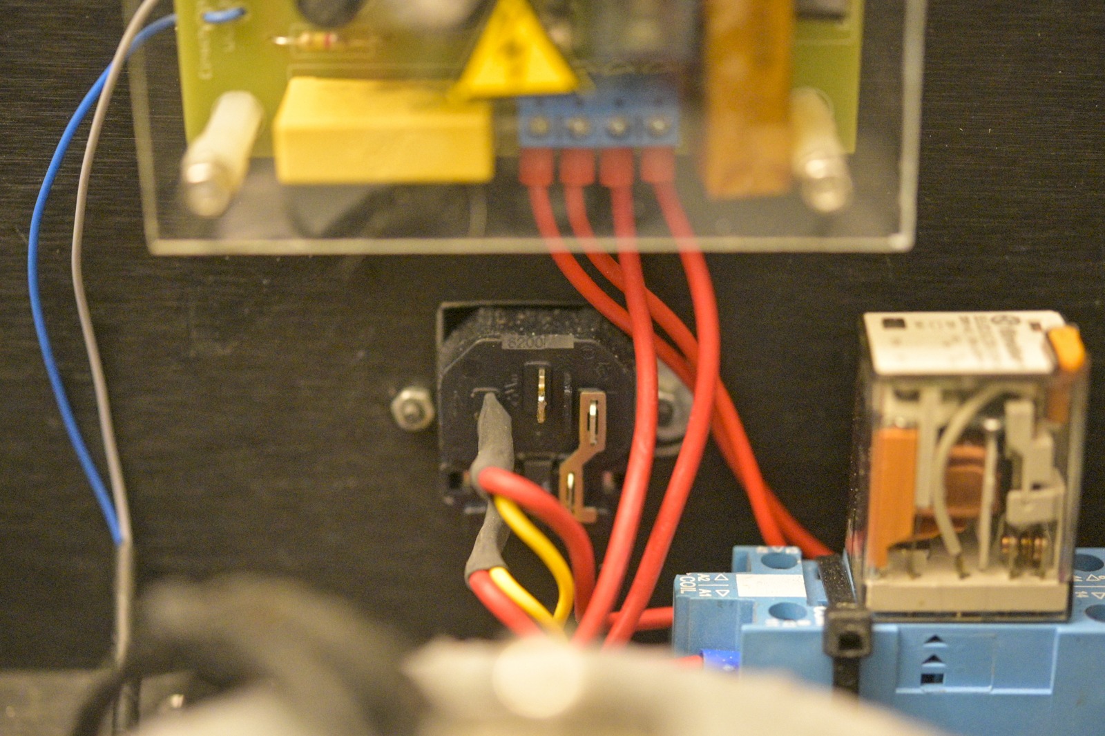

The original mounting arrangement was good, no shorted turn there.
New "upgrade" with the bar = BAD, we don't want a conductive loop around the transformers like that. You need to break that path somehow. Remove the bar, cut a section out of the bar, something....
Safety ground -
We need a close up picture of the IEC inlet. For safety, you need to have a secure connection between the IEC ground/earth terminal and your conductive chassis. Make the connection close to the IEC. Use heavy wire, scrape chassis paint if needed, use star washers, etc. Guys here will usually use a CL-60 thermistor (our "ground lift") between the power supply circuit ground and this chassis ground that we've created. There's a picture of that early in the F4 build guide somewhere. I can't tell from your pictures where, or how the ground connections have been made.

Recommend fixing the grounding and x-former mount issues first as they are related to safety.By the way I wanna fix the bias and DC offset then eventually work on the ground bit
Giovanni,

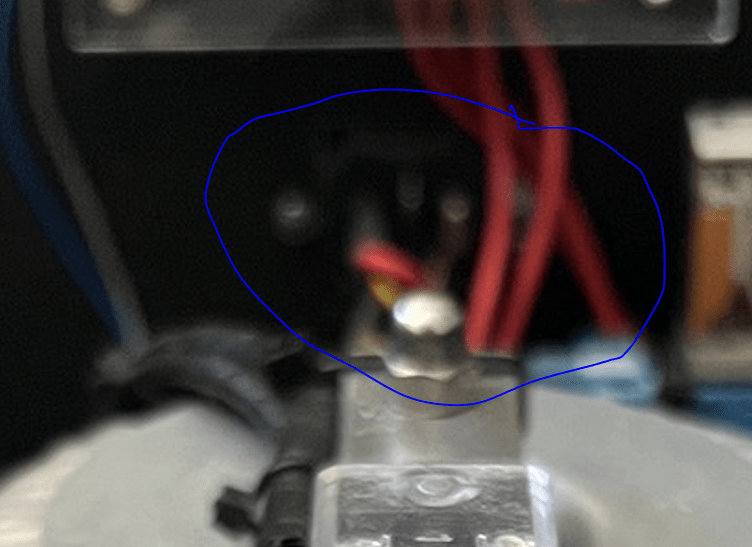

Can you please take an in focus photo of the IEC connector? (See attached). It looks like the earth pin is not connected. This is a safety feature and is what William is concerned about.
More photos of the interior, with special attention to the power supply will be useful.
@Dennis Hui here you go, you are right, the ground pin is not connected, tomorrow I will ask my friend why as I have no clue
edit: the bar connecting the transformers is non-magnetic so no ground loops and the fact the ground is not connected is on purpose, he'll explain me once we meet in person

that bar is electrically conductive, so remove it!!!!!!
and, your Buddy is, mildly said - Bloody Idiot; every metal enclosure must have Safety Ground connected.
Safety ground not connected to chassis is a safety issue. You risk shock or electrocution if there is an accidental short to chassis.@Dennis Hui here you go, you are right, the ground pin is not connected, tomorrow I will ask my friend why as I have no clue
The bar connecting the transformers may form a shorted turn at each transformer - not a good thing. You can check by measuring the resistance between the bar and the chassis. If there is continuity between the bar and chassis, you have a shorted turn.
