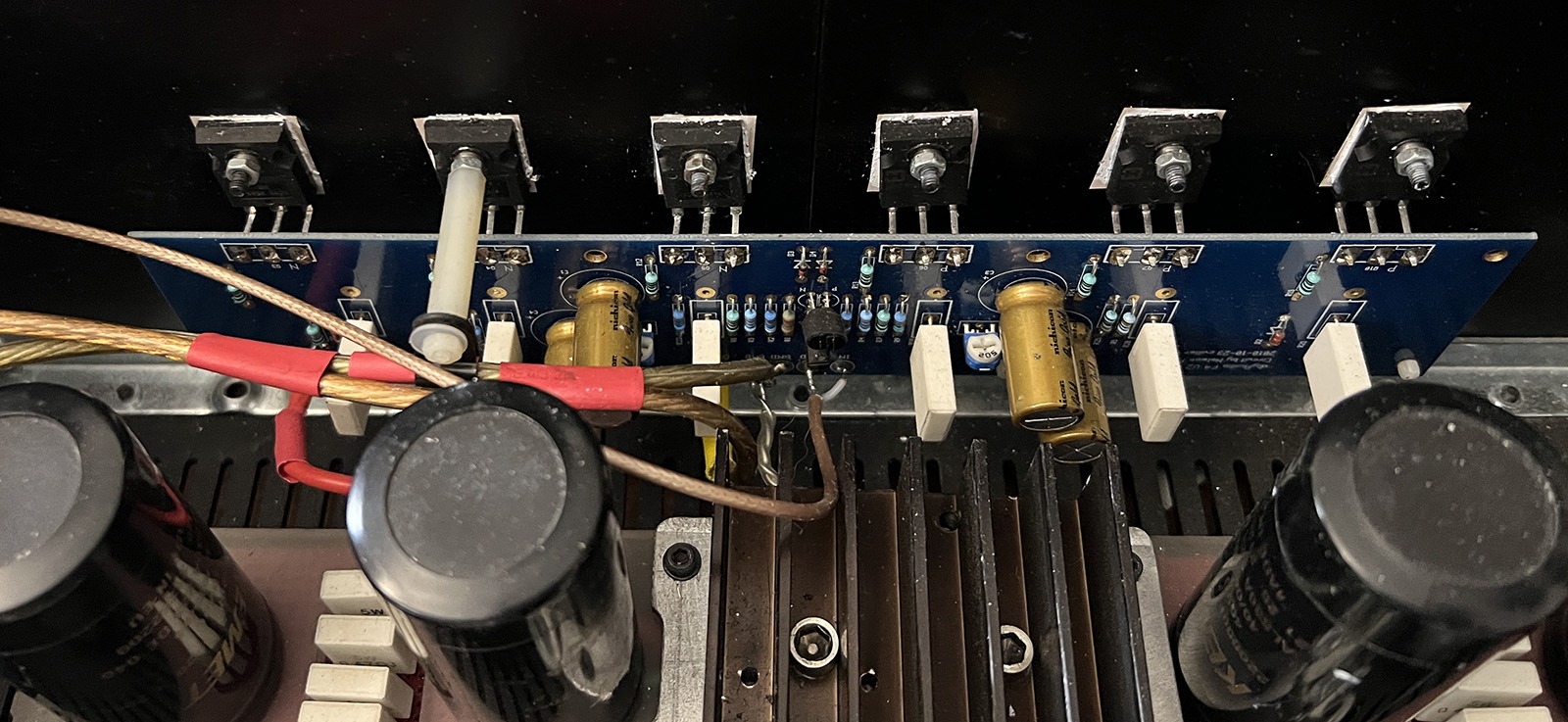

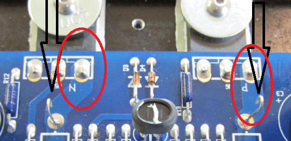

I so much wanted to check the bias this morning, took the amp cover off and worked my best to find the above mentioned resistors to measure but to my luck the probes of my DMM won't fit 🙁 do you have some suggestions to work it out?
What else could I measure to check it being properly biased?

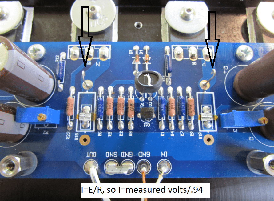

Here's how I personally did it (see attached pictures). I soldered some test points to the board and measured across two of the series resistors. We live and breathe ohm's law around here so you know it's I=E/R. We find the current through something by measuring the voltage across it, and we already know that we have .47 ohm resistors. So, you take the reading, and do the math. So, I clipped the voltmeter to the test points on my pcb, took note of the voltage reading, then did the math to find the current through that leg of the output stage. The F4 has three legs, or what we refer to as being a "3 deep" output stage. My math was... current=.55 volts divided by .94 ohms. My own personal F4 had a total of 1.75 amps of bias current (.58A per leg).

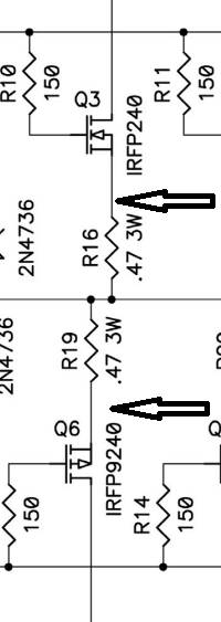

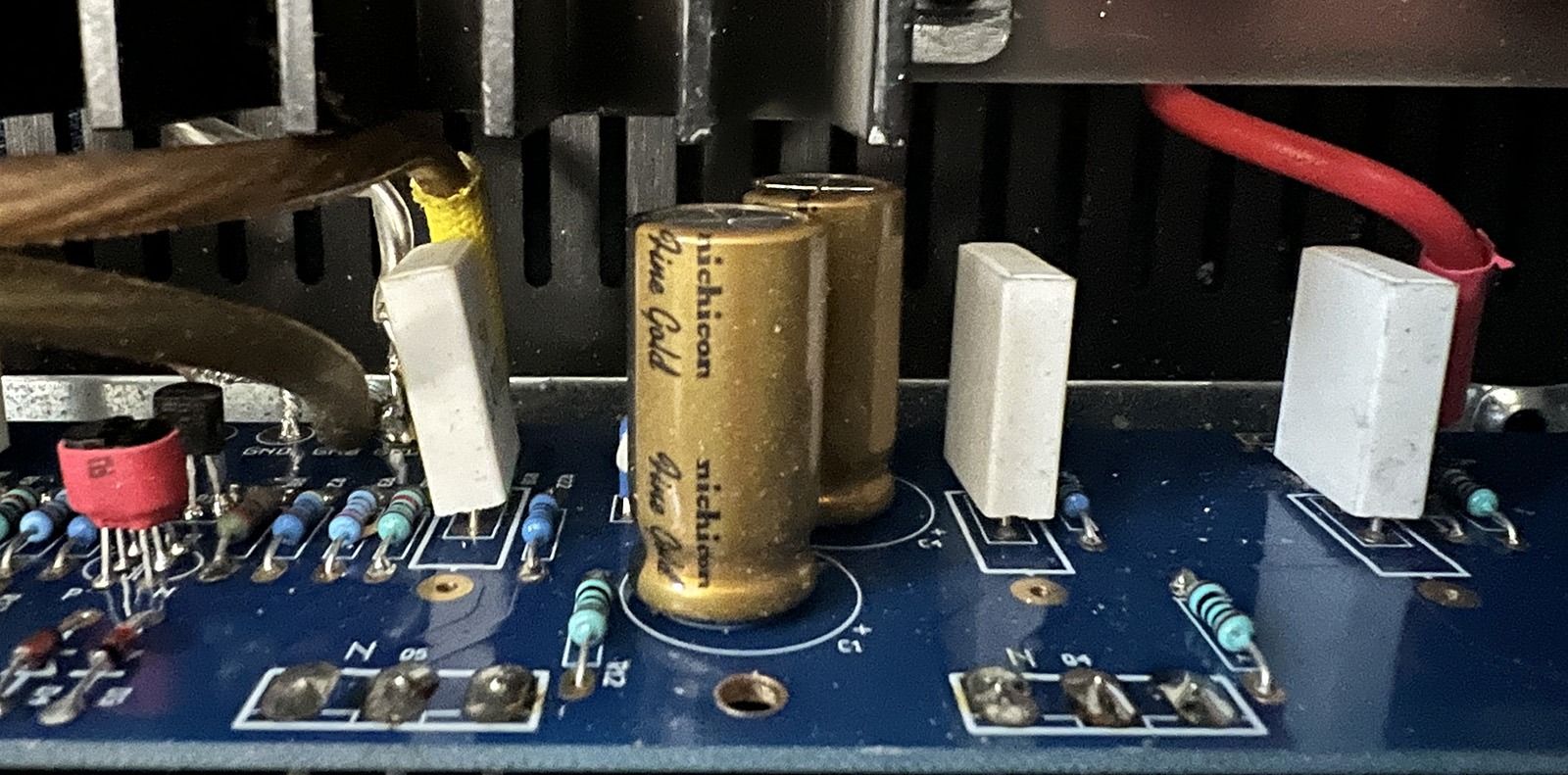

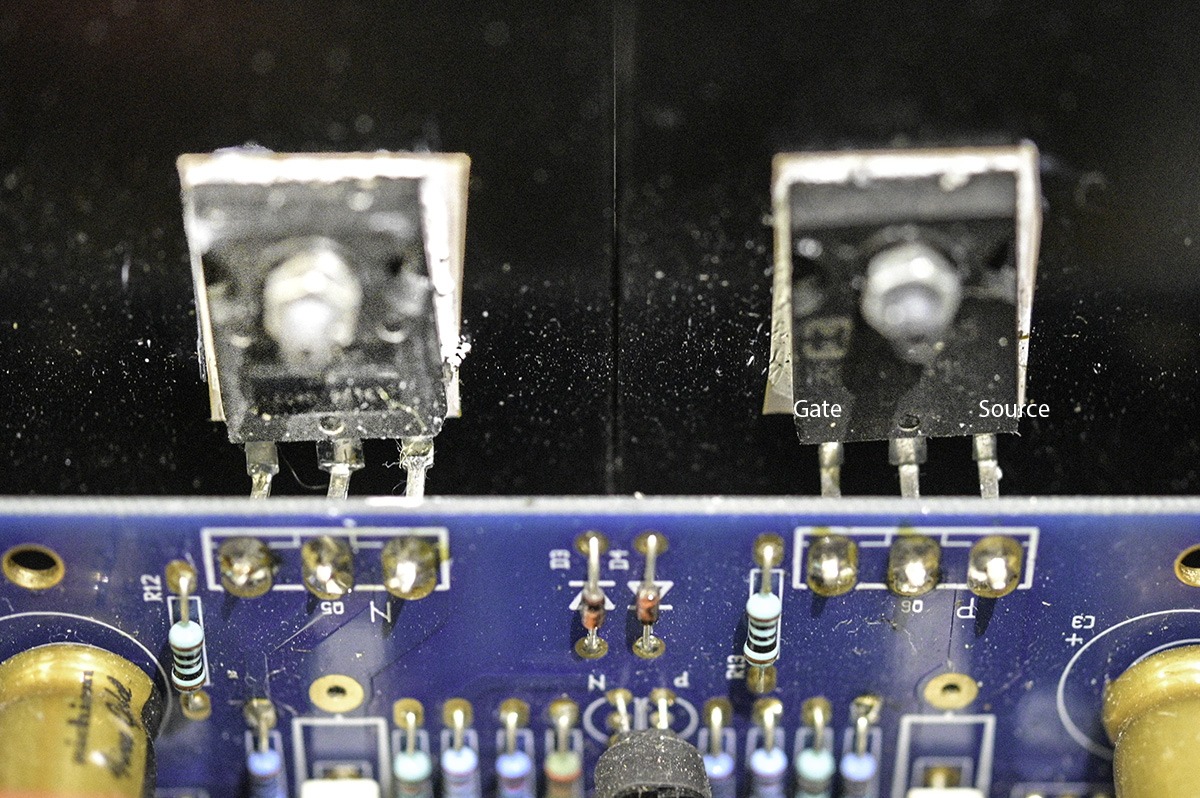

Source pins of mosfets are exposed enough (pin, most right one, when mos is looking with numbers at you, pins down)
so, connecting one probe to 240 Source pin and second probe to 9240 Source pin will give voltage sag across two source resistors
so, if target figure is 280mV across one source resistor, this way readout needs to be twice that : 560mV
numbers just from top of my head , applicable for 600mA per mosfet string, resulting in sum Iq of 1A8
if desired figure is smaller, calculus is simple and most likely already mentioned elsewhere
reminder - final settings in temperature equilibrium
whatever room temperature is, means when amp is hottest ....
edit: if that is confusing, another and maybe easier way is - one probe to Source pin of mosfet, other probe to speaker output (wherever is convenient to clip probe); that's showing voltage sag across one 0R47
Ok, with the mosfet facing me (the right one in the pic) I take measure from source and speaker output on the same bank, repeat procedure for each and every source pin (which is the opposite on the other side of the board, left in the picture)?

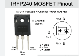

The red circled pins in post #29 from William are the 'Source' pins. ( FYI, I've attached the pinouts of the IRFP240; IRFP9240 has the same pinout as well. )
So keep one meter probe on a channel's positive output (doesn't really matter which probe; you can just screw it in the binding post). Use the other proble and measure the voltage at the Source pins of every IRFP240/IRFP9240 for that channel, and write them down. You will see some as positive and some negative. Don't worry about it. When you have done so, please report back.
you need to make amp Iq setting observing just one ( any of 6) source resistors
also, do not forget observing and setting output DC Offset (Vdc meter across speaker outputs)
when done, you can check voltages across all 6 source resistors (moving just red probe to each of 6 source pins, black probe staying at speaker output), to check how well mosfets are matched
Right channel bank:
left to right probe on the left leg of the mosfet I read 4.5 - 4.5 - 4.5 (dropping below 4.4 after a few minutes) on the following three I inverted the probes to keep the reading positive and have 1.10 - 1.06 - 0.92
Left channel bank:
here I have 0.71 - 0.75 - 0.76 and 4.4 and dropping on the other three
What am I doing wrong?
edit: putting probe on the right leg of all of the mosfets on the right channel bank I get very similar readings and all of them slowly dropping since I switched it on

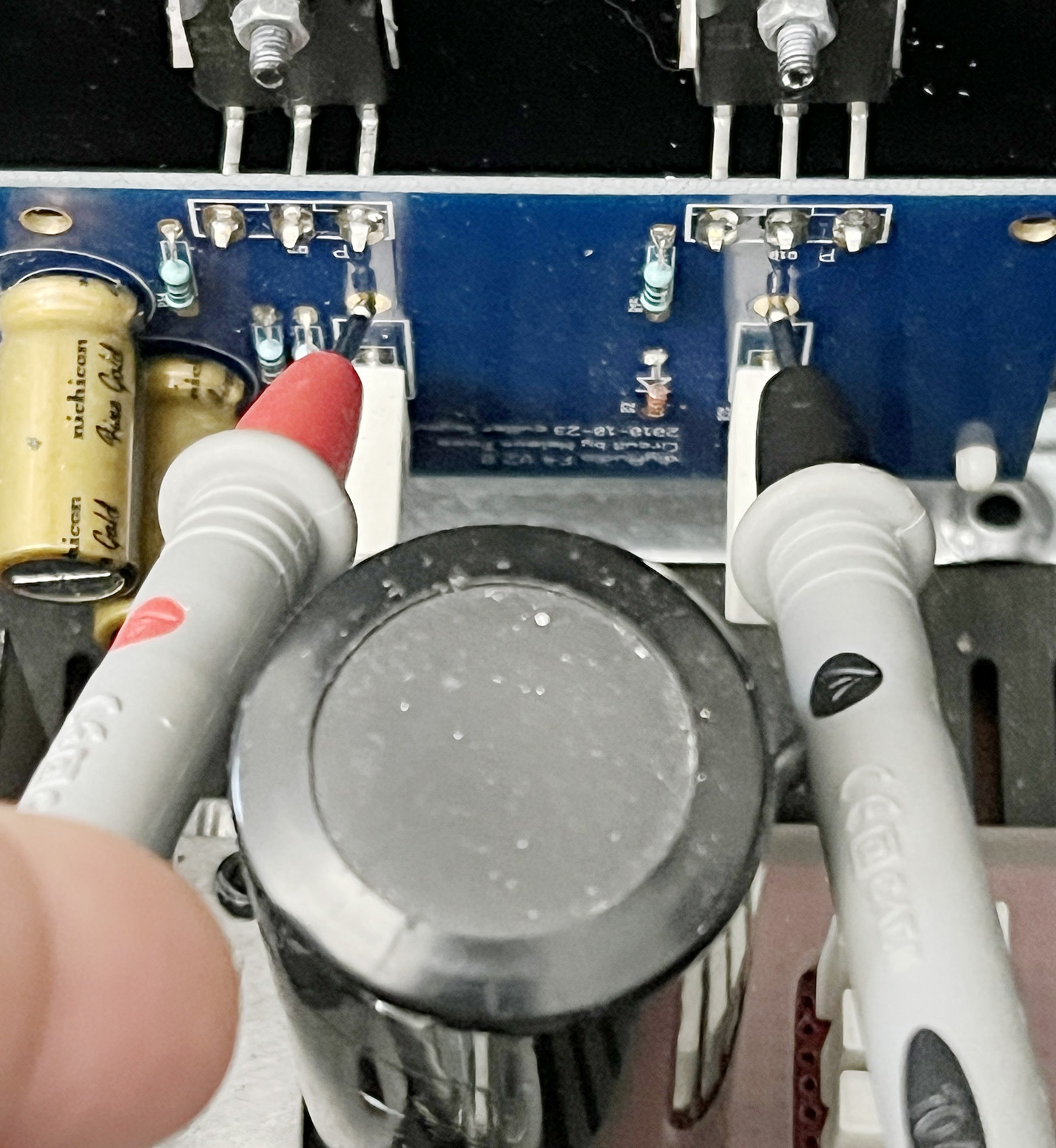

With probes on the speakers output and meter on 2v range I measure 0.13v
Something must be wrong with the DC offset, right channel being 8.5mV and left being 31.5mV 🙄
I should act on P2 to adjust the offset, is that correct? How do I do, clip the probes on the speakers output of each channel and turn unti, on the 200mV scale, I get down to where, the closest to 0mV as per above ZenMod suggestion?
I checked one bank of the amp, transistor source leg to speaker output and I get a range from 100mV to 124mV, DC offset being 7.6mV
I am following yours all instructions as well as on the first page of the building guide, sorry but I am no tech at all, I am just taking readings and going through trial and error not to say that English isn't really my mother tongue
OK, now we're getting somewhere. This amp is not biased properly. No wonder it doesn't sound great. As I mentioned before, use two voltmeters at the same time. Keep one on the speaker outputs to watch DC offset, adjust DC offset pot to get 0.0mV at the speaker terminals (some wiggle is OK) as needed while messing with the bias pot. Put the other voltmeter exactly as you did in post #38. Adjust bias pot to get ~200mV across one of those resistors, any one, it doesn't matter which. Now let it cook and watch the heatsink temperature. Be patient with it, this is a slow process.

now, look and read here : https://www.diyaudio.com/community/threads/f-4-boards.214003/
clip red probe to (any) source pin, black probe to speaker positive output
in small steps, rotate P1 and set to reding of 200mV on your DVM, when amp is hottest
do the same for other channell
then - with DVM across speaker terminals, small steps on P2, set output DC offset as close to 0mV you can
inputs shorted, no load on output
