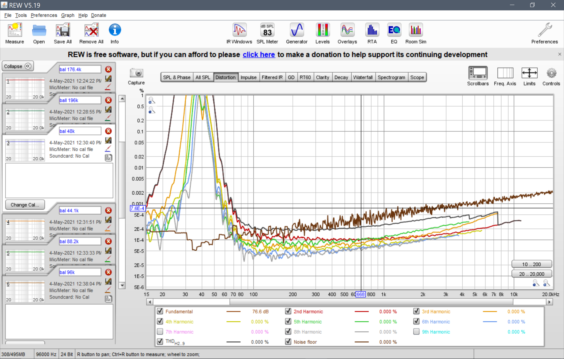

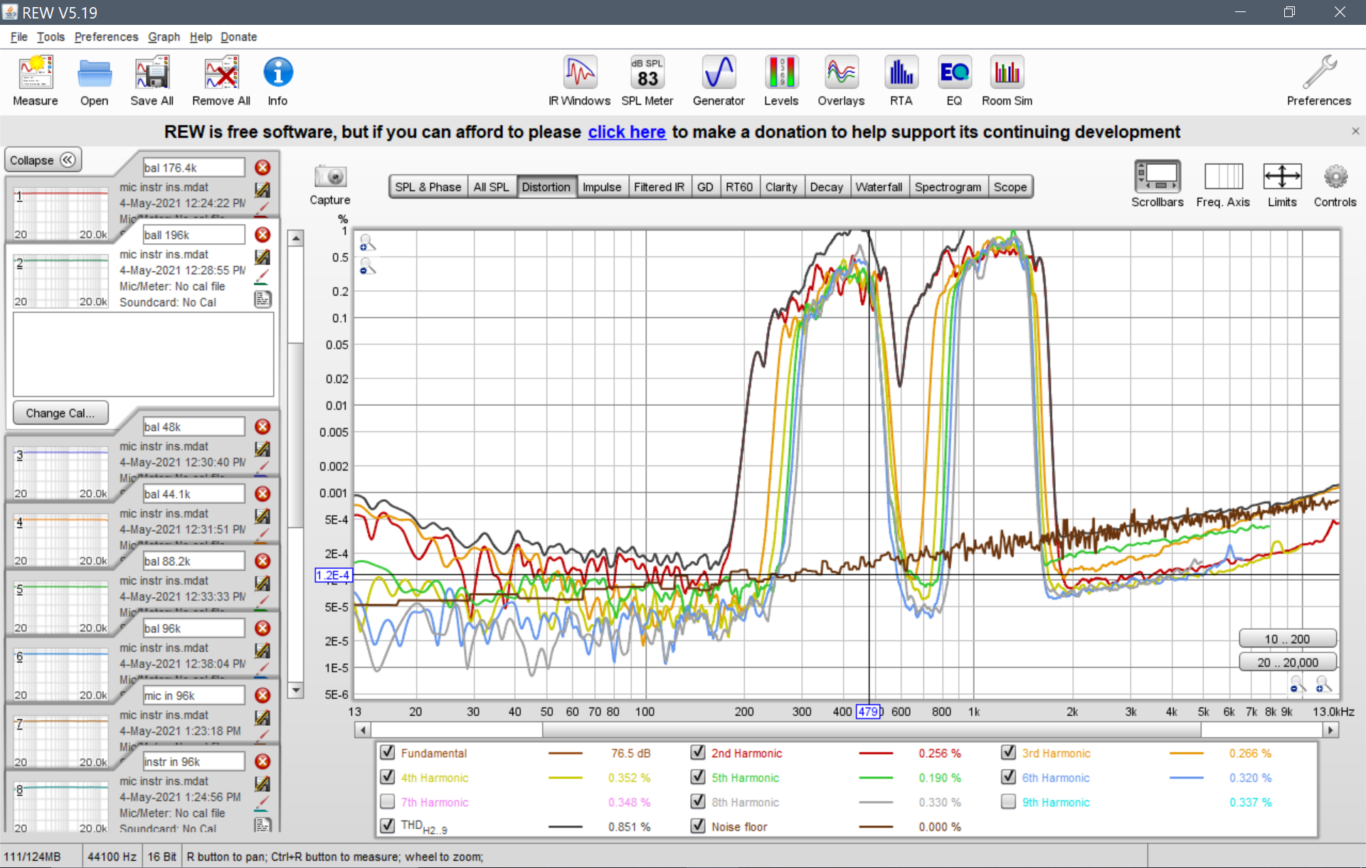

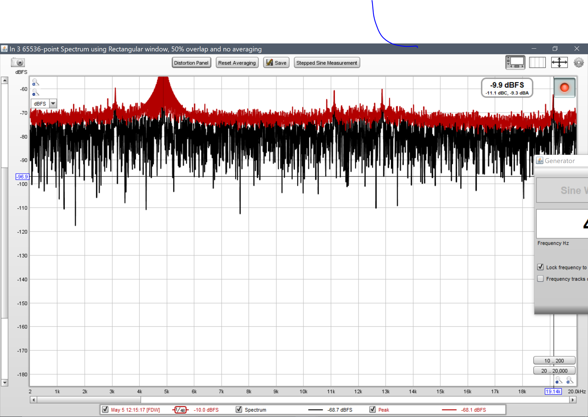

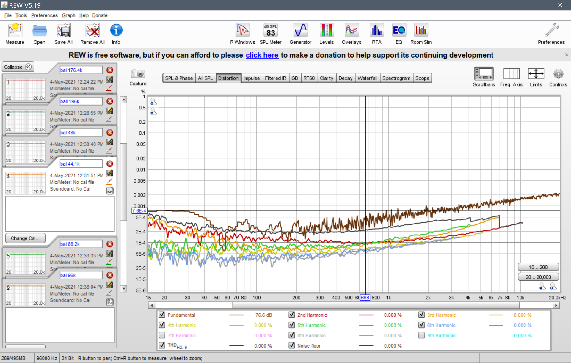

Just picked up a Motu M4 and REW and tried a loopback test of the M4. I'm getting weird results with some sample rates. I'm using the ASIO driver that came with the M4 and made sure the rates are the same in REW. The test at 44.1 looks right, whats with the other two? There 48k and 196k. 88.2k, 96k and 172.4k also look fine.

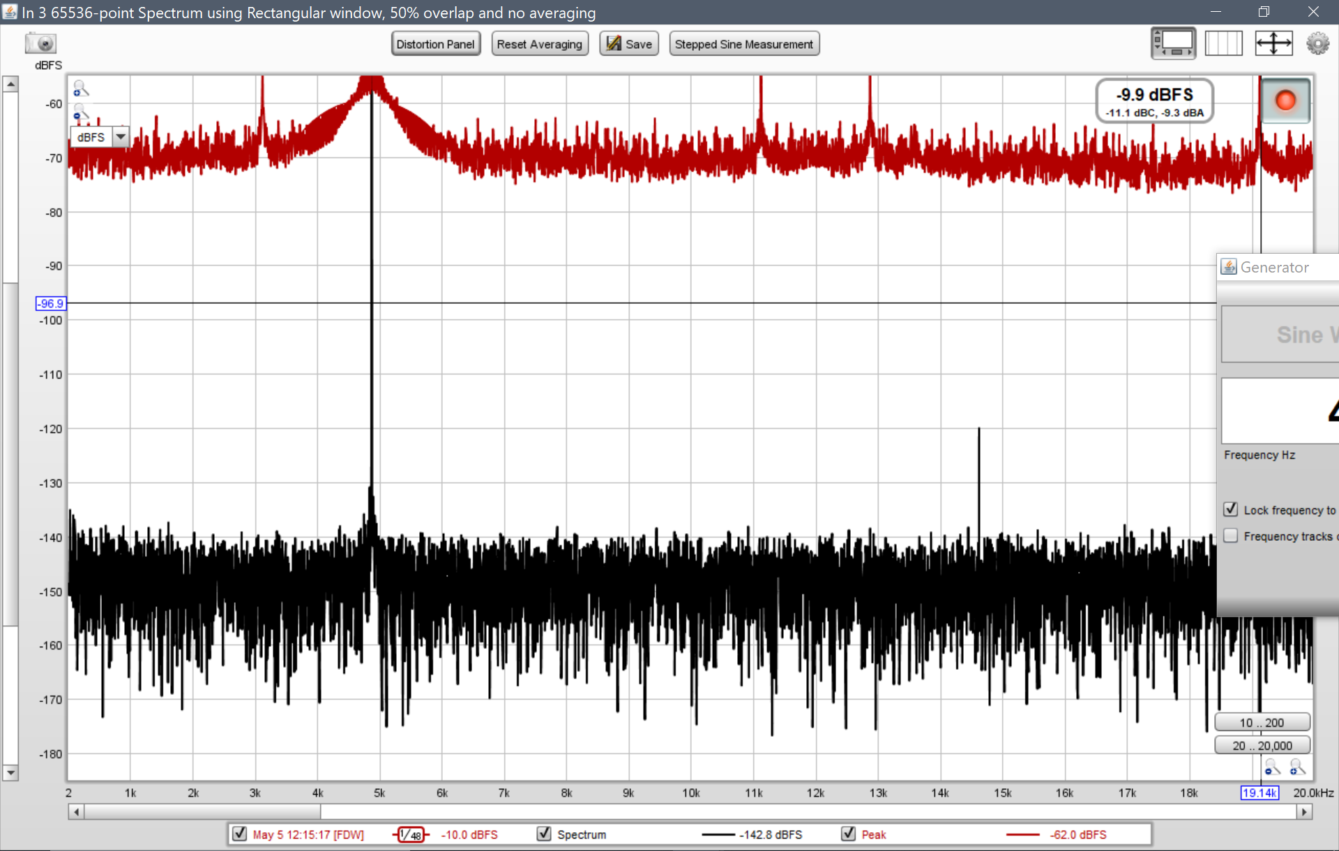

Changed buffer, no difference. But I did find a clue. When I use the RTA real time at the bad sample rates the noise floor/harmonics jumps 100db for a fraction of a second every second or so. This doesn't happen otherwise.
Try a basic test using default non-ASIO driver. If that works, then it might be some sort of interface issue.

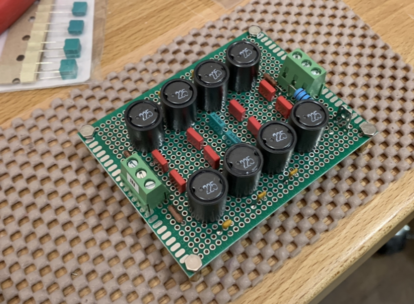

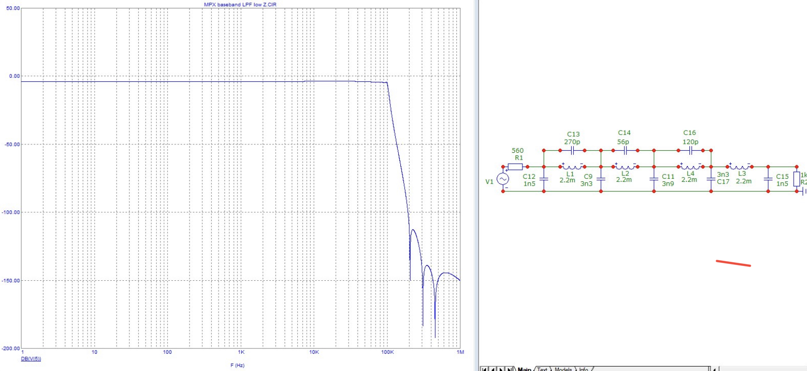

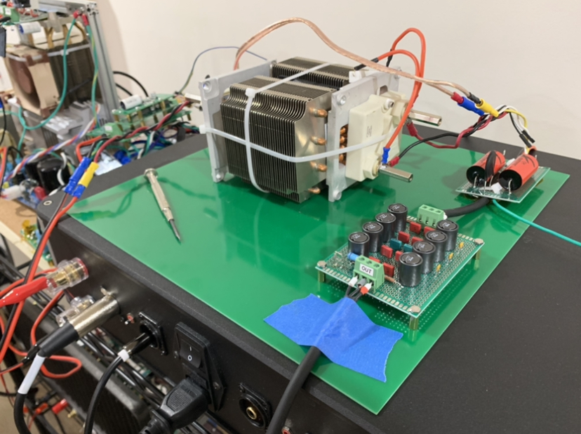

I built a very steep 100kHz low pass filter that was recommended by someone (I’ll have to dig through the forum to see who I got it from) in the Class D amp forum. It is supposed to have -130dB at 400kHz and is helpful to reduce any aliasing caused by HF PWM carrier frequencies used in Class D amps or SMPS. It helped to remove the hash I was seeing in my FFT spectra and dropped the noise floor by about 10dB (which I assume was there due to contamination from high speed switching stuff above 100kHz). The filter costs about $30 in parts for a balanced setup needed for BTL amps. Not hard to make and a worthwhile tool to add to your measurement toolbox.
Schematic and predicted transfer function:
attachment.php
Built using 5% film caps for nF values and 5% NP0 for pF values. Inductors are shielded CoilCraft rated for 300mA so should be good:
attachment.php
In action measuring a 350w Class D GaN amp:
attachment.php

You want to use bulk metal resistors - they are non inductive and make a huge difference. The gold metal shells ones add distortion. The wire wound ceramics do as well.
The best ones are made by EBG. You can get used UXP-300 for about $15 on eBay. Not sure how much new but probably pricey. These are 300w 10ohm designed to be used with a heatsink like a CPU cooler or large aluminum plate.
For example:
QTY:10, EBG (VISHAY) UXP/300 10RK 10 OHM/10OHM 300W FOIL NON-IND.POWER RESISTOR | eBay
Another way is the series parallel quality 1W metal thin film resistors. You can make circa 25W dummy loads this way 5x5 8ohm config for example. Avoid metal oxide as they are distortion generators as well.
The worst ones are the huge 6in long 100w wirewound heater element style coated with green ceramic.
Just changing to EBG UXP-300 resistors and using a balanced input on my Focusrite with quality MKP caps cleaned up the measurements quite a bit.
