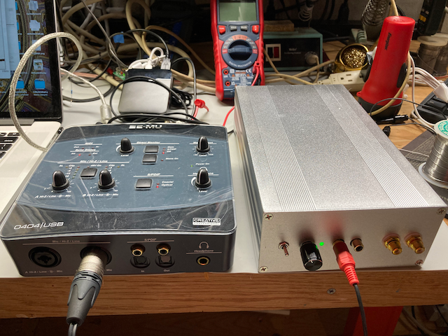

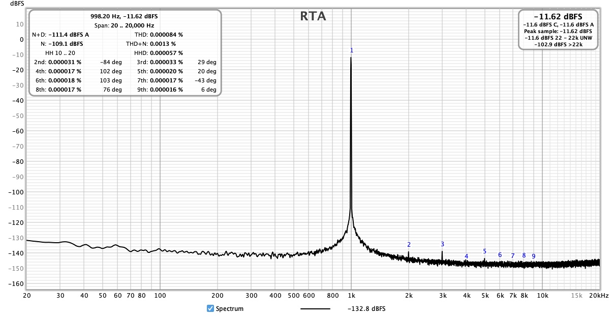

I am just getting back to messing around with REW using my old EMU 0404 USB. I got one of Victors oscillators (latest version) and put it in an aluminum box. Power comes from 4 Lithium 9volt batteries (actually about 8.4 volts each). So far I have only tried a quick and dirty REW run with the oscillator directly feeding the EMU, but the results look promising.
The EMU was running off a 5 volt USB battery pack and my Macbook was running on battery as well. The version of REW is the latest for MacOS.
With the oscillator output at -11.6 dB (about .5volts RMS) feeding the XLR input (with one side grounded), I am seeing 0.000084% THD and 0.0013 THD+N. The noise is a function of the EMU A/D paths and would require some mods to get it lower (and some shielding inside the box).
This is definitely an improvement over using the EMU to output a sine wave, so I can recommend Victors oscillator to anyone trying to get a pure signal.

The Generator 'Tones' button has the Sine button selection which includes an "add harmonic distortion" tick box, which brings up a new selection Distortion Controls box for adding in harmonic levels/phases that can be used to suppress the measured distortion. This can be used not only to suppress the soundcard THD, but also to suppress an external devices THD (eg. by including say an amp in the loopback) - which is great for making your own very low distortion THD test oscillator.
Have you tried the Emu in loopback with the sinewave preadjusted to suppress measured harmonics?
That's an interesting technique. I may give it a go. However, I do like the simple approach of using a sine as pure as possible for the DUT from a separate oscillator. As I mentioned the noise of the EMU A/D swamps distortion at these levels, and I can't think of a way to null the noise out. At this point, maybe a custom A/D converter with modern parts.

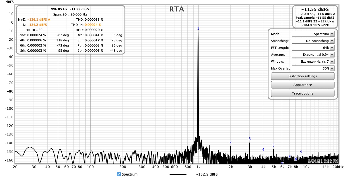

Coherent averaging will drop the noise floor to reveal the harmonics.
Well, as they say, RTFM. :)
With coherent averaging turned on, THD is now showing 0.000055% (predominantly 2nd and 3rd H) and THD+N is down to 0.00024%! The EMU input LEDs are showing -12dB.
Since this is less than 1 PPM, I'd say I'd be hard-pressed to improve much further with Victors oscillator and the EMU 0404(without mods). Maybe better cables and shielding would help too.

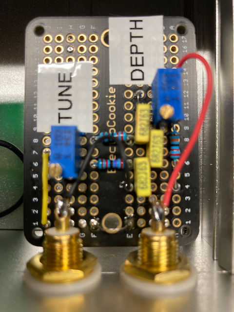

I decided to add a passive notch filter to the box with Victors oscillator. This is a very simple Hall-type network documented in this article by Kenneth Kuhn. The two pots allow it to be tuned to the oscillator and get the best notch depth possible. I am sure the "Q" of this thing is not great, but it will give me a basis for experimenting.
I assembled the filter on a small perf board and mounted it directly on isolated RCA panel jacks. I matched the caps to within about 0.2% by selecting components. The resistors are metal film and the pots are cermet. The notch is completely independent of the oscillator and can be hooked in or not. A preliminary test with REW indicated I could get about -74dB fundamental suppression. Better results could be obtained with an active Hall circuit, but adding active devices would increase THD+Noise. Even the types of capacitors and resistors used can influence distortion.
There is a good website here describing how to use a notch filter for making distortion measurements.
It would be better to build this with BNC connectors, which are typically used for low noise measurement equipment, but I did not have any handy. I may upgrade the whole thing (including Victors board) to BNC at some point.

Coherent averaging by principle reduces noise, therefore the noise-related figures in the chart are correctly marked with a different color. IMO they are irrelevant in this mode.
The question is why also the distortions drop in most cases. IMO the reason is their phase fluctuates against the fundamental a bit, reducing thus their vector average magnitude. That is why I wonder if the vector-averaged THD at these tiny fluctuating distortions is relevant.
I have made many measurements with EMU 0404 USB. I am surprised your ADC part is capable of this tiny distortion. My split-side measurements show the harmonics at -10.3dB fundamental seriously higher https://www.diyaudio.com/forums/equ...nsation-measurement-setup-40.html#post6507785. E.g. H2 at -129 - (-10.3) = -118dBr, H3 at about the same. The splitting method has been confirmed to yield correct values by several independent experiments, therefore I trust the distortion magnitudes measured on my ADC side.
I still wonder if the lower frequency stability of an analog oscillator can have some effect on the distortions as measured by REW. John, please may I ask you to shed more light on this? Thanks a lot.
I agree that averaging the noise is a bit artificial. As John mentions, its function is to reveal harmonics that might otherwise be buried in the hash. Perhaps the phase noise of the oscillator is responsible for the THD reduction when using coherent averaging - maybe John can provide insight as to how that might be measured with REW.
