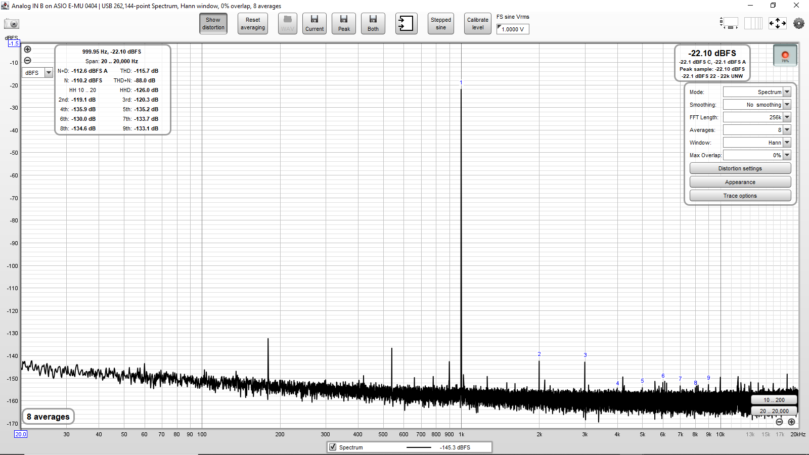

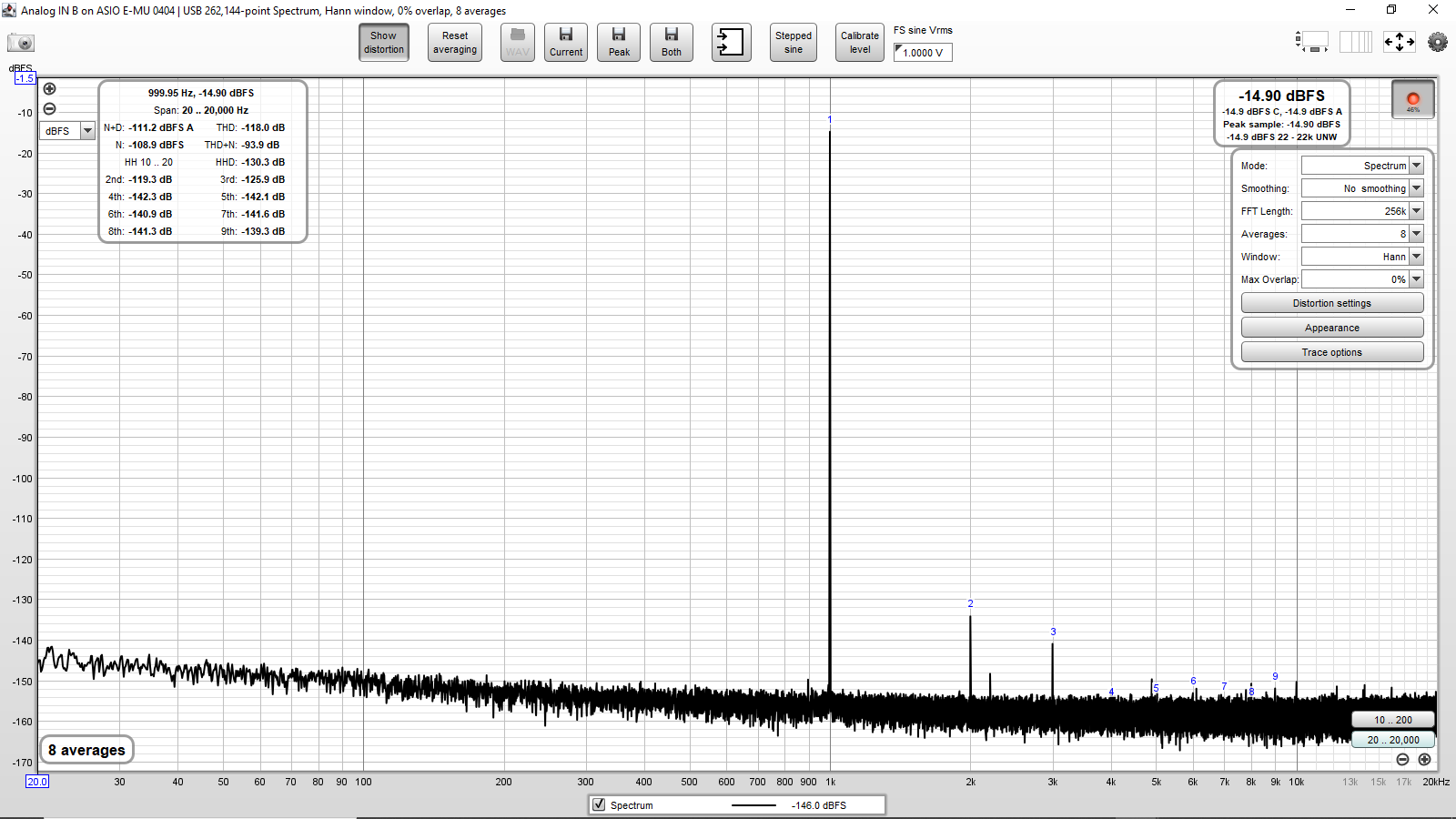

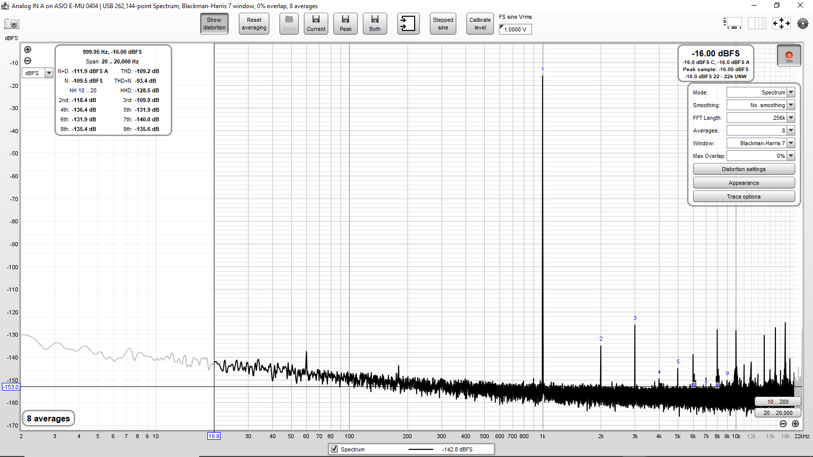

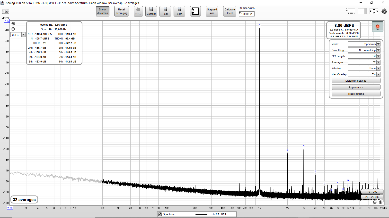

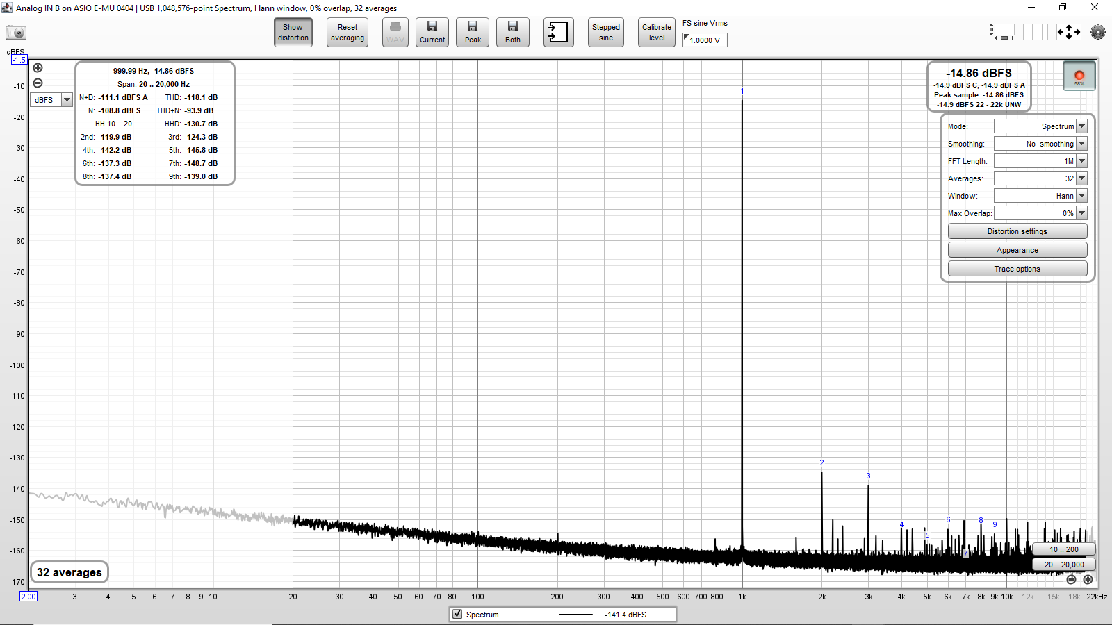

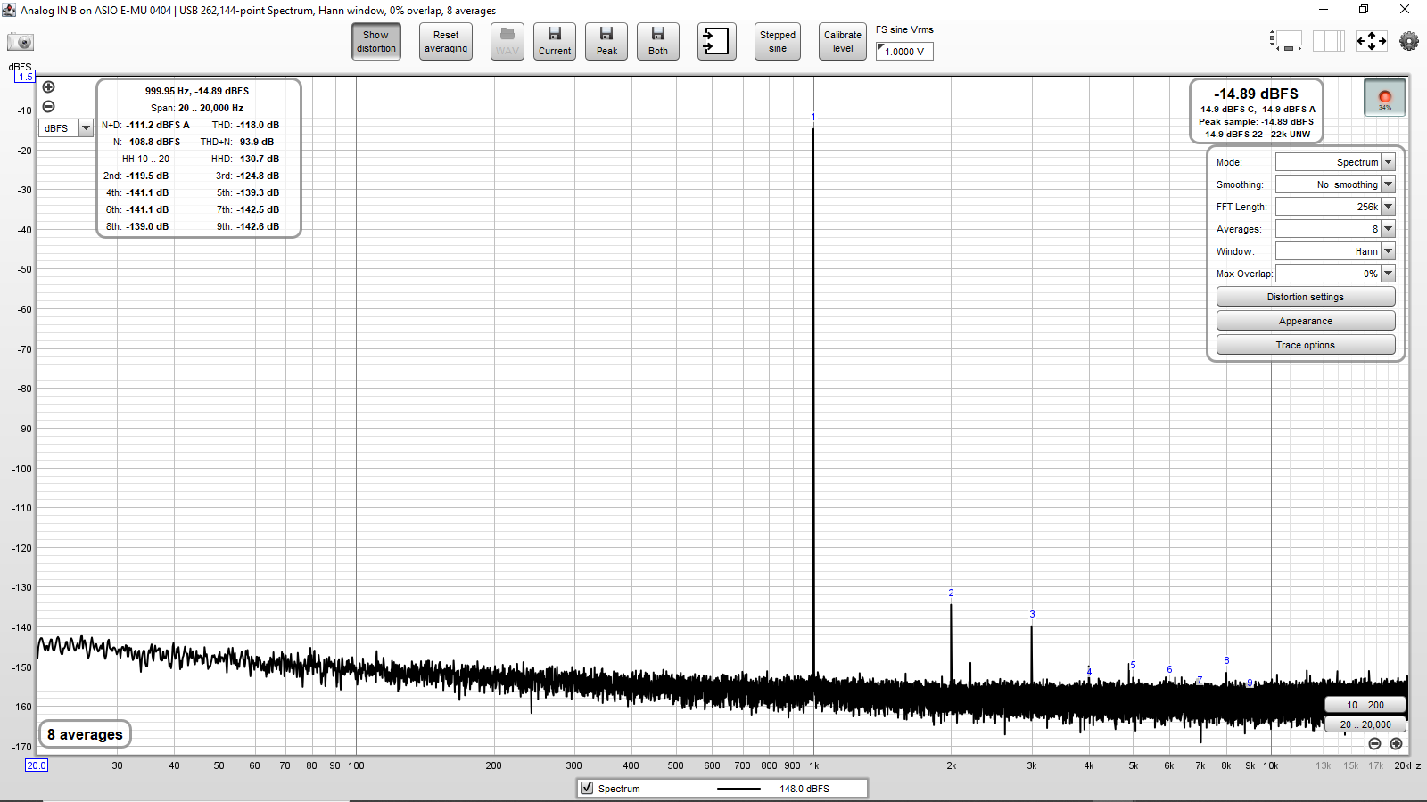

Well my E-MU 0404 USB arrived and I have attached balanced and single ended loop backs. I have noticed input B is a little better than input A. In case anyone is wondering if you search for 64-bit Windows 7 beta driver you can download version 1.40 beta driver from Creative and that installed and worked totally smoothly with latest Windows 10 64-bit.
The 0404 arrived with the original Creative 5V adapter so I have used that so far. The spectrum looks pretty nice, even single ended. I was thinking that 4xNiMH AA would be the right voltage and I have a 4xAA battery box. That should work without problems, right? (I have 2x18650 and LT1083 so I could also use that for 5V battery power.)

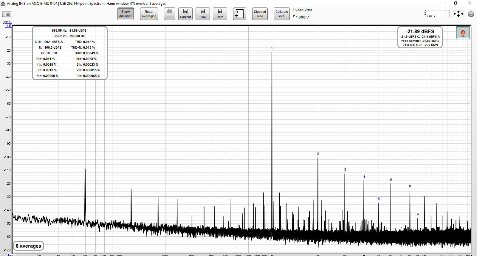

Next I will try remeasuring the uPC1342V amplifier with the E-MU 0404 and the balanced attenuator.
Attached (in order) is:
- Balanced right main output to TRS input B
- Single ended left main output to TRS input A
- Single ended left main output to TRS input B

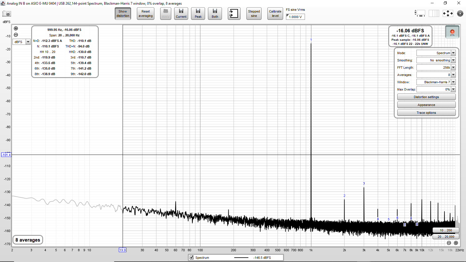

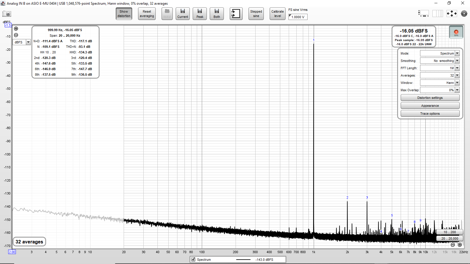

Today I made a TRS to XLR cable and measured the E-MU 0404 USB TRS to TRS and TRS to XLR. I noticed that the 3rd harmonic was the biggest improvement when bypassing the 5532. The levels also go up a bit.
Attached in order:
- TRS (L Out) to TRS (B Input) -10 dBFS input level
- TRS (L Out) to XLR (B Input) at the same output/generator level as above.
- TRS (L Out) to TRS (B Input) -16 dBFS input level

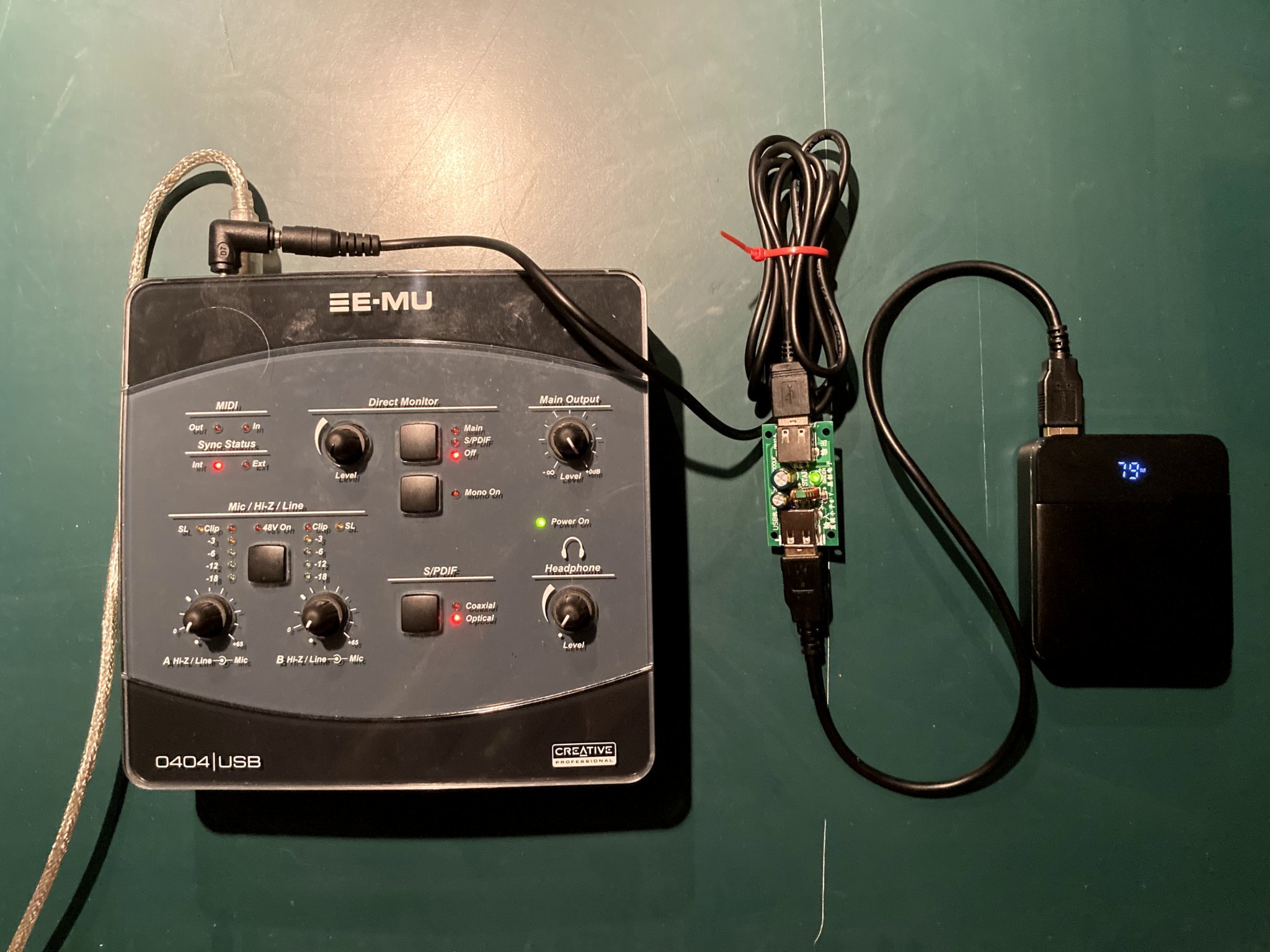

I have been using one of those lithium power packs intended for powering cell phones via USB. I got an adapter cable and plug to go from the USB output into the 5-volt input of the EMU (I think from Amazon). Seems to work fine and runs the EMU for several hours. No ground loops or mains hum. Since some of those battery units have buck/boost converters, I also use a small USB noise filter in between - it has a small common mode choke and some filter caps, but I am not sure it is even necessary.

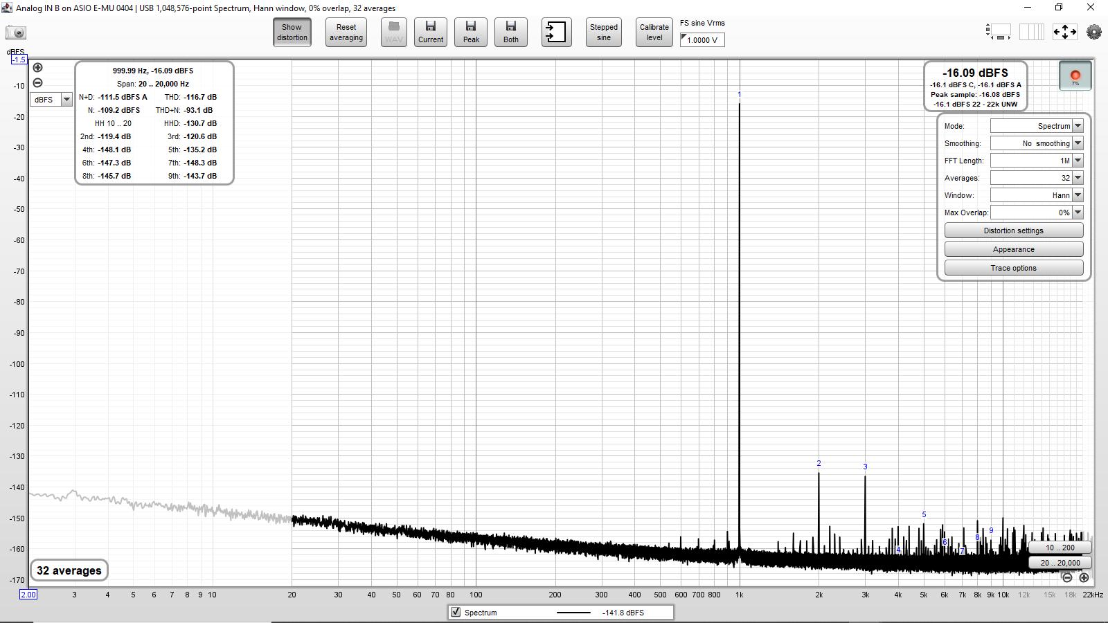

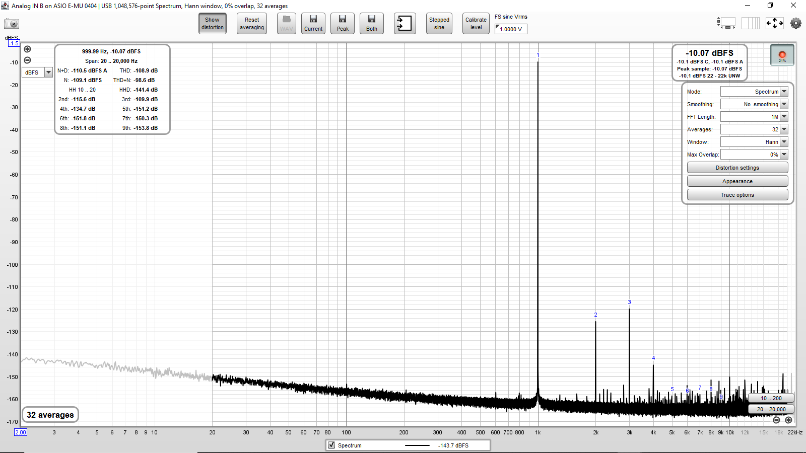

I used a similar battery pack to measure the loopback on the E-MU 0404 USB with the original Creative power adapter versus battery. Loopback alone is very close to identical. However in the next post I will show the difference when measuring an amplifier.
In this post in order there are:
- Left TS Output to B TS Input with original Creative power adapter.
- Left TS Output to B TS Input with battery pack.
- Left TRS Output to B XLR Input with original Creative power adapter.
- Left TRS Output to B XLR Input with battery pack.

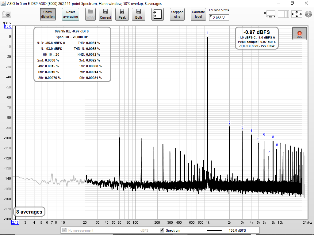

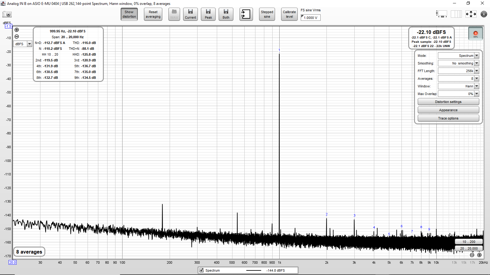

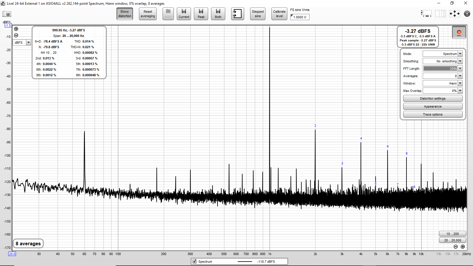

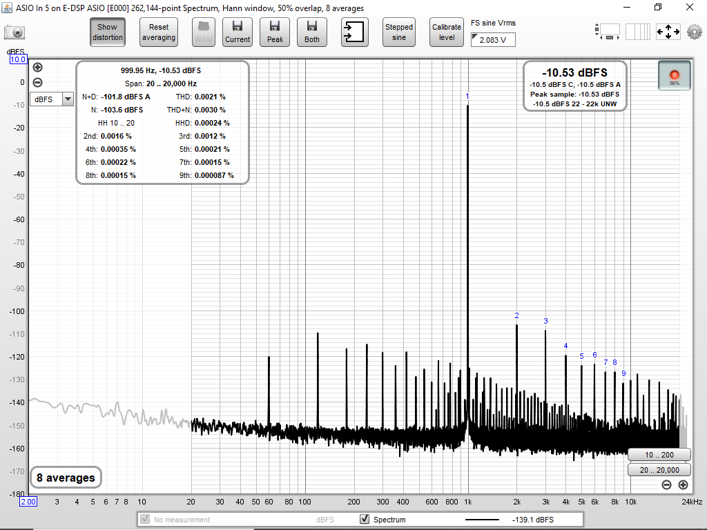

In this post I am measuring a uPC1342V based power amplifier with the E-MU 0404 USB. The degradation when using the original Creative power adapter with the 0404 is clear compared to the battery pack.
In other words don't use that adapter. Use battery power if possible. Later I might try hooking up a linear regulator but the USB battery pack works well.
- E-MU 0404 USB with original Creative power adapter (wall switcher)
- E-MU 0404 USB with original battery pack
- SB0490 (Sound Blaster Live! 24-Bit USB External, USB power)
8 Vrms Original Creative Adapter Measure Across Load and Load Is From Designed Terminals.png192.7 KB · Views: 157
8 Vrms Battery Power Measure Across Load and Load Is From Designed Terminals.png144.6 KB · Views: 145
8 Vrms SB0490 Measure Across Load and Load Is From Designed Terminals.png170.3 KB · Views: 140

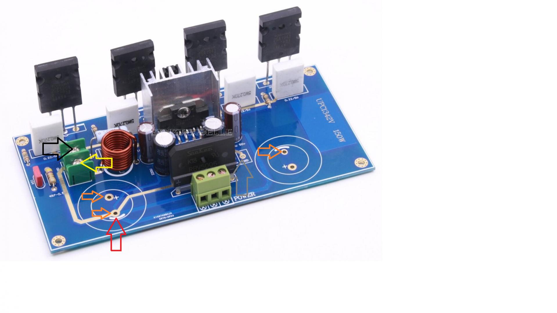

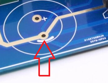

Good progress there. Looks like your amp power supply could use more filtering; lots of 60 Hz harmonics - or there is a ground loop somewhere. Are you using a star ground inside the amp?

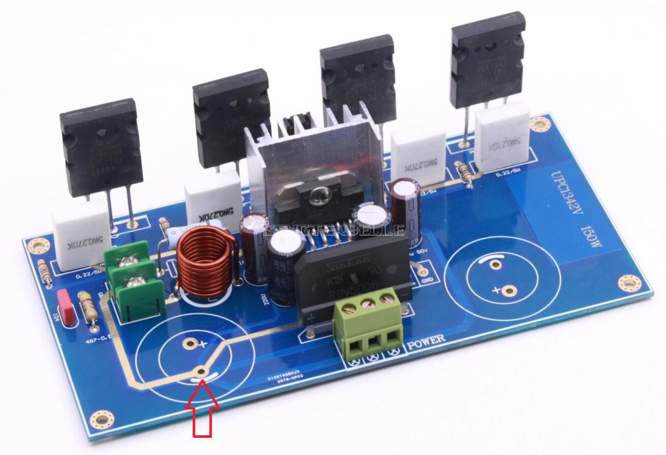

The PCB for this uPC1342V amplifier has a star ground formed by a number of different traces which emerge from the thru hole for one of the two main filter capacitors. I have attached a picture showing this.
Any suggestions on improving it?

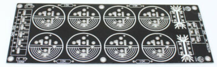

There is 2x4,700uF on the uPC1342V board and then 8x4,700uF on the rectifier board. (A picture of the bare board is attached.)

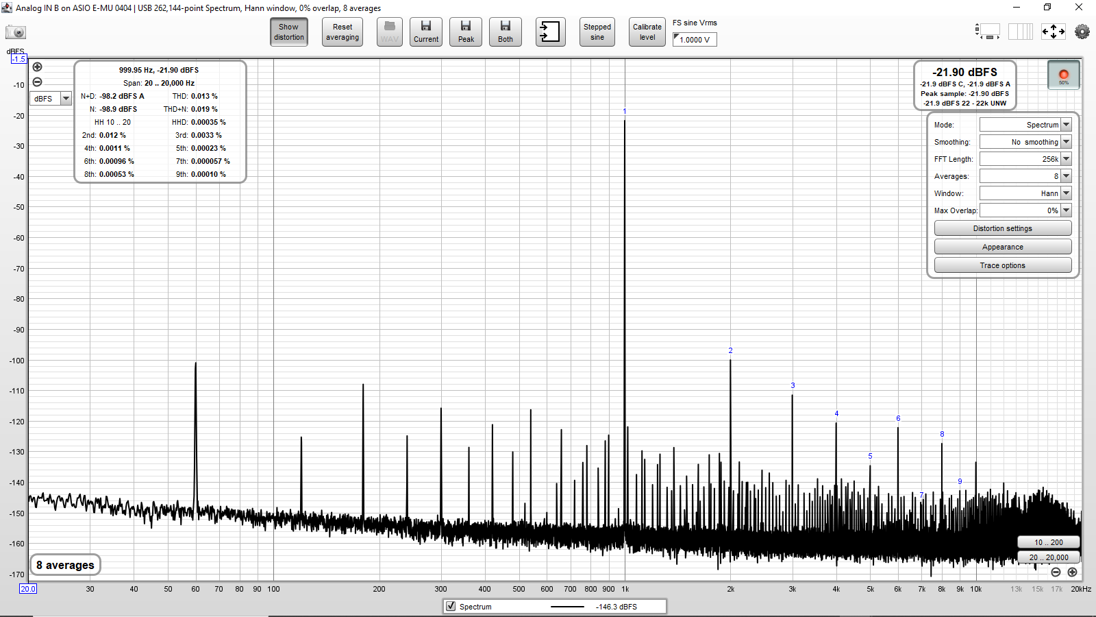

As a comparison the attached are in the same chassis with the same wiring and same power supply.
The first is an MX50X2 and the second is a QUAD405-2 modified (gain, current source and OPA228). These measurements are made by a desktop using an E-MU 1820m microdock attached to an E-MU 1010 PCI card. (Mains powered desktop.) These measurements were done before I bought the E-MU 0404 USB and before I built the balanced attenuator.

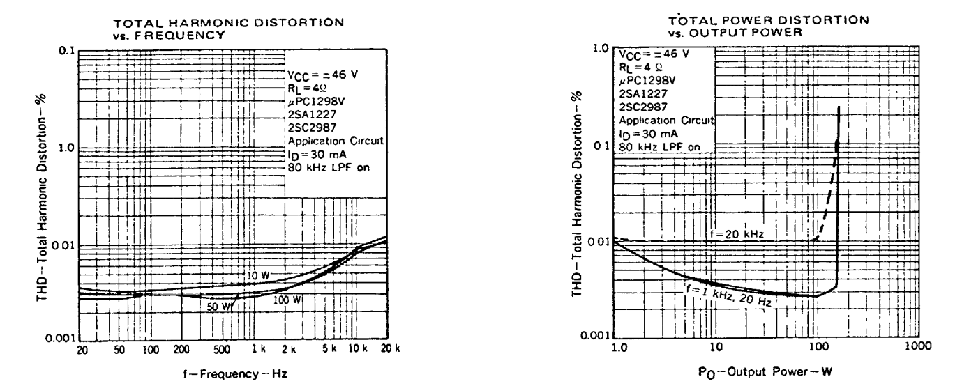

I am mystified as to why the uPC1342V measures so badly relatively speaking (THD, 2nd harmonic).

Previously the ground of the output side of the power rectifier board was connected to the chassis. I temporarily removed that as an experiment. Current (attached) results are with that ground removed temporarily. Later it will be attached again, perhaps with a 25A bridge, 10 Ohm and 100nF as per ESP.
The power rectifier and filter board connects to the pictured uPC1342V board via three twisted 16 AWG Remington Industries tinned stranded copper wires which are soldered to the –ve terminal of the amplifier board negative filter cap, the star ground "integrated in the amplifier PCB layout" pictured in the attached picture (red arrow) and the +ve terminal of the positive filter cap. (Soldered under the board, three orange arrows on the attached picture.) The amplifier board filter capacitors are 4700uF Samyoung rescued/recycled from stereo amplifiers.
The output is taken at the yellow arrow shown on the attached picture of the uPC1342V board. I have experimented with two return paths. First to the black arrow on the attached picture of the uPC1342V board. (That is what the PCB designer intended.) Second to the ground on the output side of the power rectifier board (seems to be better). Both configurations produce about 4x the expected 2nd harmonic relative to the datasheet.
