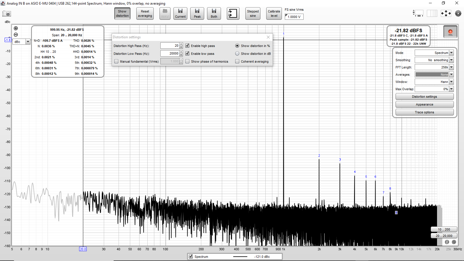

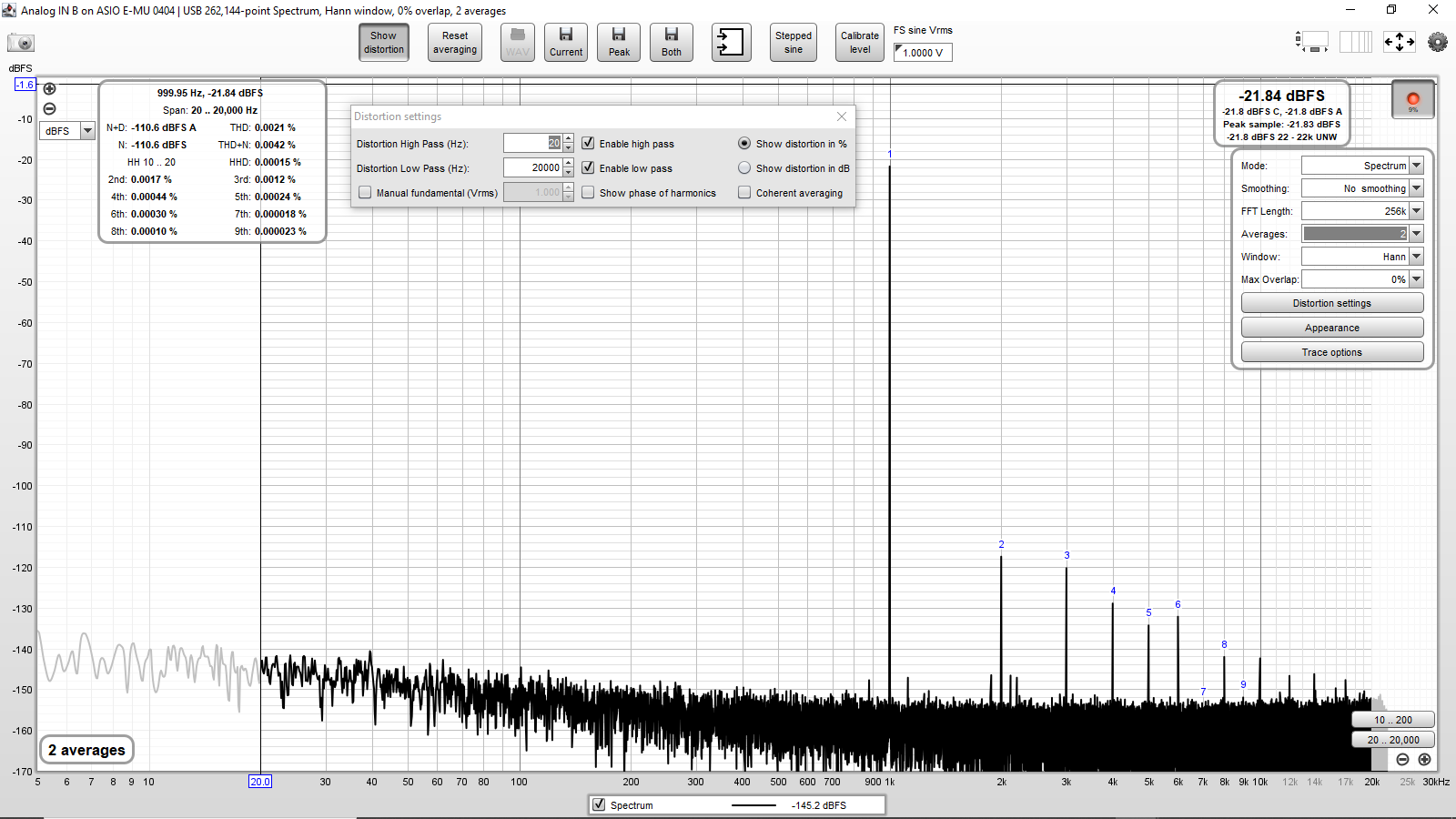

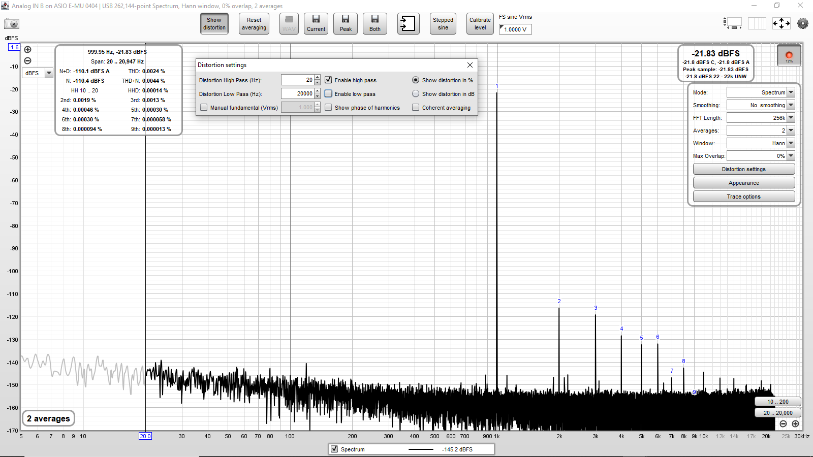

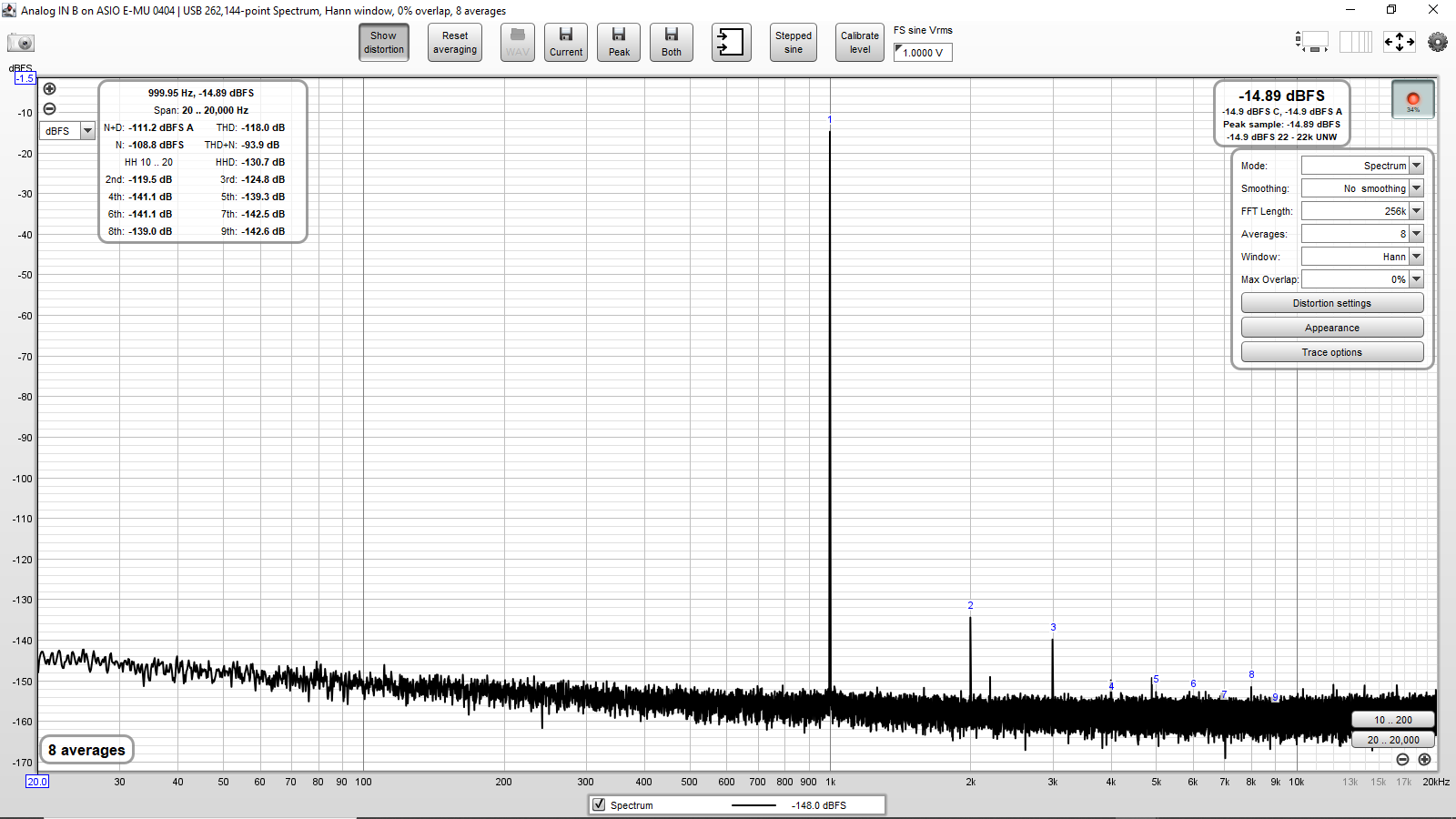

Kozard, I note that your plot shows noise content is circa -30dB below H2 level, but the results box displays N as -110dBFS. Perhaps an issue for you is related to units and what units you have chosen. There could also be a bandwidth issue. Could be worth playing around with settings.
What setting would you suggest looking at? Nothing jumped out at me in the distortion settings menu or the preferences.
The results box says -110 dBFS and the graph shows noise at -140 to -150 dBFS. It seems odd since both are dBFS. It should line up since they are both the same units?
Perhaps change every setting you can see (eg. in the graph controls panel - top right icon - including all the subsettings like coherent averaging - and read the help on each, as a learning curve). Once you have a fair handle on what changes occur and why, then perhaps post over on the REW forum showing what you are getting and what values you don't understand why you are getting. The outcome could be a variety of reasons, such as an unknown setting is not appropriate, or you didn't appreciate a particular setting's consequence, or there is a bug, or ......

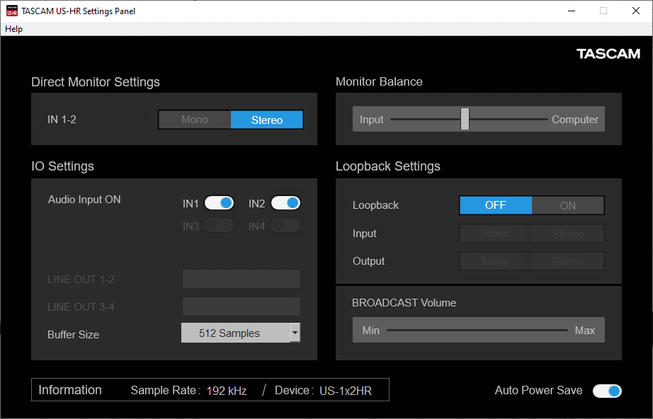

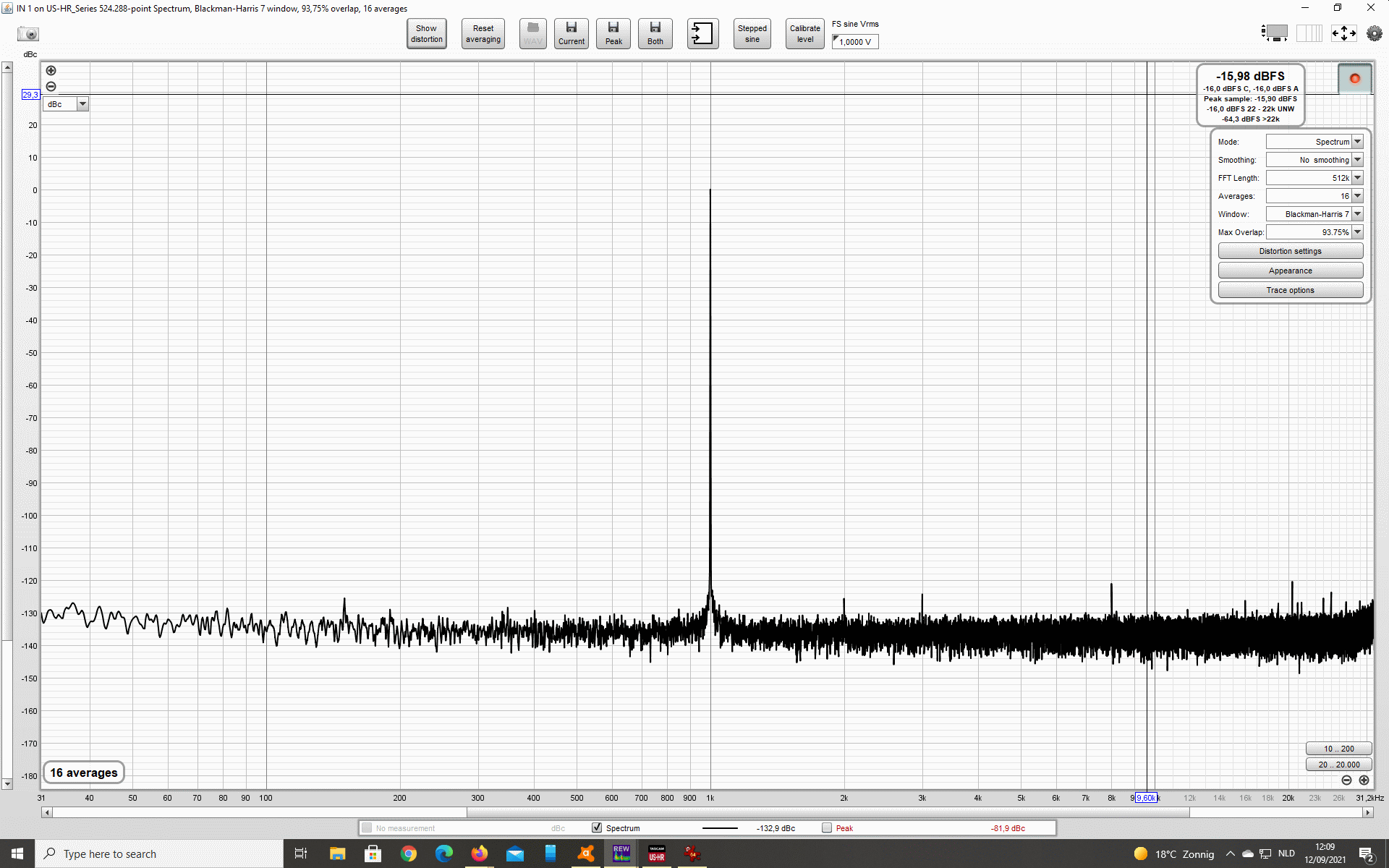

In my previous measurements of the Tascam US-1x2HR I used the internal loopback.
Here are the measurements with an external loopback (RCA out connected to RCA in).
Best results I got is with ASIO 192k, REW generator -10db, Tascam Line out volume at 2 o'clock.
The N (noise and non-harmonic distortion) figure is the sum across the bandwidth, either as a ratio if the Y axis units are set to dBc or as a level in the current Y axis units.The results box says -110 dBFS and the graph shows noise at -140 to -150 dBFS. It seems odd since both are dBFS. It should line up since they are both the same units?
Yes, but in the attached RTA screen shot how can the sum add up to -110 dBFS?The N (noise and non-harmonic distortion) figure is the sum across the bandwidth, either as a ratio if the Y axis units are set to dBc or as a level in the current Y axis units.

There are a lot of FFT bins in that 20 kHz span, they soon add up.Yes, but in the attached RTA screen shot how can the sum add up to -110 dBFS?
I guess that is the answer. I guess it just integrates up to such a large number, especially with the LF (higher noise) integrated in.
It just seems very odd at first glance to look at noise at -150 dBFS and see -110 dBFS for noise.

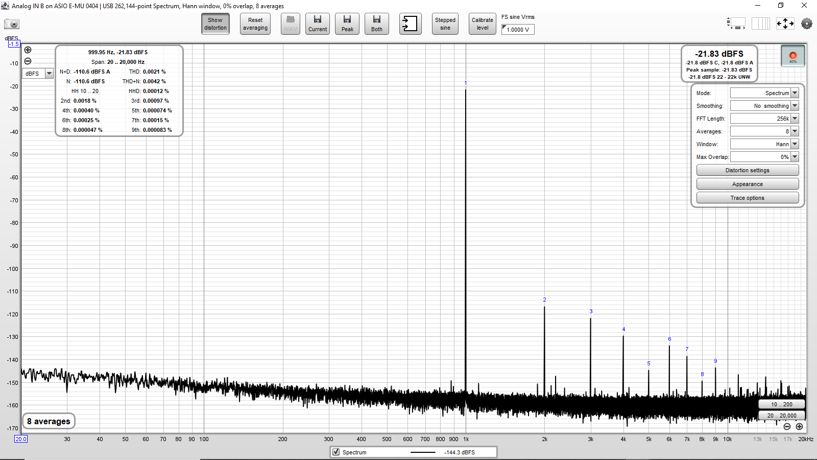

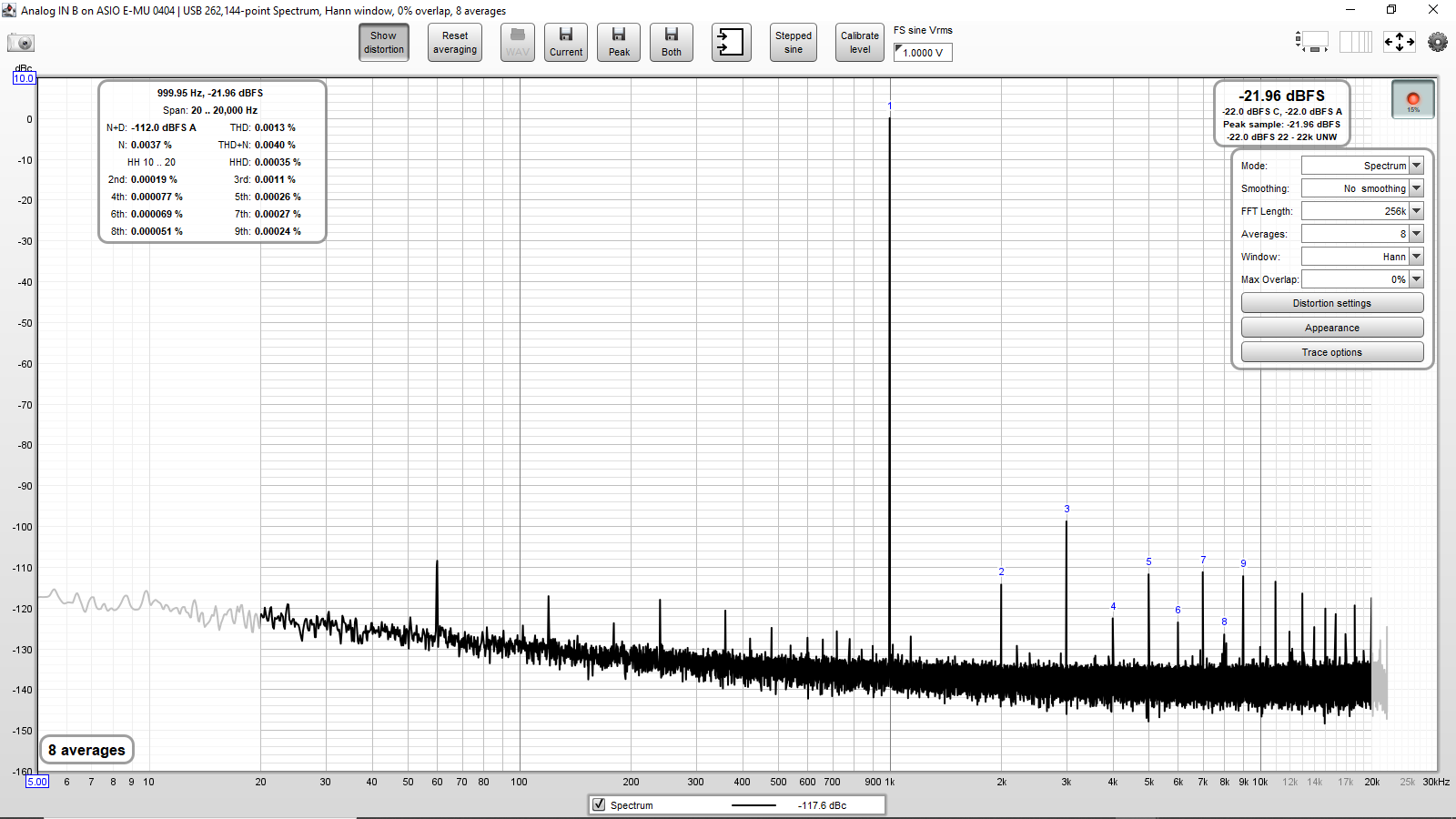

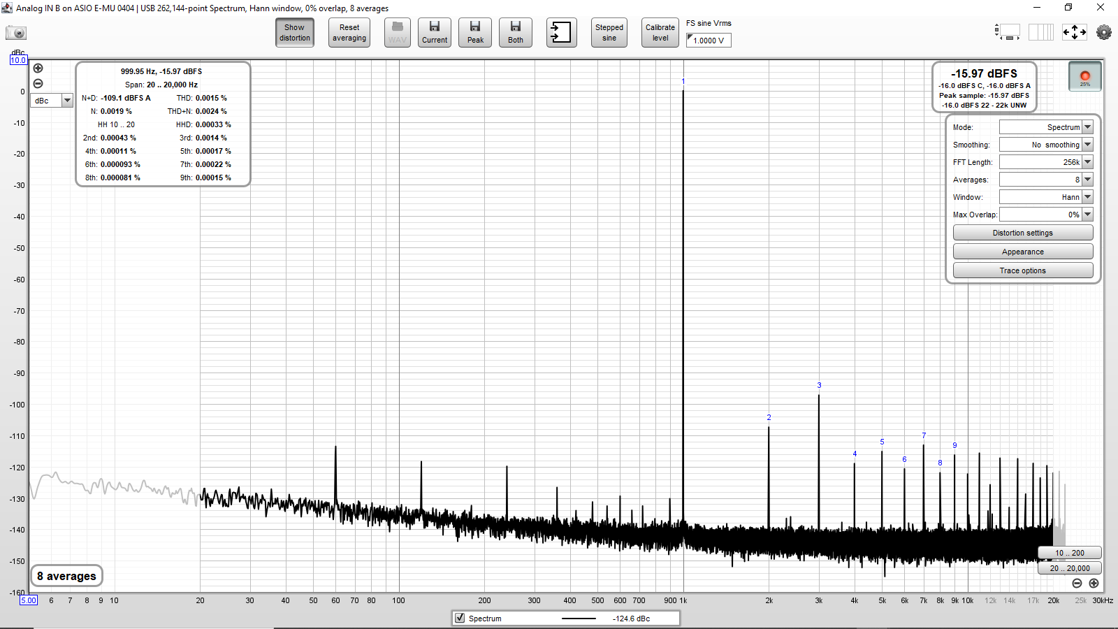

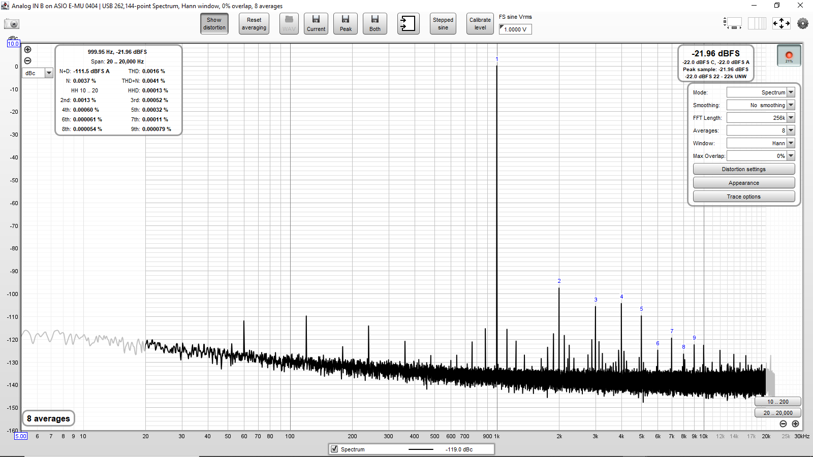

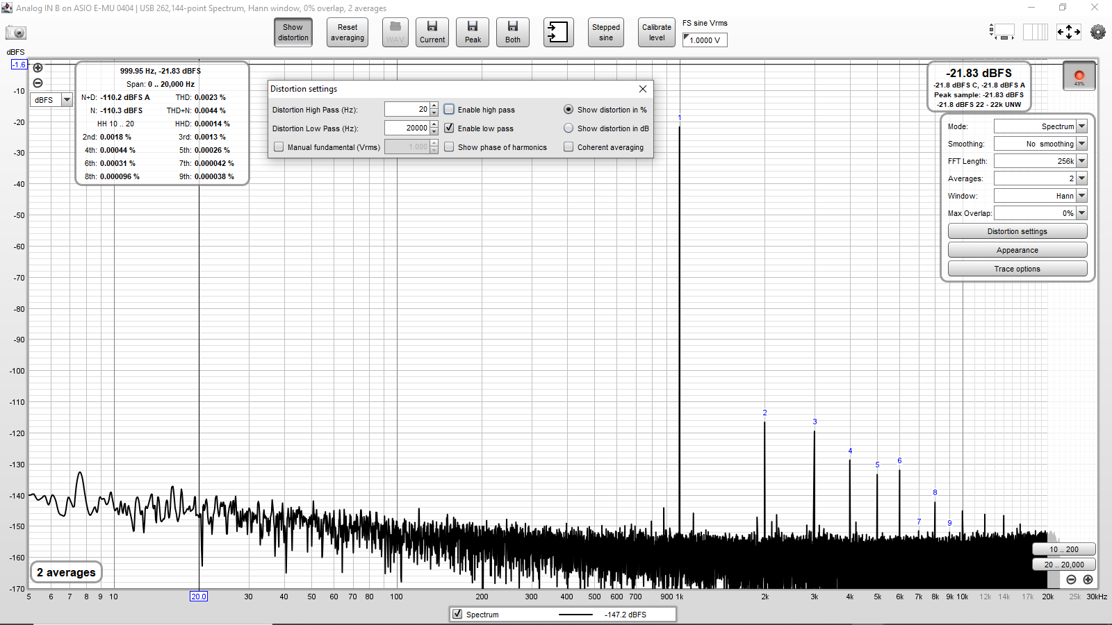

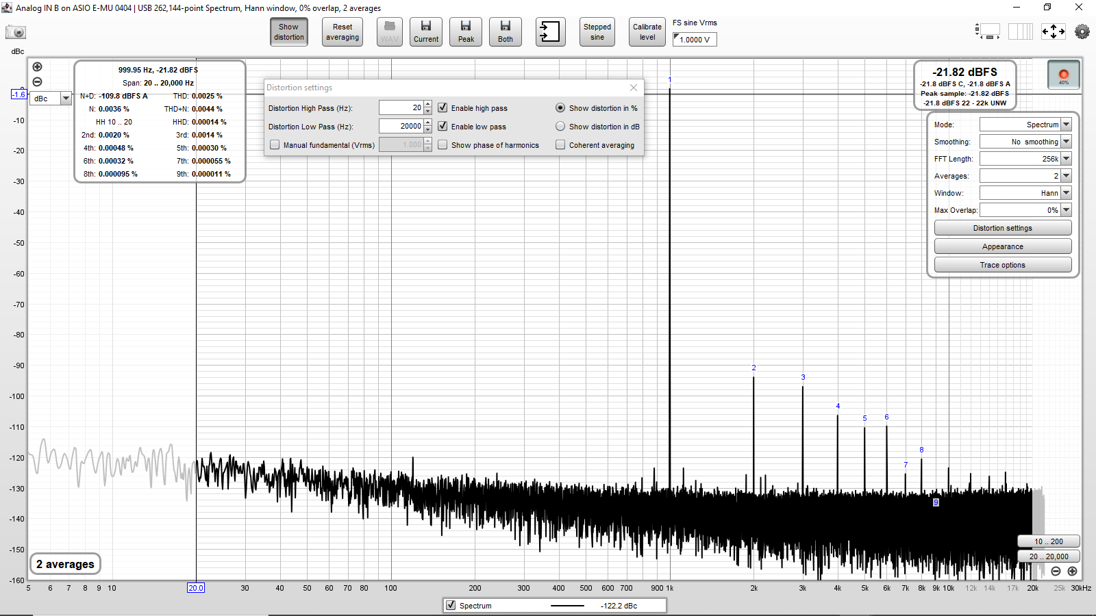

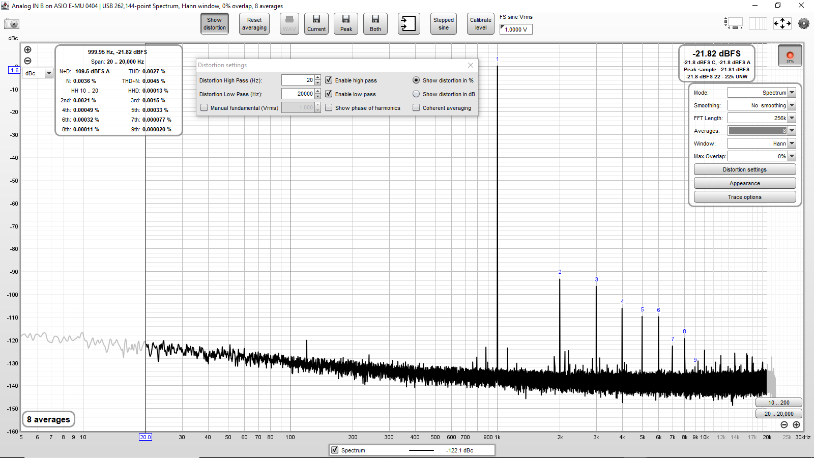

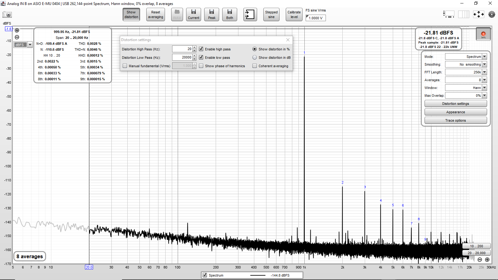

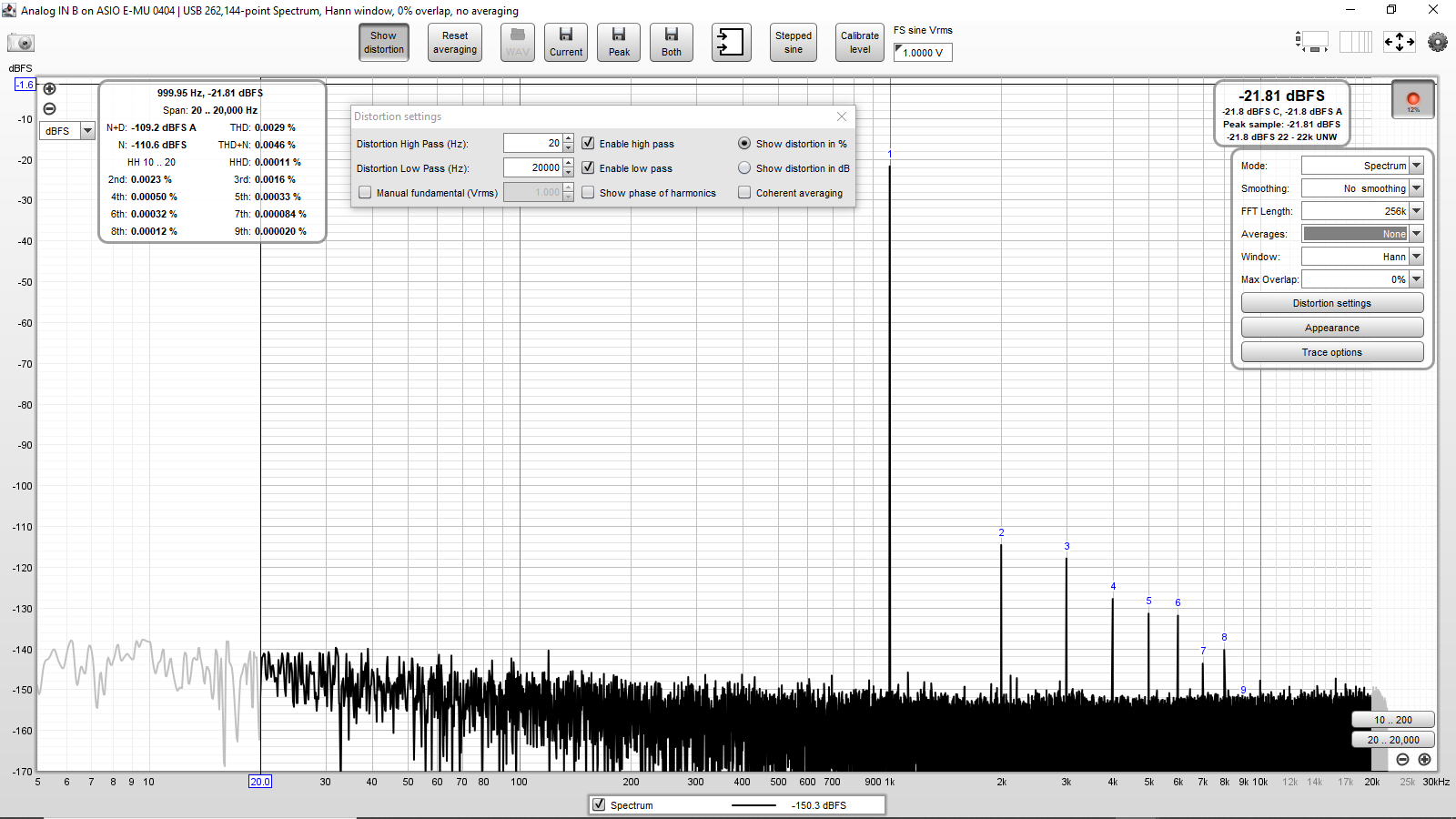

I did the following (attached) experiments with the distortion (HP high pass/LP low pass) and units (dBFS and dBc):
I also changed the display from 20 to 20k to 5 to 30k to show that there was nothing else of interest beyond the displayed bandwidth.
- Units dBFS, LP On - 20kHz, HP On - 20Hz, No Averages
- Units dBFS, LP On - 20kHz, HP On - 20Hz, 8 Averages
- Units dBc, LP On - 20kHz, HP On - 20Hz, 8 Averages
- Units dBc, LP On - 20kHz, HP On - 20Hz, No Averages
- Units dBc, LP On - 20kHz, HP On - 20Hz, 2 Averages
- Units dBFS, LP Off - 20kHz, HP On - 20Hz, 8 Averages
- Units dBFS, LP On - 20kHz, HP Off - 20Hz, 8 Averages

kozard, perhaps reducing the bandwidth would be a stronger confirmation that bandwidth was complicit in the higher than expected N value - part of the learning curve of what different settings may effect, or not.
I can try halving the bandwidth a couple of times and see how the summed/integrated N responds.
Any other specific suggested experiments that I should try?
Perhaps read post #963 again. REW is a wonderfully powerful tool, but that can equally make it daunting to realise what particular settings influence as there can often be so many settings without an immediate way of knowing if any are important for an issue.

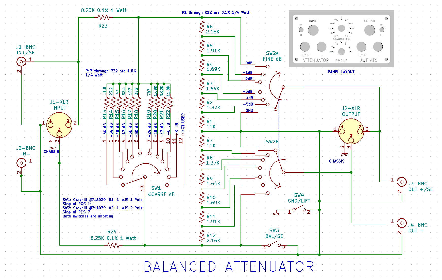

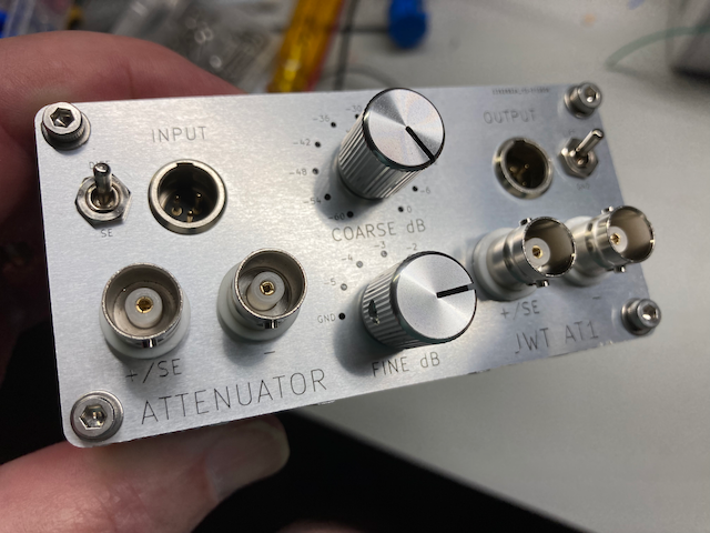

Stepped Differential Attenuator
I posted this over in the Equipment and Tools forum, but I thought it might be interesting to the folks in this thread.....
I got tired of cobbling together resistors to attenuate amplifier signals when doing distortion measurements. For low-level measurements, having a rats nest of parts and wires on the bench was bad from a noise standpoint as well.
So I decided to put together a fully differential stepped attenuator. I wanted:
1) Either fully differential or single-ended use (switchable)
2) XLR (mini) and BNC connectors
3) Coarse and fine adjustment
I looked around for an easy way (as opposed to something fancy like relays and R2R networks) to do this and came across Joe Broskie's clever idea of using a combination of shunt resistors for coarse adjust and a series string for fine steps. He sells a kit to do this on his Glass-Ware store. Currently, they appear to be out of stock.

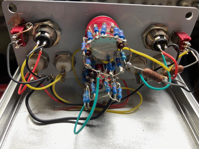

The first picture shows the completed unit in a small aluminum case. The second shows the schematic with resistor values and the third shows the internal (somewhat messy) point-to-point wiring. The resistors are mounted directly on the switches.
For the shunt resistors, I used 1%. For the input and series string resistors, I used 0.1% in order to keep common-mode errors low in balanced mode.
Note that the attenuator has an in-built 3 dB insertion loss due to the shunt arrangement, so I have to mentally add in -3 dB when doing measurements. Not a big deal.
The front panel was designed in KiCad and sent off to JLCPCB. I specified aluminum for the substrate. They charged me US$0.50 each (plus shipping) and had them to me in a week. This is a great way to get nice-looking panels done on the cheap.
My next project will be to build my Victors oscillator into a matching box. I plan to replace his level control with a 10-turn pot with a vernier dial since it is tough to tweak an exact level with his pot. I also plan to build a differential notch filter to pair with this attenuator.

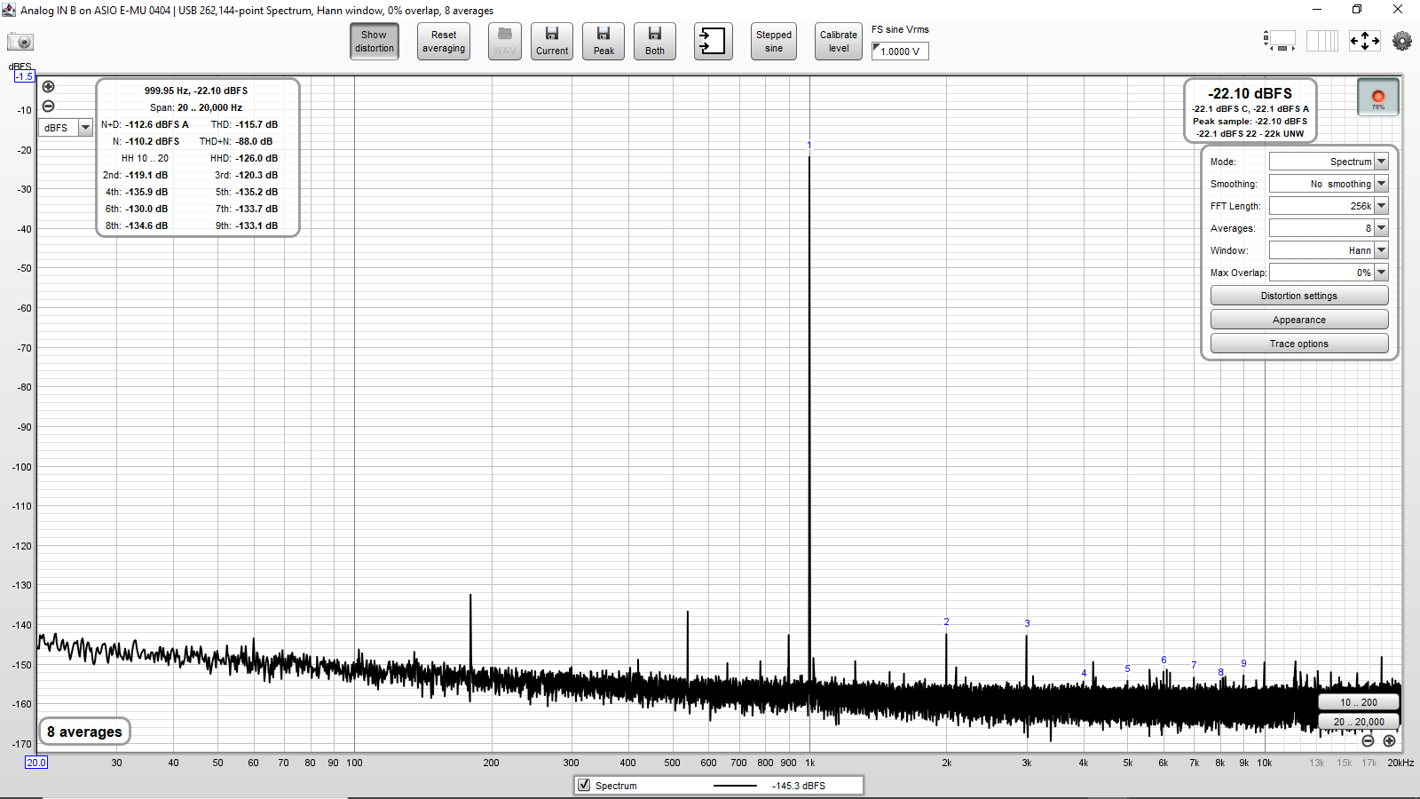

Perhaps worth adding the loopback response (the measurement rig, but not the DUT amp) to provide some perspective as to your benchmark noise/harmonic levels.
First attached is Left TRS to B XLR which gives us an idea of what the ADC side is capable of. (The balanced attenuator connects to the B XLR bypassing the NE5532.)
Second attached Left TS to B TS which shows the cleanliness (or lack of in terms of generator/DAC harmonics and power line harmonics) that will go into the power amplifier input. (But the NE5532 is there.)
The E-MU 0404 USB interface is powered by battery bank.
