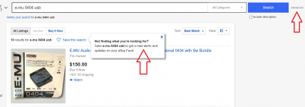

You can setup an alert on Ebay to let you know when one is listed. (See attached.)
Use the advanced options to filter out false alerts such as the power supplies.

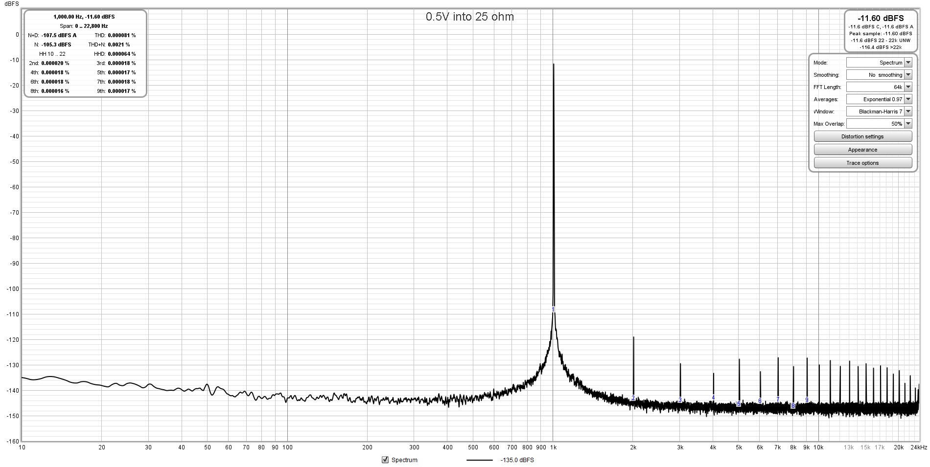

I've included a measurement of a headphone amp I recently built. The testing set up is this:
REW ASIO 48kHz, 2i2 connected to desktop PC on mains supply.
Akitika oscillator -->RCA out to HPA --> TRS headphone cable to 25 ohm dummy load --> RCA to XLR--> 2i2
Voltage at dummy load 562mV RMS (checked against Siglent SDS 1202X-E scope).
Is this a trustworthy measurement (relative to the equipment used), it seems to be very good and that makes me suspicious I suppose. I want to make sure I'm doing things right before I measure my other HPAs.

I don't see anything wrong with it. The 2nd is about -108 below the fundamental, which is quite good, but not so low to distrust it.
If you want some more confidence, take out the hp amp and connect the source directly to the measurement inputs, so you measure the oscillator and the 2i2. That would be your baseline.
I'd say well done, both the measurement and the headphone amp.

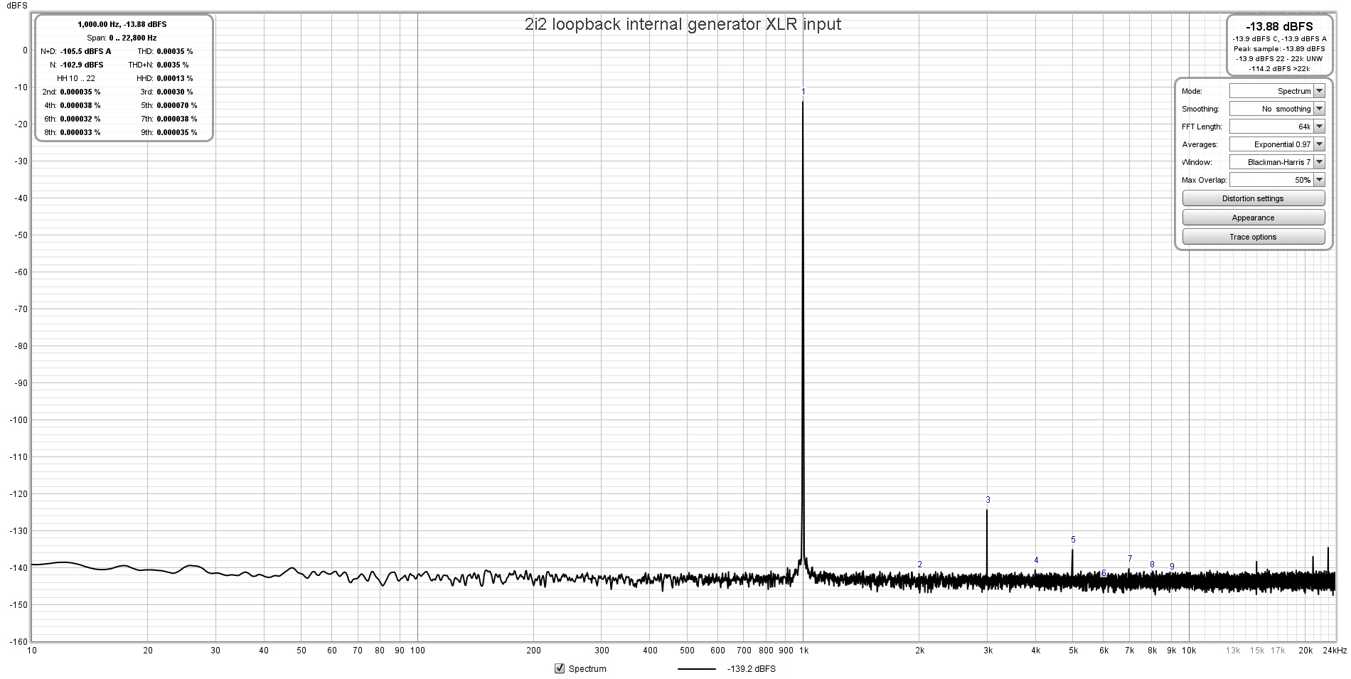

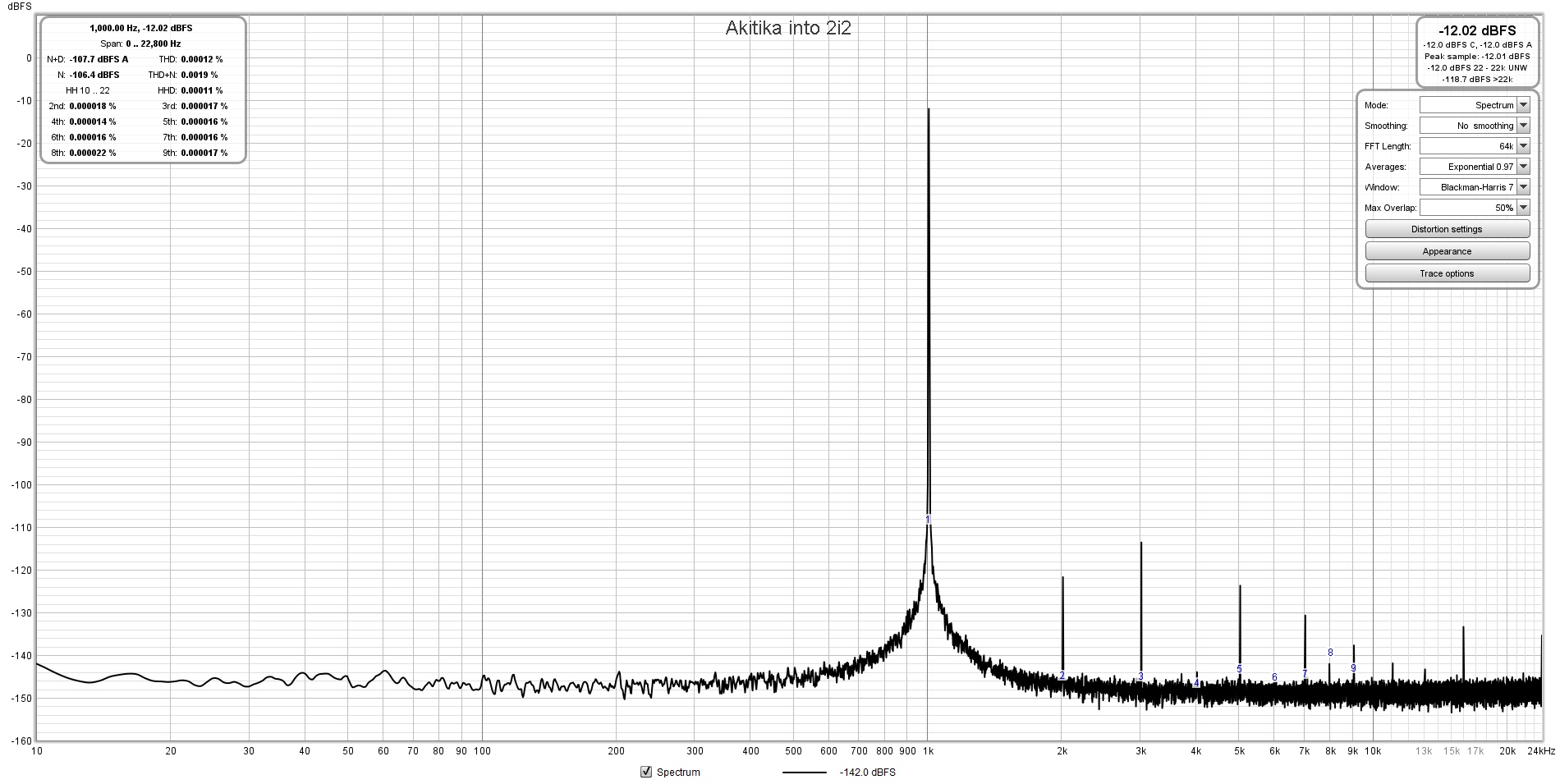

I've just done a loopback focusing on trying to get the lowest setting.
The first uses the internal generator with phono to XLR in.
The second is with the Akitika RCA to XLR in.
That's more in line with what I would expect.

Somehow the distortion panel figures from your Akitika measurement in post #1013 don't fit together. The graph shows 3rd harmonic clearly higher than 2nd, though the distortion figures show them as almost equal, with 3rd even slightly lower than 2nd.
But I have no idea what would cause this phenomenon ...
