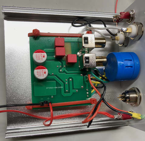

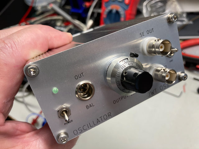

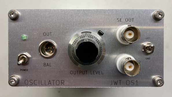

I decided to build a slightly more professional-looking enclosure for Victor's oscillator. Better shielding and improved connectors were the main goals. Similar to my stepped attenuator, I put it into a small 50x100x100 mm aluminum case. I designed the panel in KiCad and had it fabbed in aluminum by JLCPCB.
I replaced the level control with a 10-turn pot and vernier dial. This helps get consistent levels across multiple distortion runs with REW because the existing pot was a tad touchy. The RCA jacks were replaced with BNC connectors. I made provisions for a future differential output, probably consisting of an OPA1656 on a small piece of perf board (I don't have anything to test yet that has differential inputs).
Power comes from an external battery box with 4x 9Volt batteries.
It is taking its place alongside some of my other test equipment.

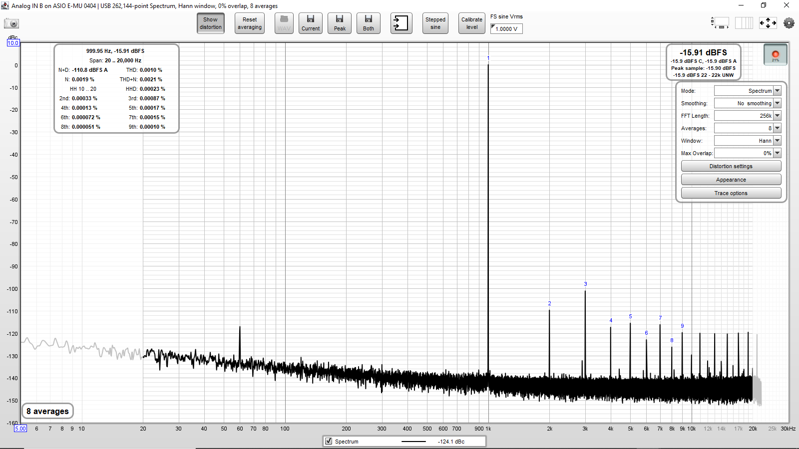

Attached is THD at 64W (4 Ohms) of L20.5 with modifications: Genuine Toshiba 2SC5171/2SA1930 drivers and with four output pairs of Toshiba (Japan) O gain rank 2SC5200 and 2SA1943.
