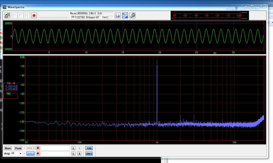

Post #9576 by DNi indicates Victor's oscillator is circa -157.4 and -165.2dBc for H2 and H3 at 2.28Vrms output, when using a notch and an EMU.
Post #9493 by KSTR indicates Victor's 2012 version oscillator is circa H2: -144dB and H3: -138dB at 2.7Vrms, when using an AP SYS2322.
Post #9112 by Bob Cordell indicates his Victor oscillator is at least -145dB THD, depending on loading.
Your plot in post #893 of this thread indicates the harmonics are circa -130dB, so as long as your Victor oscillator is performing nominally then it should be at least -15dB under any EMU0404 USB ADC/input related distortion.
So that then indicates the level of harmonic distortion generated by the EMU0404 USB when acting as an oscillator output, is capable of being lowered to circa -130dB, which is consistent with what I observed in Distortion analysis - a thought experiment.

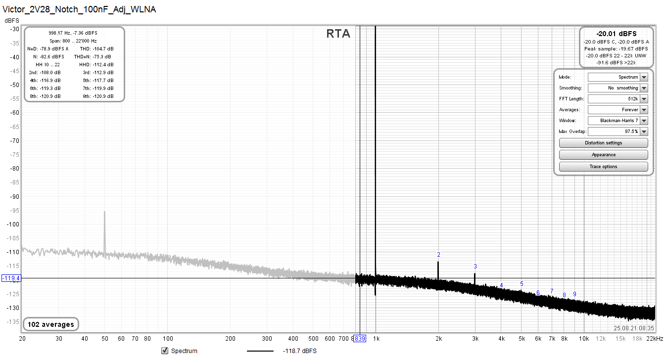

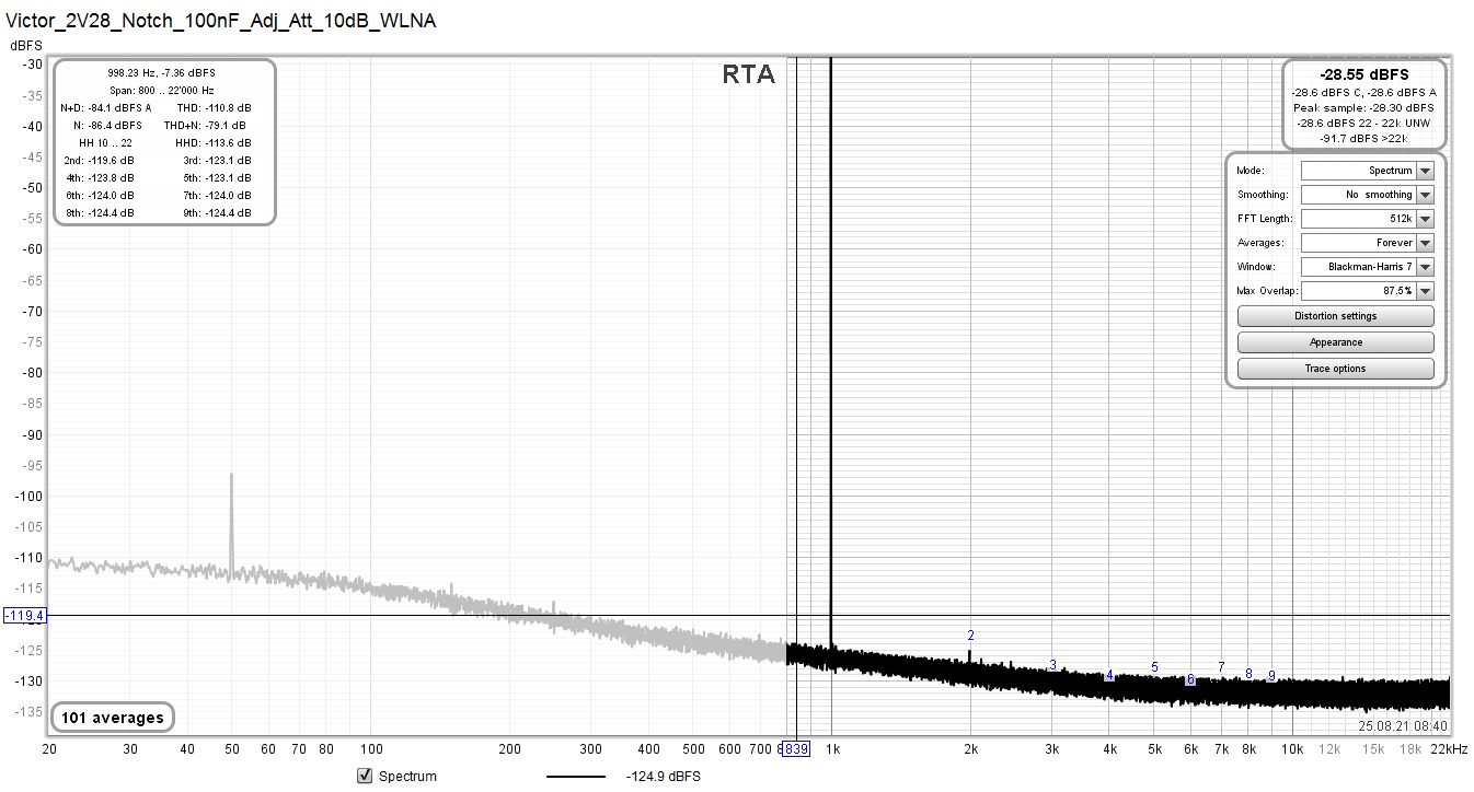

Just a small addition: I used a 60dB LNA after the notch filter and fed its output to a modded Motu AudioExpress card.From that long thread:
Two measurements as of this morning: in the first att the 2nd is at -108dBc, which corrected for the notch attenuation and LNA gain yields -158dBc. In the second plot the oscillator signal is attenuated by 10dB at the notch input, reducing thus the 2nd to -119.6dBc, possibly indicating a small nonlinearity in the notch filter (ideally, it should have been -118dBc).

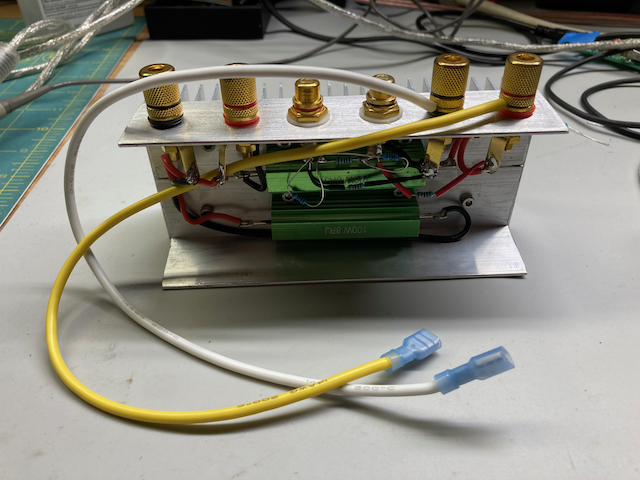

My dummy load box is pretty crappy and was done quickly. Of course, the binding posts on the load box play into the equation, as do the dreaded green WW power resistors (2x4 Ohms 100 Watts) bolted to the small heatsink.
The RCA jacks are connected to the power resistors through a balanced attenuator set of metal films (1% but not matched). This allows me to feed the balanced inputs to my EMU XLR jack with an RCA to XLR cable I made up.
I will probably scrap this a build a new one with Caddock power film resistors and a trimmable attenuator to get good CMRR into the EMU. At that point, I can experiment with testing at different connection points - the back of the amps, at the end of speaker cables, etc.

Those RCA jacks look like the ones I bought. Are they a tight fit for RCA plugs or are they loose? (Mine are a little too loose.)
I started with one 4 Ohm 100W load that looks like yours except it is gold color. Last week I experimented with four parallel 16 Ohm 100W loads. (Also gold color.) Did not really make much of a difference. (Certainly did not resolve the 0.02% 2nd harmonic issue.) If anything the four parallel 16 Ohm loads resulted in slightly higher THD.

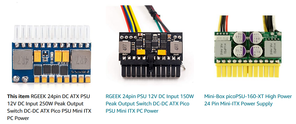

Edit: Using this PICO ATX power supplies will be a little complicated since I am using a surplus HP Z400 motherboard and they changed the pin out a little bit... Not hard but another step.
That is a good idea, however the main issue I am facing is that my good interfaces are PCI card and microdock (connected to PCI card by Ethernet) based.

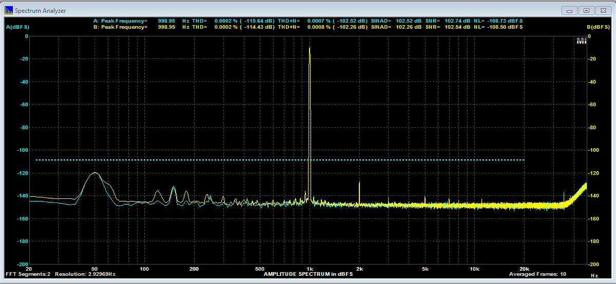

This is a line stage I measured recently- there is some 50hz pickup due to lack of screening.
The second screenshot is a loopback measurement.
The only time I have issues is when a ground loop is formed, and I have an ADC with isolated USB to deal with that.
