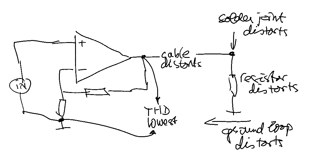

It is more likely X measured a contact distortion problem, an effect I can confirm based on my own measurements. As Jan stated, to measure the amp and nothing else it is mandatory to measure before any connectors on the way to the load.
AX tech editor
Joined 2002
What I meant. Reliably and repeatably measuring very low distortion isn't just slapping a couple of probes on somewhere.

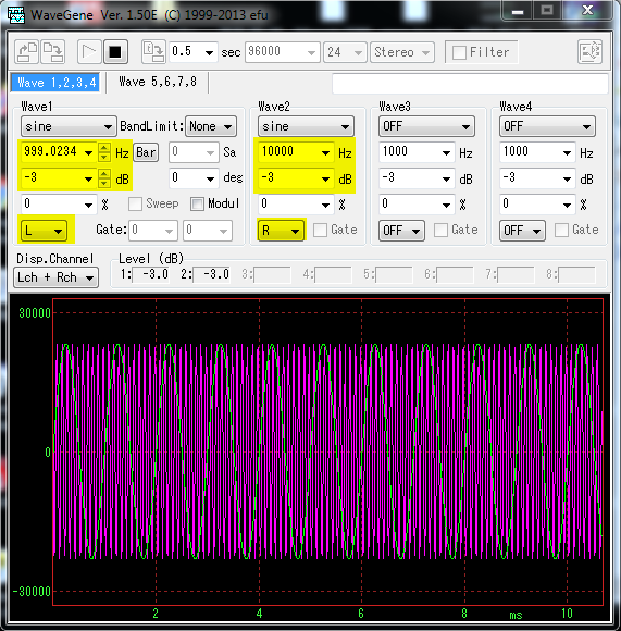

Is it possible to send out different signals on the two channels of the soundcard? As far as I can see the REW generator can only output one signal to either or both channels. Is it possible to spawn another generator instance that sends another signal to a channel output? That way I could send the test signal out of Lch and the unmodulated sync signal out of Rch, for instance.
Jan
Jan, you can do this with WaveGene - it has 8 oscillators and each one can output to a different channel (if you had an 8 channel sound card!).
It also supports the generation of an assortment of WaveForms and "user wave" (arbitrary waveforms)

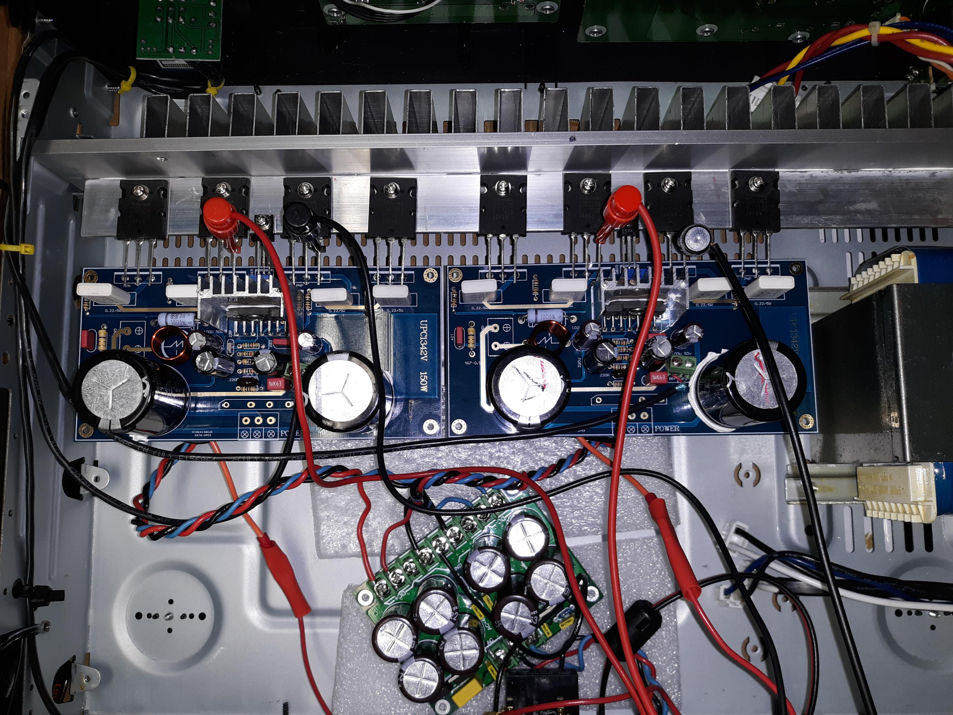

I have a uPC1342V based amplifier (with two pairs of 2SC5200/2SA1493 outputs).
If I measure from the PCB between the output trace and the ground at the input (on the PCB) I measure 0.003% THD.
If I measure from the speaker terminals I measure 0.02% THD (mainly second harmonic).
What should I look at to improve the measurement at the speaker terminals? I used 16AWG tinned copper wire (Remington Industries) and I am bypassing the protection relay during the distortion measurement.

Does the speaker return line go straight back to the same point as the input ground where you measured first?
You can do step by step working through every solder joint, connector, etc, leaving the ground at the input ground and then working towards the load, see what happens. Draw out the circuit and note all solder joints and connection points, treat those as 'components' in series that can have non-linearities.
Jan
The power amplifier PCBs connects power (+/- & GND) to the rectifier/filter board as does the speaker return from the speaker terminals/protection board. The rectifier board has five ground screw terminals in a row of which two go to the power amplifier PCBs and another is used to connect to the speaker terminals. When I do the 0.02% THD measurement the speaker return goes to the rectifier board as does the ground of the measurement/ADC cable.
For my 0.003% THD measurement I ground the ADC cable on the power amplifier PCB where there is a 2 pin screw terminal for the input. The speaker return is still going to the rectifier/filter board which is a different point. That is likely part of the problem but the rectifier/filter board with the multiple ground screw terminals seems to be the usual connection point for the speaker return. (Or it that a mistake?)
So I guess I could move the speaker return from the rectifier/filter to the power amplifier board (currently it is on the rectifier board). Would that be a good idea?

Once I moved my measurement point from my speaker terminals to my amplifier PCB I was surprised to see how low the THD was on several of the amplifiers that I have built. In other words I was unaware that most of the THD was due to factors outside of the actual amplifier PCB and design. I am seeing 0.0015% to 0.003% THD on several different designs at the amplifier PCB.
So I would encourage others (who are measuring the THD of their project amplifiers) to measure:
1. First across the feedback divider on the amplifier PCB
2. Second across the output and ground terminals on the amplifier PCB
3. Third across the speaker terminals
I was putting 90% of my effort into the amplifier PCB and components and I did not realize the problems being caused by the purchased speaker protection board and the power rectifier/filter board.
