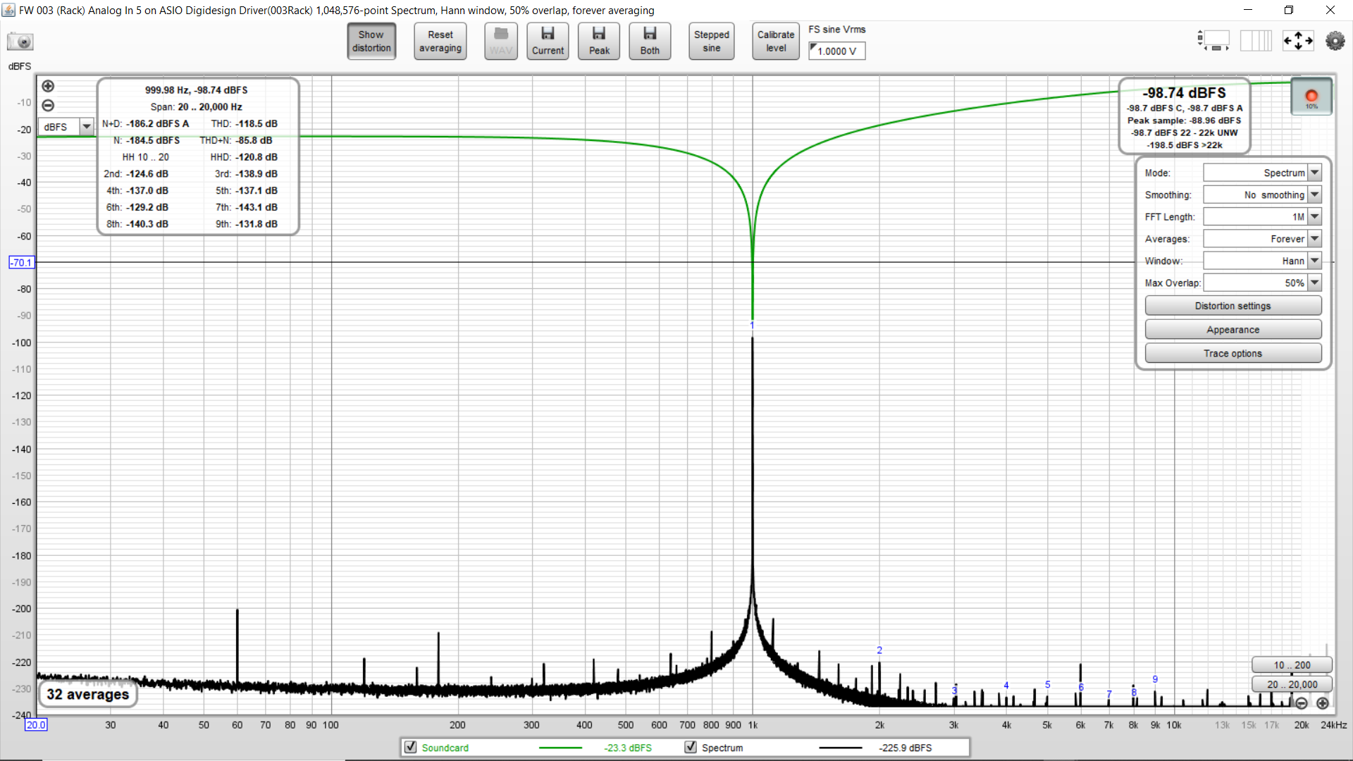

Are the noise, noise plus distortion and thd + noise calculations/RTA readouts "invalidated" by using a notch filter (calibration in the mic file)?
Please see the attached spectrum. The violet line is the measurement of the passive Hall notch filter.
Ok. I tried RC7 this morning and the noise numbers look better.
With an 88 to 90 dB notch filter the levels end up at -240 dB or lower. So I guess I will need to use the math functions or Excel to change the 0 dB at 1 kHz (in the cal file) to -88 dB to fix that. (Offset the whole file by adding 88 dB?) I guess that will be the result of subtracting a measurement of the notch filter from a measurement of the interface with a straight loop-back.

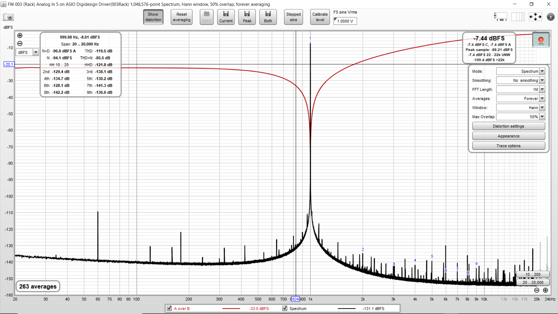

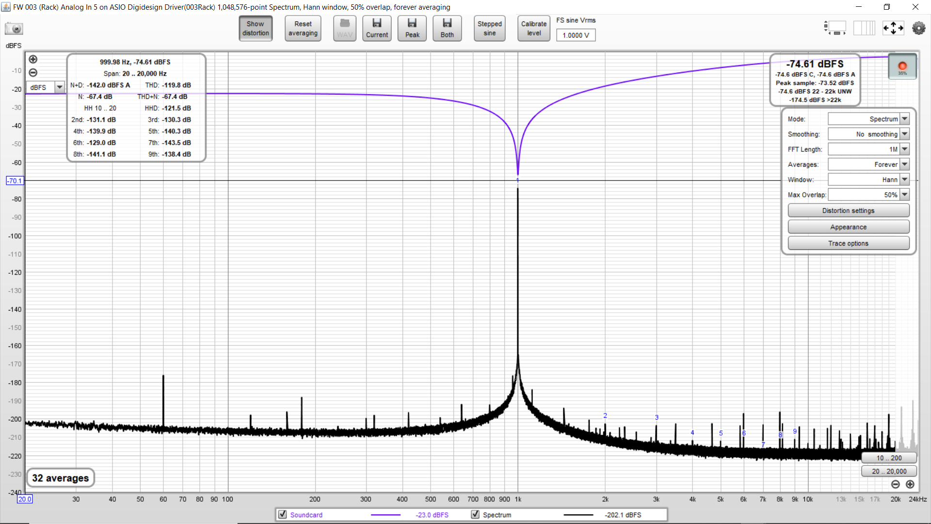

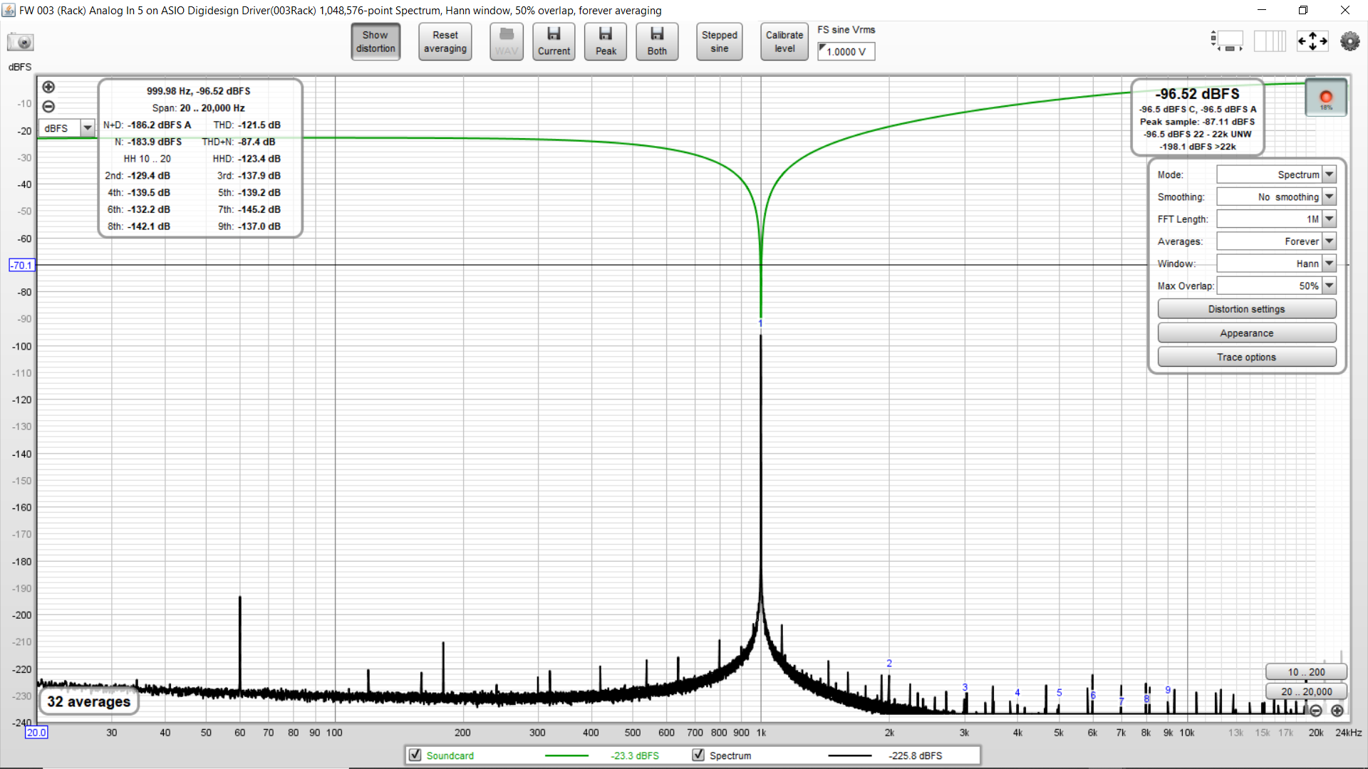

Just FYI: I made the notch filter as stable as I can make it so far. However I am trying to calibrate and then measure immediately (without any delay).

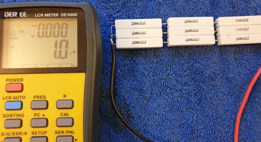

Do you have a way to measure the inductance? If not you might like to purchase a few of these to use as a baseline to complete the other resistor you are considering.
I ended up with 1uH.
But its not just about that. As keantoken said in my thread its about how the magnetic field from the collapsing inductance injections more harmonics into the measured signal.

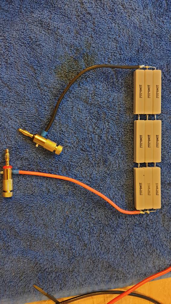

AU $2.46 5%OFF | 10pcs 10W 5% Cement Resistor Power Resistance 0.1 ~ 10K 0.1R 0.5R 10R 50R 0.22 0.33 0.5 1 2 5 8 10 15 20 25 30 100 1K 2K 3K ohm
10pcs 10W 5% Cement Resistor Power Resistance 0.1 ~ 10K 0.1R 0.5R 10R 50R 0.22 0.33 0.5 1 2 5 8 10 15 20 25 30 100 1K 2K 3K ohm|Resistors| - AliExpress View attachment 936420 View attachment 936422
You want to use bulk metal resistors - they are non inductive and make a huge difference. The gold metal shells ones add distortion. The wire wound ceramics do as well.
The best ones are made by EBG. You can get used UXP-300 for about $15 on eBay. Not sure how much new but probably pricey. These are 300w 10ohm designed to be used with a heatsink like a CPU cooler or large aluminum plate.
For example:
QTY:10, EBG (VISHAY) UXP/300 10RK 10 OHM/10OHM 300W FOIL NON-IND.POWER RESISTOR | eBay
Another way is the series parallel quality 1W metal thin film resistors. You can make circa 25W dummy loads this way 5x5 8ohm config for example. Avoid metal oxide as they are distortion generators as well.
The worst ones are the huge 6in long 100w wirewound heater element style coated with green ceramic.
Just changing to EBG UXP-300 resistors and using a balanced input on my Focusrite with quality MKP caps cleaned up the measurements quite a bit.

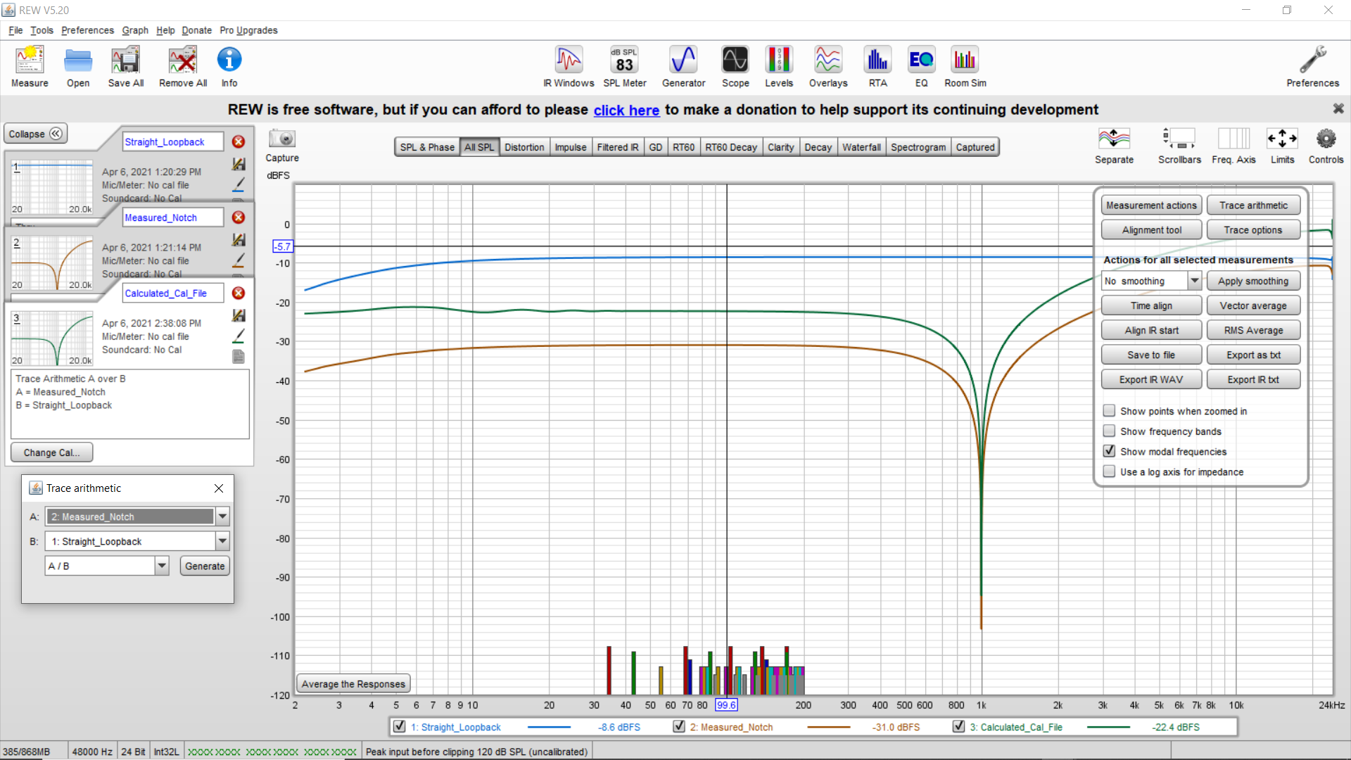

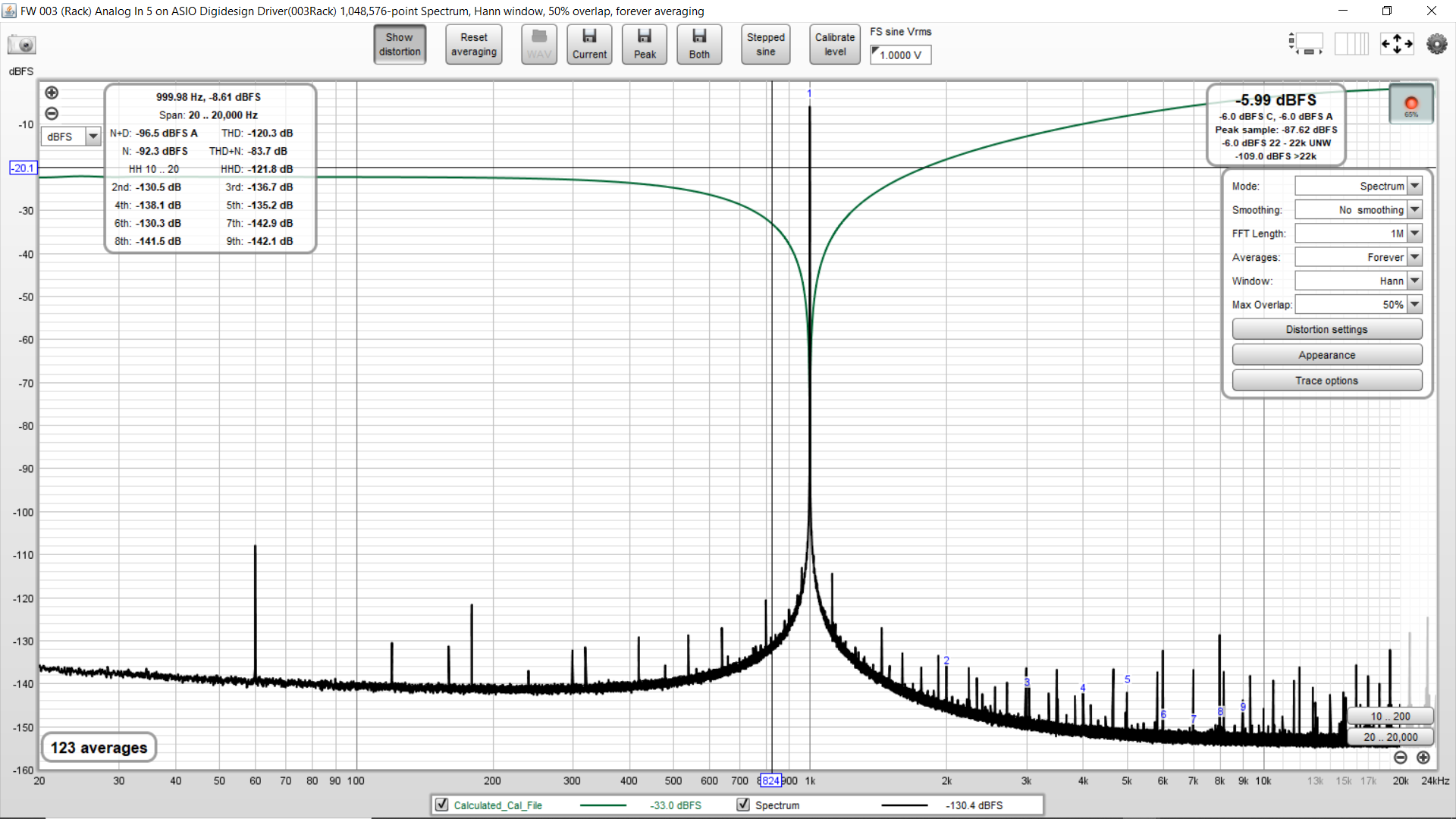

Offset the cal file so it has the correct gain figure away from the notch (e.g. measure a 100 Hz tone with/without). Use the Manual fundamental option in the Distortion settings to let REW know what level the fundamental should be, notch stability/drift shouldn't matter then.
The attached images show how I did it.
In the first image there are the measurements "Straight_Loopback" and "Measured_Notch".
Next in "All SPL" I used Trace Arithmetic to calculate A/B where A is the "Measured_Notch" and B is the "Straight_Loopback". Make sure to get them in the right order. This result I called "Calculated_Cal_File" which I "Exported as txt". This exported file was setup as the microphone calibration file in the preferences.
I then entered a manual fundamental of 0.371Vrms because the Straight_Loopback (measured at the same level as I used in the generator for the distortion measurement) reads -8.6 dBFS. (And I put 1.000Vrms as full scale in the RTA.)
The results of the CS4392 with stock NE5532 output filter is attached as image 2. CS4392 with stock OPA2134 output filter is attached as image 3.
This might help someone else do their first measurements with a notch filter. A helpful dB to Voltage Gain/Loss calculator is found here: Decibels to Voltage Gain and Loss convert calculation conversion amplification amplifier electronics - sengpielaudio Sengpiel Berlin
