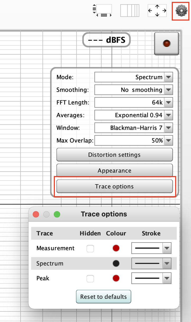

I have been using ARTA, but wanted to try REW for distortion measurements. In general a positive experience, but I have one issue: I cant get rid of the averaging curve in the FFT window.. (I see two, one average and one 'live') I try to disable it. but it's still there.

There are 3 traces on the RTA graph. The first is the currently selected measurement from the main REW window (the last measurement saved, typically), the second the 'live' RTA trace and the third the peaks of the live trace. Any of them can be removed from the graph by deselecting them in the graph legend.I have been using ARTA, but wanted to try REW for distortion measurements. In general a positive experience, but I have one issue: I cant get rid of the averaging curve in the FFT window.. (I see two, one average and one 'live') I try to disable it. but it's still there.
Suggestions?
[URL="https://www.diyaudio.com/forums/members/johnpm.html" said:JohnPM[/URL];]There are 3 traces on the RTA graph. The first is the currently selected measurement from the main REW window (the last measurement saved, typically), the second the 'live' RTA trace and the third the peaks of the live trace. Any of them can be removed from the graph by deselecting them in the graph legend.

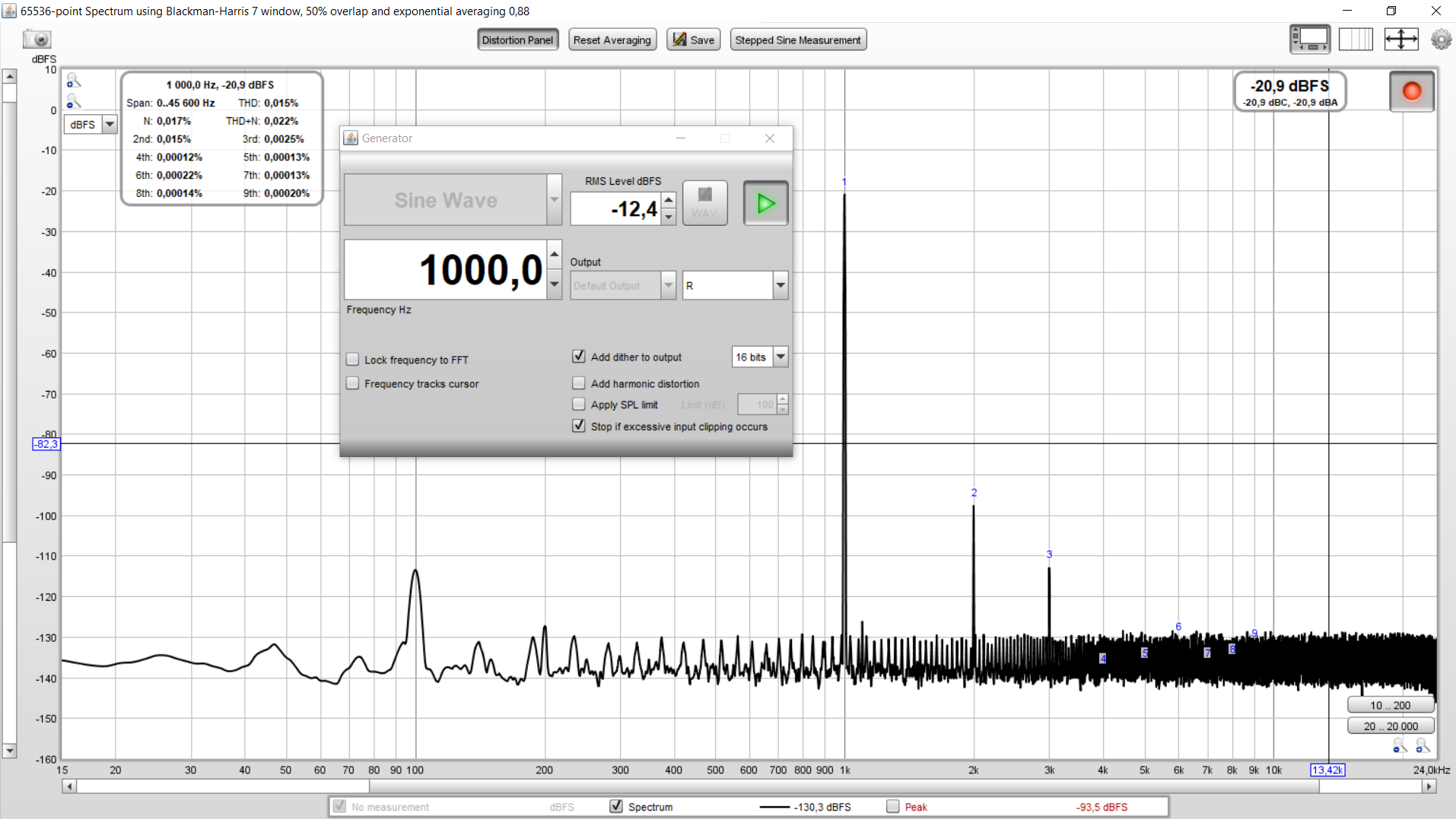

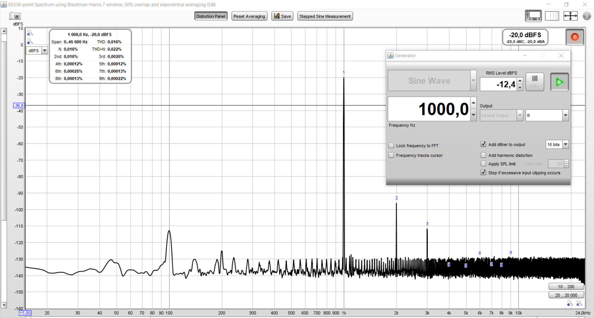

Hi, I made some measurement on my F5Turbo.
1 kHz, 2,83V peak 8 ohm load and 8 ohm+1,5 uF parallel.
It seems to me OK, just the 100 Hz peak are too much or normal at a class A amp with CRC psu filtering?

Looks like intermodulation with the 100Hz from the supply. That will generate multiple sum & differences with the 1kHz carrier. 1kHz +/-100, 1kHz +/- 2x 100, etc.

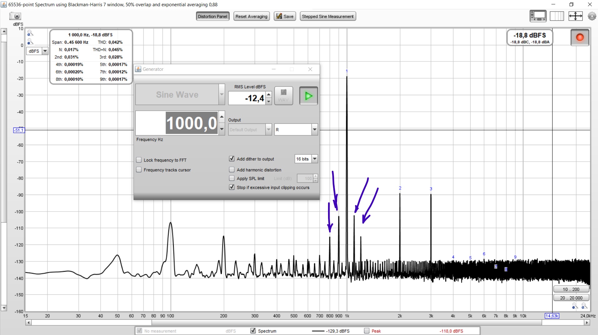

What are those peaks around 1 kHz?
I sometimes find that I get those peaks if I have a bad connection.

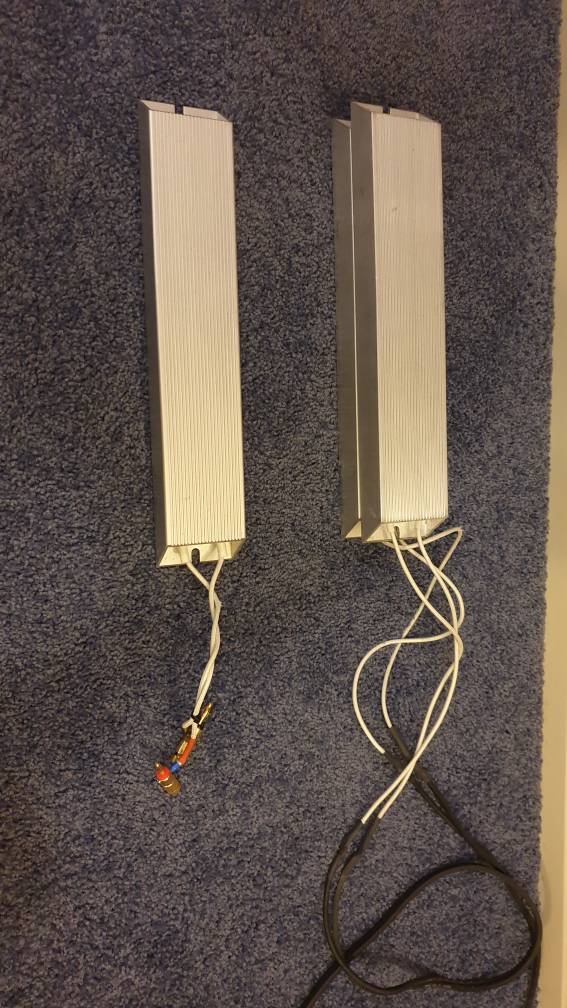

You guys might also like to check out my findings on my honey badger amplifier. Making distortion measurements.
I couldn't work out why I had so much distortion a 16khz. I haven't fully verified my results yet but it looks like its the load resistor. So if you have one like this you may want to subscribe to this thread.
diyAB Amp - The "Honey Badger"
I reduced the distortion from 0.23% to 0.0055% just by measuring prior to my zobel network indicator as apposed to across the load resistor.
Check out post 2419 onwards.

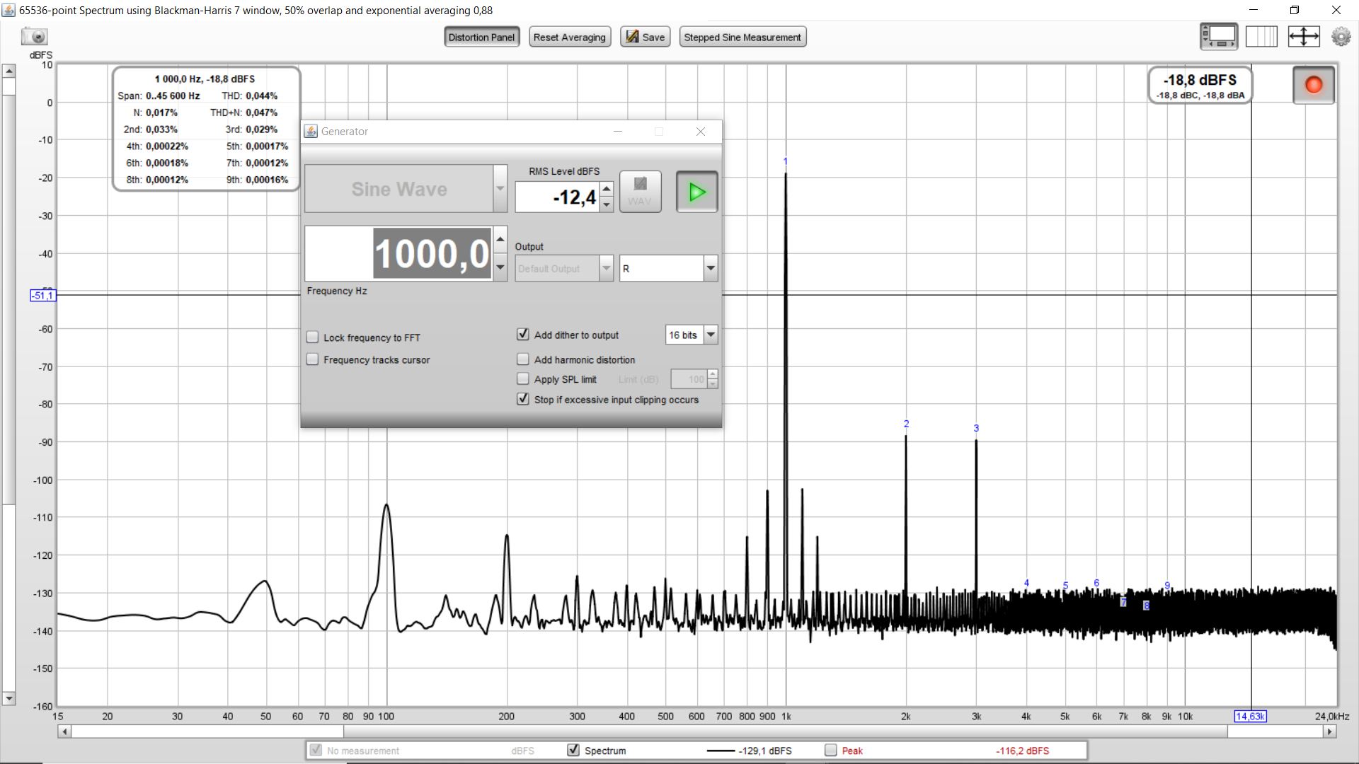

And there is a peak on 200 Hz too 🙁
The amplifier sounds rich and relaxed, very enjoyable.
Perhaps set the generator to lock the frequency to FFT, and disable the dither, to see if that causes a noticeable difference.
50hz looks way to high to me. Does you circuit use a ground lift on the power supply or a small 4.7ohm resistors between the amplifier ground and the signal ground.
I always connect the ground of my distortion test lead to the signal ground not the negative speaker terminal. This cuts out alot of unwanted noise.
