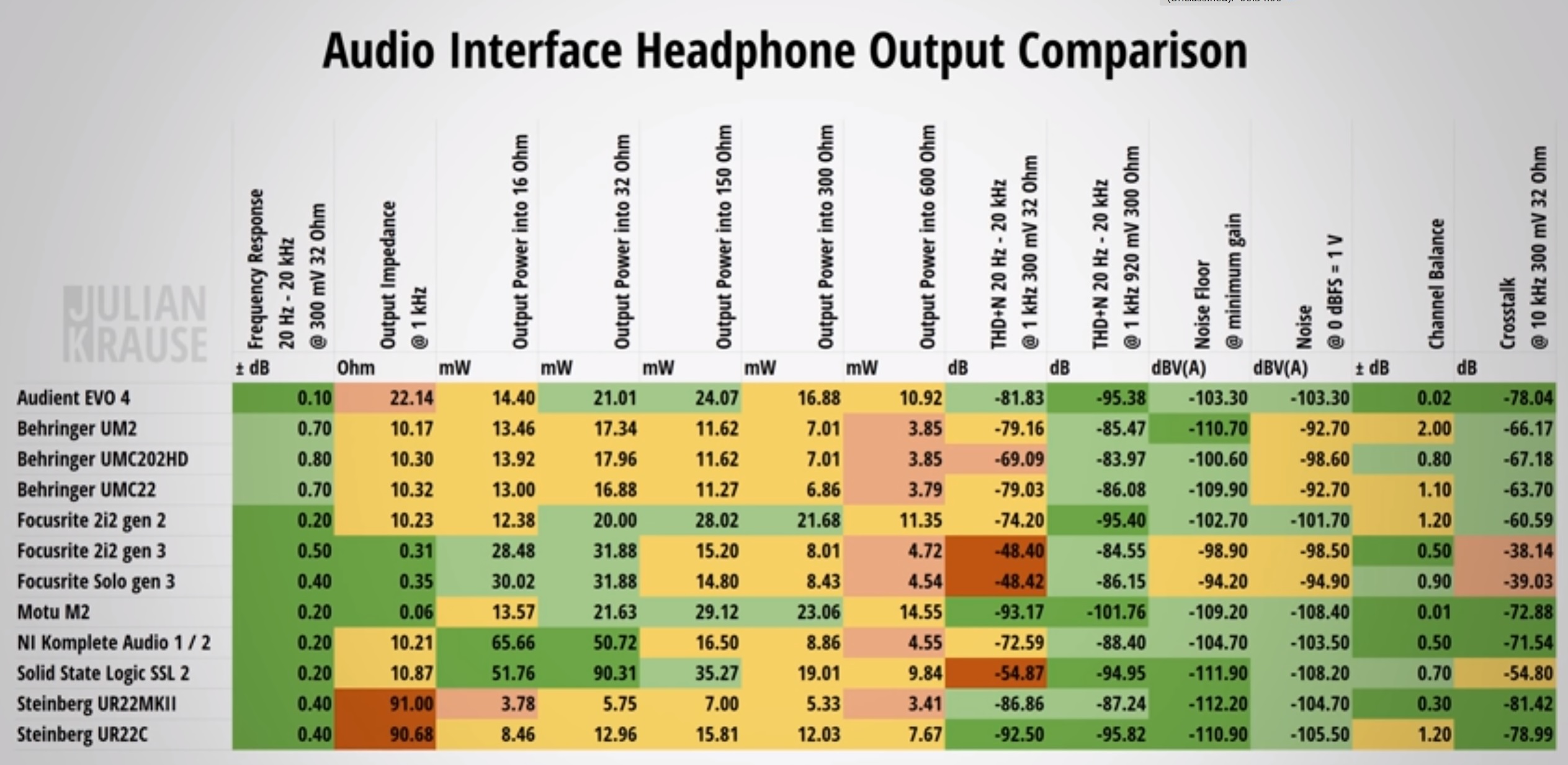

I'm less than satisfied with the Focusrite 2i2. When its looped back (cabled) i get a respectable 0.0007 THD and 0.002 THD+N (from memory). Problem is as soon as you just use the outputs into other equipment its noisy, like real noisy. This is confirmed with a scope. Its not earth loops or anything like that.. its white noise. In fairness to Focusrite they do focus on the mic inputs and it is a gen 1.
So its not my imagination. All credit to Julian Krause. Don't know what he's measuring with but crosstalk @ -38 dB. Wow.

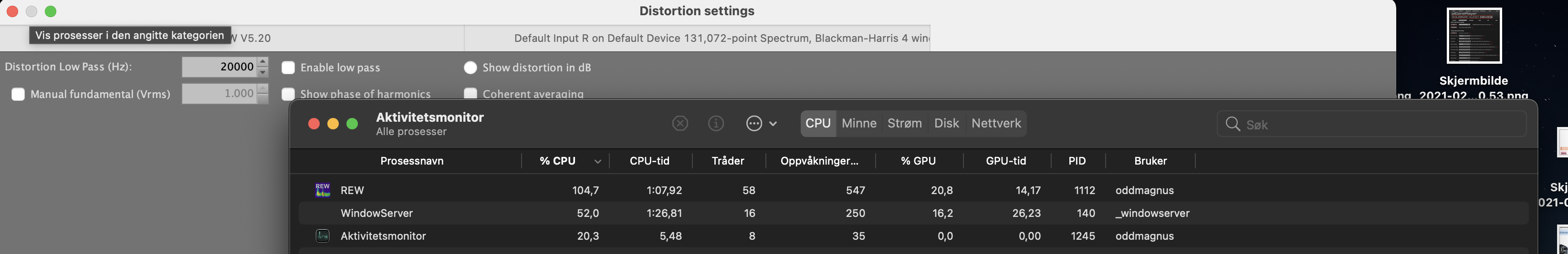

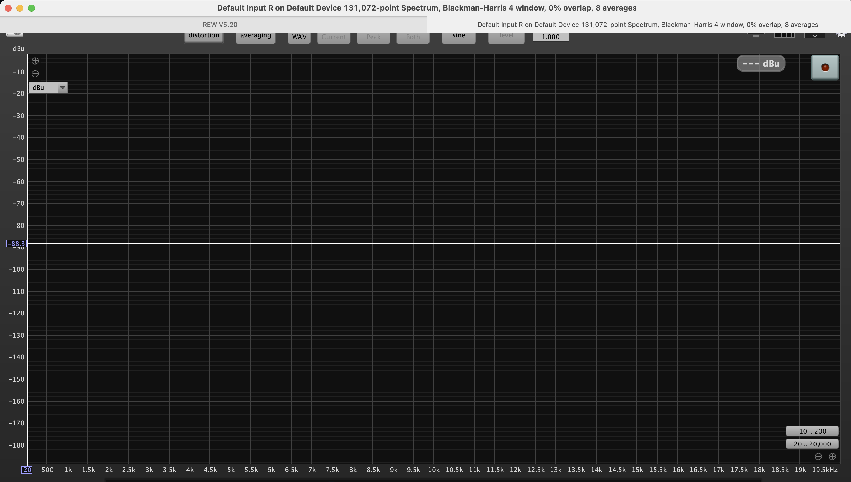

Hi, unsure if this is the best REW thread but anyway.
Someone using MAC (Big Sur) with REV?
Latest Beta is very unstable and the gui has some weird behaviour.
"Everything" works fine but when I am doing an RTA the looks of it is a bit strange.
No matter how I resize or try to change looks every "pushbuttons" on tom are almost completely hidden.
If I go into settings (upper right) and press for instance distortion settins, apperance or Trace options it freezes every time.
A big CPU hog is also present and have to kill the process.
Anyone else experienced this?
Tried restarting the machine but it does not help.
