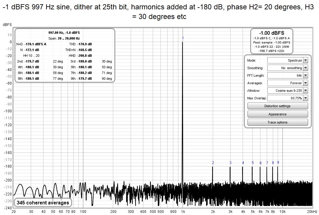

Perhaps easier to test with a file. 1125 Hz is quite problematic for 48 k (or multiples) sampling from a quantisation perspective, needs dither. I tweaked the signal generator so I could add harmonics at -180 dB and added the lowest dither I have implemented (25th bit) to 997 Hz on a 60s file saved as 32-bit float:
I spent a couple of hours understanding the high 3rd HD at 4500 Hz exactly when I did a stepped sine.
Finally I googled it and found your post, especially:
"1125 Hz is quite problematic for 48 k (or multiples) sampling from a quantisation perspective, needs dither"
As I saw a component around 1200 Hz, I suspected that this was the problem as 1125 times 4 equals 4500.
I added 16 bit dither and it disappeared!
Would you please explain the mathematics of this?
Is adding dither only an option for the generator? Or is there an option for that in the sweeps? (In other words I see it as an option for the generator but I have not found it yet for sweeps.)
Is 44.1 kHz better in this case or will I just get other spikes popping up in sweeps?

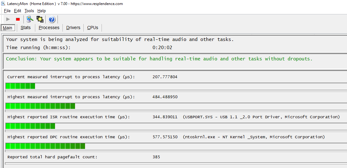

Thanks Jan. On the issue of dropouts, LatencyMon is a good tool to identify problematic drivers or processes that may be causing audio issues. I've seen reports of issues with the Win 10 20H2 update for some users with USB interfaces, driver updates may help in those cases.

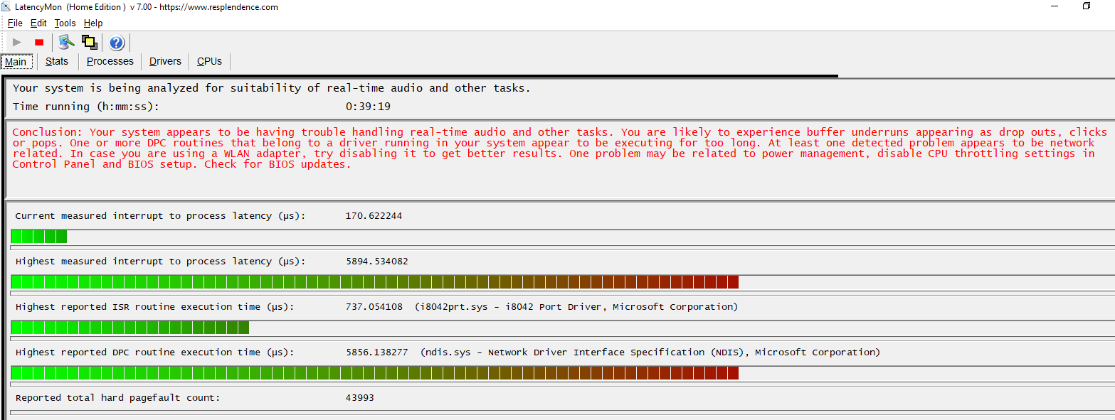

LatencyMon seems to indicate that my WIFI is causing problems. (See attached, before and after disabling WIFI.) Next I will see if that stops the dropouts on my next set of measurements.
So anyone else with dropouts should give LatencyMon a try.

This makes a whole lot of sense, why it is so random. I'll just try disabling Wifi and see what happens.
I had an ordinary USB DAC (EMU 0204, the one I now use for measurements) as part of an HTPC, and I got drop outs that was caused by the wifi driver's interrupt. I guess that they somewhere deep down share some resources with the USB drivers.
I used a similar program to LatencyMon to find out.
Once the wifi was disabled, the drop outs disappeared.

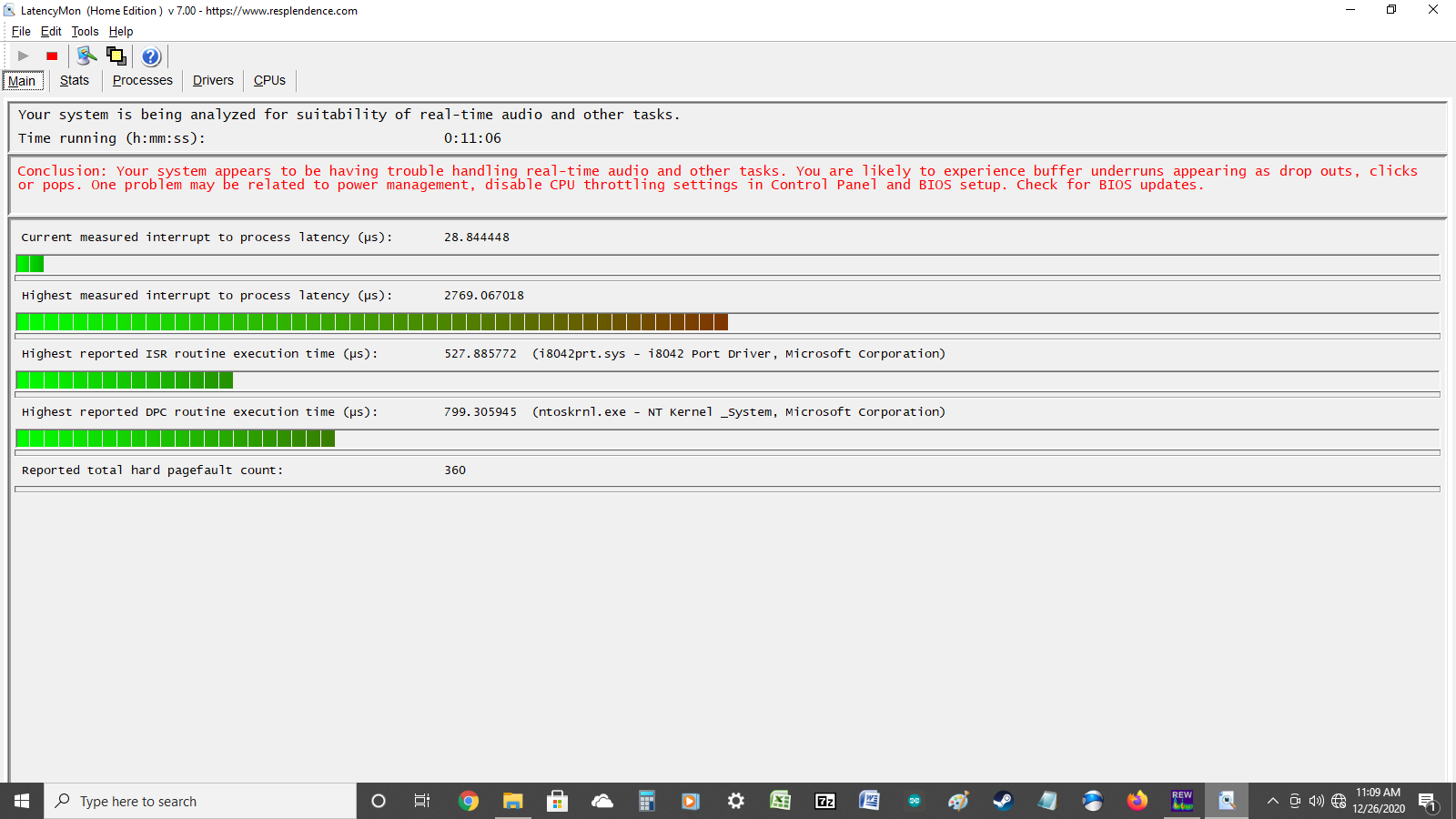

Unfortunately the dropouts continue even with WIFI disabled. See attached.
I have already set the minimum CPU clock to 100%. I am not sure what else I can adjust with regards to the LatencyMon message regarding CPU throttling.

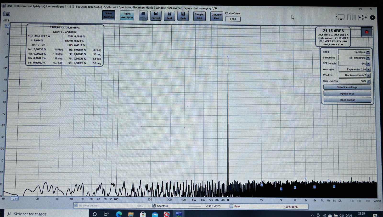

After I updated both Win10 20h2 and driver to Focusrite 2i2 (2nd gen) I am not able to get signal level to 0 dBFS before input turns "red" (input clipping). Now limit seems -21 dBFS (image attached). Loop back test using internal generator. So I am not able to watch the harmonics as detailed as before. Any idea what caused this?
It may be a setting I have missed somewhere.........
It is same "issue" on two different computers. Maybe not an "issue" but just something I need to get used to after updating both Win10 and driver.
Now when I plugin 2i2 in USB a "Focusrite Notifier" shows up with info about Sample Rate, Buffer Size and Clock and also name of device. Probably the new driver that has changed the behavior a bit.

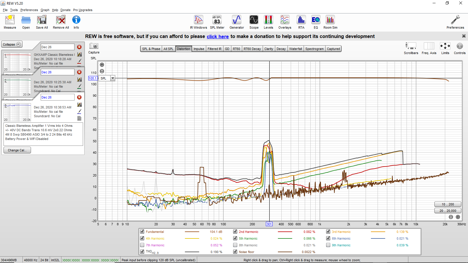

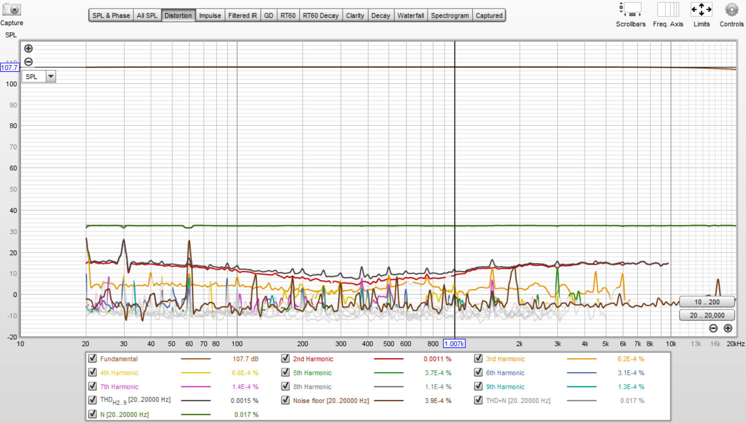

I believe that this works. It is hard to know 100% with a random phenomena but I gave REW several hour long tests (long stepped sine sweeps and 4M FFT spectrums) and no glitches yesterday. I disabled WIFI, track pad and ran with realtime priority. I have never been able to run such long measurements without a glitch so this realtime priority might be the real fix. Hopefully it does not glitch again today right after posting this. This was done with ASIO (ASIO4ALL), Windows 10 and SB0490 (24 bit USB external Sound Blaster Live!) at 48 kHz 24 Bits.

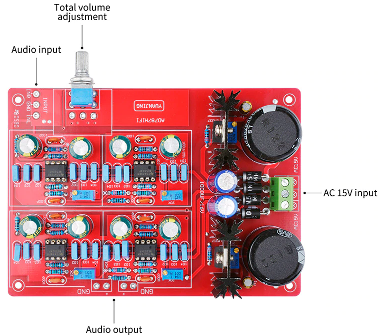

I have attached the long measurements of a YJ (Yuan Jing) AD797HIFI (MBL6010 inspired NE5534P preamplifier). I think it is quite a nice preamplifier. I expect the 60 Hz and harmonics will be less when I have a metal chassis for it. It is called AD797HIFI but the op amps are Ti NE5534P.)
