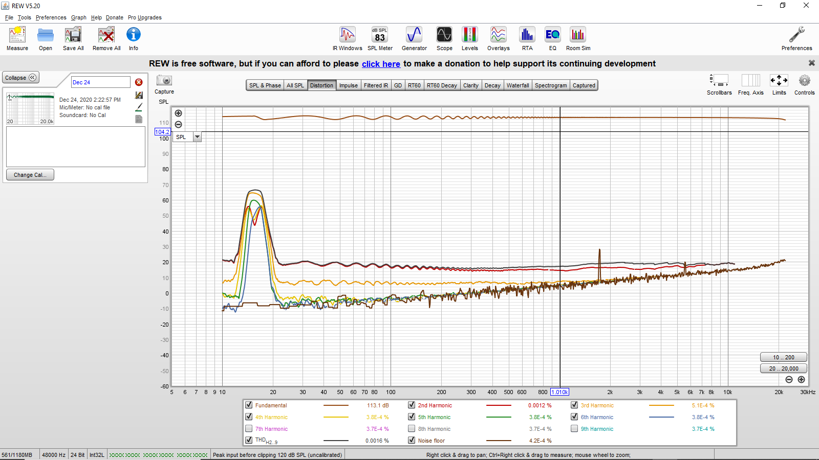

I was able to measure my Hafler DH110 preamplifier. I'm having issues with stability of the measurement. It goes along and updates moving around a little and improving with more averages and then it jumps, distortion goes way up, everything climbs and then it starts averaging again and getting back to normal. I have attached a picture of the error screen.

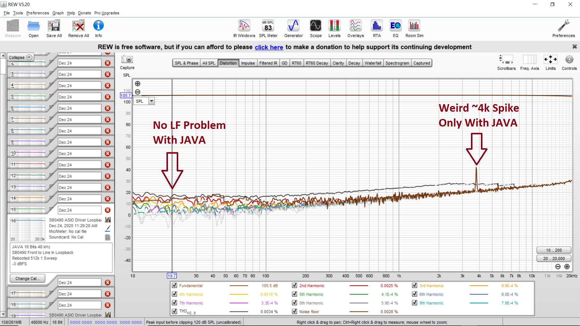

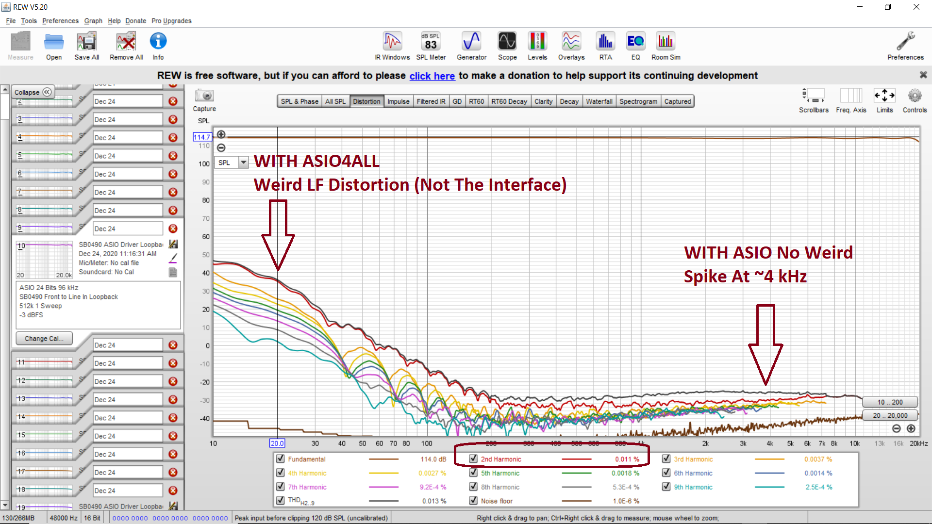

Trying to get rid of the glitches on my Windows 10 Laptop with SB0490 USB interface I tried the ASIO (ASIO4ALL) and I was able to exchange one problem for another problem... 🙁
With JAVA I don't have any LF (20-100 Hz) false distortion problem. (See attached screen capture.) But I do have a weird spike at ~4 kHz that should not be there. And I am limited to 16 bits on this 24 bit interface, of course.
With ASIO (ASIO4ALL) I don't have the weird spike at ~4 kHz. But unfortunately there is a terrible LF (20-100 Hz) false distortion problem. (See attached screen capture.) So I can use 24 bits but it is ruined by the LF problem.
Running on battery power doesn't make any difference. So far (about one hour) no glitches today (the original issue)... The glitches were frequent yesterday. I have nothing running in the background (except Windows 10 64 Bit...).
I am running REW 5.20RC4.
I would love to resolve this since I would like to do my measurements in 24 bits and without the false distortion readings.

Making some progress. With the ASIO drivers there seems to be a digital/software feedback loop from Line Outputs 1/2 to Inputs 1/2 with SB0490 and REW. This does not occur with JAVA.
Now I am trying to route the outputs to Line Outputs 3/4 and loop back to Line Inputs 1/2.
I had this problem before with the SPDIF Out 1/2 being looped back (internally or in software, not sure) to Line Inputs 1/2 so when I measured a DAC (using the SPDIF out) I had to route the output to the left channel and bring the input into the right channel.
