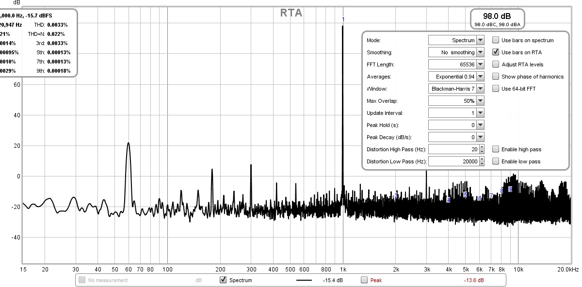

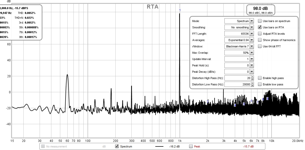

First, my thanks to xrk971 and the rest of this community that makes diyAudio a place that keeps me coming back for more.
After weeks of frustration (and binning my original interface) I got a used Focusrite and was able to get some measurements. I'm attaching photos of my setup, plus an initial measurement for reference to my question:
When I press the red RTA button, the immediate response is not that great, but it improves after a few seconds... (which is what the snapshot shows) but the graph and distortion figures keep changing, (getting better) and if I wait a few more seconds, the graph gets these weird bumps instead of the spiky harmonics. When I reset the averages it goes back to a spikey harmonic graph, but appears to start the process over again... So how long do I wait to press the red button again and freeze the display? The distortion graph never seems to reach a stable reading.... is that normal, or do I have a wrong setting somewhere?

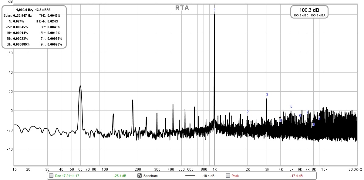

This graph is of my re-capped Carver 500 and hope to use that as a reference for measuring some new Chip and Discrete amps I have in the process of rebuilding...
Thanks! - Sixto.
Thanks! - Sixto.
Hi Sixto,
Looks like you are getting there,
What sort of graph do you get with the dB setting on the top left set to dBFS or dBc ?
Are you getting low numbers and noise in loopback ?
-Dan

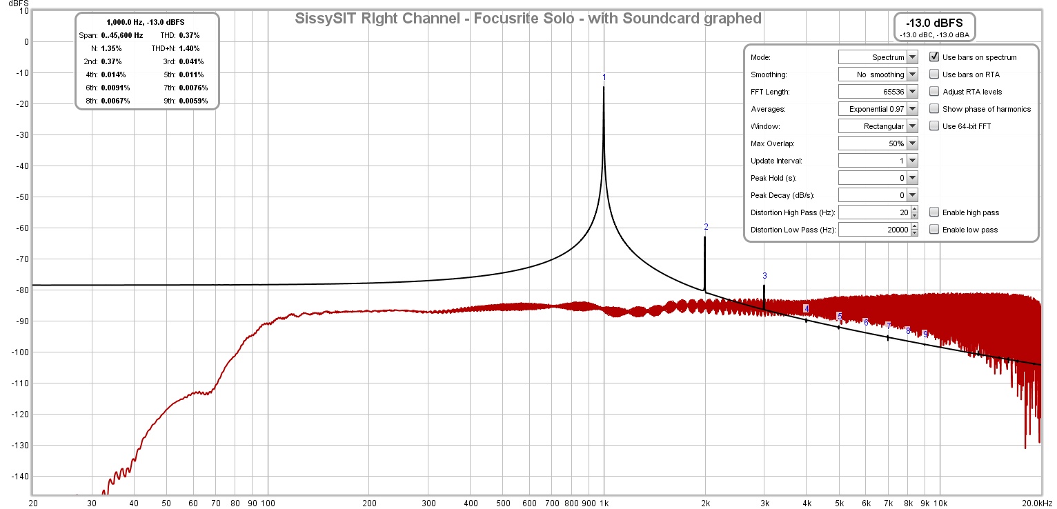

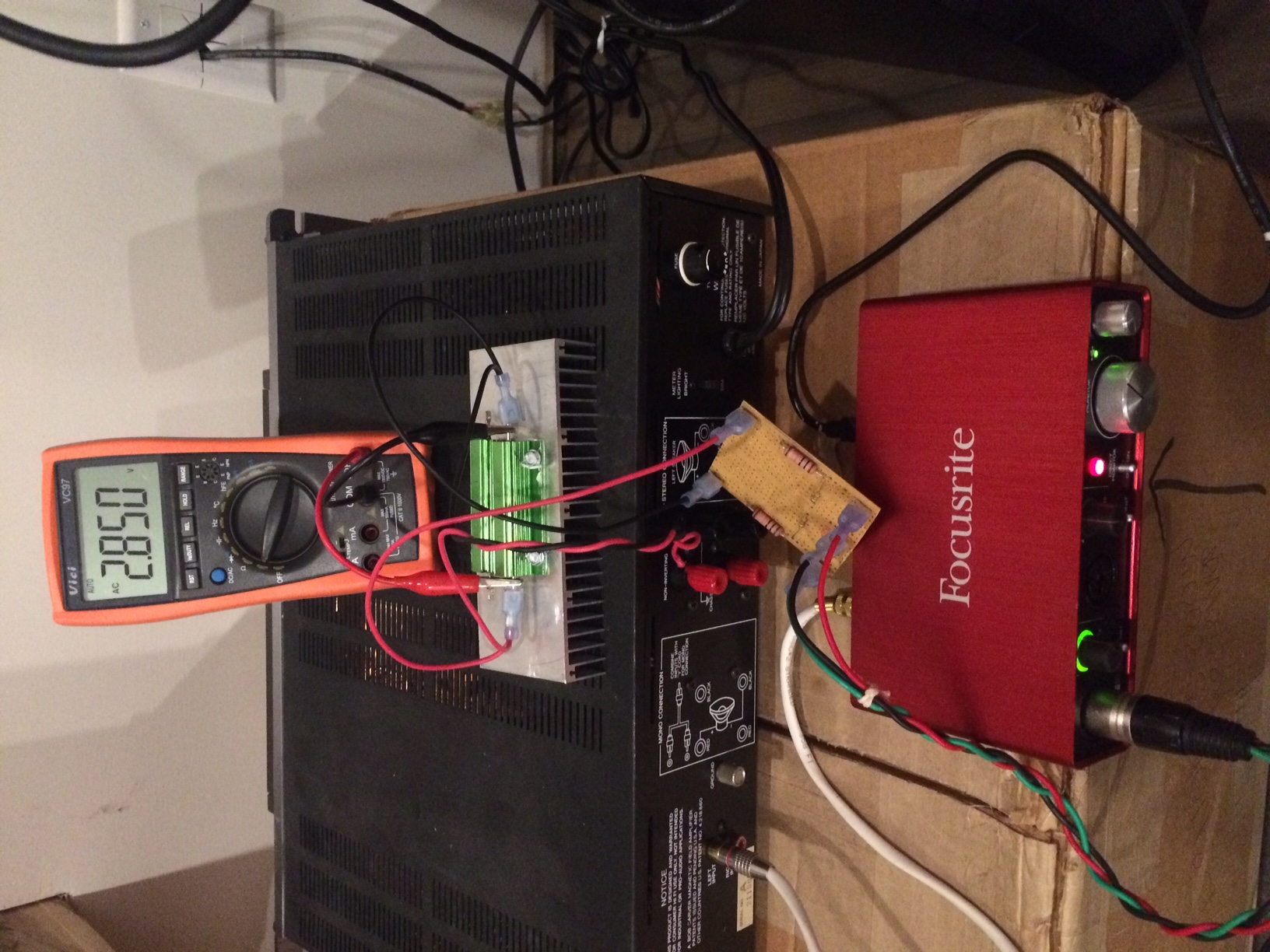

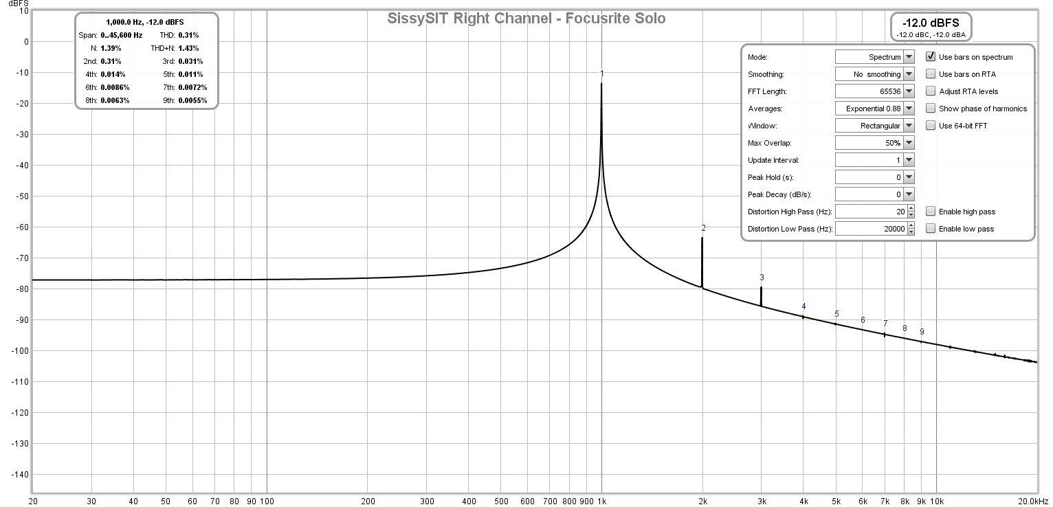

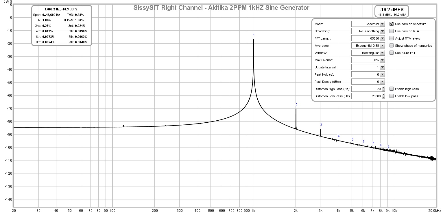

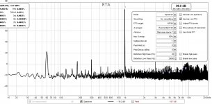

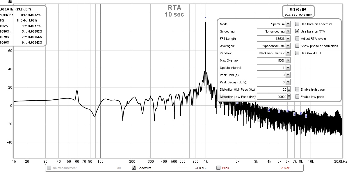

I finally got my Focusrite set up and began with a test on my SissySIT, an F5, Aleph J, and a couple other amps. It's really nice to see the distortion and harmonics, and will be great to tune the P3 on F5 amps using this rig.
When I compare the graphs I'm seeing with what is posted I'm curious why the noise floor up to 1k is at -80dB range, then it trails down up to 20k. It's the same story with all the amps, and even when I switch between Focusrite and Akitika generating the 1kHz wave. The pix I'm seeing in this thread have a more consistent noise floor and more "grass" at the bottom.

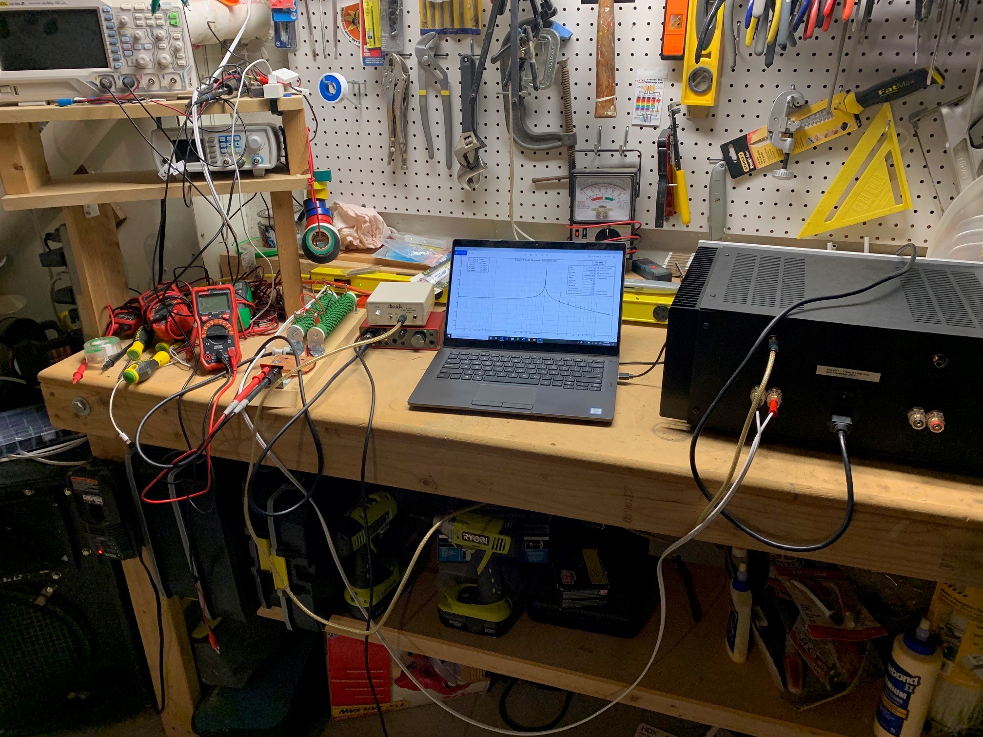

I have some pix of my bench set up and some SissySIT screen shots.
I'm running the PC on battery mode. The power resistor board has a little voltage divider network on it that feeds into the XLR input of the Focusrite.
Any tips to share?
Any tips to share?

Hi Dan, I am relatively new to REW, so I've just been following the settings on the first post, here are 3 different images of the same signal, taken at 10, 20 and 30 seconds after hitting the RTA red button.
I don't see the settings you mention to change dB to dBFS or dBc... I also don't know if I'm getting noise in Loopback - I ran the sound-card calibration and created a calibration file, just like I had from the mike... I thought that would offset the noise from the soundcard and what RTA shows should be just the amp noise...
I did try running RTA with various averages, various window types etc... I still keep getting distortion numbers that get lower with time.(and change values when I change settings) ..though the rate of change seems to slow. (the longer I wait the lower distortion I get...and there is more change from 0-10 sec. than from 20 to 30 sec. (even after hitting the reset average button...)
Maybe this is the way it's supposed to work, I just thought that I would get a steady, repeatable number.
Thanks! - Sixto.

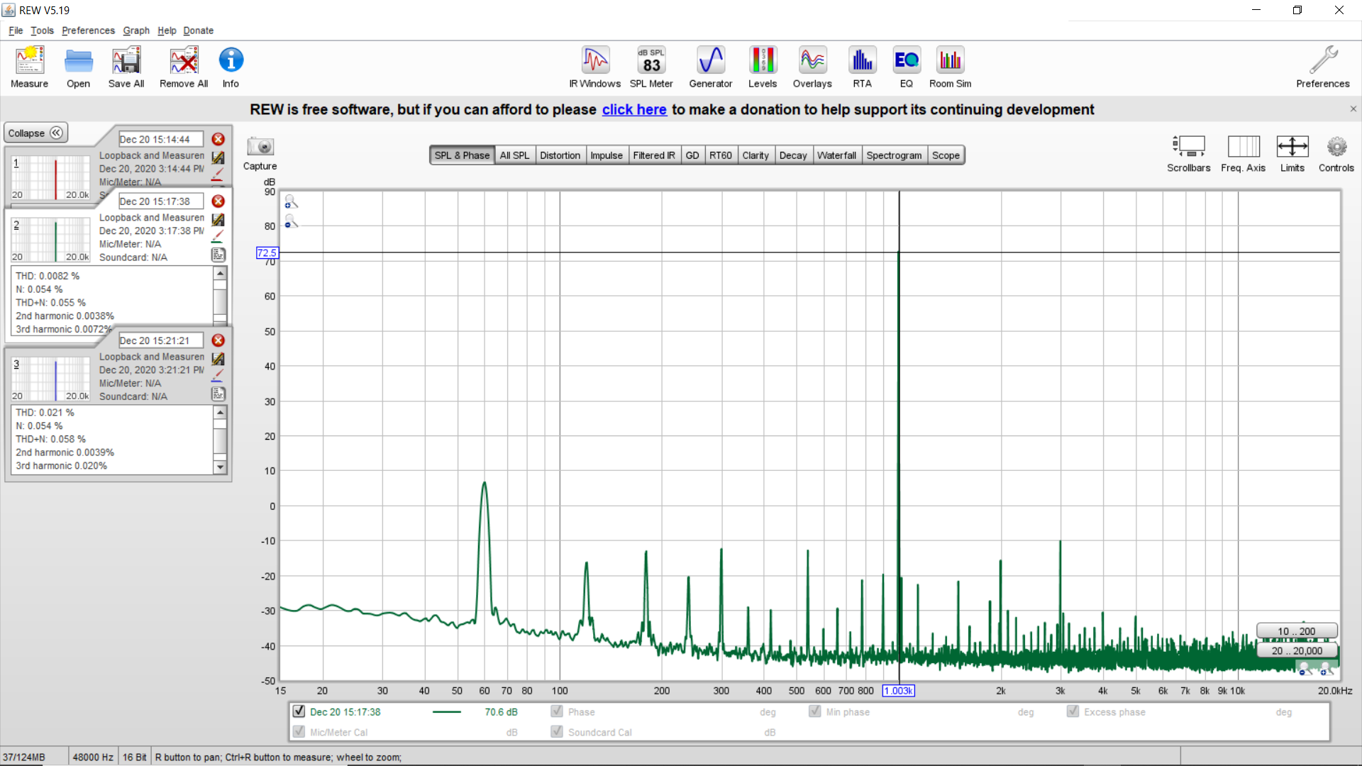

Hi Sixto,
- Ben Mah's comments are correct about how to select dBc etc.
Your last graph looks pretty typical, so you can see the (US) 60 Hz mains noise spike which is significantly higher than your THD by the looks of it.
Also once you set your input level your level you can do a stepped sine measurement so you can see THD at frequencies other than 1 kHz. REW will automatically measure at your selected frequency steps.
Just a tip - prior to stepped sine **check the level is the same as the generator tab**
REW will then give you a graph of THD across the full audio spectrum as long as your ASIO or JAVA driver settings and sample rate in the preferences are at a high enough sample rate and you have selected the appropriate settings to cover the audio spectrum in the stepped sine tab.
(REW will usually give you a message pop up if the setting are not suitable.)
I hope this helps.
- Dan

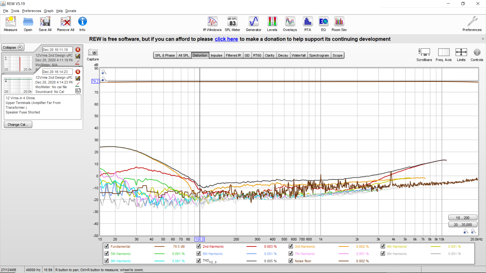

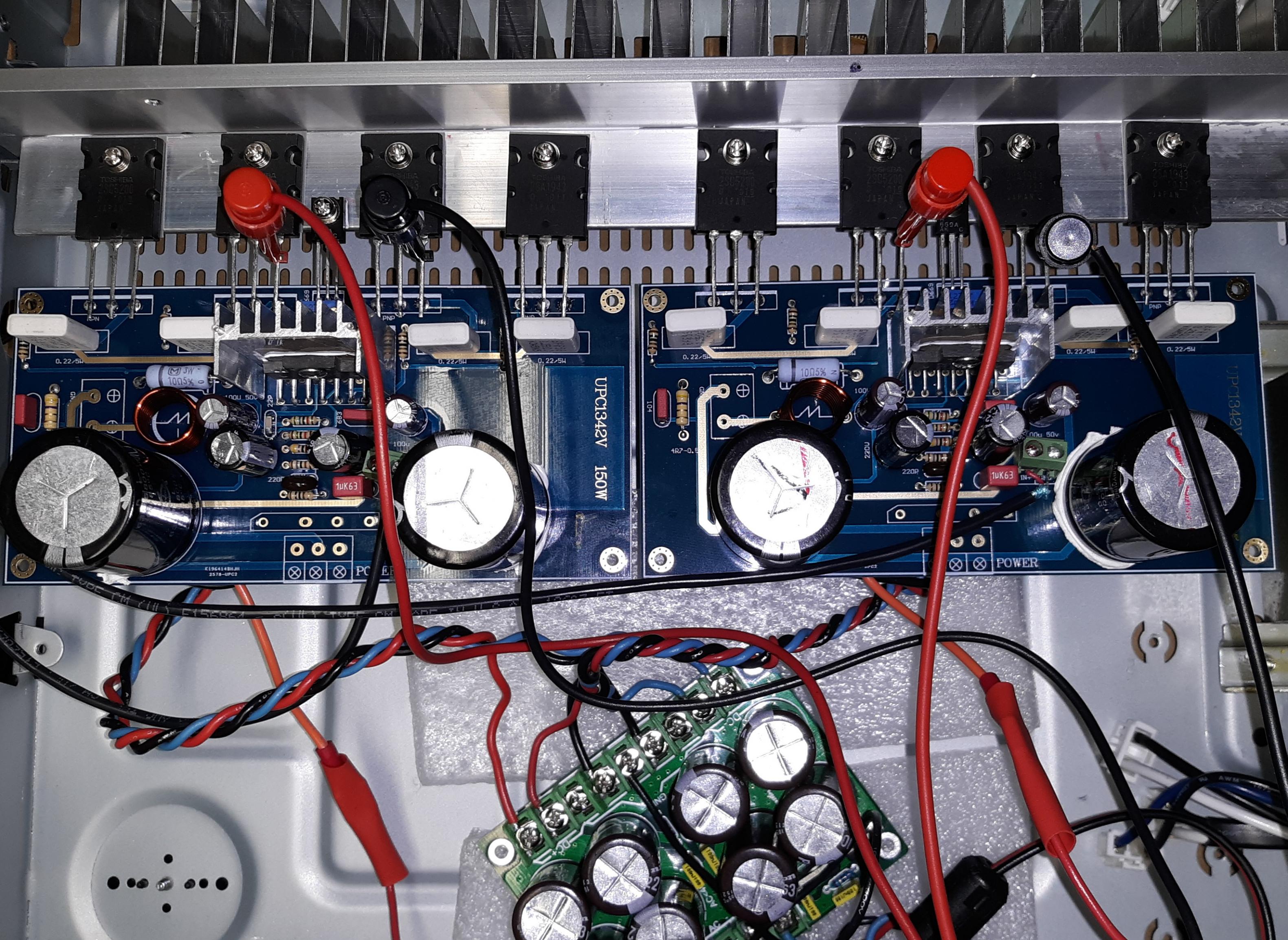

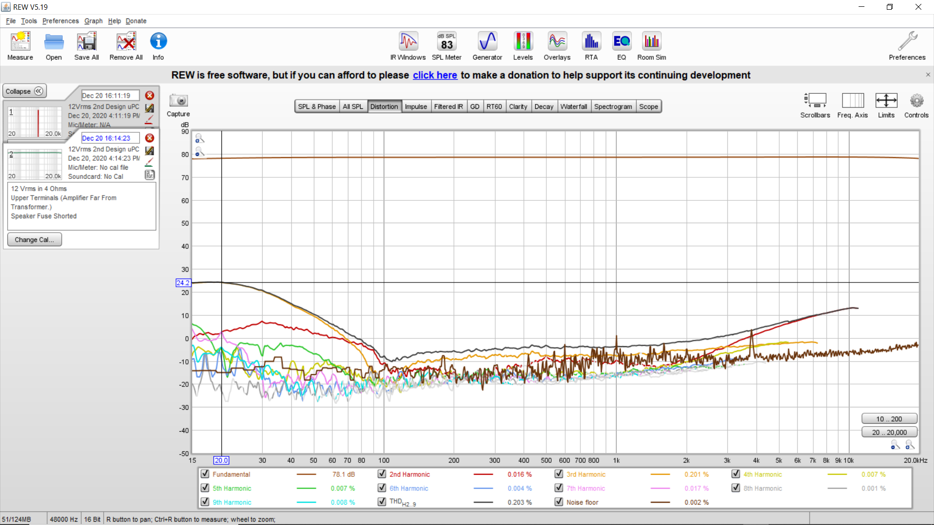

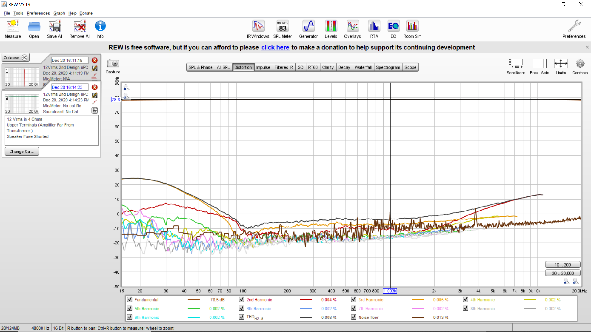

I did my first power amplifier distortion measurements today and I obtained good results at 100 Hz and 1 kHz (inline with what I would expect from the datasheet).
The amplifier is the uPC1342V with two pairs of 2SC5200/2S1943.
However I get high distortion at 20 Hz. (Especially 3rd harmonic.) What would cause that? Is a capacitor too small in the circuit? Or it is something to do with the measurement or setup of REW?
I have attached images and a picture of the amplifier.
The sweep (with screen shots at 20/100/1000 Hz) are at 12 Vrms into 4 Ohms.
The spectrum (1 kHz) is at 8 Vrms into 4 Ohms:
65536-point spectrum using Blackman-Harris 7 window and exponential averaging 0.94
Input RMS 72.6 dB, 72.6 dBC, 72.6 dBA
Distortion at 999.8 Hz, -13.9 dBFS based on 8 harmonics:
THD: 0.0082 %
N: 0.054 %
THD+N: 0.055 %
2nd harmonic 0.0038%
3rd harmonic 0.0072%
4th harmonic 0.00080%
5th harmonic 0.00068%
6th harmonic 0.00022%
7th harmonic 0.00019%
8th harmonic 0.00019%
9th harmonic 0.00018%
As an aside I get 3x higher 3rd harmonic if I do not short the fast blow fuse in the speaker lines (my disaster fuse while testing project amplifiers).
THD 2nd Design uPC1342V 4Ohms 8VRMS Upper Removed Speaker Fuse.png337.5 KB · Views: 217
