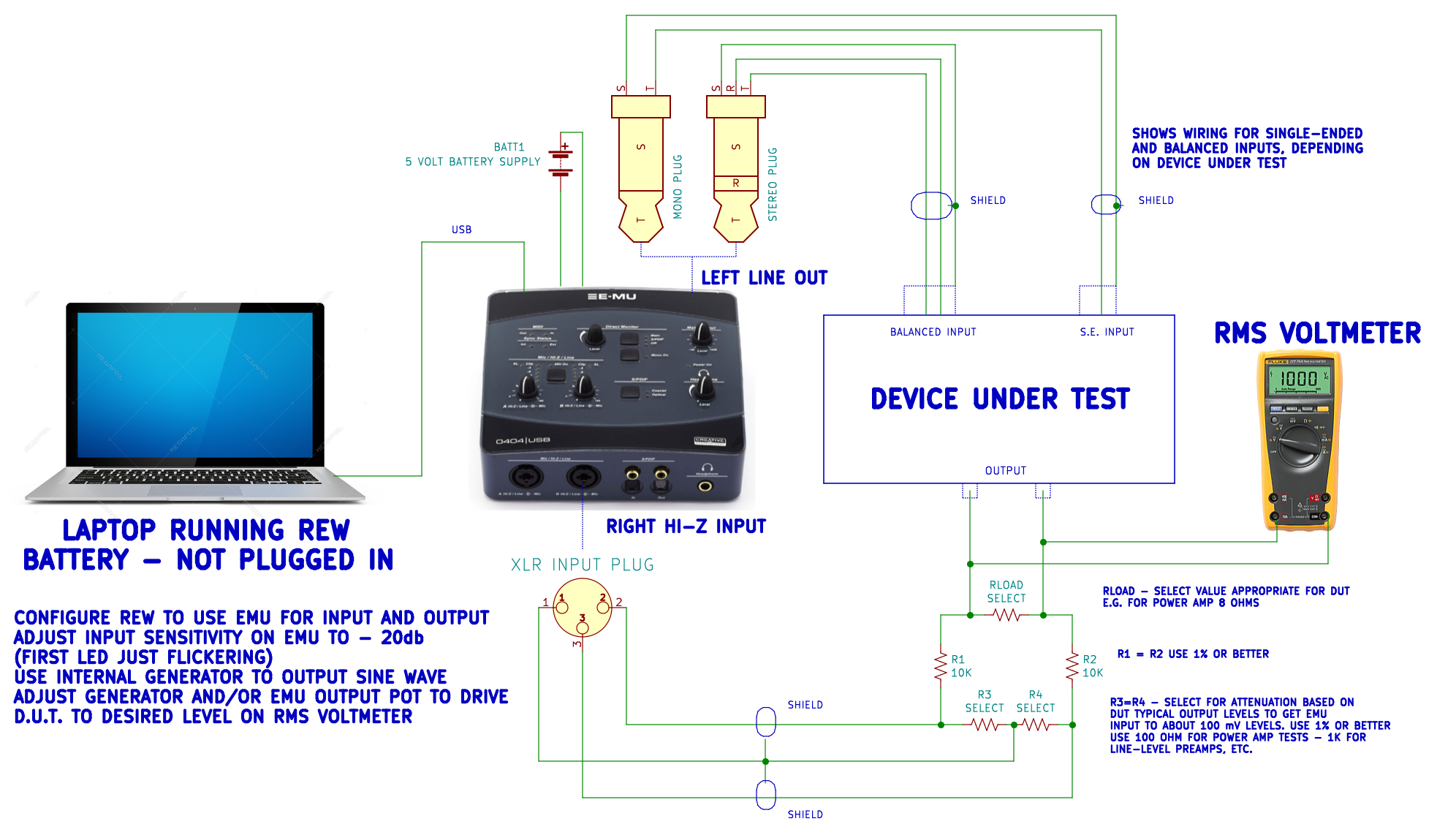

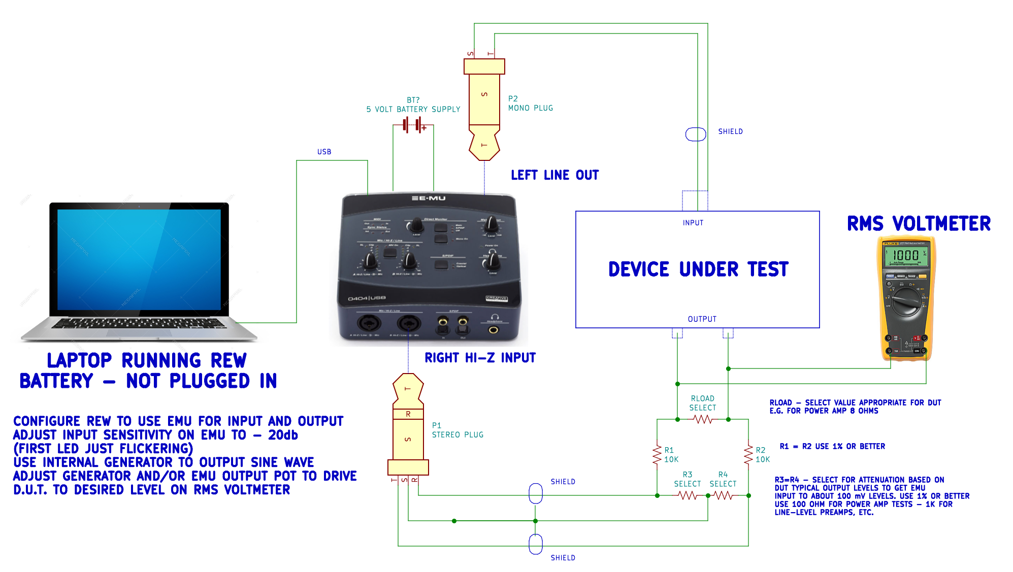

Here is a slightly updated sketch describing the correct resistor values for attenuation under different circumstances. I am also going to test using the XLR inputs because using those for differential signals bypasses the EMU's 5532 opamp input buffers in the signal path for the TRS inputs. Theoretically, this should slightly improve noise and distortion. I'll post a new sketch once I have tested this configuration. Your mileage may vary depending on the input circuitry of your interface.

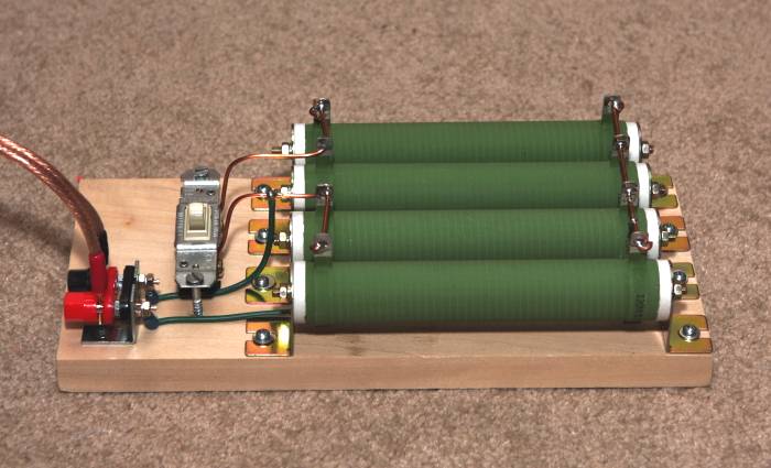

For power resistors, get four of these bad boys for $7 each.
Screw them down to a board side by side, wire them in parallel, putting a light switch between #2 and #3. Now you have a switchable load that is 200+ watts into 8 ohms and 400+ watts into 4 ohms. Then add a voltage divider set of resistors so you can run the output into your sound card.

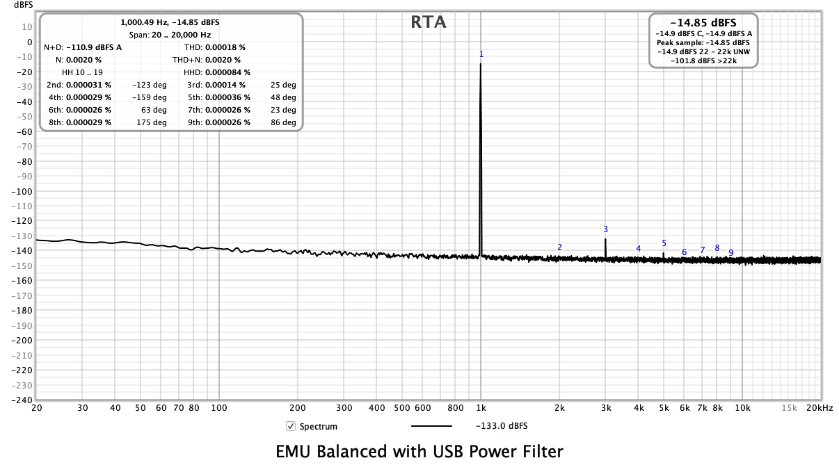

For people using the EMU 0404, here is another setup using the XLR input vs. the phone plug. Internal THD is reduced somewhat since the 5532 input buffers are bypassed. Unfortunately, inherent noise does not change much - see the attached FFT of the EMU looped back to itsef. This also shows how to use the EMU output for single-ended or differential input devices under test.

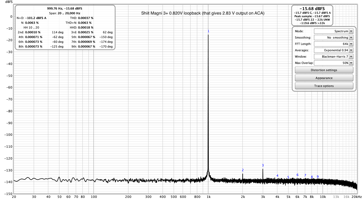

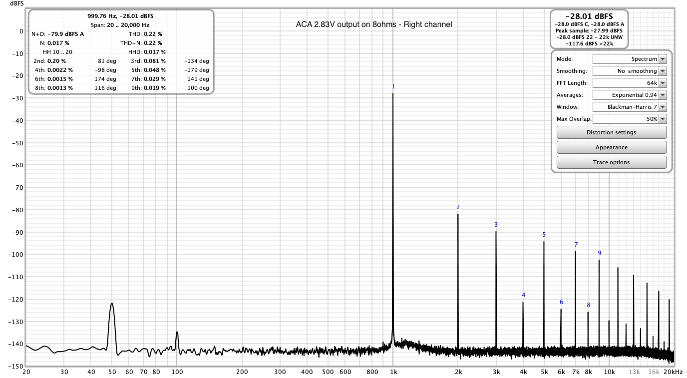

Hi! I did some experimentation with Focusright Scarlett 2i2 and measured my ACA and M2X. Got some strange results is one case and would be happy if the community could comment on that.

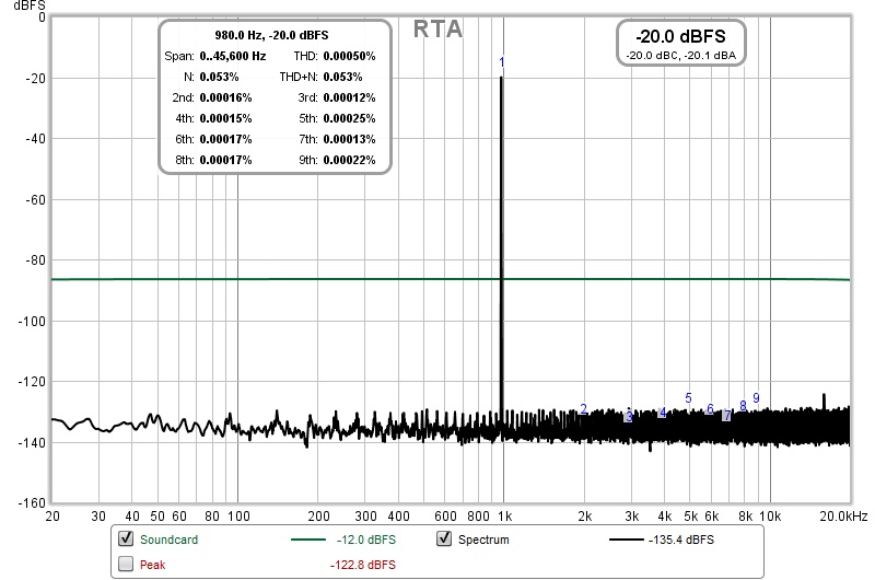

My setup was as follows:
- I used internal generator of RAW, set at -10dBFS, 1000Hz
- that gives about 360mV on the output of 2i2 with max monitoring volume, and it's not enough to get 2.83V on the output of ACA or M2X
- so I routed the signal via Shiit Magni 3+ pre-amp on 5.5x gain, setting the volume at the level that gave 2.83V measured on the output of the amplifier (it required 820mV output from pre-amp for ACA and 535mV for M2X)
- I am still waiting for the 8ohms 100W load resistors to arrive, so I measured with the actual speakers (Overnight Sensations) connected
- 2.83V signal from the output of the amp went (in parallel to the speakers) to the line input of the 2i2
- 2i2 line input can take up to 22dBu (9.75V), so I did not use any voltage divider network
- the gain of the 2i2 line input was set to minimum

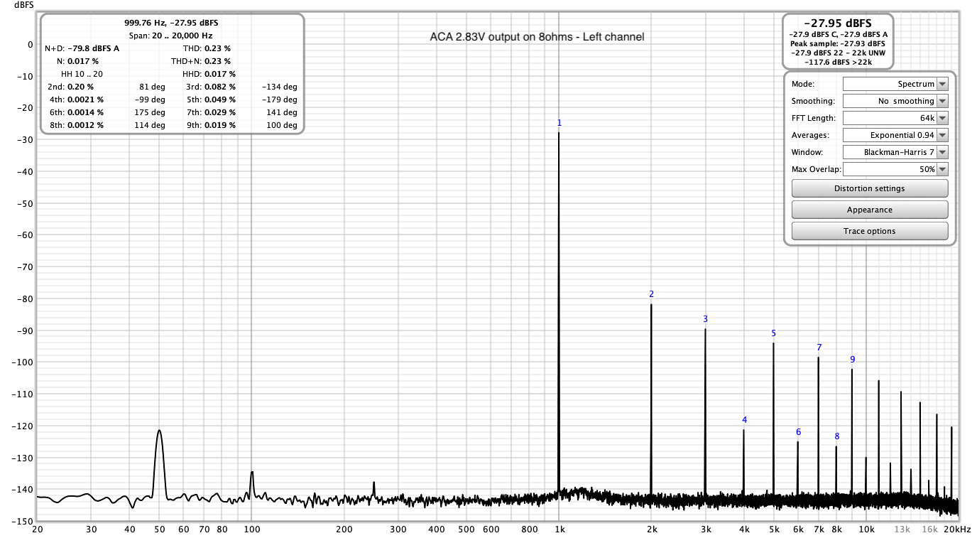

I got nice and consistent results on my ACA (see the 3 first pictures: Left channel, Right channel and the direct loopback from pre-amp to check that pre-amp did not introduce any significant noise or distortion). THD measured at 0.22% (much better than oficialy stated 0.7% distortion of ACA), and it is 2nd harmonic dominant, but I see the whole handful of other order harmonics, and mainly odd-order harmonics. Also notice that the phases of harmonics are very consistent between the channels (just 1-2 deg of difference between the channels). The hum from the mains is low and really not audible in reality.

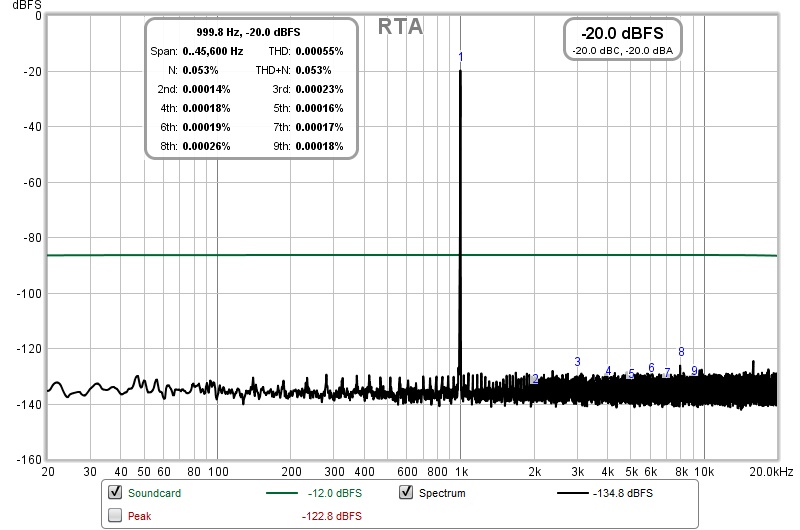

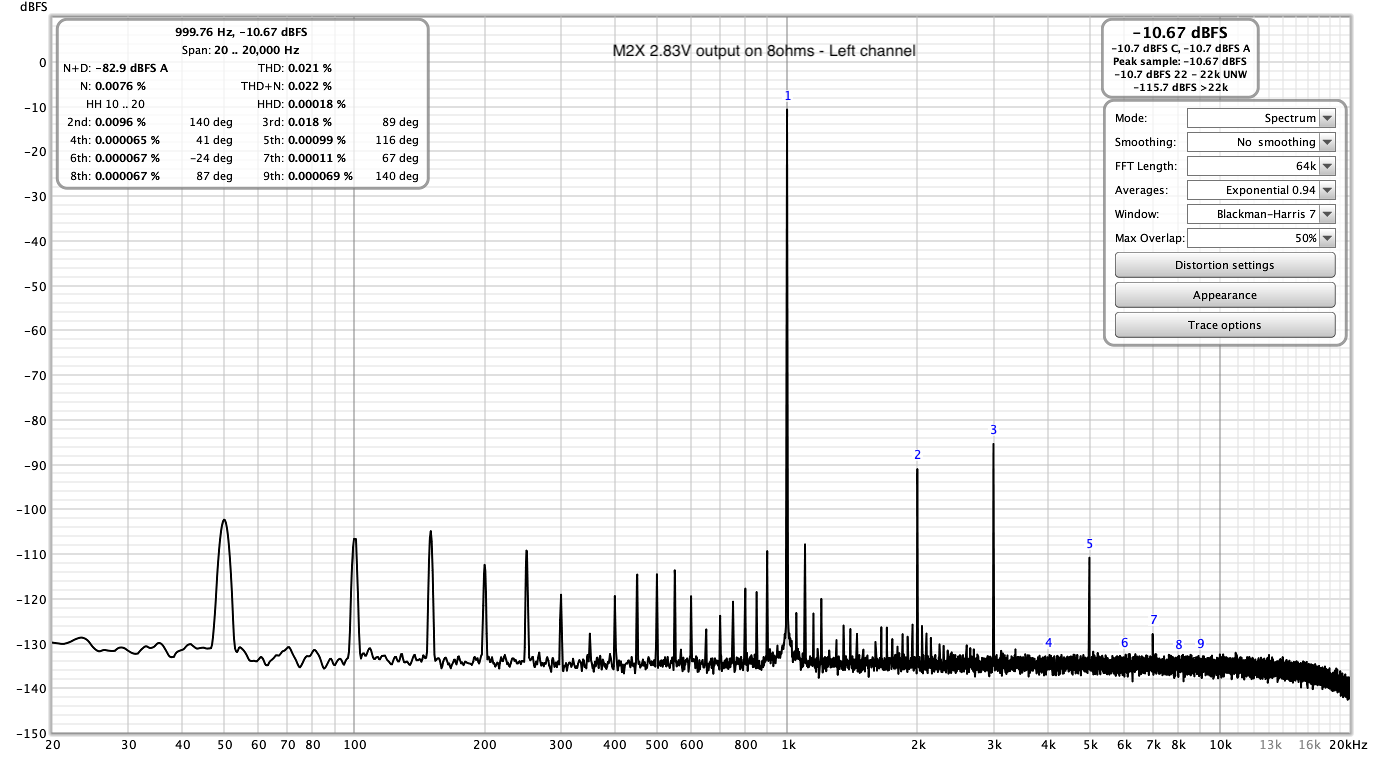

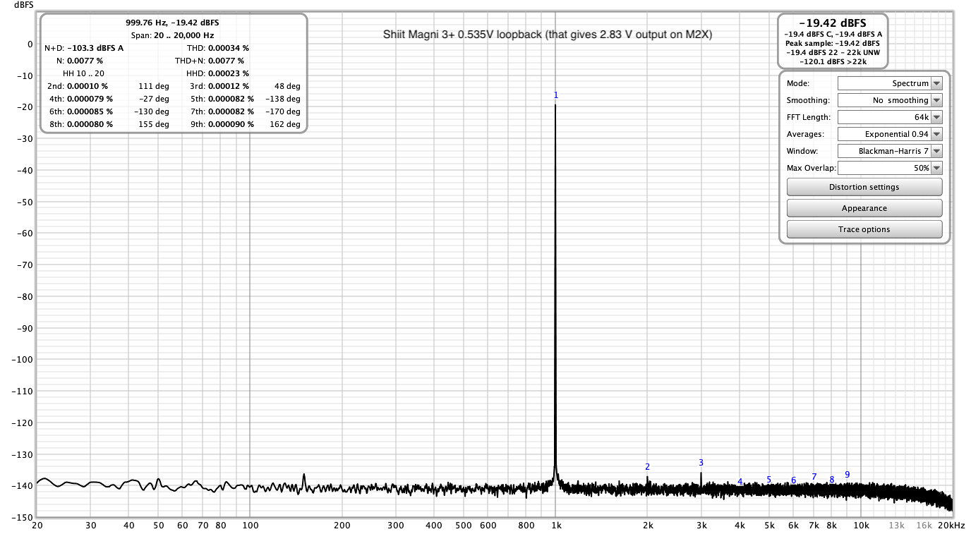

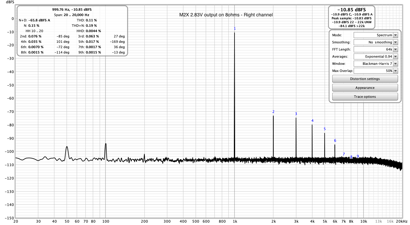

With M2X I got mixed results that I do not fully undestand.
Left channel measured well and as expected. THD 0.022% (very close to "official" 0.025%), 3rd harmonics dominant with nice 2nd and a bit of 5th - very much as described by NP (my M2X is with the Tucson buffer now). Hum from the mains is very visible and this was also expected - neither toroid not the auto-formers are shielded yet in my M2X (waiting for the steel cover for the transformer and mu-metal for Edcors to arrive). This mains hum was actually the main reason of these measurements, as I wanted to see it before I make changes and then compare.
But on the right channel I am confused. Please see the picture (5th picture in the attachments). The overall noise floor rose by 25dBFS (from -130 to -105) hiding in effect much of the mains hum, and the harmonics look much different than on the left channel (and if you look at the phases of harmonics, they are totaly different than on the left channel - though in ACA measurement the phases matched almost perfectly between the channels).
What happens here? Why the increase in noise floor level?
I tried to change the loudspeaker used as a load, but same result. If you feed less V to the input, the noise floor on the right channel drops, but with inceasing levels of input the noise floor rises. But it does not rise on the left channel.
Does that hint to some problems in my M2X right channel? What could that be?
When listening to the music, though, I do not hear anything specific on the right channel, it plays as fine as the left to my ears.
Any ideas, please?
