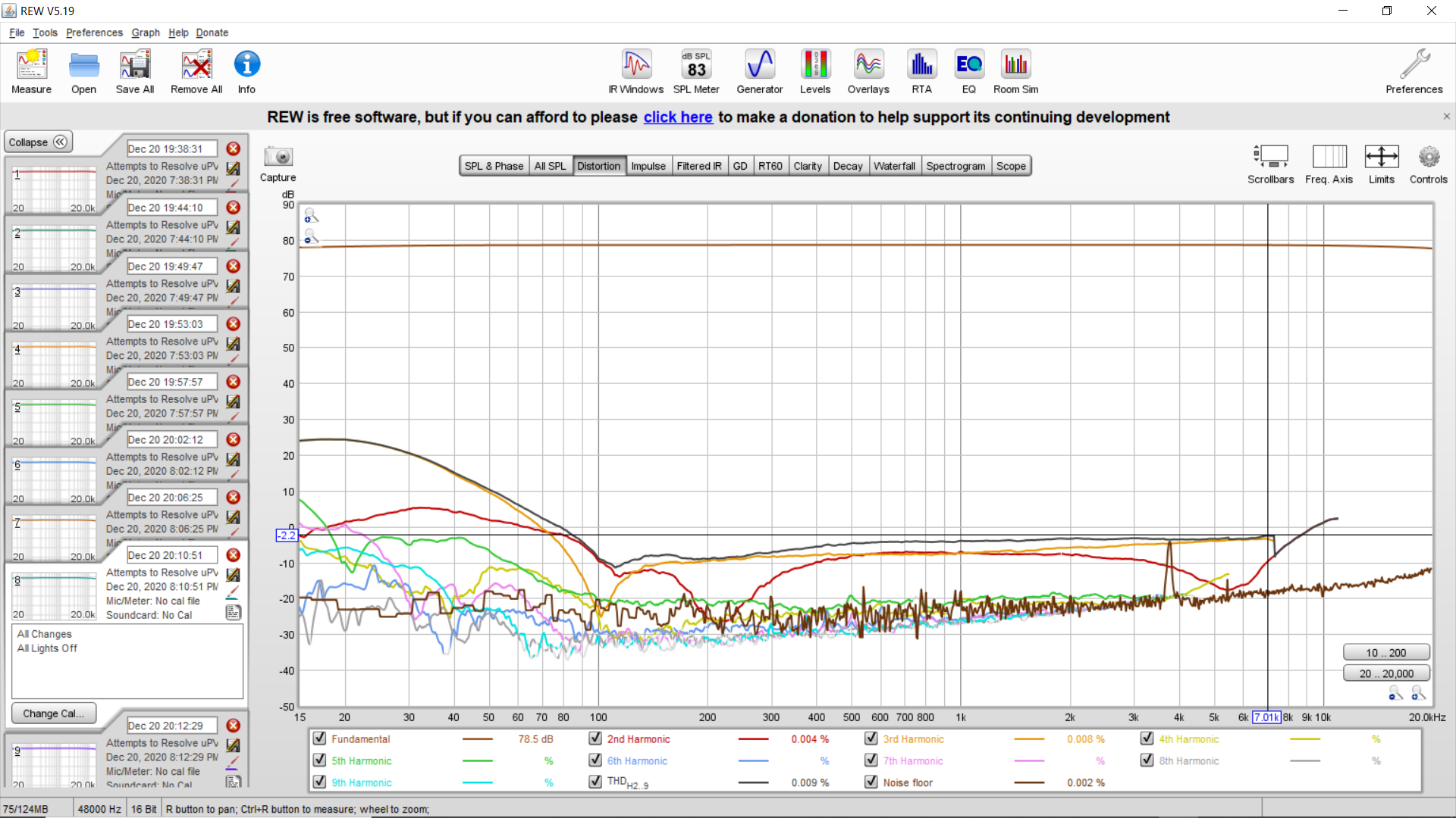

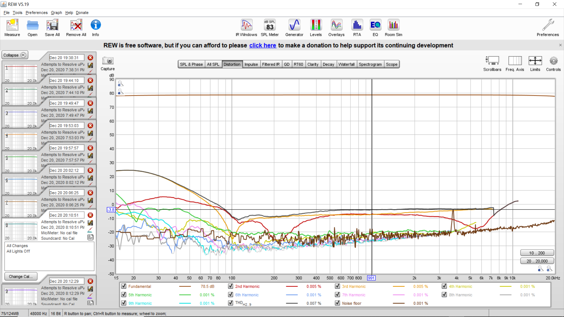

@kozard, I think you have high 3rd harmonics at 20Hz because you have hum from the power supply at 60Hz and this is added as your "3rd harmonic" of the signal of 20Hz. Same for "2nd harmonic" for 30Hz etc.
I was wondering about that but it is a 60 kHz switching power supply with two stages of CLC filters.
And I was wondering if it should appear as peaks of distortion at 20 Hz, 30 Hz, etc. But it seems to be a smooth function starting at 20 Hz extending to 100 Hz.
I wonder what I can do to the measurement setup to reduce 60 Hz pickup.
Well I have tried a number of changes and so far nothing has changed the 20/30/60 Hz related distortion.

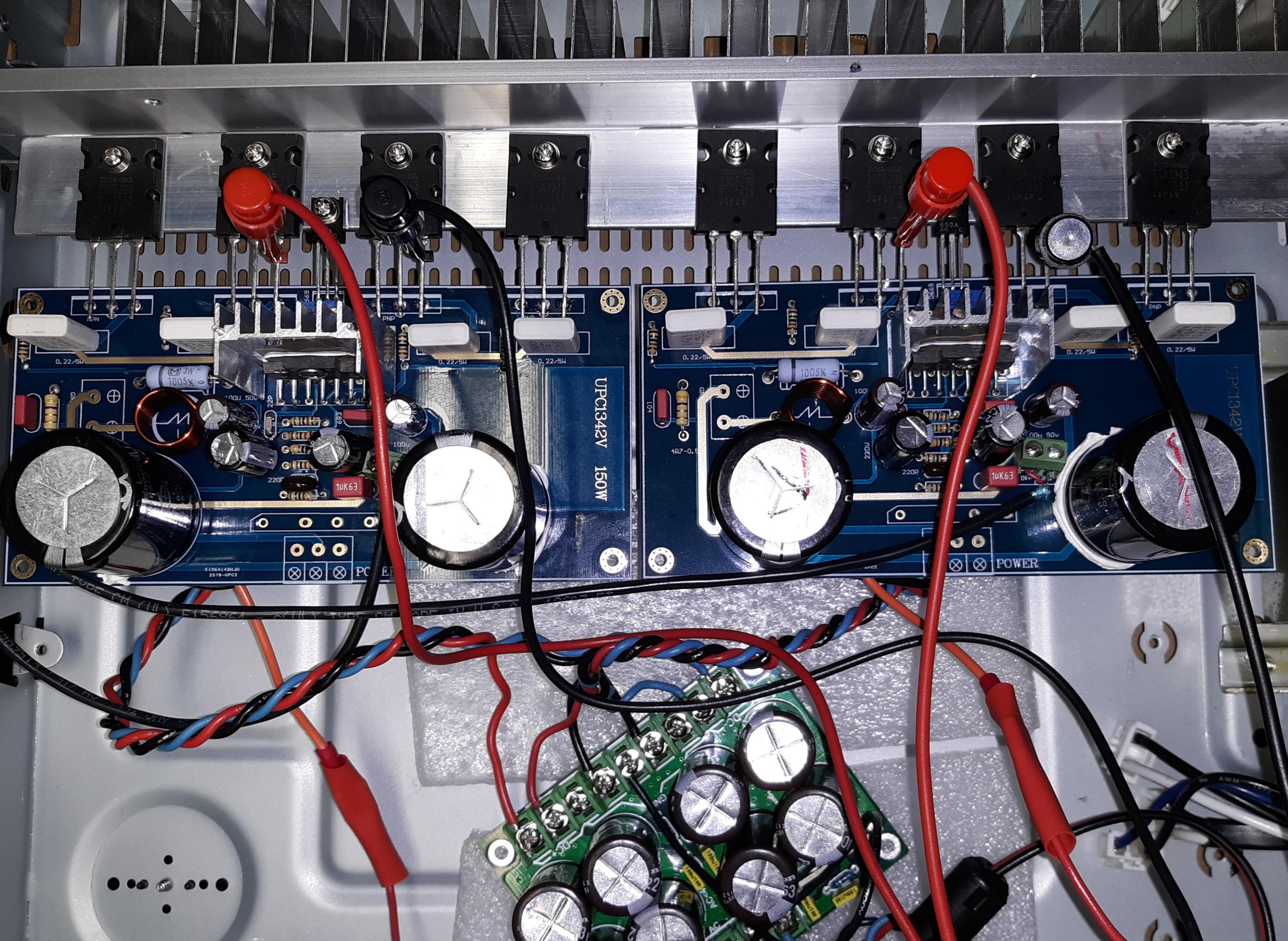

I tried moving the star ground. Putting the chassis cover on. Shielding the potentiometer with copper foil (and grounding the foil to the star ground). Moving the speaker adapter output cable and coiling it tightly. Nothing changed.
I replaced the USB cable with a shorter and better looking one (shield looked better). No change. Turned off all the lights (some LED, some fluorescent). Nothing changed.
I tried moving and tightly coiling the shielded input (to the amp) cable. The low frequencies did not change at all. But the HF (7 kHz) distortion improved to 0.009% THD at 12 Vrms into 4 Ohms. (See attached.)
Any ideas/suggestions on fixing this low frequency issue? What can I check or try? This amplifier sounds very nice and the THD looks good, I just want to understand and fix the low frequency THD issue.

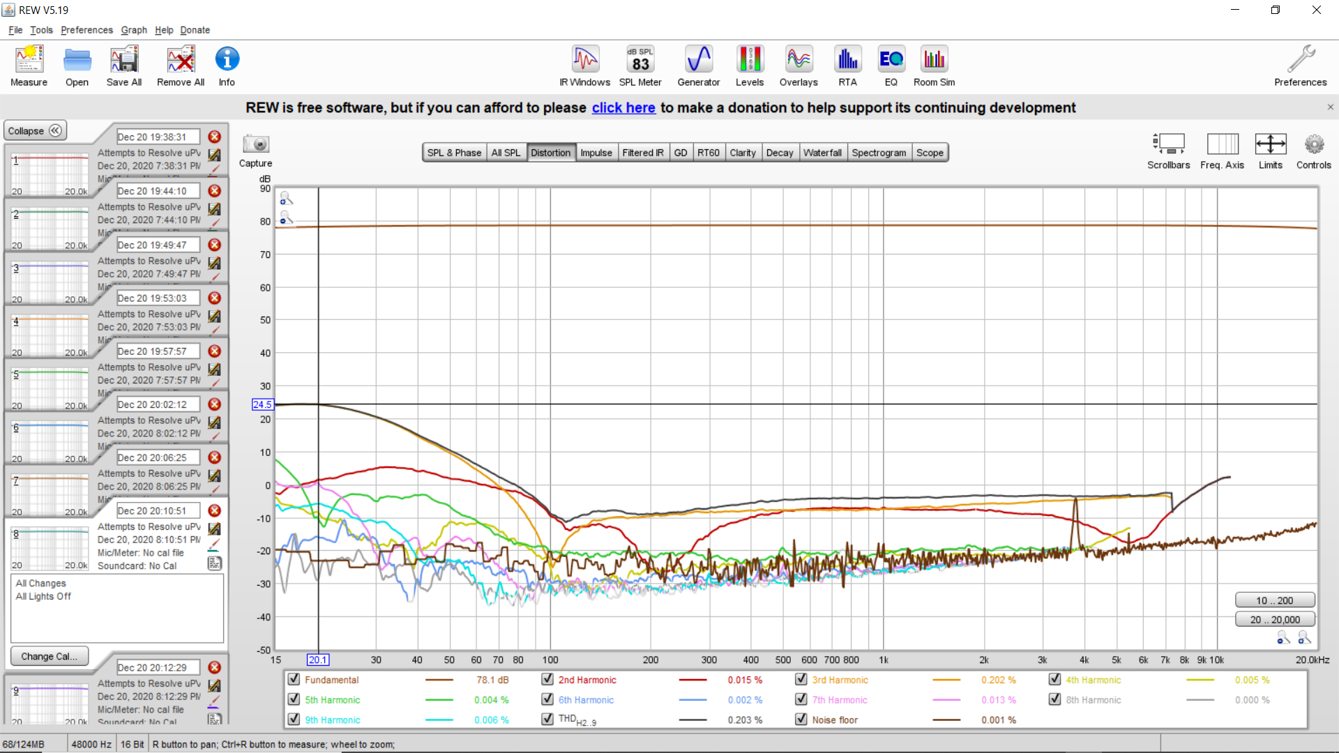

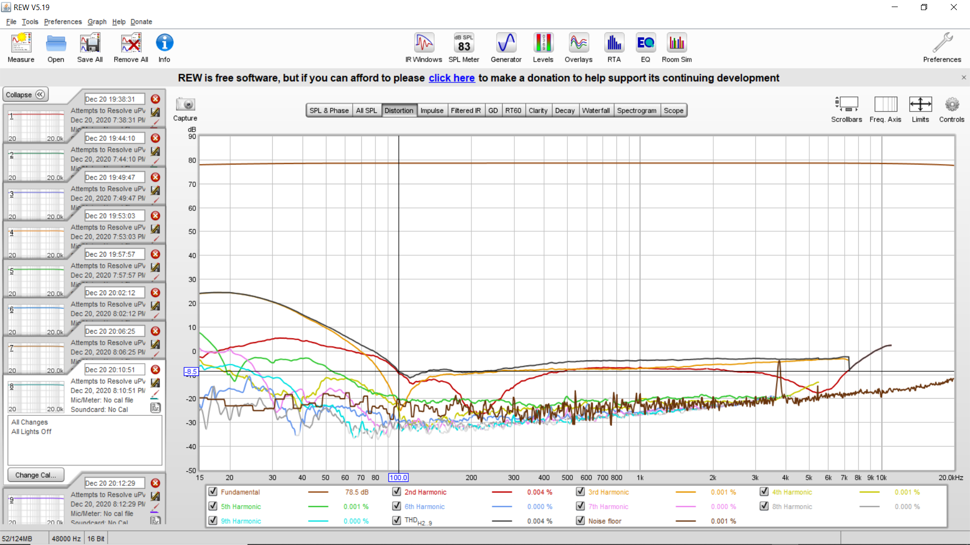

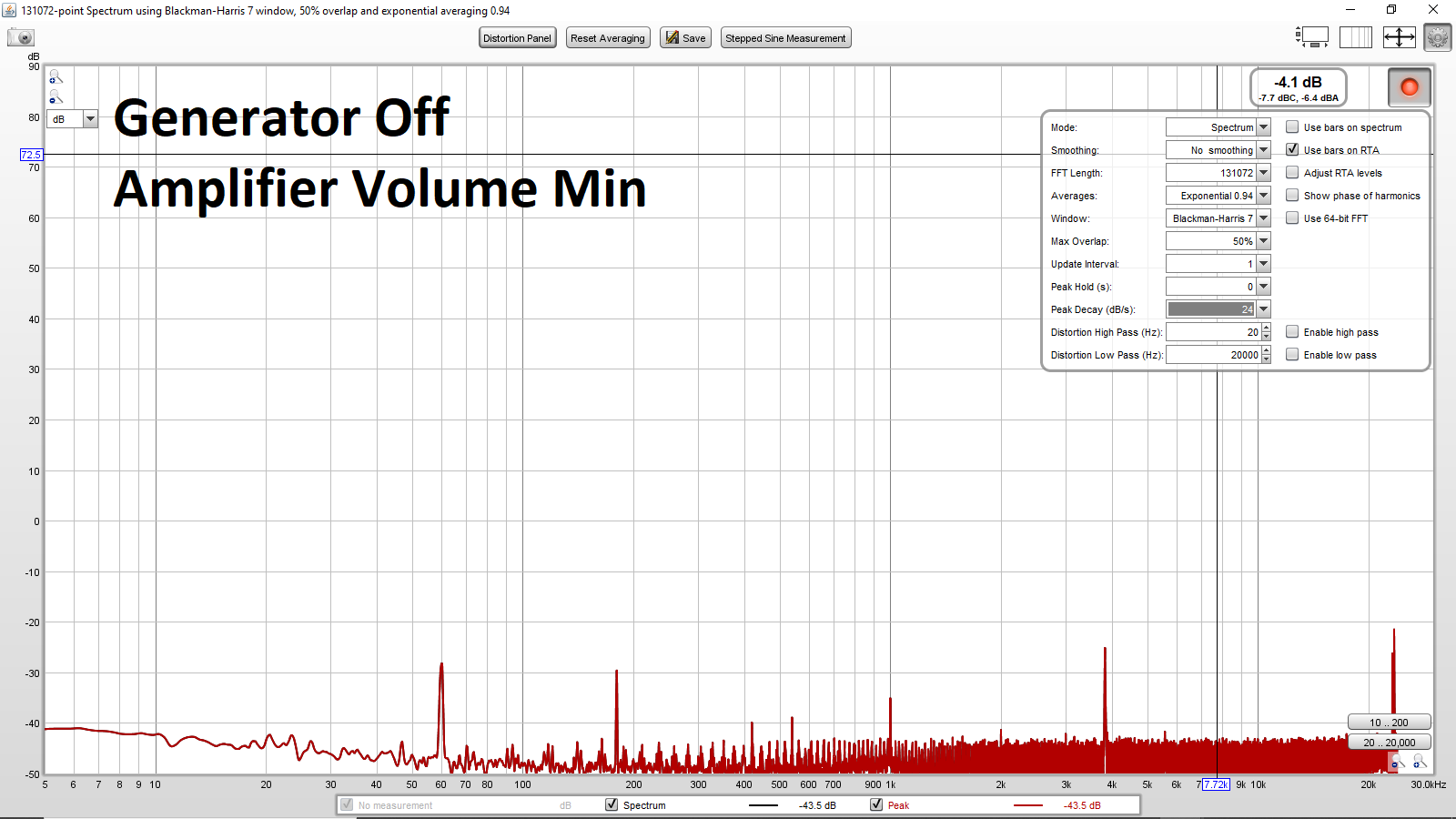

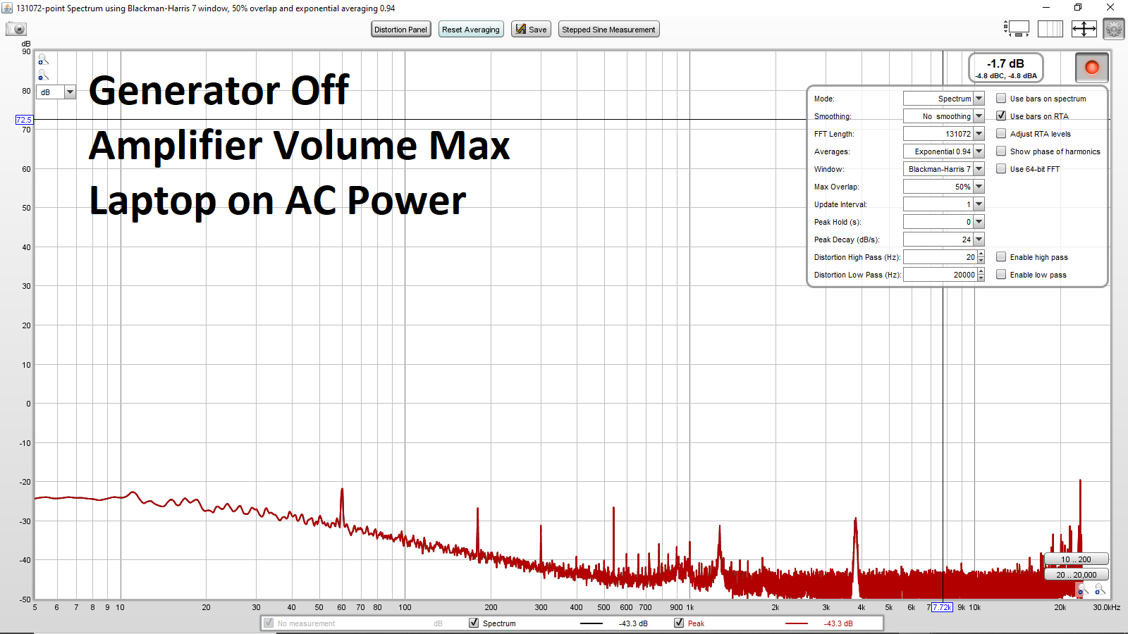

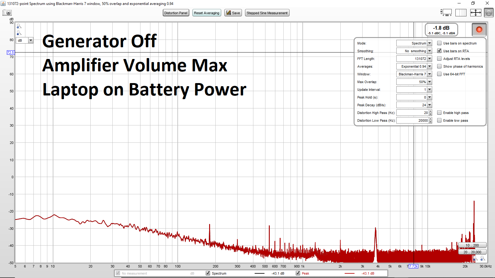

I was using a notebook but on AC power. I did additional measurements this morning on AC and battery. While it is possible to see a small difference in 60 Hz on battery power the LF distortion does not change much at all. My audio interface is USB and 24 bits so I think I am a little bit isolated from 60 Hz from the laptop. But there is still some quite far down. (About 102 dB down from full scale output.)
With my ear up to the speaker I do not hear any hum at all. Silent. (Amplifier volume at maximum. Same with the laptop on AC or battery power.)

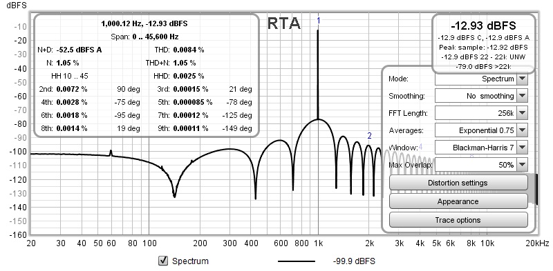

I have attached RTA screen shots with maximum and minimum amplifier volume and laptop on battery or AC.

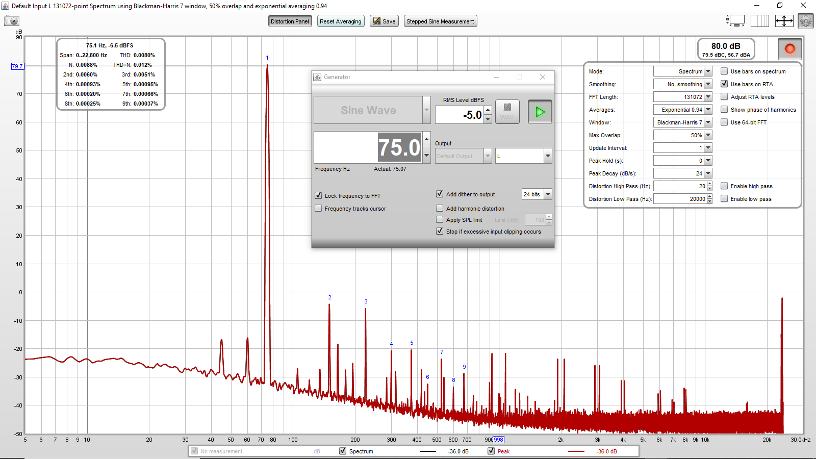

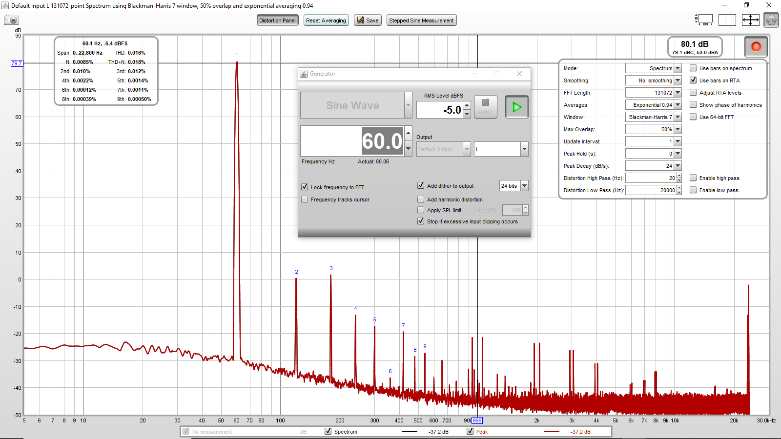

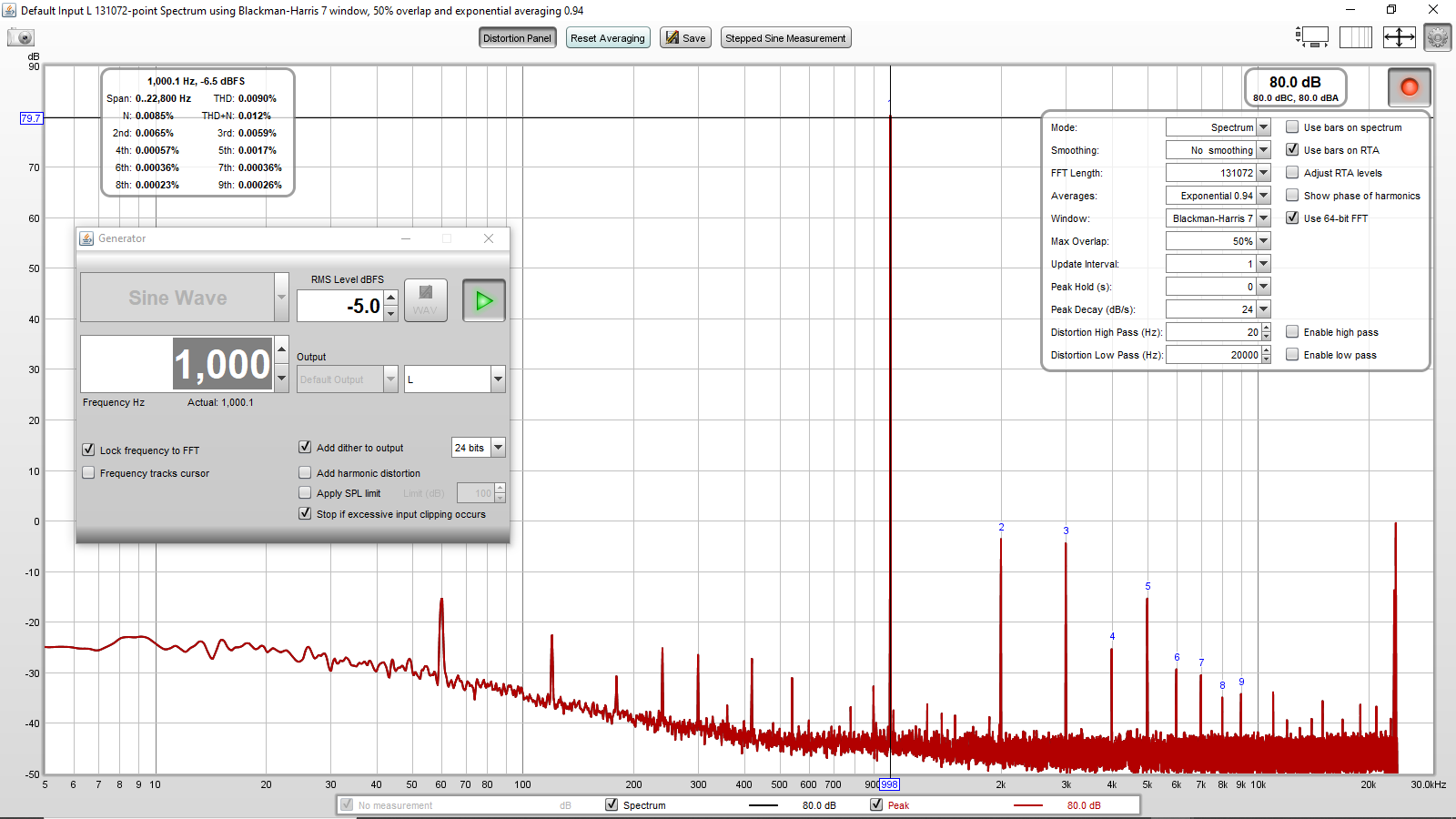

Max I can run is 128k FFT (attached at various frequencies). All are at 12 Vrms into 4 Ohms. This time I ran on battery power.
I assume that my 75 Hz measurement proves that it is 60 Hz? Where is it coming from since there is almost no 60 Hz when the amplifier is at maximum volume but no input? I am surprised since it is a SMPS with massive filtering. (Especially massive considering the switching frequency.)
1st LC filter has: 4x1000uF low ESR inside the SMPS per rail.
2nd LC filter has: 4x2200uF low ESR added outside the SMPS per rail.
3rd C filter (on each amplifier module): 6800x2 uF
I guess under load my SMPS somehow has fairly big 60 Hz noise on the output? But almost nothing unloaded? I was hoping the SMPS would not do anything like that.
Is my interpretation correct? I need to still somehow improve the power supply but that the amplifier is ok?
From what I see, it looks pretty normal for me - quite normal spectrum with mainly 2nd and 3rd dominating harmonics. If you don't hear any LF hum from the speakers, I would not go crazy about the measurements in LF - this is not the most sofisticated measuring equipment anyway. So - enjoy your music! 🙂

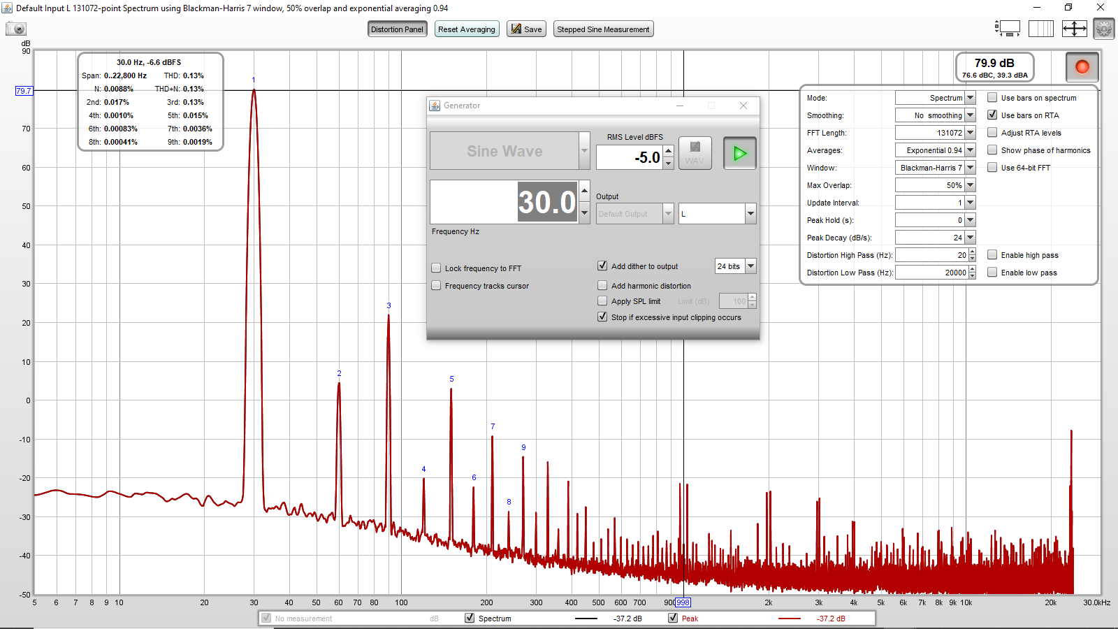

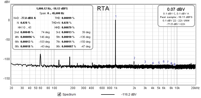

At that power level, the 60Hz noise is about 95 dB down, so it is pretty much swamped out by the signal. It is probably sneaking in through the supply. If you are using an SMPS, you could try adding larger caps across the rails, but that might prevent the SMPS from starting up correctly - they can be fussy about heavy capacitive loads (one reason I do not like them).
I would not worry about it too much - if you are sure that this is not coming from a ground loop or the wall wart for the D/A converter (use a battery for that and float everything to be sure) then let your ears be your guide. I am guessing the main effect at high power levels would be a very slight garbling of music coming from the speakers (60 and 120 Hz modulation).
