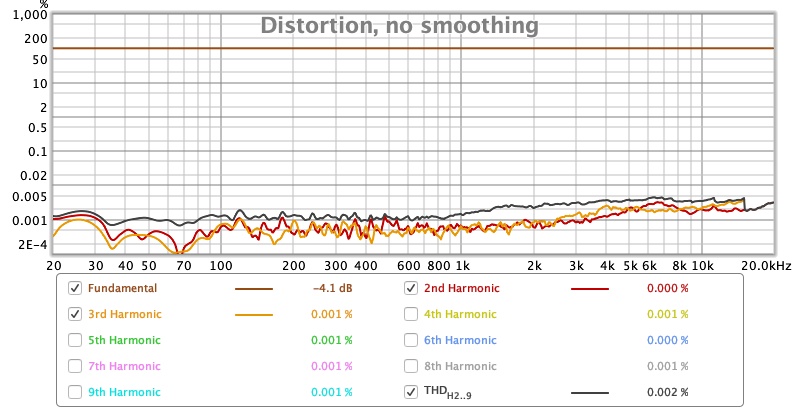

Any screenshots for comparison? Thanks.

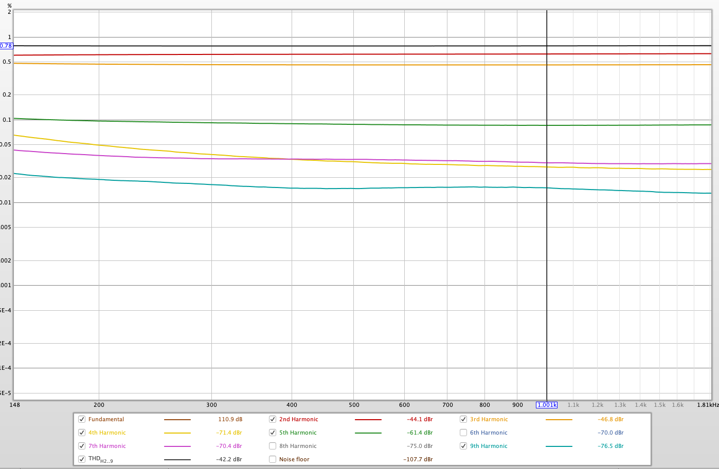

Measured at @19.9V/50W
Frequency/THD plot is pretty much the same as RMAA, but RTA showing much higher THD. I start thinking it is because the amp has high current choke CCS, so hysteresis due to continuous 1K tone of RTA may cause the difference.
Please let me know what you guys think.

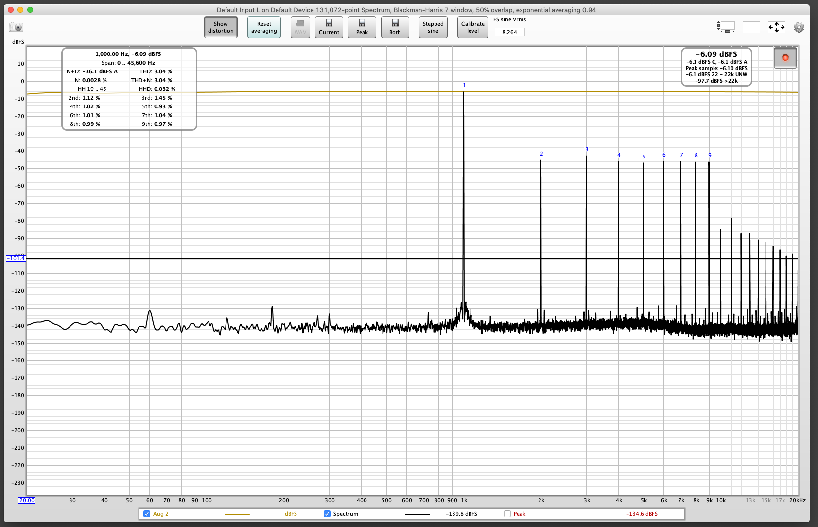

Okay, I just checked AD/DA loop and it seems like a REW bug. I'm using REW for OSX Mojave, which is still public bata. RTA was working fine last time I checked ADDA loop, but it does not any more for unknown reasons.

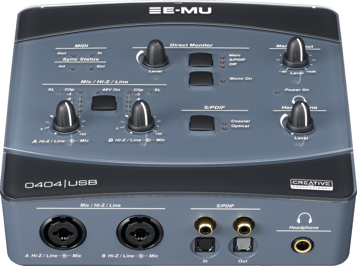

EMU 0404
I resurrected an old EMU 0404 USB which had gathered dust ever since EMU stopped supporting the drivers on anything beyond Windows XP.
I discovered an actively maintained macOS driver here: GitHub - Wouter1/EMU-driver: OSX Kernel extension for Creative Labs EMU driver and since I have moved to a Macbook Pro as my main computer, that was a pleasent surprise.
The REW calibration tool yielded some not so bad results, so I am happy to begin some amp testing with this as my audio interface. 😀
