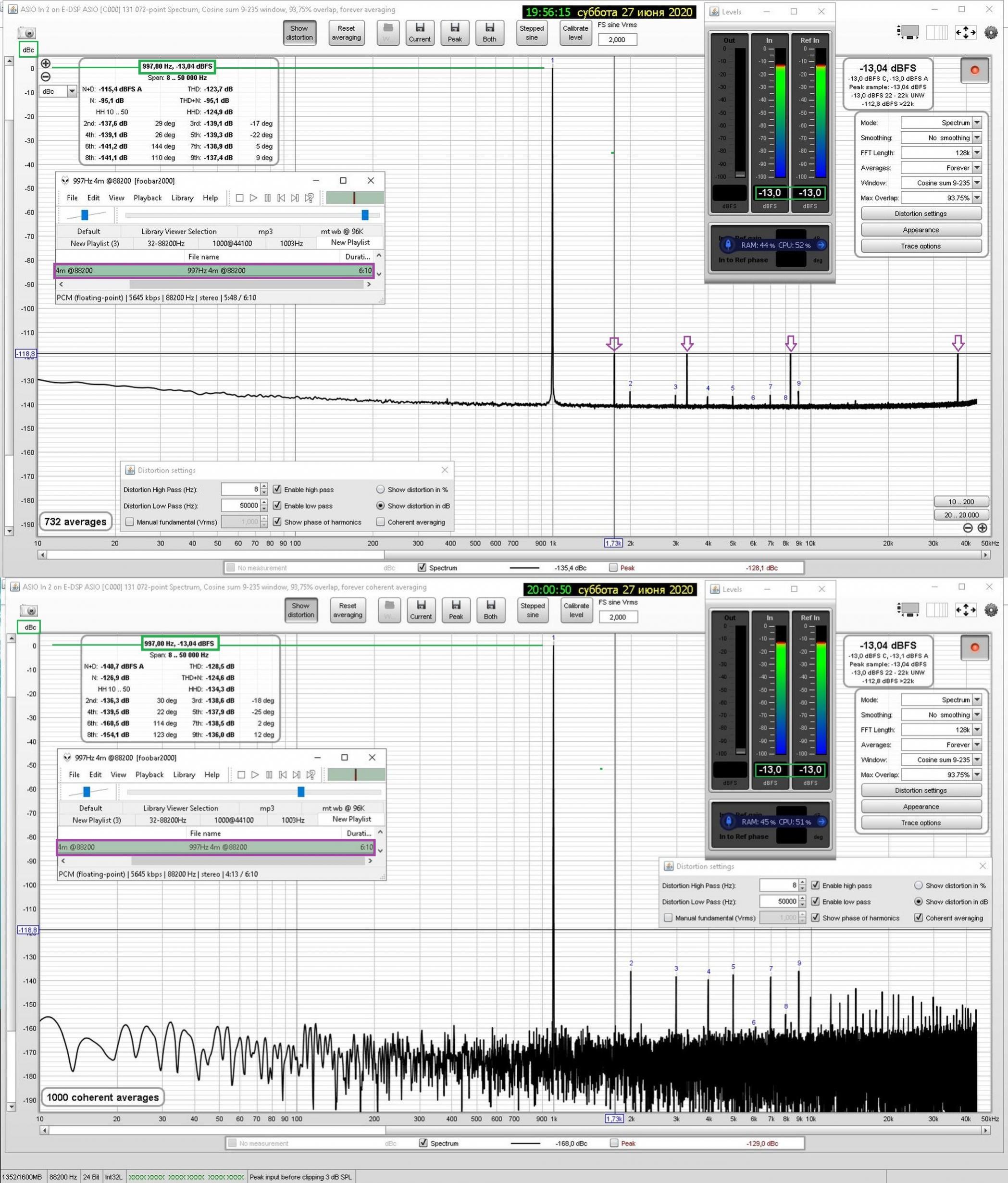

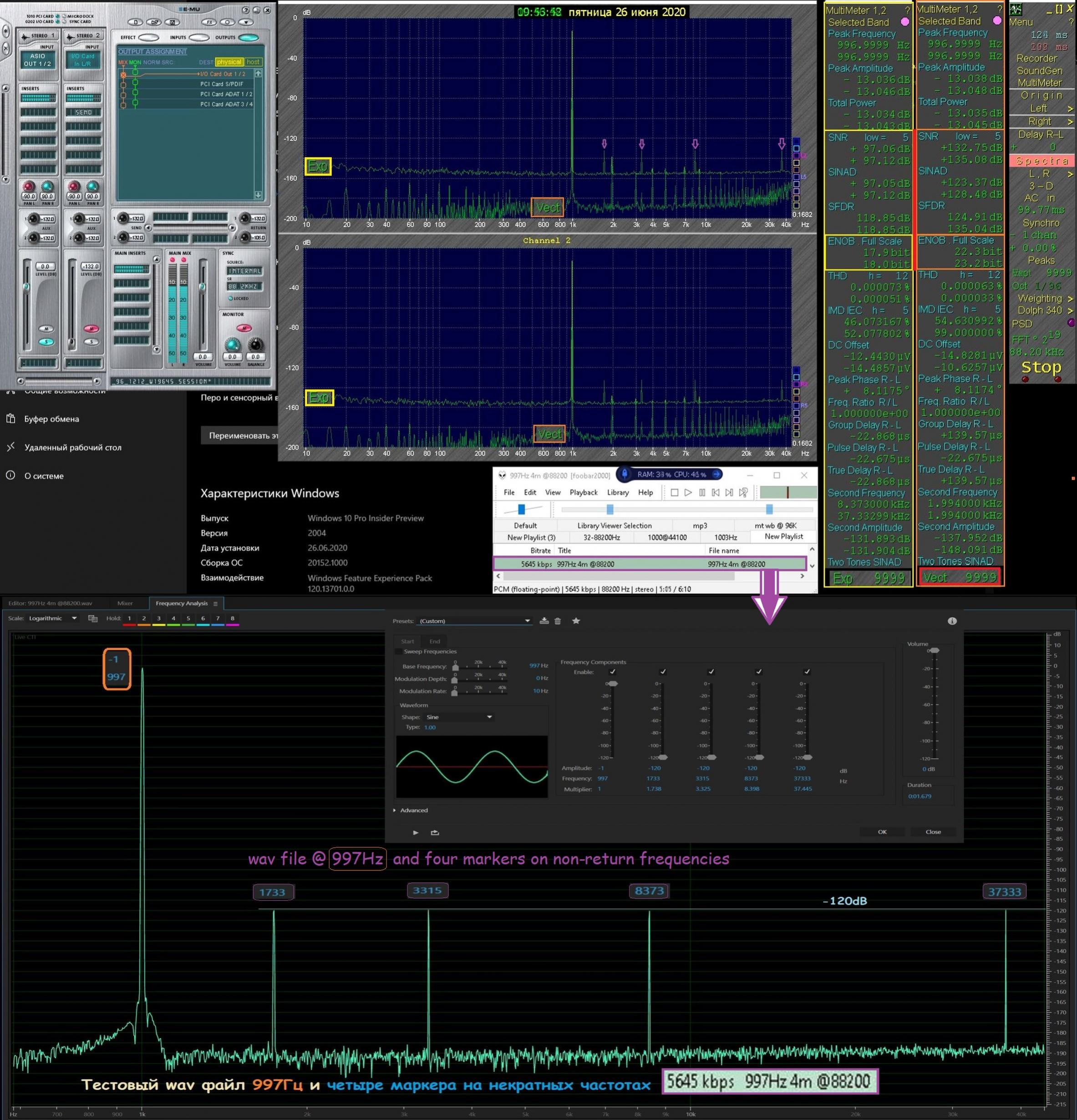

2 Experiment
wav file @997Hz and four markers on non-return frequencies

wav file @997Hz and four markers at frequencies not multiples of the main frequency.
I am happy 👍with programs that allow you to look under the noise blanket! ...please forgive me for the inaccuracy.
No it's no problem, I was just curious where those marker frequencies come from. You put them in to be able to 'calibrate' the display?

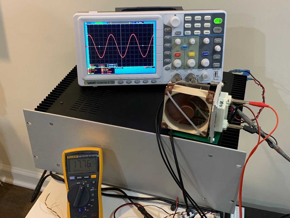

I have lately switched to using precision EBG UXP high power thin film high power load resistors. They have a large thermal pad for mounting heatsinks and they are absolutely non-inductive. Here I am using a 300w resistor fitted with a CPU cooler and a fan to test a Class A amp.

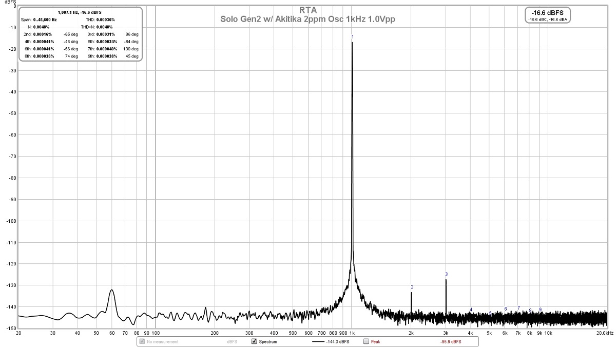

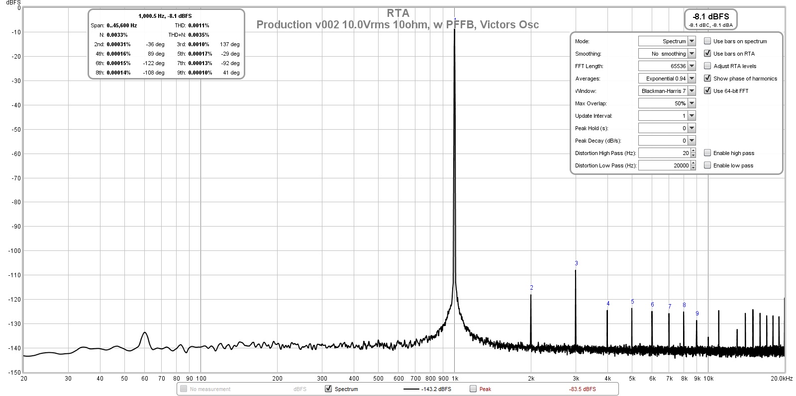

Using this jig and Victor's sub-ppm 1kHz oscillator, I was able to measure 0.0011%THD on my TPA3255 amp (sorry another 1600 wide image-need to set the default in REW to produce 1200 wide pix in the future):

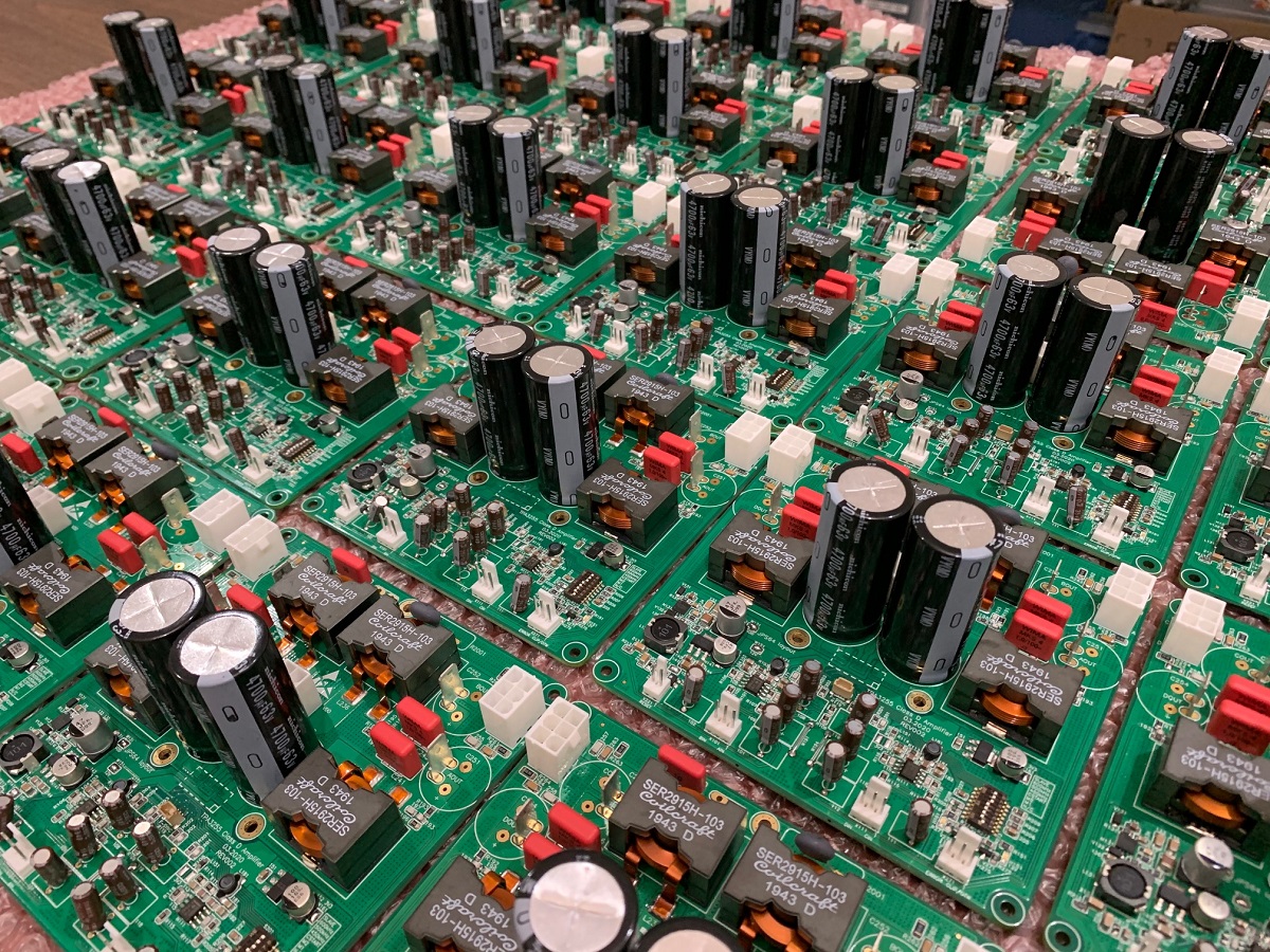

And no, I did not measure each individual one.... :)
841790d1588899159-tpa3255-reference-design-class-amp-gb-tpa3255-production-delivered-02-jpg
