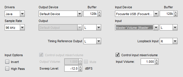

Choose input and output amplitude to be “Master” and set to amplitude of 1.0 - this lets the full signal be generated by the sine wave generator and the full signal be captured by the ADC.
This is the setting I cannot find. Has something changed in new version od REW?
It's here in the settings. Needs to be on Java drivers for that setting to be present. Many people recommend using the ASIO drivers (which I now use).
