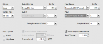

Choose input and output amplitude to be “Master” and set to amplitude of 1.0 - this lets the full signal be generated by the sine wave generator and the full signal be captured by the ADC.
This is the setting I cannot find. Has something changed in new version od REW?
Are you using OSX or Windows? That setting is only on Windows. Look back for a few of my previous posts. I had the same initial struggle.
It's here in the settings. Needs to be on Java drivers for that setting to be present. Many people recommend using the ASIO drivers (which I now use).
If you read through the thread and have trouble, post back. It took me quite a while to figure it out with a ton of help from the forum, but everything should be in this thread to get you going.
