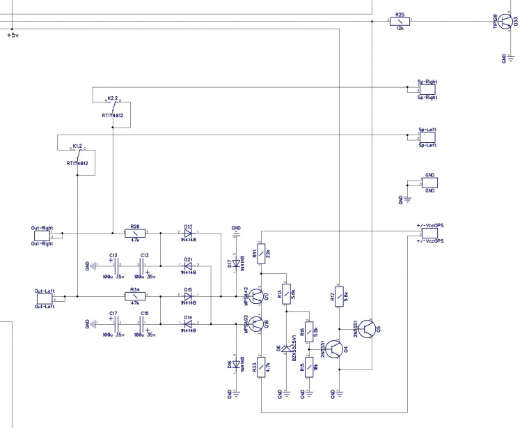

In fact, to add a channel (or multiple channels) you can just duplicate R26, C12, C13, D13, D21 as many times as needed and connect the right sides of D13, D21 in parallel, as it's done with 2 channels already here. Is that what you're looking for?
Arduino supports 2 hardware interrupt channels and both of them are already engaged with DC offset and over-current sensors.

I have 2 complete standalone DC detection circuits. One on each binding post of the amp. Their signal output pulls the line low in normal operation, and lets it go high on fault. I'm bringing the signal from each to the control board separately. Being they pull the line low for normal operation, they can't be paralleled together, or the signal wouldn't go high unless both were in fault. I'm trying to reuse your code as much as possible, but I've noticed you used two hardware interrupts already. I've been reading that software interrupts can be slow to react, and I'm still pretty terrible at coding. I can combine the signals with a dual optocoupler (creating an inverting buffer) and modify the code to require a high signal. I'm just wondering if that would operate better.
S1 is a "Reset" button, only needed for testing/debugging.
U6, R20, D13-15 are handling the remote on/off trigger signals and optional "Power On/Off" switch - if you don't use the trigger signals, you can drop those.
I can't find D8 (looking at schematic from the post #583).
