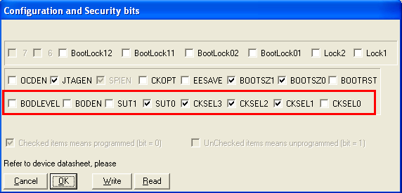

It is useful if someone can post the right fuse bit settings for this protection board when using Pony programmer.
See picture as reference only!
This may be usefull.http://microcontrollerslab.com/ponyprog-tutorial-beginners/
Attention!!! Wrong fuse settings will make the chip <<death>>

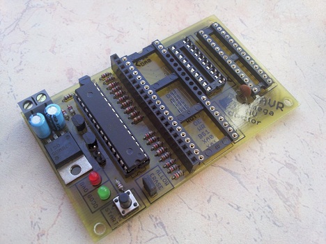

This will be useful again after fuses reset.You need a parallel (H.V) programmer for this,or a <<fuse doctor>>

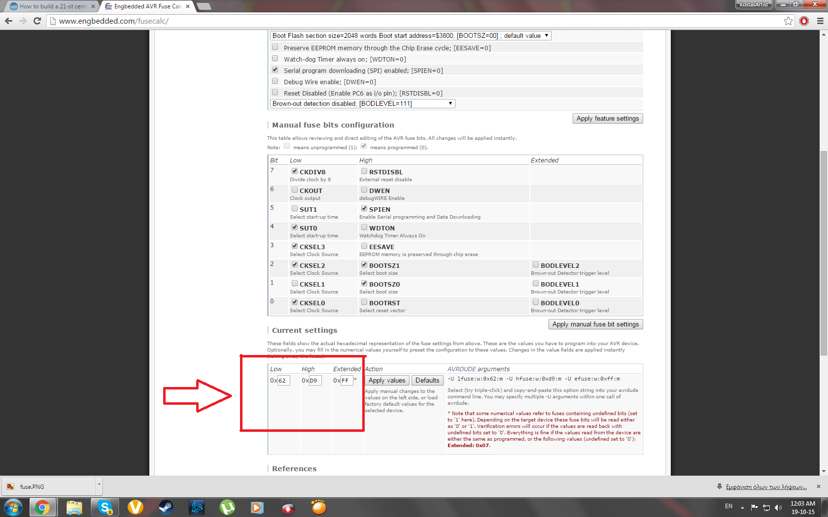

This may be usefull.PonyProg tutorial for beginners | Microcontrollers Lab

Another issue I ran into was the fuse bit calculators didn't seem to be able to calculate bits for a 16MHz clock on a 16U2. I was using suggested bits I found on the Arduino website.

I think those were the values I was trying to program. Maybe I'll have better luck with some more modern software.
