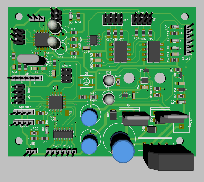

What I'm trying to design is a universal amp control. DC output protection would be right at the speaker binding posts so all the extra internal speaker wire would be eliminated. Current sensing and temperature sensing could be on a small remote board screwed to each heat sink. Rail shut down can be done by replacing rail fuse holders with a small daughter board. A small LCD could be added to the front panel of the amp easily if someone wanted too, but that's not something I'm really interested in. The hardware is easy for me to botch together, but I'm terrible with writing software. I've never had the time to learn enough about it.

Most 8 port expanders have more addresses to choose from. They don't take that much space in SOIC. I'd prefer to stay with one interface to make it easier for software challenge people like myself. Those ADS1000s are available in two preconfigured addresses. I just need to find a couple I2C temp sensors with different addresses and I'm all set for a stereo amp. I've got the next rev of control board 90% layed out. It has all the standard connections plus an I2C port, USB and FTDI serial adapter cable port.
We've talked about data-logging quite a few times already. I think it would be cool to have the amp networked and accessible through a web browser. I might add necessary connections for a Wiznet network connection to go along with the USB port as connections for LCD. This would make it useful for a lot of different things besides an amp control.
My new version of the control board is layed out. Next are the satellite boards.
