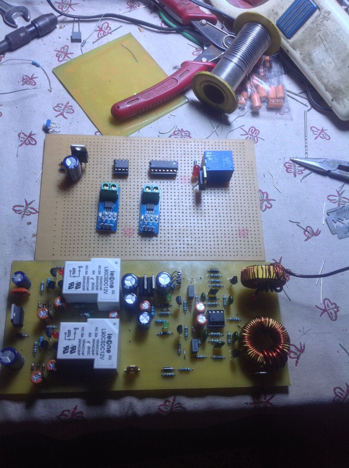

Hello jwilhelm
greetings thanks for replying i will try your mosfet relay waiting
for ASSR-V621-002E as in my city some components are hard
to get as i cant make the 21 century protection
so i will try a cheap DC and overload short circuit protection
as you can see these cheap mechanical relays shown on pcb
have to be replaced with your SS relays even tauros ACS712
overload protection works
warm regards
Andrew🙂

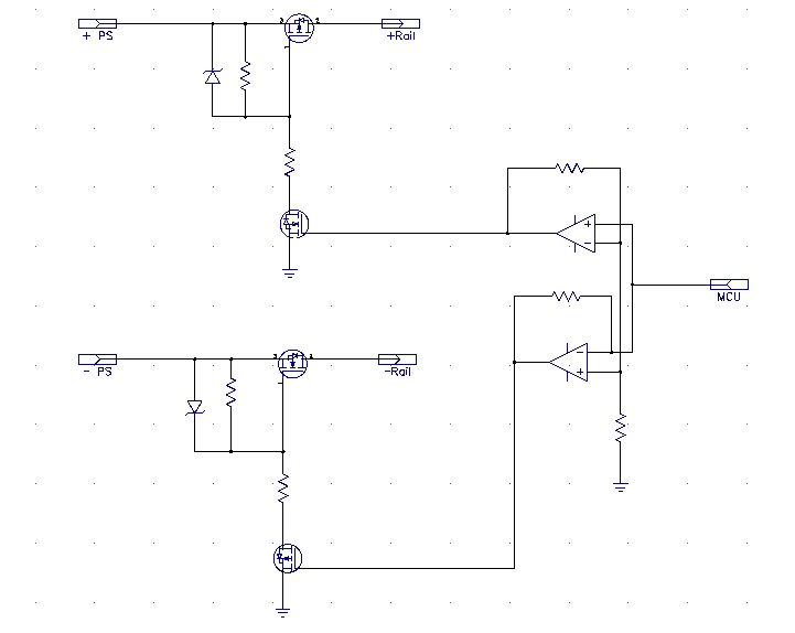

Basic idea for rail shutdown
Basic circuit I'm looking at to use for rail shutdown. Probably will design the opamp outputs to take the gates beyond ground by 5-10v for improved turn off. Just an idea, I'm kicking around.

You can drive the rail fets directly with a ASSR-V622-302E. It has a quick off circuit on board and will optically isolate the protection board from the rails. I've done this in my protected supply. It's working perfectly in testing, but hasn't gone into service yet.
Hello jwilhelm
Yes I have thought about that also. Most of my new amp designs, have separate front and OPS rails, something else to consider. Will this be part of your smd redesign? And thanks for the files, got them ok!
MI
This can already be run from the existing boards. Either switch them on with the power relay control or use one of the extra outputs and modefy the code to run it.
