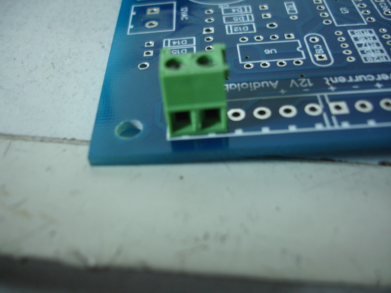

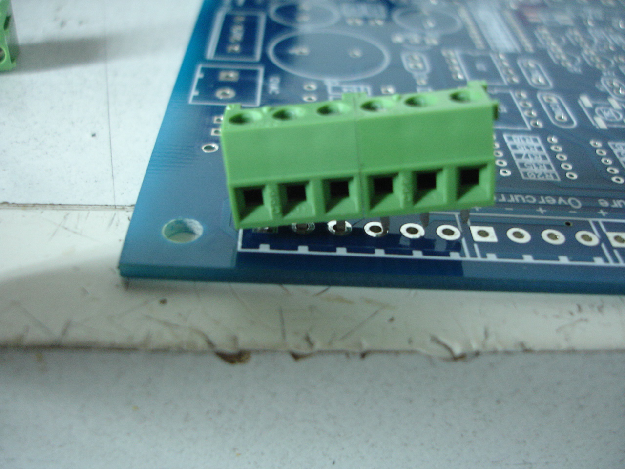

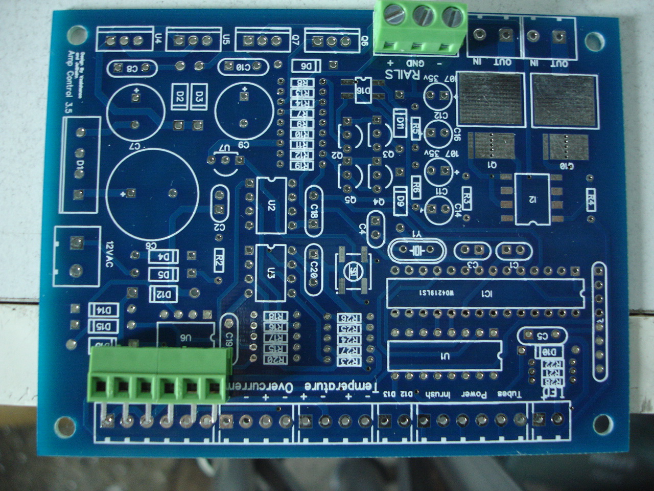

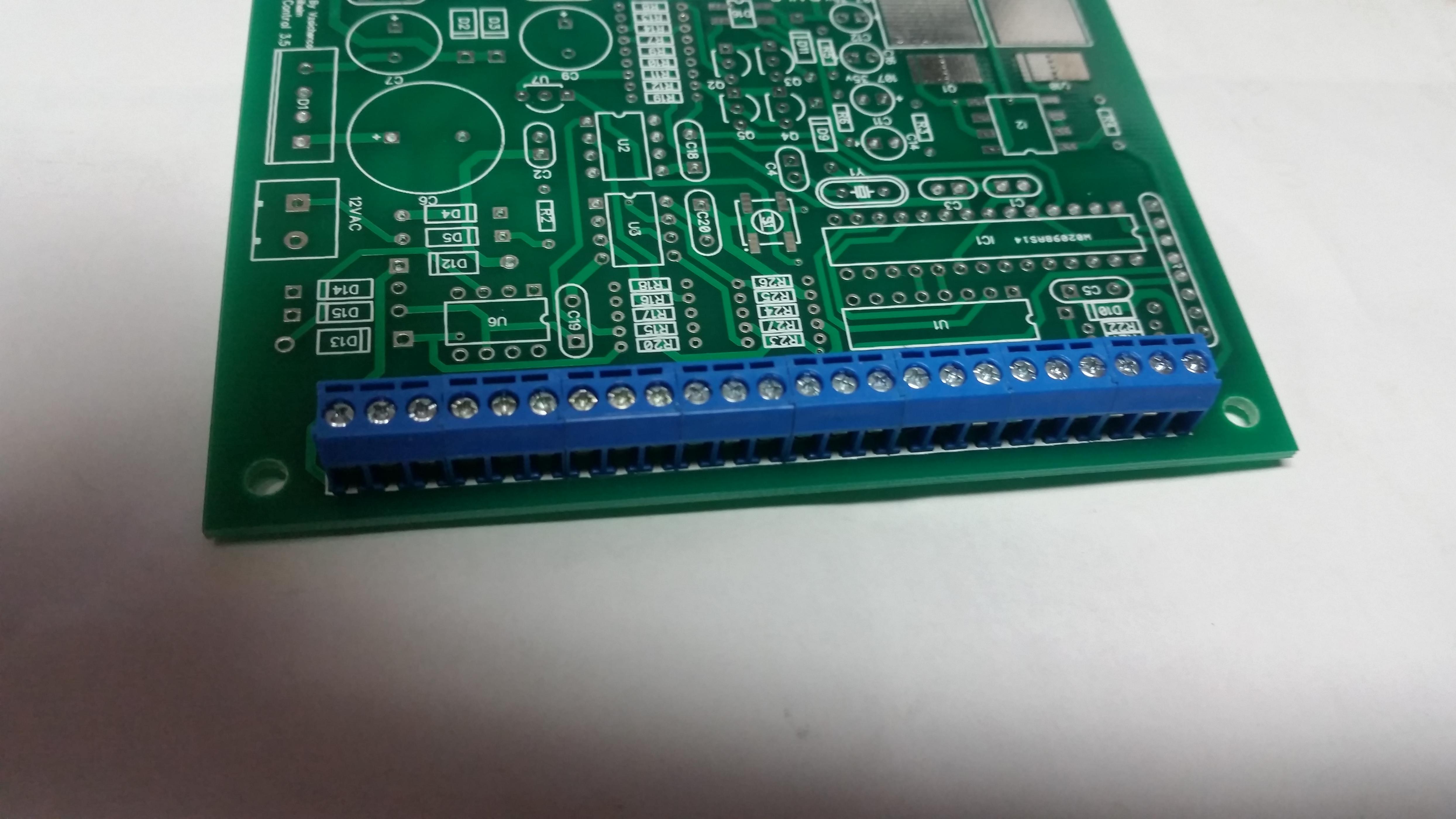

I have difficulties with this connector . This can't sit well here. Especially the next one
I used Tyco 1776275-x terminal blocks clipped together to make a row for there. The signal connectors are 3.5mm spacing. Power connectors (speakers, rails and AC) are 5mm spacing.
I used Tyco 1776275-x terminal blocks clipped together to make a row for there.I used Tyco 1776275-x terminal blocks clipped together to make a row for there. The signal connectors are 3.5mm spacing. Power connectors (speakers, rails and AC) are 5mm spacing.
Can you share the code number for this connector?
The x is the number of circuits. If you clip four 1776275-6 together, you will have a 24 circuit terminal block that will slip right in.
1776275-6 TE Connectivity / AMP | Mouser

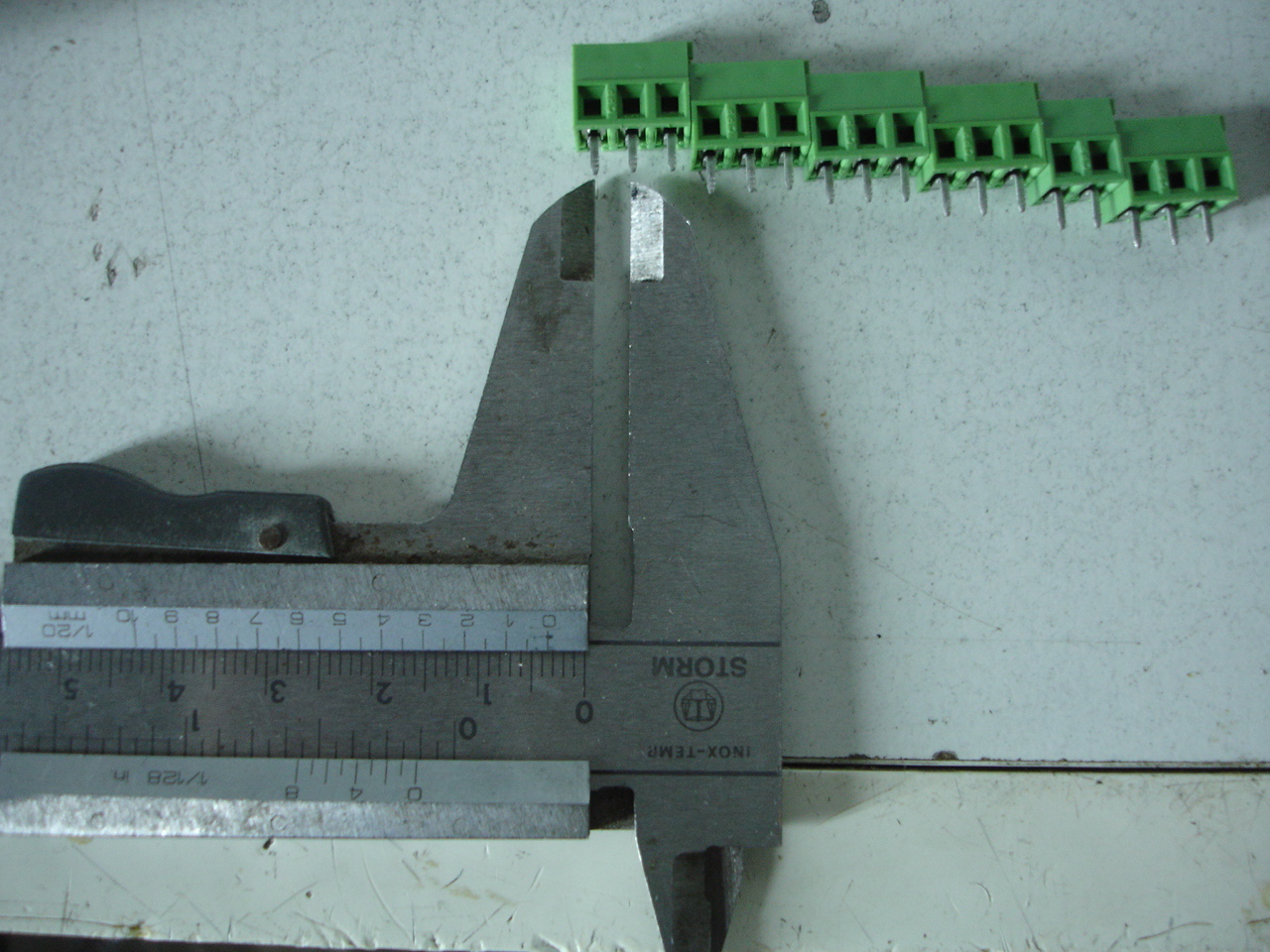

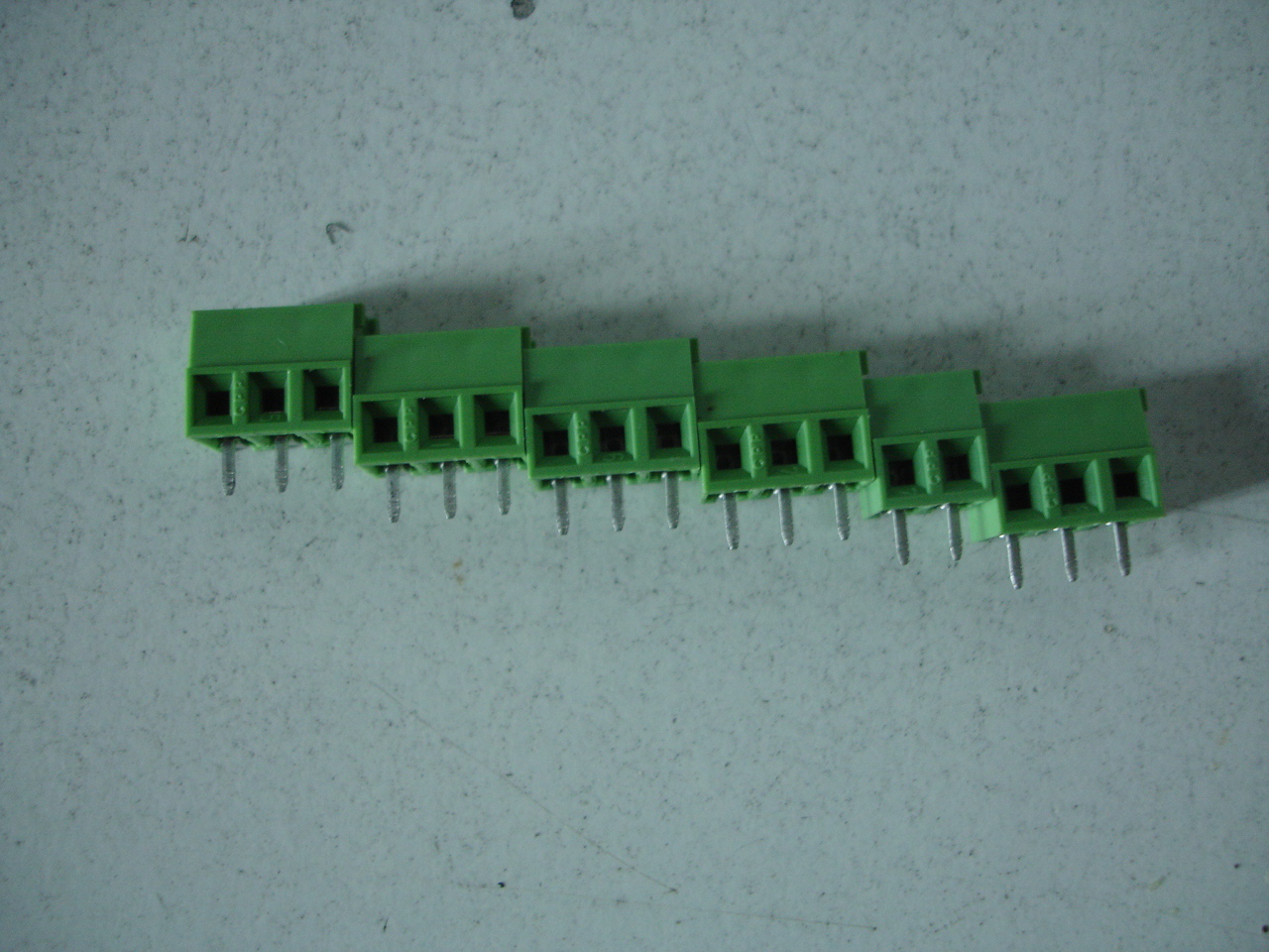

Thank you but looking at mouser data i see that spacing is 3.5mm just as mine.The x is the number of circuits. If you clip four 1776275-6 together, you will have a 24 circuit terminal block that will slip right in.
Why they don't fit?I wonder for mine pcb accuracy...

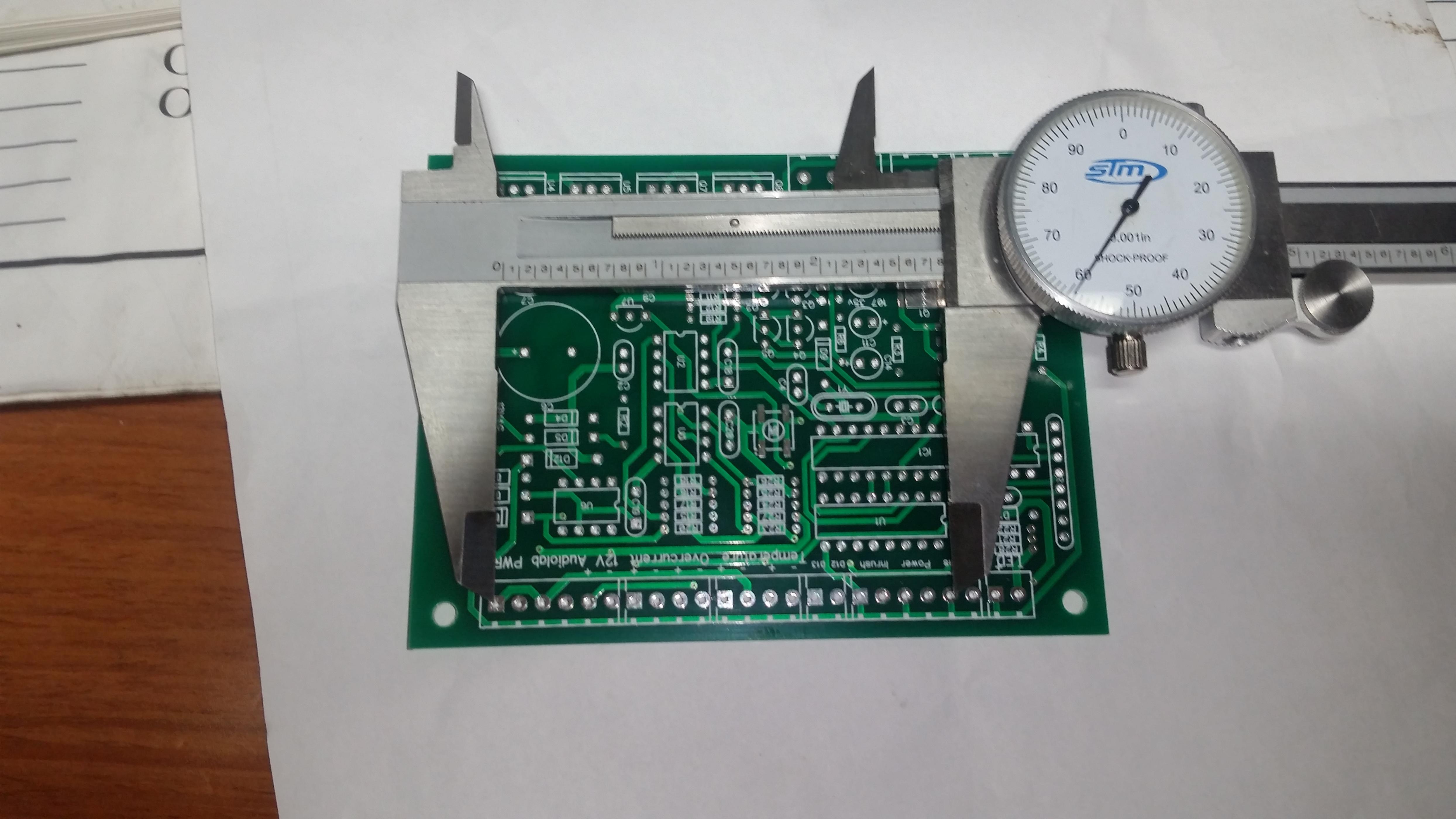

YesDo you have some way to measure the spacing?
This fit well but when combining with other not fitWhat's the spacing on the board? I'm at the office now. I'll double check mine.

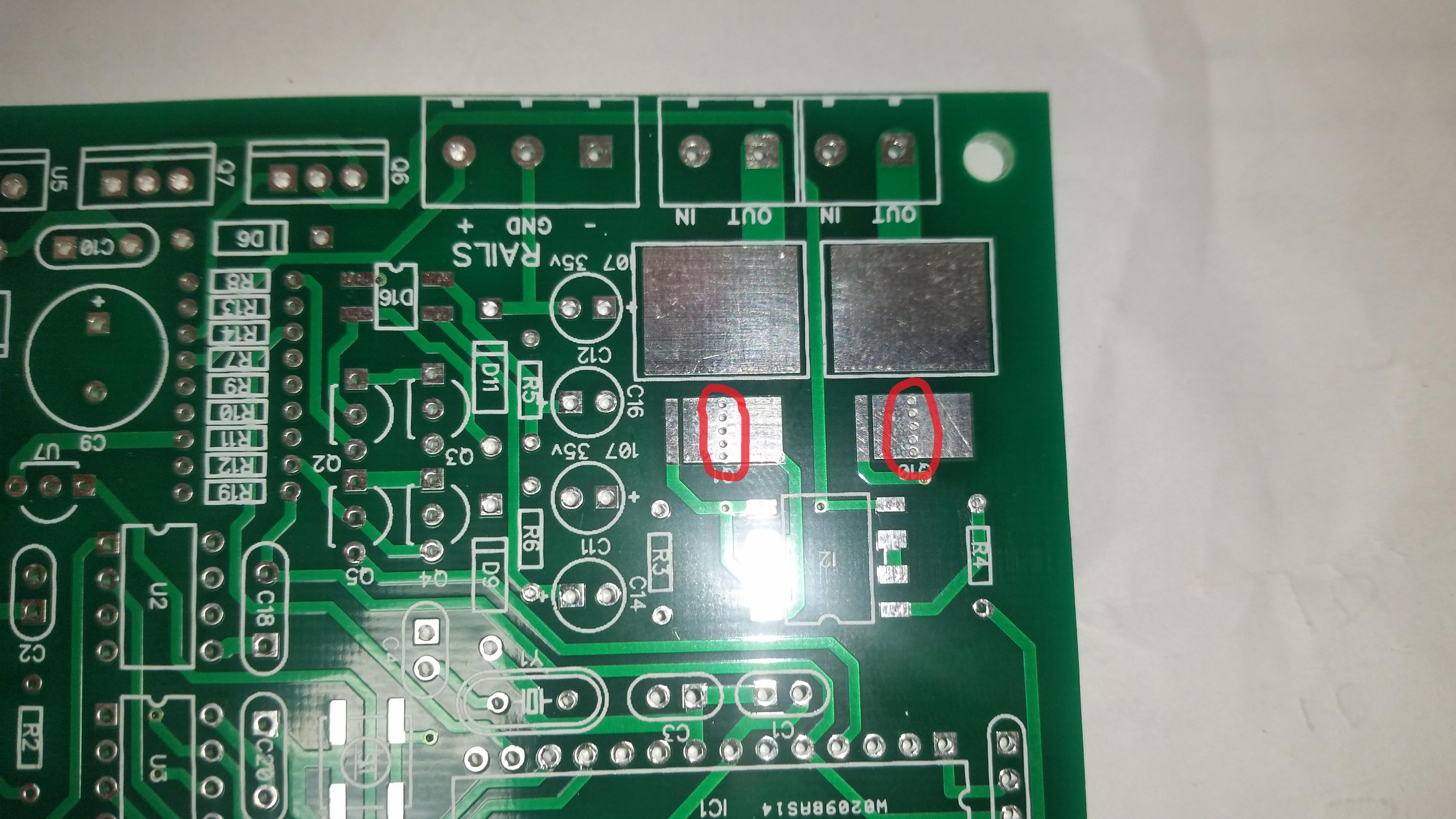

I'm not sure if I've mentioned this already but, these vias should have wire soldered through them. They carry full speaker current.
Hi Jeff, thanks for the information. I have not done that as yet. Can you just fill it up with solder?
Quan
No vias are small size,solder won't pass thru this.Hi Jeff, thanks for the information. I have not done that as yet. Can you just fill it up with solder?
