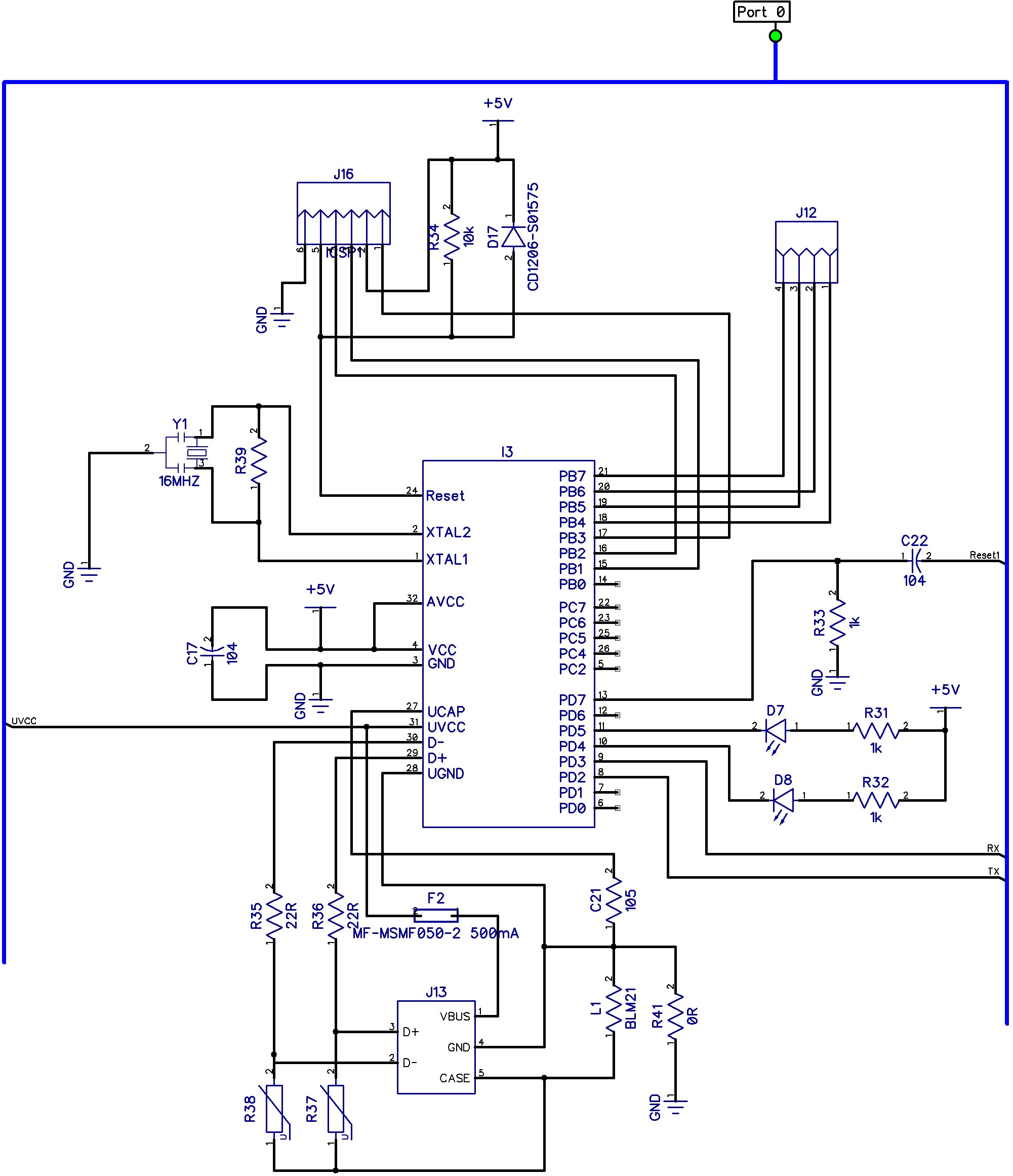

I3 is the USB interface.

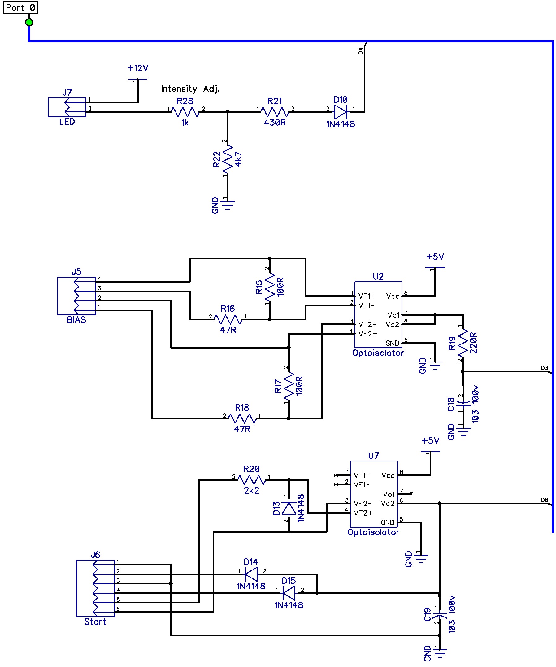

You need to add bias connectors to your output boards to make them that much easier to connect. I did it with my sub amp.

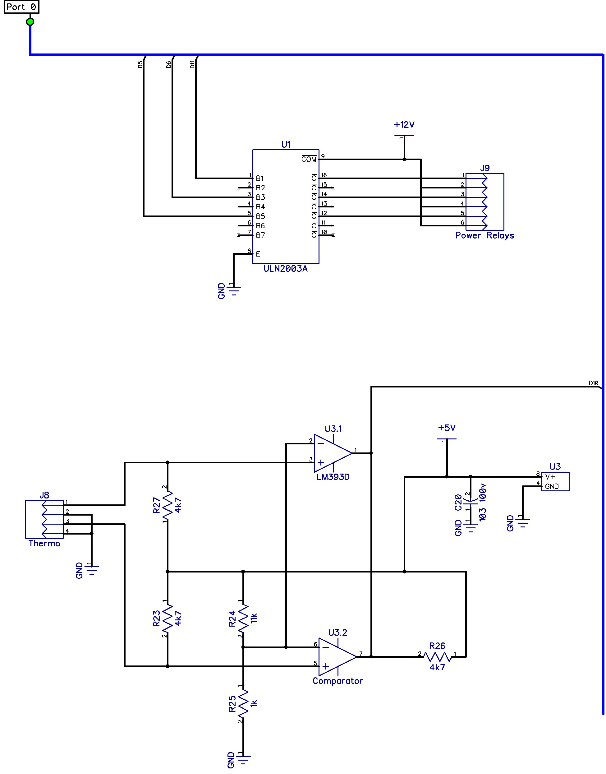

The "honey badger" already has "TP1/2" posts for the over current hookup.
Thermal could just be another hole in the heatsink .
Everything else is just power supply wiring.
Edit - one builder even ran wires off the badger board to add V/I limiters.
OS

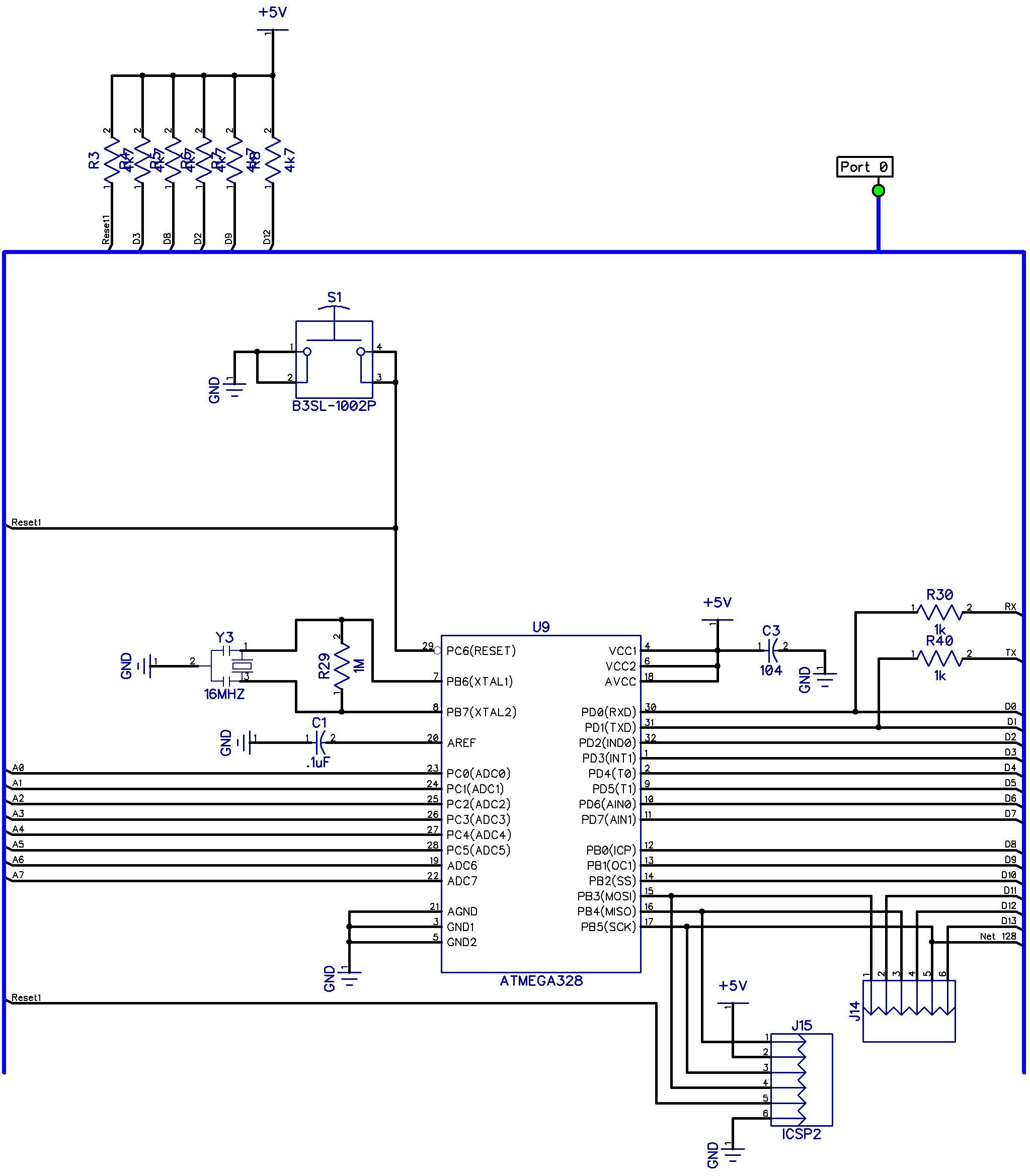

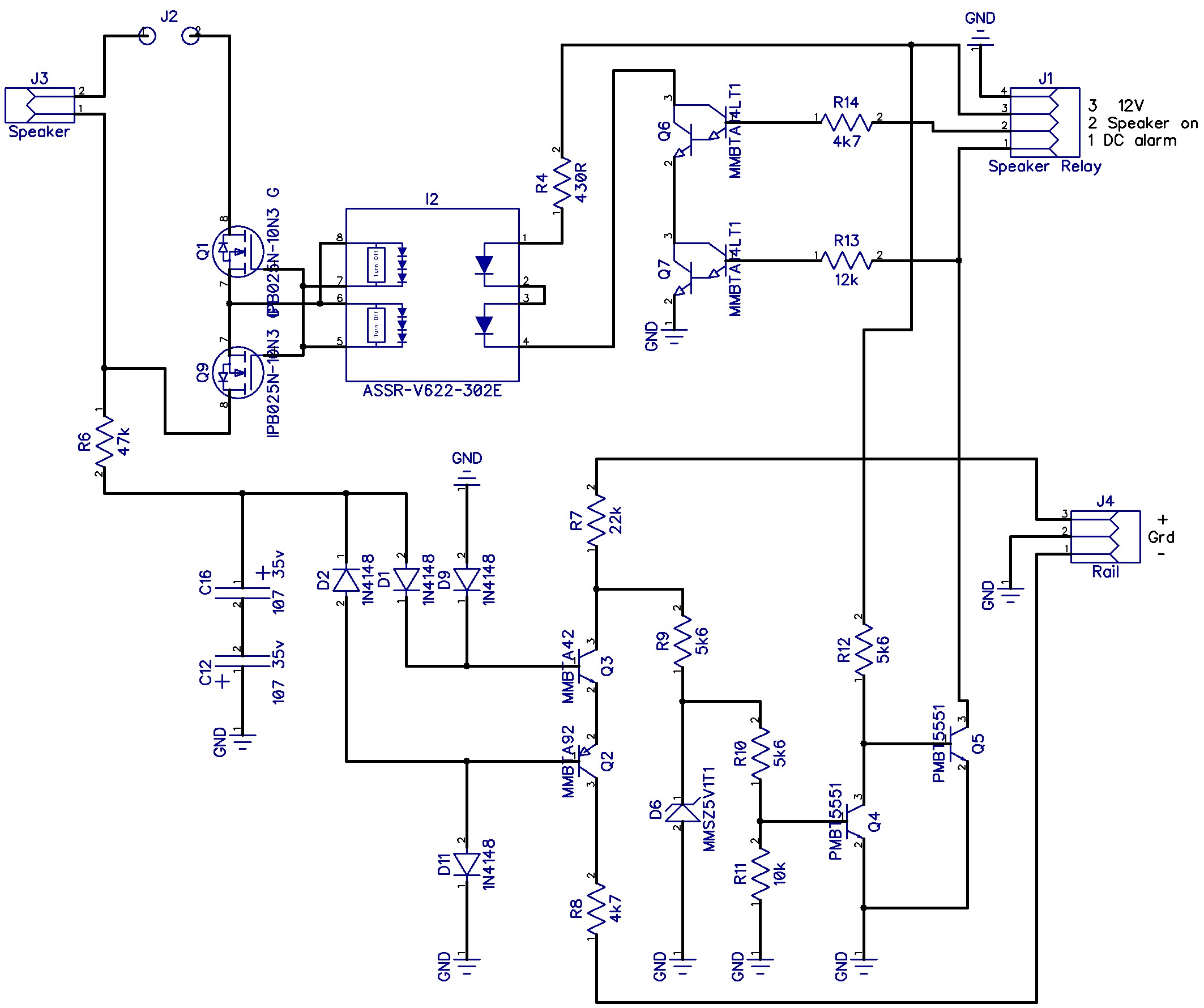

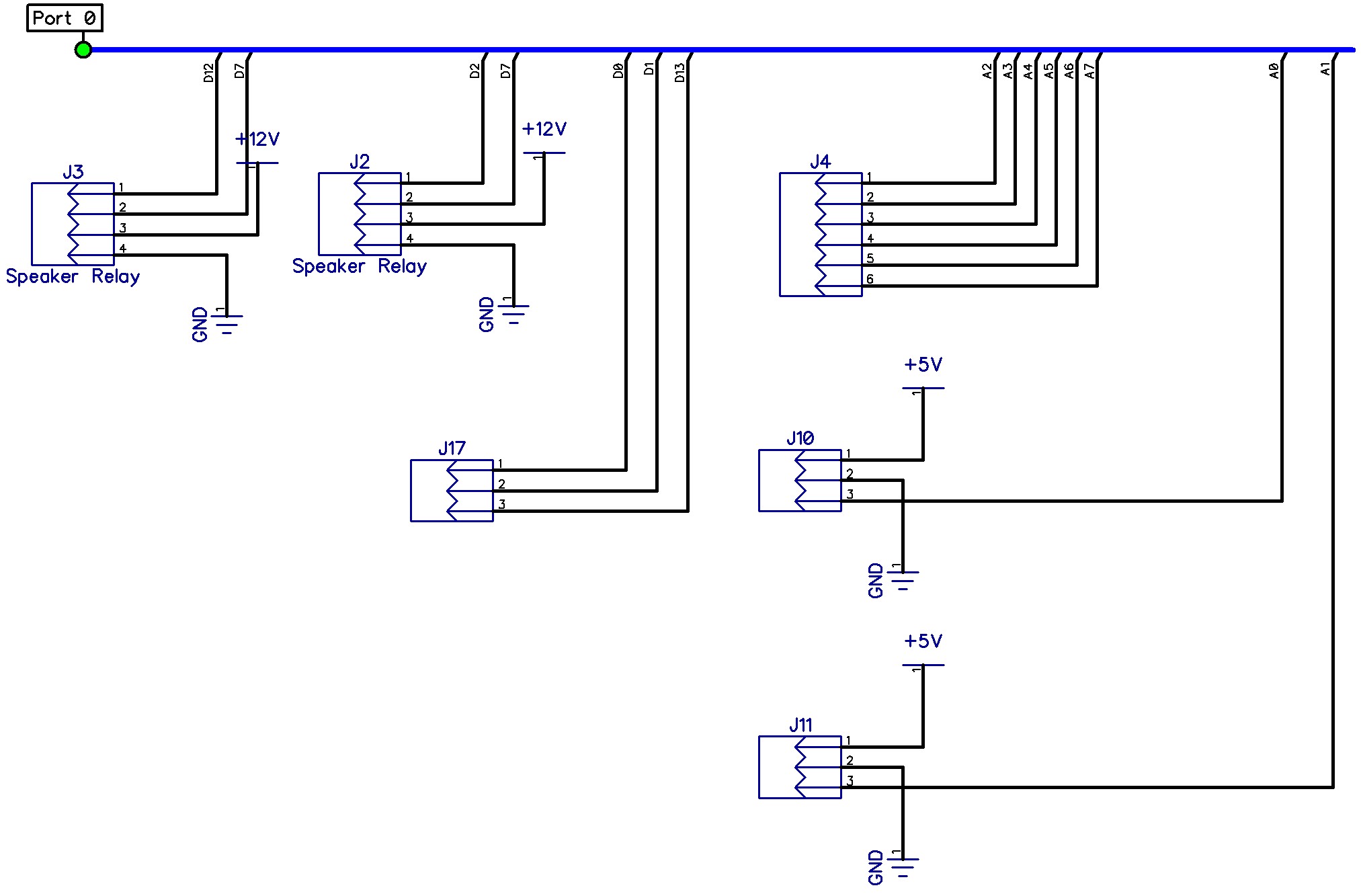

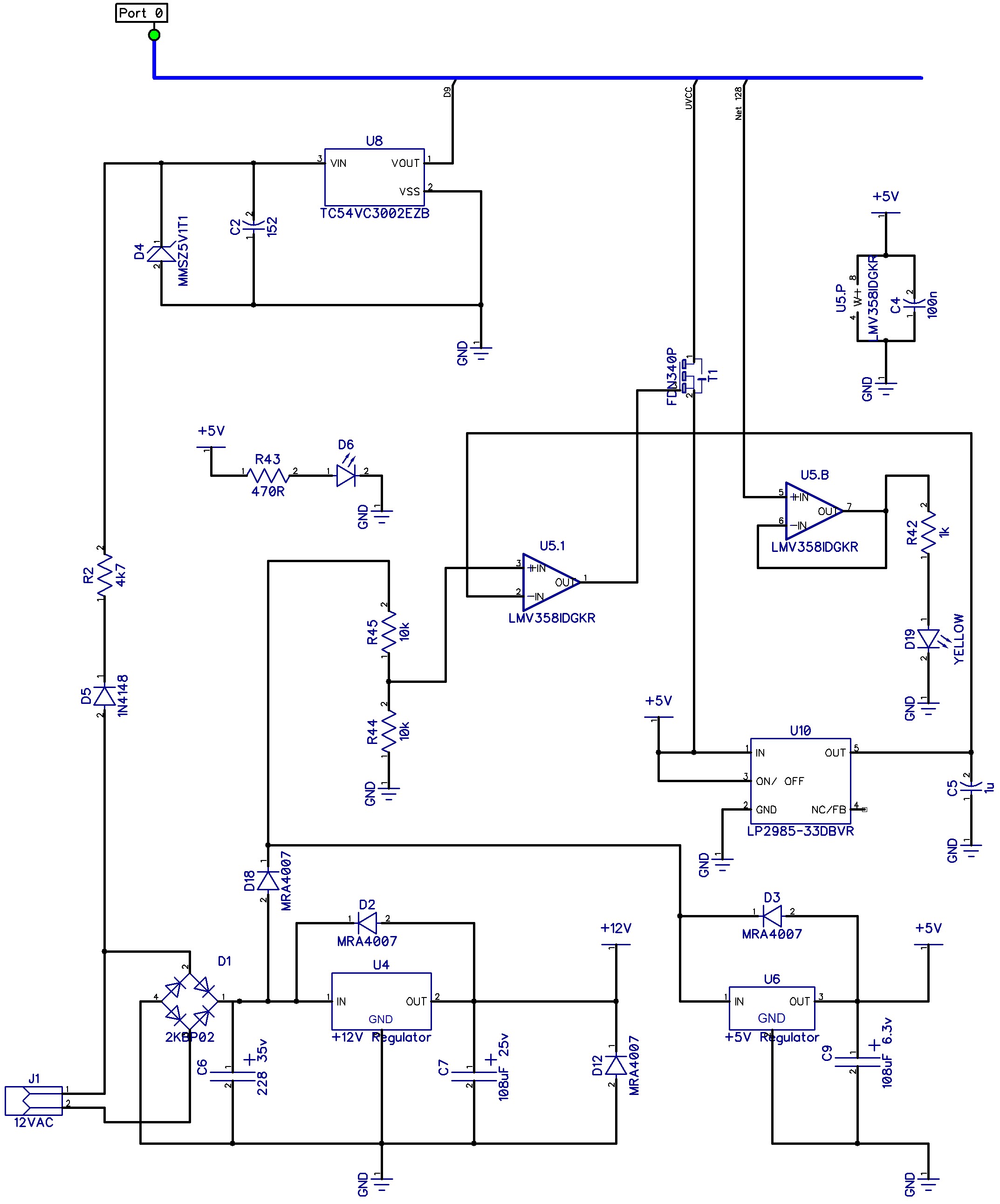

I've been using DipTrace to design these boards
The relay board and the latest control board aren't tested yet. They've been updated a bit since the schematics and will likely have a couple bugs to work out. They are a huge change from previous versions. Gerbers will be available after they are debugged.
Jeff, kool lites is right - R12 is referenced to +5V, but there is no +5V rail on DC offset sensor / SS relay board. So you need to either bring it there from the main board, or reference to +12V rail with appropriate R12 value increase. R12 = 12K will be good in this case.
Valery
Valery
I saw that when I posted the schematic and I think I connected it to 12V. I'll see when I get a chance to populate the board. I'm battling with the control board right now. I can't burn the bootloader for some unknown reason.
These are still untested. Some passive values will likely change.
