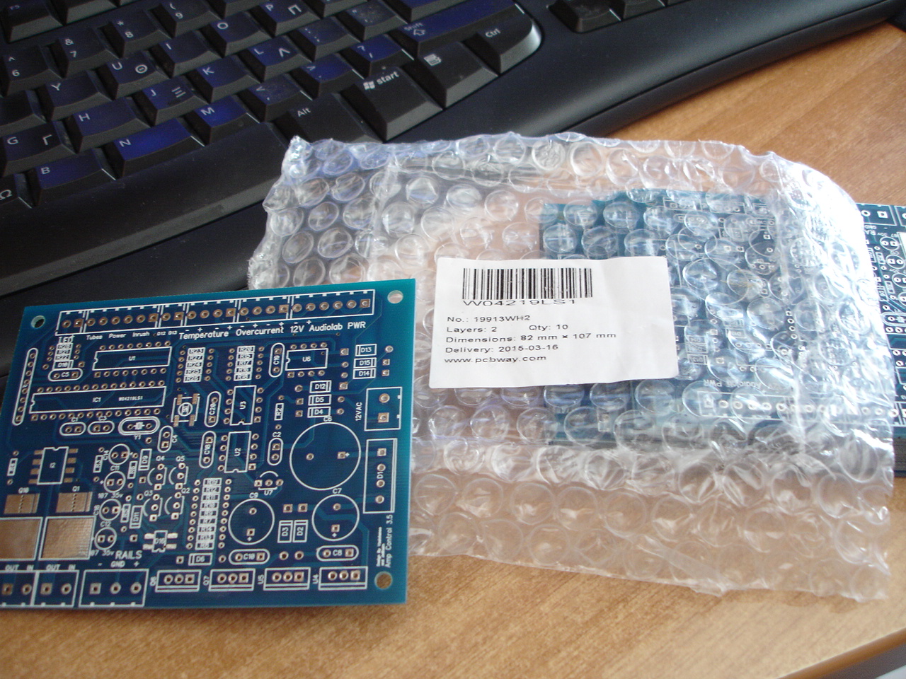

Pcb arrived today!
10 pieces+1 bonus.
Thanks Jeff.
Is there a bom somewhere?

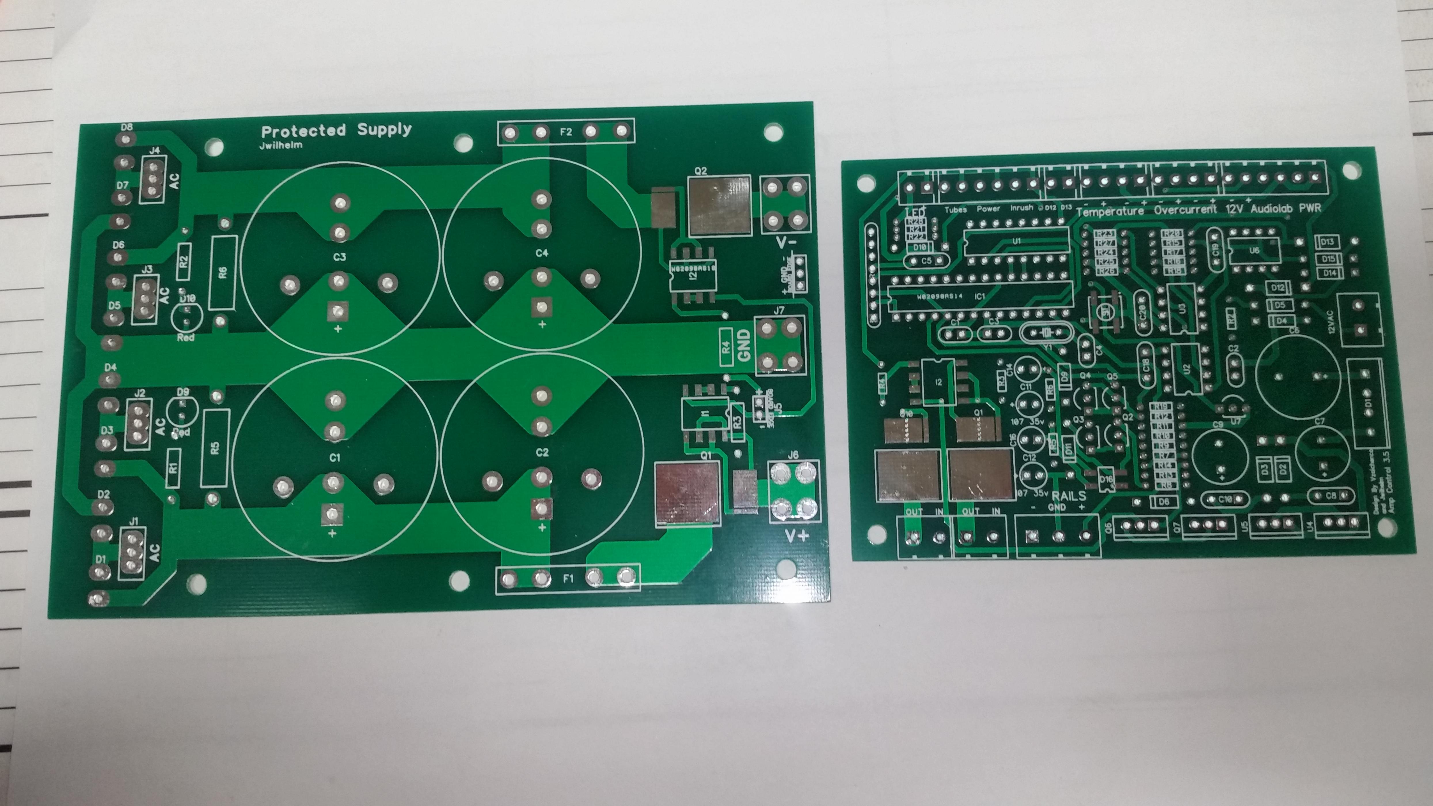

I haven't had much time to test out these last two versions of the protection board yet. Thing have gotten too busy here since the snow has melted.
R3 and R4 may need some adjustment. They should flow 20mA max but should be close to that to ensure complete on switching of the mosfet relays. R21, R22 and R28 need to be adjusted to make your front panel indicator intensity correct. The listed values aren't great. Do some tuning before finish soldering. Let me know if you have any other questions.
