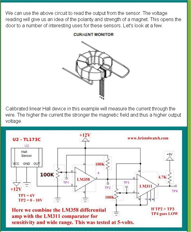

Better to make your own current sensor using a generic hall effect
sensor and coil/toroid (below).
Link - Using Ratiometric Hall Effect Sensors
Avoid proprietary components. Unless you are lazy ... 😀

os, with your idea, having the speaker current going through a coil that saturates because of a magnetic (ferrite) core? does this not affect linearity some how?

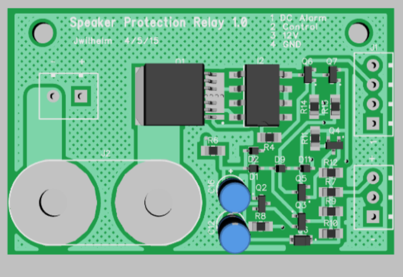

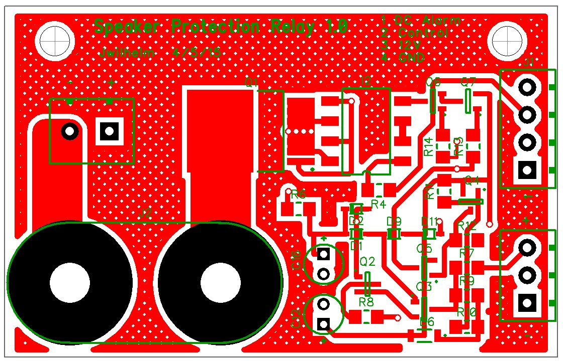

i think if you send valery a pm he will send/email you the cam data. you can send the cam data to a pcb fab shop for boards. this way valery can keep track.

I used the same module but 5 amps. They are easy to read and reduce the components counts. Just 2 analog inputs for both channels. You can easily implement them in any amplifier by just cutting the speakers cables and read the voltage output from the modules. Nothing to it.

I did this for a living , long ago. Jwilhelm wanted current sensing for DC
rails in the PS. I would never run audio through a tiny toroid. 🙄
Larger gauge winding , fewer turns than the image - no saturation.
The hall effect sensor would have to be amplified and scaled.
To sense a sharp 6-10A threshold would be very easy and precise.
For the audio -
I even have some of my old industrial current detectors (trafo's).
Audio just forms the primary by going through the hole. easily
rectified , scaled ( just set a threshold for the arduino trigger).
WAY Superior to monitoring voltage drop across an output Re.
This is the way the factory keeps track of remote motors/fans/pumps.
Current demand would even indicate one in need of service.

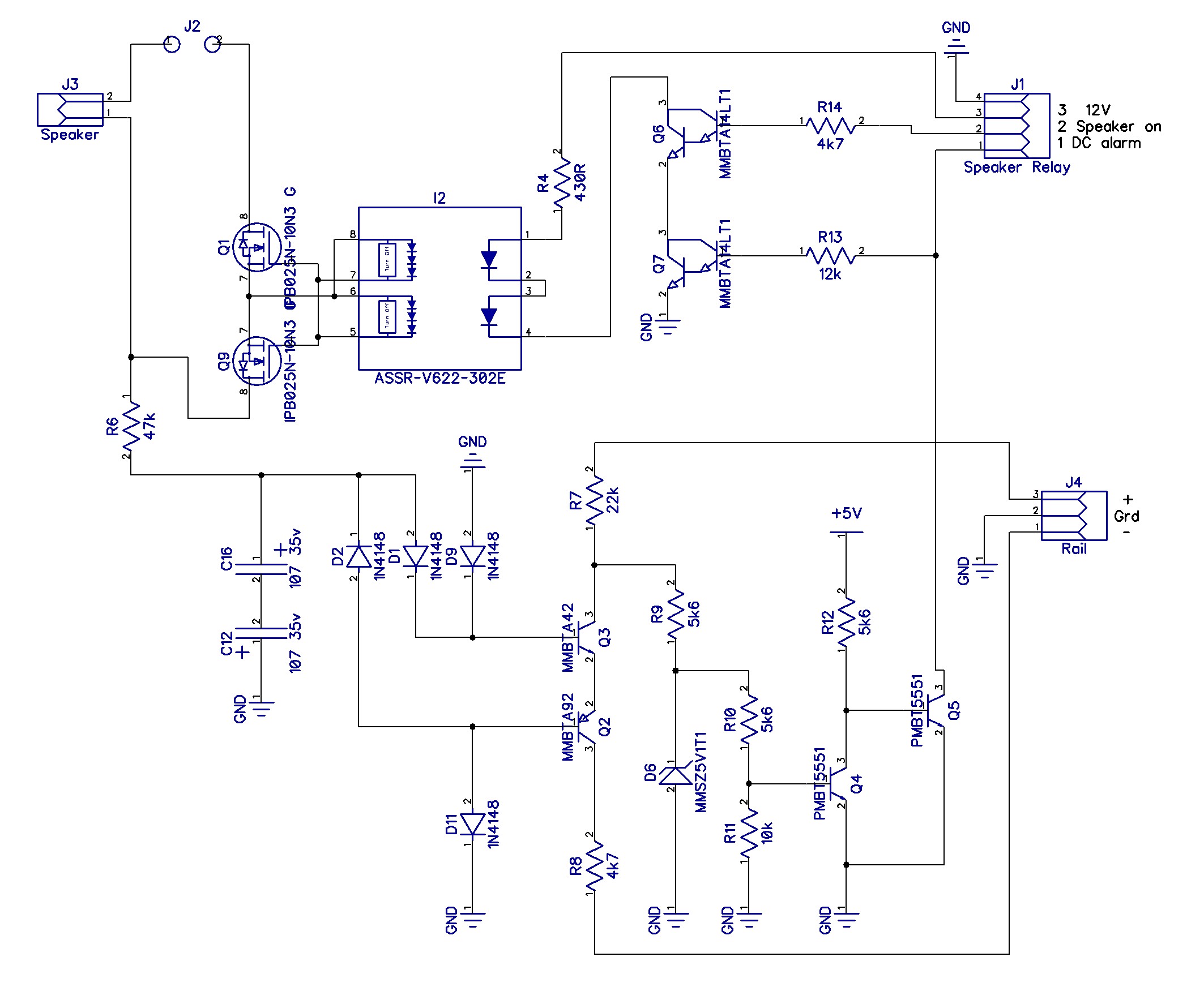

I've been designing a control system with speaker relays and DC detection right at the binding posts. I've run into a bit of a snag. To keep it universal I've layed out individual complete detection modules for each channel. (Jason's idea sounded good after all)
The way the circuit operates presently, The microcontroller needs to see a low input from the DC detect circuit or it will go into shutdown. I like this operation personally because if there is a connection issue anywhere it will shut down.
The issue I have run into is that the microcontroller will require a separate input for each speaker relay module to operate like this. There are 4 available digital IOs available including the RX and TX so it's not a huge issue. My only concern is the extra code that is going to be required to make it operate. Is that going to cause any speed/reliability issues for the Arduino? This could be solved with an AND gate and some jumper selectors for the number of channels but I'm not a fan of jumpers. Too easy to bypass a safety circuit and forget about it that way.
