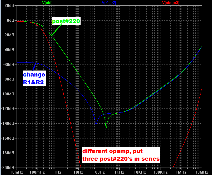

I think you can do better. I think there are a few other two-terminal components besides "resistors" for positions R1 and R2, which would attenuate input frequencies ("noise") another 100X (-40dB) as soon as you put them into your simulation / instrumented hardware prototype.
I also think there are 30 volt opamps from Linear Technology that have significantly tighter headroom than the NE5534, which would allow you to put two or even three of these entire circuits in cascade, and only drop 5 volts from input to output. Which would you prefer: X decibels of attenuation from Vin to Vout, or 3X decibels of attenuation?
Simulation gives a flavor of what might be approximately possible. Do you get the impression that (three greens in series) might not be as good as (one blue in series with two greens) ??
_
I was unsure to begin with but you are probably right. What were the changes to R1 & R2?

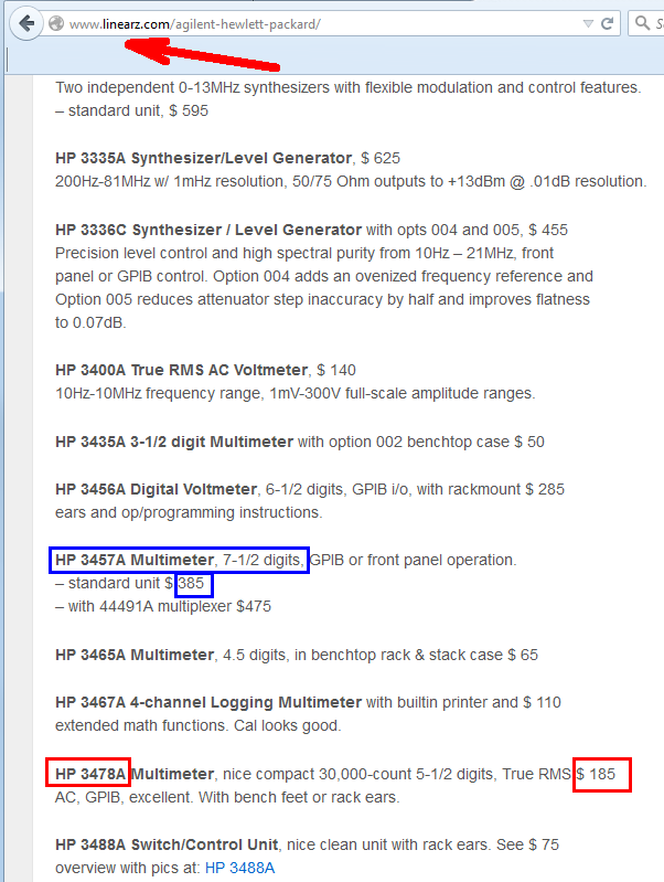

Thats off by 13% at 20 kHZ. Try to get a hp3478a or hp3447a at ebay - they are very good and reasonable priced. Other option is to add a peak detector at the output and measure the DC voltage.
Thanks Udo, The HP3478A looks like very good value, I was expecting this sort of meter to be £500+ ($750+), I was pleasantly surprised. No one selling on eBay UK just now, but I'll keep a look out for one.
For anyone else interested:
ROBOT WARNING - at the Test Equipment Depot
Gordon. 🙂

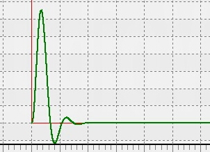

Regarding power supply noise, this is the sort of thing I've been troubled with:
See Attachment.
This is not an actual photograph of the spikes I've been seeing but is close enough. The horizontal scale is about 1uS, making the pulses a little under 1MHz. They are regular but both aperiodic and of variable height ( amplitude ).
Combinations of capacitors and a simulated inductor ( gyrator based ) produced no visible difference, but the same noise is apparently being picked up by my 'scopes leads and makes viewing of small signals <5mV peak difficult. Does anyone have any suggestions as to; (i) Where these spikes are coming from, my first thought was a switching power supply but there were none in the vicinity. I also thought about my home wireless network, could it be that? (ii) How to defeat this noise / interference?
Gordon.

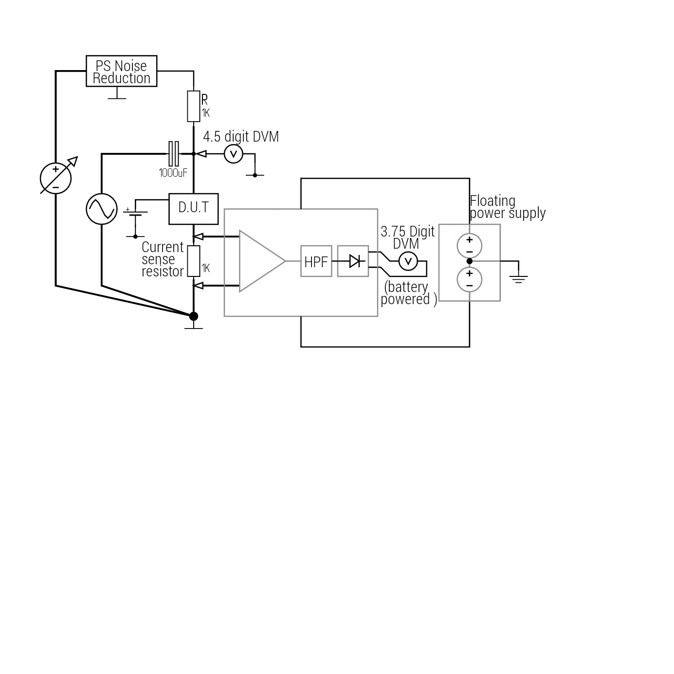

For reasons I can't fathom I couldn't get my homebrew differential amplifier to work. I've gone back to a single ended amplifier made with two halves of an lm833 powered by an independent +/- 12 volt power supply along with lots of due care and attention to layout and construction.
Should be publishing some more results within the next week. By necessity I've been forced to put this project at a lower priority than other more pressing matters.

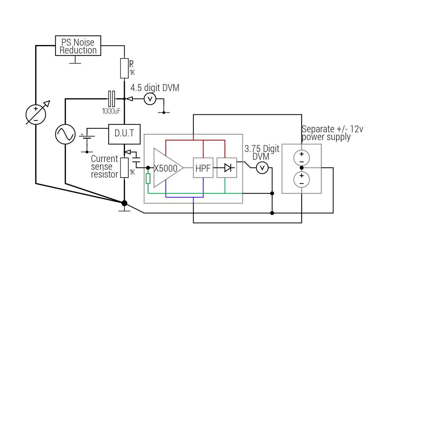

BLOCK DIAGRAM OF LATEST SETUP ATTACHED.
Notes: The HPF is to tame sub 10 Hz noise which is quite significant in a x5000 amplifier. I've also built a little RMS to DC circuit to get round the upper measurement frequency limitation of my portable DMM's.

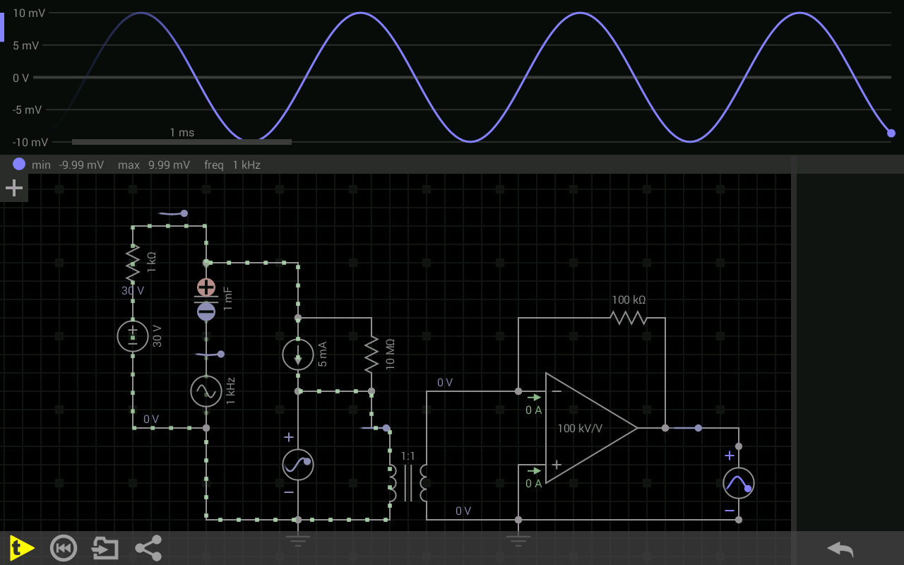

I was looking back over the thread today and came up with the attached idea. Essentially the transformer would be getting used as a current transformer and with the low input impedance of the trans impedance amplifier any capacitive coupling across the transformer would be severely attenuated.
I need to try this to see how well it works in practice, the simulator I have on my Android tablet is fairly basic and doesn't take into account some of the more subtle effects.
The circuit in post#235 looks like it will pass DC current through the primary of the transformer. Will that saturate the core? Will it add extra distortion?
You are correct, I will need to try it. I'm assuming that it might tolerate the relatively small 5 MA as in its original function as a telephone transformer there would have been a small DC current present in use with the speech signal riding on top of it.
Looks like the pulses of a switched mode power supply. What is the frequency of the pulses?.

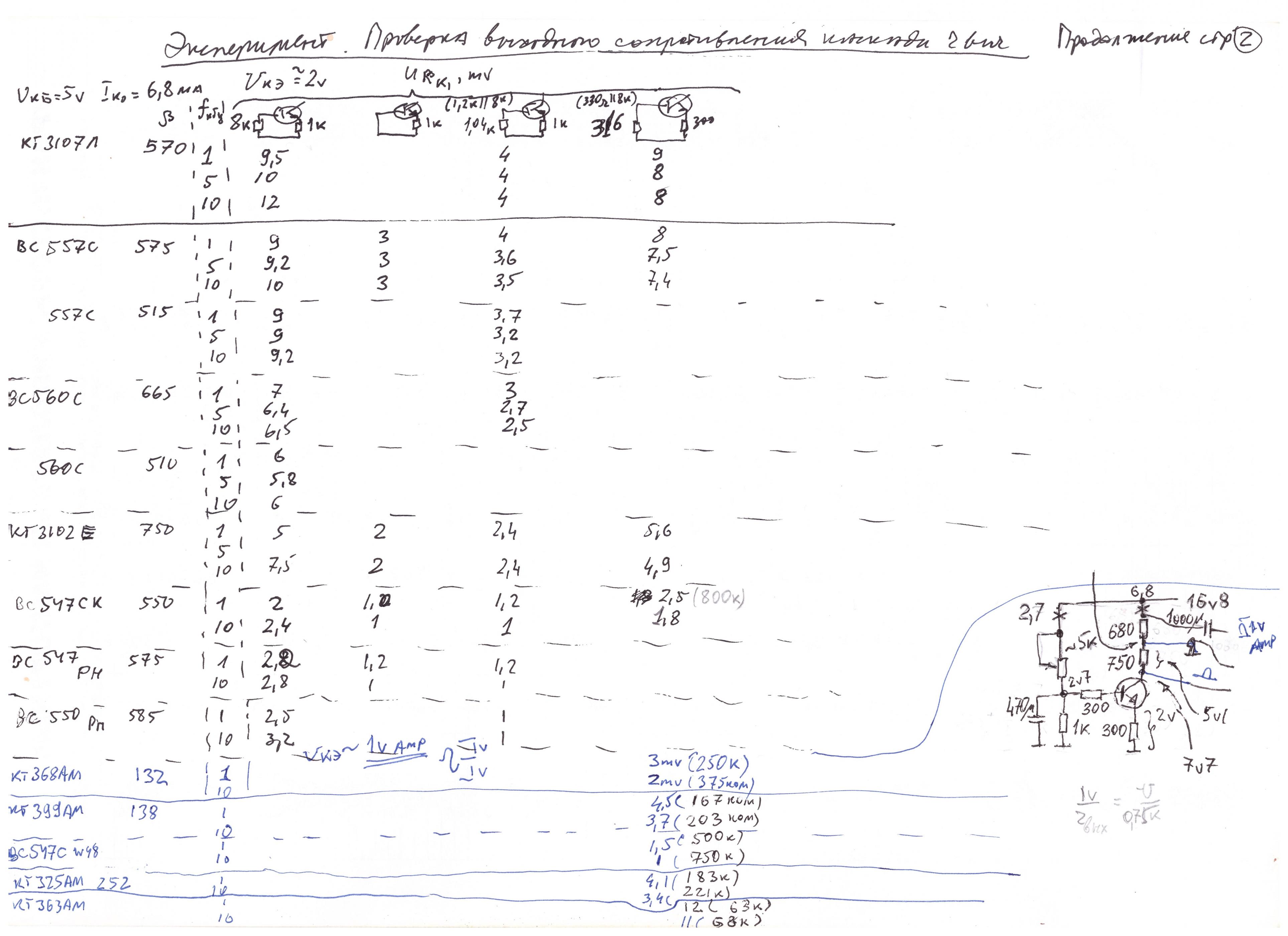

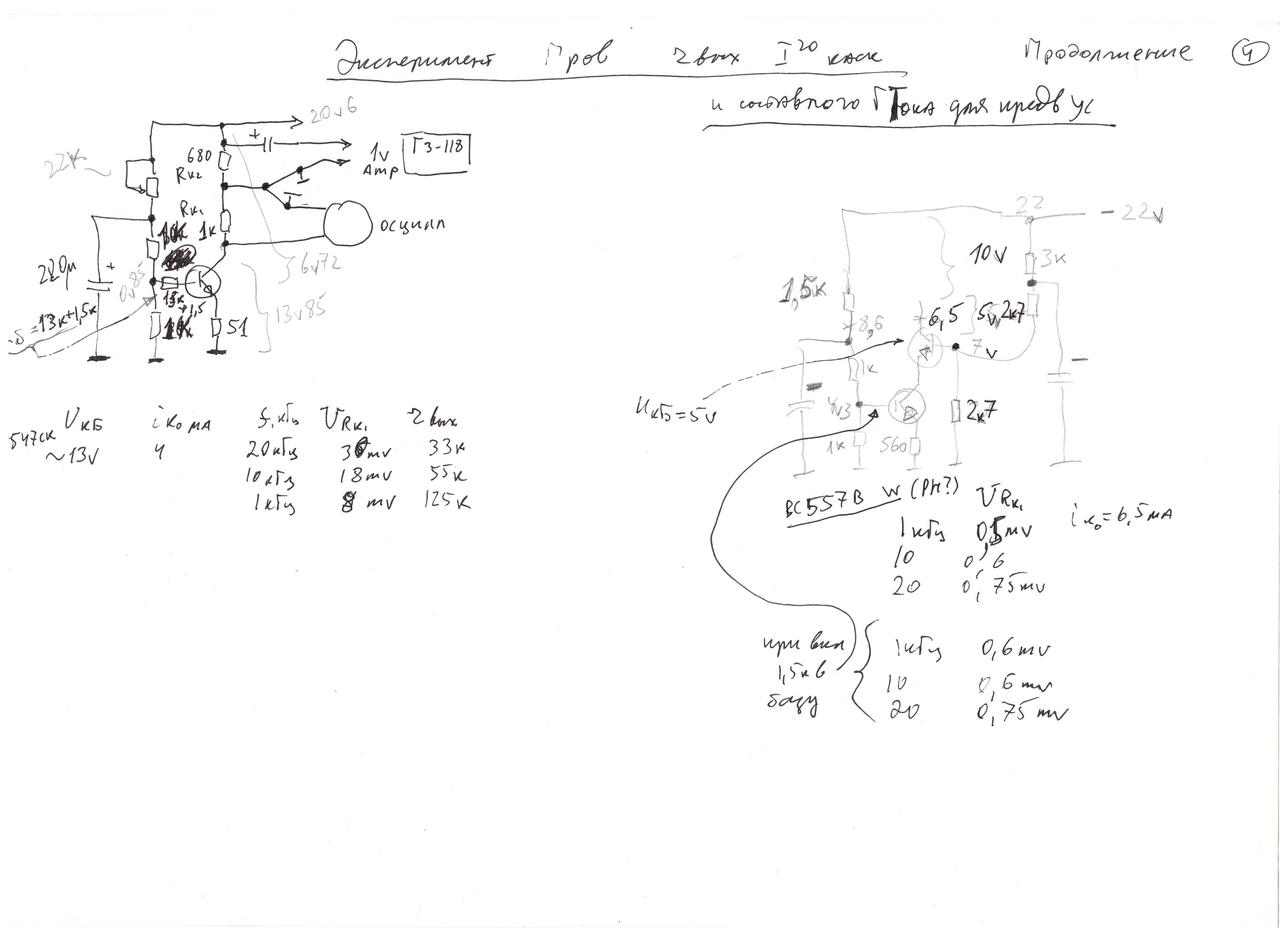

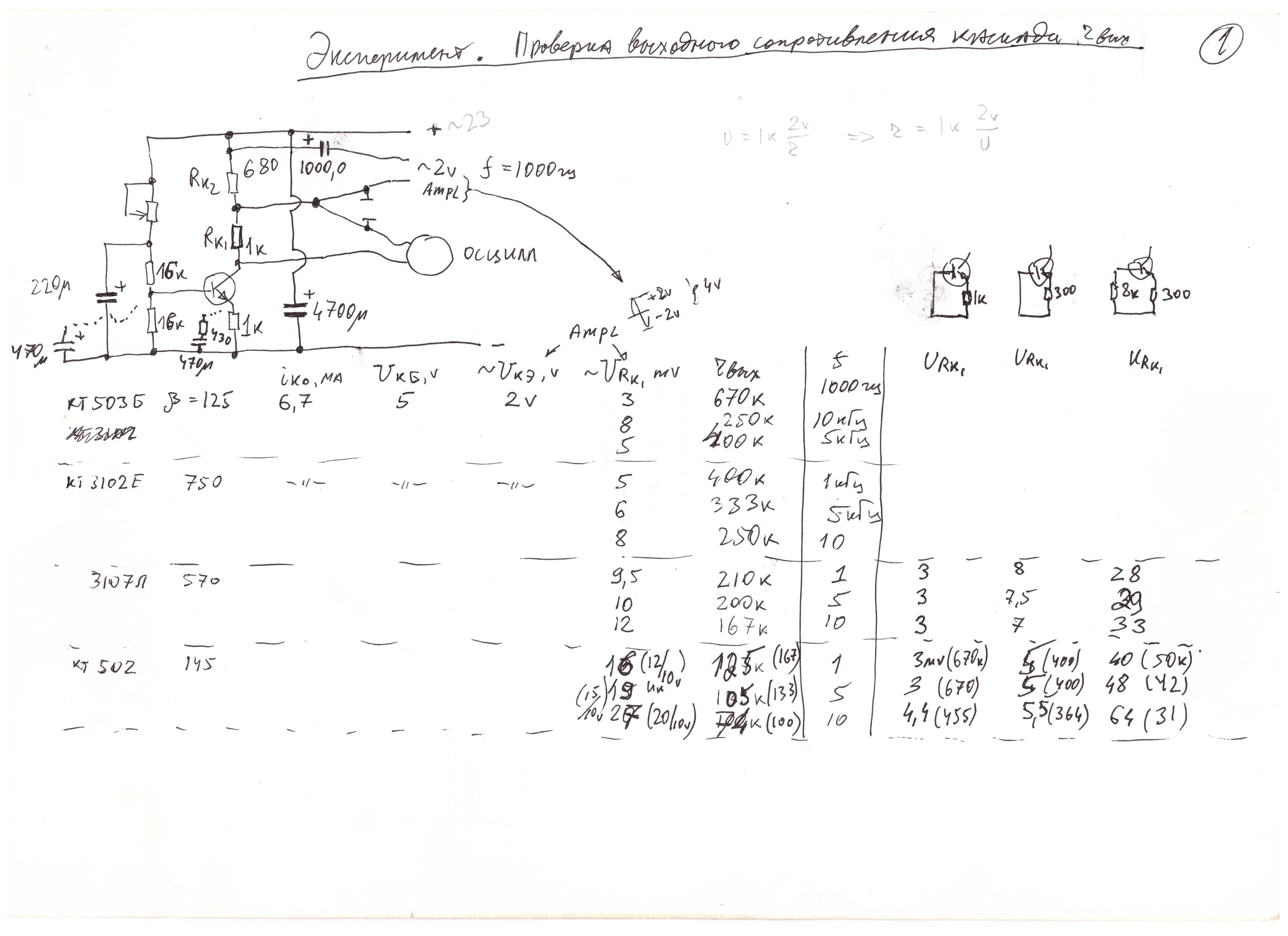

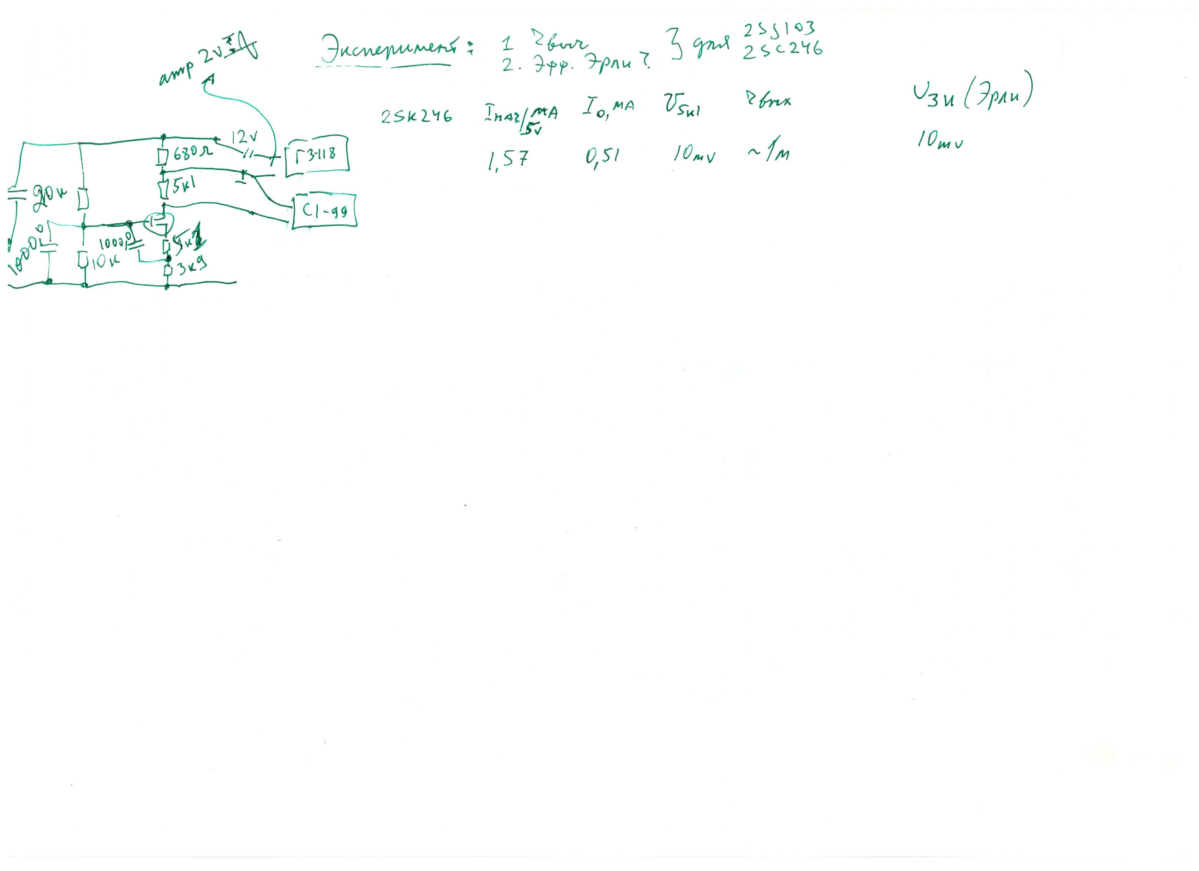

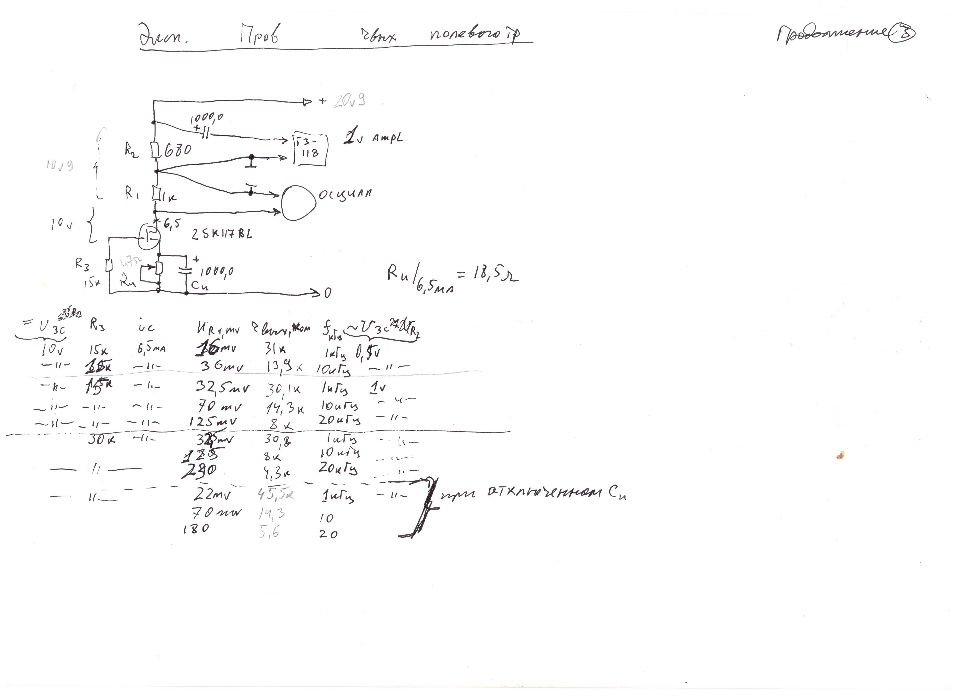

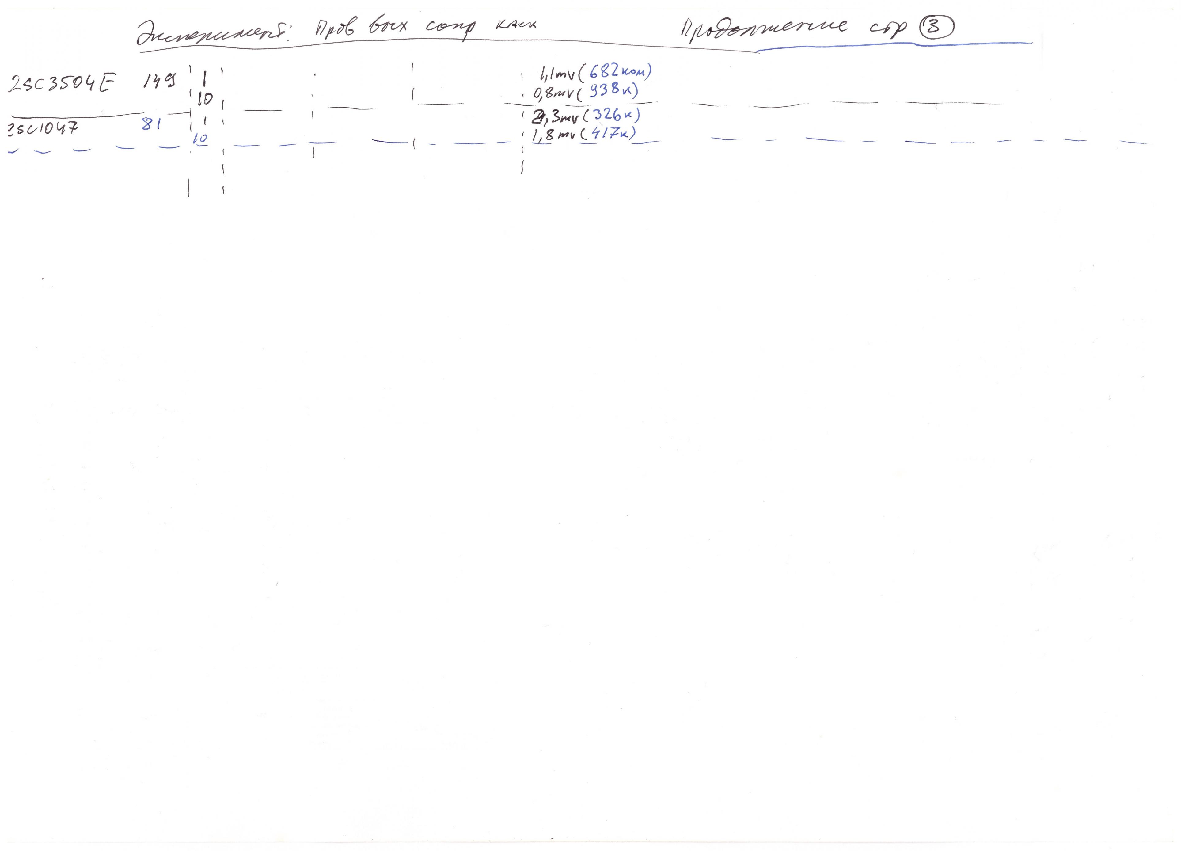

Hi Gasboss775!
Some time ago (enough to paper got yellow 🙂) I solved the same question and I'd like to share with results obtained (see please the application).
I measured the output resistance of the elementary stage with common emitter (the finding collector resistance of the transistor is approximately the product of the stage gain and that measured resistance). For these purpose in the collector circuit was introduced two resistors, the first (Rk2=680 om) - to provide the alternative collector voltage, the second (Rk1=1 kom) - to provide the measurement of the collector current deviation, caused by that voltage.
A lot of Soviet and World brand transistors were examined (even some FETs).
Instead of low frequency generator (Soviet G3-118 in my case) pulse measuring generator also can be used (no matter how to change the collector voltage).
The connection of ground terminals of measuring devices, as shown on the drafts, turned out good enough to provide tolerable noise level.
With respect, Igor Shukov
If you decide to get the HP Meter, get a HP laboratory power supply too.
(Have a look at the HP catalogs from 1980-1990).
The pulses aren't coming from the bench PS, as I've used a linear one ( that I built previously ) and the noise pulses are still present. Perhaps the pulses are present in the ac power line from other equipment in the house with switching power supplies. The pulses are not at a fixed frequency, which is puzzling.

Hi Gasboss775!
Some time ago (enough to paper got yellow 🙂) I solved the same question and I'd like to share with results obtained.....
Thank you very much Shukov for sharing your results. 🙂
You have given me fresh encouragement to carry on with this project! At the moment I am away on holiday / vacation though I intend to get back to the task when I return home. One question, what did you use to measure the voltage across the 1k resistor?
Gordon
