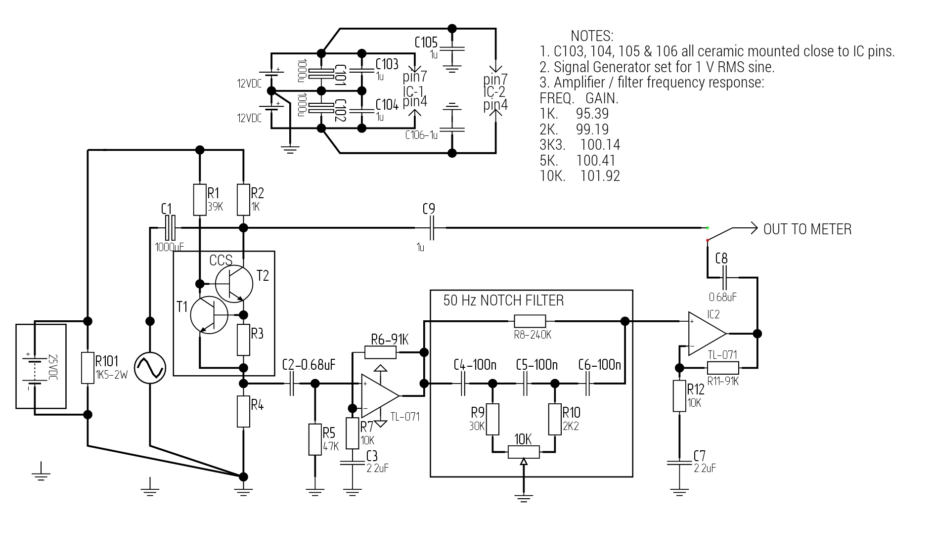

As suggested split the amplifier into 2 20db stages, new schematic attached.

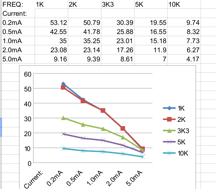

Results of 2 transistor CCS at different DC currents, see attached.
Would seem to confirm that current source impedance is inversely proportional to the DC current.
Gordon.

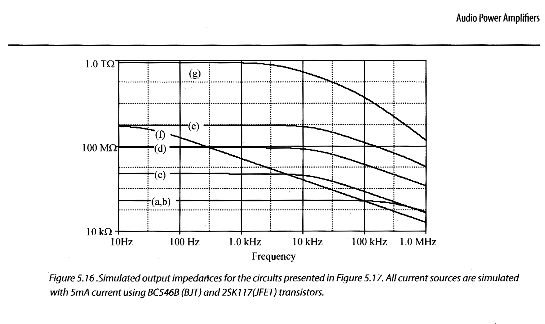

After you finish measuring impedance-vs-frequency for your 2-BJT current source circuit, you may decide you want to measure a few other circuit designs for current sources.
I've been reading the new book by Arto Kolinummi (LINK) and as luck would have it, he explores this very thing on pages 124-135.
The good news is, he presents several different circuit topologies that can serve as inspirations for your own design work. The possibly not so good news is, he extracts their output impedance from circuit simulations, rather than physical measurements of laboratory prototypes. Still, I imagine that the circuit which simulates "best" (highest output impedance) probably also measures "best" with physical devices, and the circuit which simulates "worst" probably also measures "worst". He appears to choose his SPICE simulation models very carefully.
For what it's worth, here is one of his figures. When each of the six current sources is delivering 5 milliamps, he finds two of them have Zout = 10^9 ohms (1000 Megohms), and another has Zout = 10^12 ohms (1 Teraohm, a million Megohms). In simulation.
{notice that the top curve has slope greater than 20dB/decade, suggesting two or more poles are present}

I don't think that simulation gives us new insight here. The models are not good enough. At output impedances > 10 MOhm a picofarad is important.
For example 1 pF at 10 KHz has 16 Mohm impedance.
It is not possible to build a current source with 1 TOhm at audio frequencies - forgett about the book.
For the last circuit i get 4.6 MOhm @ 1 kHz and 5 mA and 4.2 MOhm @ 10khz.
The output amplifier has an error of 13% at 1 kHz due to the 50 Hz notch filter by the way.
I measured the response of the amplifier / notch filter and substituted the measured gain into the formula for impedance. Yes I was surprised how much attenuation the notch filter yielded so far from its center frequency, is this a flaw of this particular type of notch filter ( Hall notch filter ) rather than the usual twin tee type?
Gordon.
P.S. Regarding simulation results: Do the transistor models not include parasitic capacitances, considering the suggested impedances from the simulation results it doesn't look like it. I only have a very basic simulator on my android tablet ( My PC is broken ) and I got pretty similar results to my experiment for a 500 microamp ccs, but for the 5mA ccs the result was considerably higher than in the experiment. Impedance falls with increasing test frequency so the transistor models must include capacitive elements, however transistor parameters that can be varied in the simulator are pretty limited and there is no provision to adjust capacitive parameters, strangely though it allows you to do that with diodes!
