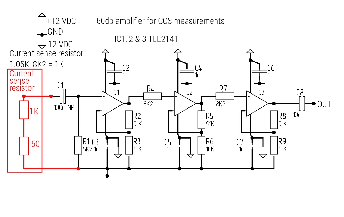

Managed to get a bit of spare time today. Built a three x 20db stages amplifier. Noise was reasonable except for 50Hz pickup. ( have been unable to implement Udo's notch filter as i only have 5% capacitors and my LCR meter has packed in, ruling out cherry picking from the 5% stock. ) I have an old biscuit tin and was thinking about putting the amplifier inside it to see if that helps with the 50Hz pickup.
The amplifier is all DC coupled except for the input ( as the CCS current sensing resistor will have a large DC component across it ) I was surprised to find that DC offset at the output was only 52mV and as I'll be coupling the meter via a capacitor. 52mV impact will have minimal impact on the dynamic range of the amplifier.
As for using the AD797 for the first stage, the manufacturer reckons it is not ideal for a 1K input source, there were other recommendations though ( Analog Devices parts of course! )

Any thoughts on using the TLE2141 as I think it's probably the best I have available for now?
Use the TL072 as it is now. It will work for your application. The TLE2141 will not improve things.
The critical opamp is the first for noise. Some good low noise op-amps are LME49990, AD797, LT1469 or NE5534.

What i want to add: it is more important to fix the problem with the 50 Hz crosstalk than to choose a better opamp.
I am very interested to hear if the cake-box helps against the crosstalk. A good reading is Henry Ott: Electromagnetic Compatibility
Engineering 2009 (you can find it online).
But beware: it is more fun to try things out and read the book later 🙂

Through trial and error I have eliminated most of the 50Hz, it was the result of the grounding arrangements. The metal box, connected to ground would probably still be a good idea. I have attached a schematic of the 3 stage amplifier. As you can see, no notch filter! I will get a better opamp for stage 1 next week probably. I've also been working on a precision rectifier, as I don't think my meter is accurate over 10Khz.
I will search for the book. I do have a book ( somewhere) that covers this type of stuff, also there is a good chapter in The Art of Electronics, Horowitz & Hill, 2nd edition
Thanks again for your input.

Can you make photos of your new circuit and show what you have changed?
I (and many others) are very interested to see what you have changed so that the problem does not occcur anymore.

My 3 x tle2141 amplifier has a tendency to burst into oscillation at around 1Mhz when the scope probe is connected to the output. Would a 10 ohm resistor at the output help with this?

Some more remarks:
- Use 100 Ohm instead of 10 at the output. 10 Ohm is very low.
- Lower the feedback network impedance by a factor of 10 - 20.
Too much stray capacitance and noise!
You can then omit the series R at the + input too => even less noise.
- You think too much about the opamp and too less about the circuit. NE5532 (NE5534) is a bargain.
- If you need to go differential use a real instrumentation amp (ina163 etc.).
They do not use the 3-opamp circuit internaly and have less noise and less stability problems.
- if you omit the coupling C, choose a opamp with low i_bias and low Vos.
- If you still have substantial 50 Hz on the output it does not matter what opamp you choose.... but the instrumentation amp may help to suppres 50 Hz noise.

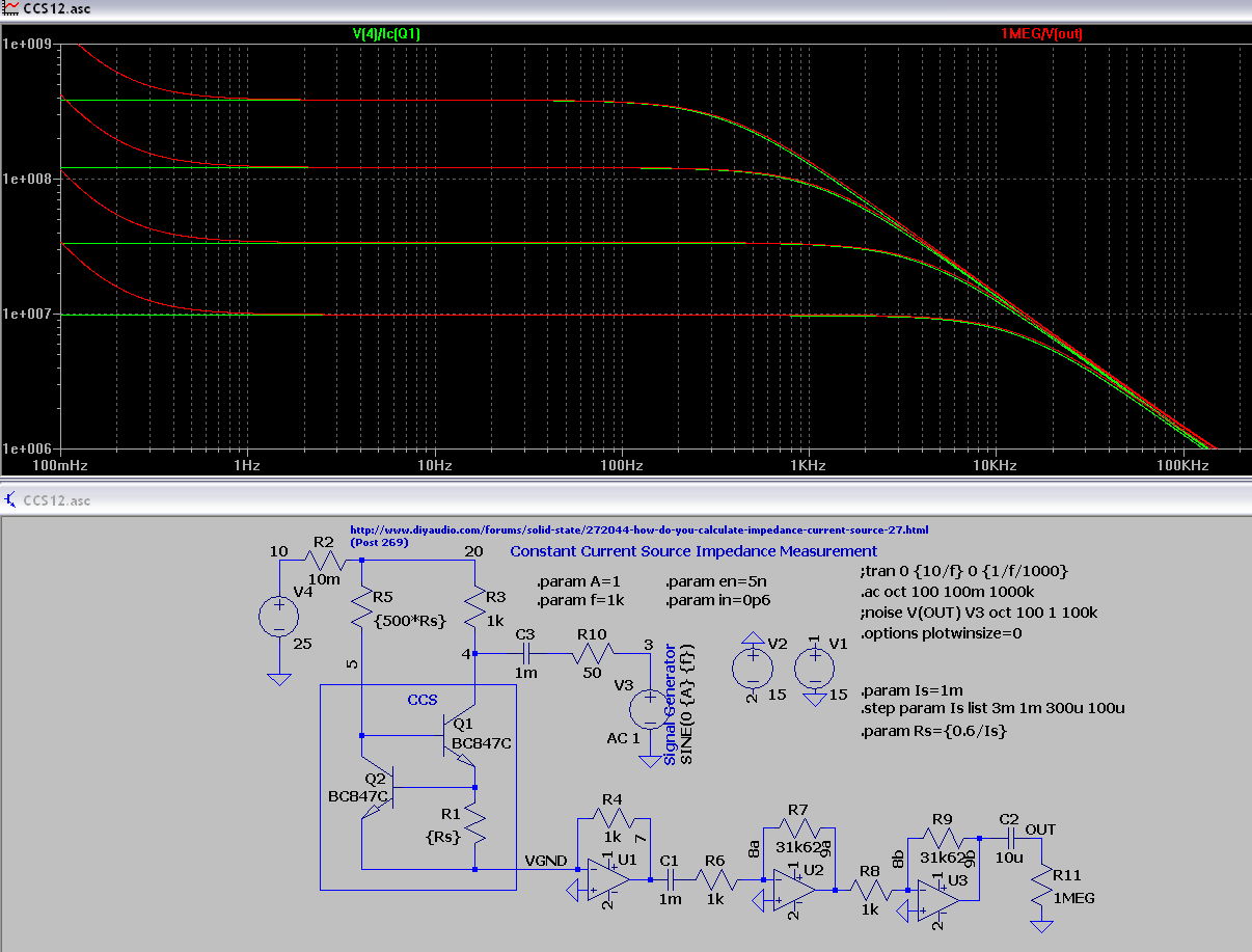

Attached a variation with inverting opamp configuration.
The CCS cold end is at virtual ground and noise is suprisingly somewhat better than the noninverting configuration.
Shown are the Impedance of the current source for 100uA,300uA,1mA and 3mA (calculated and "measured" at V(out)).
With the 5534/5532 noise is dominated by the current source, so there is no
need for further optimizations.
Someone else I know had suggested the trans impedance amplifier idea but I thought the DC component would be a problem, but making the first stage 1v per mA allows for an acceptable level of DC offset at the output of stage 1.
It occurred to me too that some noise was coming from the current source itself as the output noise was higher when amplifying the CCS signal rather than just the signal generator via an attenuator. Perhaps this is another current source characteristic worth exploring, given that the target is to find CCS' suitable for audio.

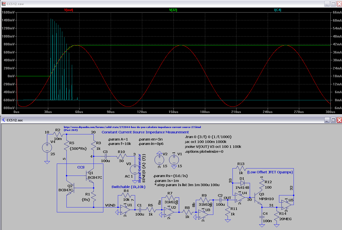

A version with a peak detector added. This should help with measuring
at higher precision above 1kHz.
By making R4 switchable (1k or 10k) you can improve accuracy for low current measurments.
If I used 2 x TL-071, i could correct offset if this is a problem. Is the choice of transistor crucial? I seen a circuit like this that used a jfet junction as the rectifier.
Gordon.
The TL-071 is on the "bad" end - but you can compensate for the offset. Better to use a OPA827 or similar.
The transistor should be a fast one with low capacitance. BC857 does not work very well here.
But it all depends on your requirements regarding precision...
