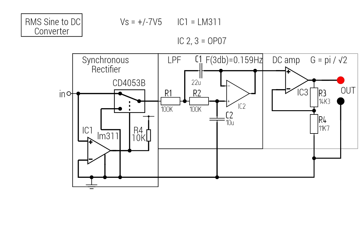

I've come up with another idea for a rectifier that can be built with parts I have lying about. I haven't tried it yet, but I seen something similar before and it was capable of wide bandwidth. What concerns me is control signal breakthrough in the analog switch upsetting the measurements.
See attached:
I realize the CD4053B is not the best analog switch IC but at the moment I can't buy any new parts. ( We spent a small fortune getting the kids new clothes for school, which started this week! )
Gordon.

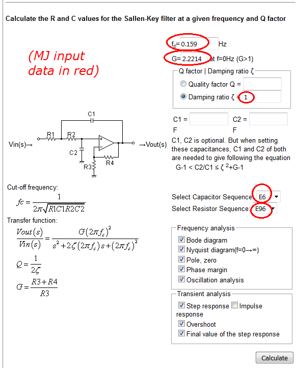

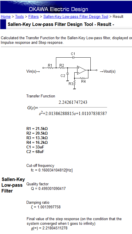

Maybe you didn't realize that you can build Sallen-Key filters with any DC gain (greater than one) that you desire. Here's one whose DC gain is PI/SQRT(2), coughed up by a free LPF calculator webpage on the internet.
The DC gain appears in the output data, twice. First it is the ratio of the constant term in the numerator, divided by the constant term in the denominator:
  • DC gain = 2.242617 / 1.011078 = 2.218045
Second, it is the final value of the step response, g(infinity)
In both cases, the DC gain pops out to be exactly the number you wanted. With one fewer opamp.

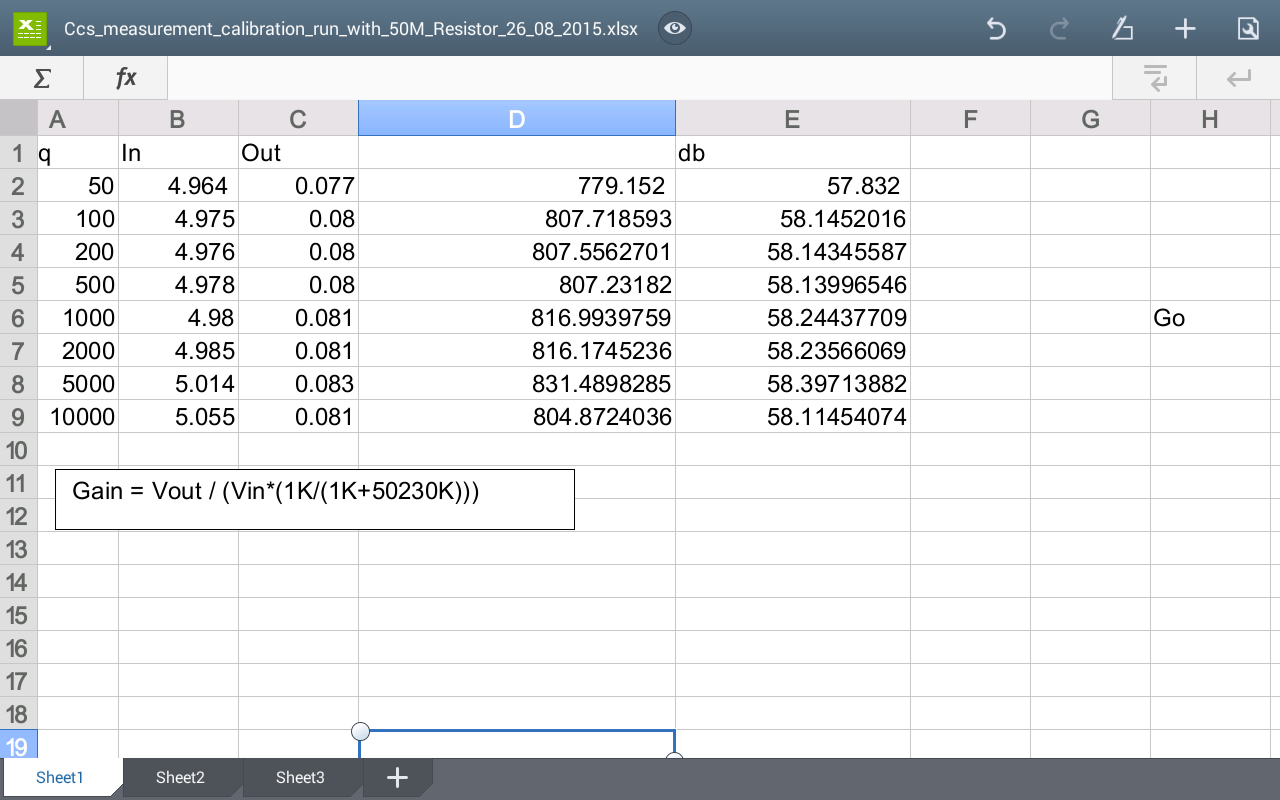

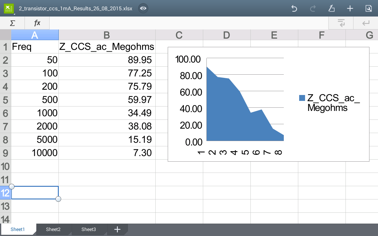

OFirst results from new setup:
CCS supply = 30 Vdc
Vccs(DC) = 27.5 Vdc
I_ccs_(DC) = 1.0mA
Results attached.

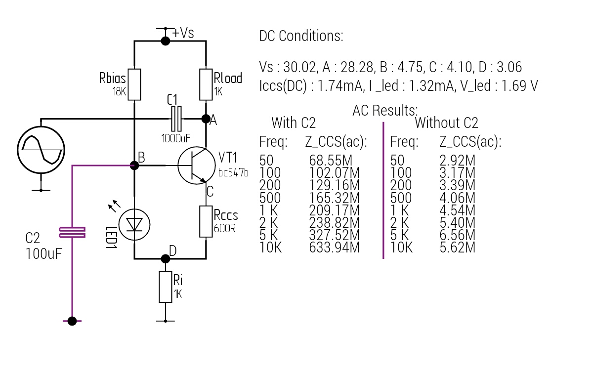

I have made some more measurements with a 1 transistor and LED ccs and got some unexpected results.
Will post these as soon as I have compiled the data.

The results for the 1 transistor and led based current source are unexpected, as you will see. I have rechecked everything several times yet the results are the same.
I'm not sure if this circuit is exposing a flaw in the measurement setup.
The led is a low current (2mA) red led. The transistor is the same bc547b used in the 2 transistor circuit.
Can someone run a simulation of this to see is these results are in any way credible.
See attached:
This looks very fishy:
might be that you have a transistor having a minimal Early effect, and that the topology in itself is exceptional, but the increase of impedance with frequency is definitely unrealistic: I see no mechanism capable of that, except an insufficient value of a bypassing cap, like C2, but this is certainly not the case here.
Talking of C2, why do you connect it that way, instead of simply bypassing the LED?
Maybe it's OK, but I wouldn't count this as certain without going into the maths of the circuit.
The way the whole setup is arranged looks questionable too, unless it is proven otherwise: what you measure is certainly not the impedance of the CCS: it is something else, because of Ri and Rbias. It might be that they are approximately the same thing, but this would need to be demonstrated. I cannot decide instinctively one way or the other, but it makes me uncomfortable and I would feel the need to dig somewhat deeper to make an informed decision
Basically, anything that departs from the root measurement of the impedance is potentially suspicious, especially at this level of accuracy.
Apply Kirchhoff's current law: The current through the 1k resistor is equal to the
collector current if the current through Rbias and through C2 is zero.
Rbias should be 100k for less than 1% error and C2 should be small (or connected to the
emitter).
The -3 dB frequecy is too low for the 2-transistor CCS. Simulation gives 2MOhm for the 1-transistor CCS (-3dB @ 100kHz).
emitter).
I didn't think there would be a problem with the current in the led branch as it's DC, and the DC component is blocked in the amplifier or are you concerned with ac coupling from the power rail? Perhaps Rbias could be replaced with a jfet?
I thought the -3db point was too low also, I'm not sure what has gone wrong here. The results for the 1 transistor CCS are most odd.
Elvee, do you think measuring impedance with a current sensing resistor in the ground leg of the CCS is inherently flawed? Should the measurement be taken in the collector path?
There is AC current in the LED branch because point D
is modulated by the collector AC current and
point +VS is modulated too due to finite power supply impedance.
This error is small if Rbias is larger than 100x Ri and C2 is connected to D.
if you keep the AC current in Rbias << Ic then there is no problem with measuring
the current at Ri (apply Kirchhoff current law).
