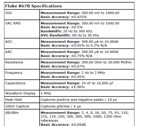

My Fluke 867B 300Khz bandwidth DMM says that it can measure resistance 0.07% accuracy! not 0.005%. Udok is right in saying that the measuring DMM also should have AC bandwidth to measure current across in the current topic. 31/2 digit DMM's do not have the AC bandwidth. They are meant to measure 50/60 Hz AC measurements mostly

Here is the spec
My Fluke 867B 300Khz bandwidth DMM says that it can measure resistance 0.07% accuracy! not 0.005%...................
did you read this sentence?
