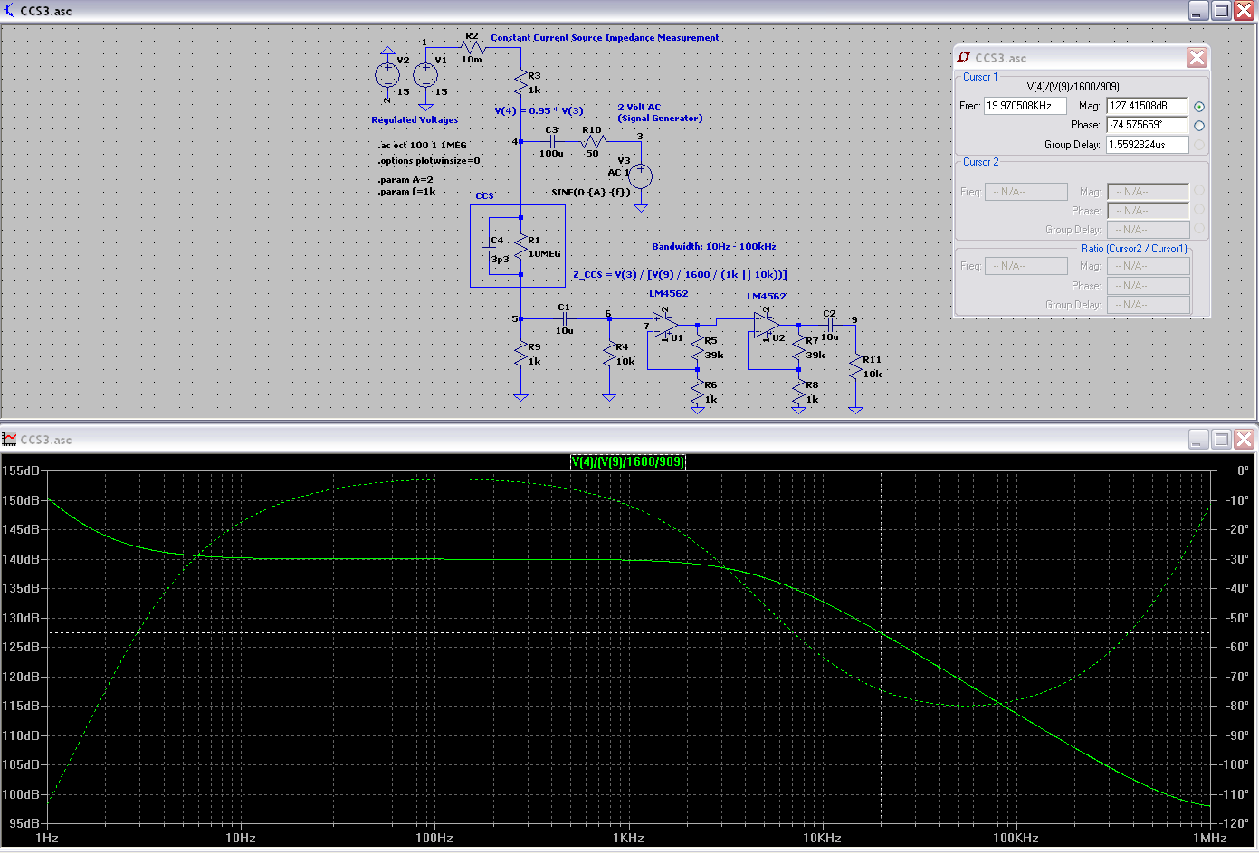

Build the attached Circuit. It will help you to verify your test setup.
I have plotted the frequency response of the CCS impedance.
If your measurement setup is ok, the result should be the identical +-5%.
I have no clue where the 0.4 Hz comes from...

EDIT: in the formula for Z_CCS: replace V(3) with [V(3) * 1000/1050]

LM833 is ok. LM4562 has more bandwidth. Both are good up to 20k.
Measure the impedance at a few frequencies (200Hz, 2k 20k) and see if you can
calculate the CCS impedance correctly.
Maybe a shielded housing (cookie box) helps with the hum/noise problem.

This morning I built the circuit suggested by Udo, though using an ne5534 for the first opamp and a tl071 for the second. After a bit of time wasted tracing a couple of stupid mistakes I'd made with the construction, I was able to determine some useful results. As the measurements taken were not done in exactly the same way, its not possible to make a direct comparison between this method and my last method.
It is apparent though that today's results show relatively higher impedances in the same 2 transistor CCS than in my last method but closer to my first set of results.
Experiment conditions: Vs = +/- 15 volts, I/p signal 2.0 volts RMS. Note that the bottom end of R5 was returned to the -15 volt rail to ensure maximum DC voltage across the CCS under test, CCS DC current = 5.3mA.

Could you verify the measurement setup with the 10 MOhm || 3p3 test?
Udo
Yes I will try this.
I have attached a schematic of the setup, including an RC power supply filter and another couple of minor variations.

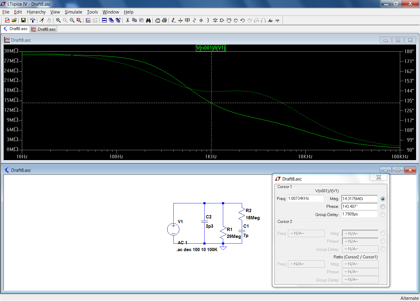

I made the test; I first checked the calibration with 1Meg and 10Meg resistors, and it was within a few % (resistors are 5% tol.)
Code:
[U]Freq. (Hz)[/U]   [U] Z (MΩ)[/U]
   100         28.5
   330         16.6
   1K          14.2
   3.3K        11.7
   10K         6.25
   20K         3.3
measured at 1Vrms, 20V across the CCS, current 5.0mA (resistors of 39K and 120Ω), transistors are BC 547B Motorola made 16th w. of 1994
The resistive part of the impedance must be around ~30MΩ, and the capacitive component kicks in at ~1KHz and dominates completely above ~5KHz: the ratio of 10 to 20KHz is almost exactly 0.5
