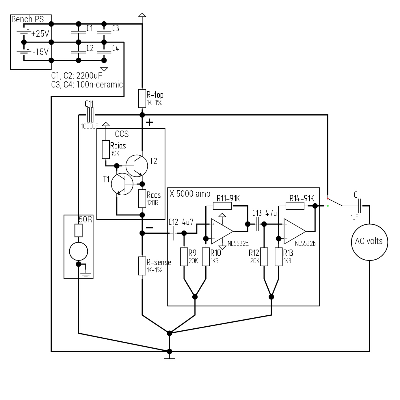

How do you calculate impedance of a current source?
I did a DC check using a pair of bc182b (hFE ~270)
@ ~20V to ~30V across the CCS I found ~ 900k effective resistance/impedance.
But it did not change instantly as the new load was applied. It drifted pretty slowly to the new value of Iccs. and drifted slowly back to the previous Iccs when the load reverted.
Thinking this was a temperature effect in the upper transistor, I added a cascode with the voltage between the two set with a green LED.
Now the change in voltage is seen by the cascode and the CCS transistor sees a nearly constant Vce.
Now the effective resistance (measured ~400k) drifted from old value to new value just as slowly, but more consistently. The cascode appeared to have lowered the impedance and did not remove, nor attenuate the supposed temperature effect.

Another very frustrating day trying to refine my setup to minimize the issues identified in post #200. First tried using 7812 & 7912 voltage regulators in an attempt to clean up the output of the bench PS, they actually made matters a lot worse, putting out around 800uV peak to peak broadband noise! Perhaps lm317 / 337 would be better? Or perhaps a capacitance multiplier.
Have resolved the DC offset problem by 1. Changing the capacitor that couples the CCS sense resistor to the amplifier to a tantalum cap instead of an electrolytic. 2. By AC coupling the 2 amplification stages.
The noise and interference pickup from the -ve rail has been improved by returning the CCS sense resistor to ground, however this requires a slightly odd power supply arrangement, namely +25 / -15 volts as the ne5532 cannot take more than 44 volts. My intention had been to supply the CCS from a + 30 v rail and the amplifier with +/- 12 or +/- 15 volts with local voltage regulators, but the noise output of these has pushed me to scrap that idea.
Using just the original RC power supply filters and returning the sense resistor to ground has made a considerable improvement as well as more vigilance over layout, such as putting the amplifier physically close to the CCS sense resistor and keeping the path of the stimulus from the signal generator away from the amplifier input. I think now there may be light at the end of the tunnel!

Yes indeed, though in the end I've learned a lot in a very short space of time. I have what I think is a setup free of any of the aforementioned obstacles to getting accurate results. The biggest issue by far was that the signal generator and the oscilloscope are both connected internally to mains earth ( ground )
By a process of elimination I've got interference at the amplifier input down to a level that it is beneath the noise floor of the amplifier.
See attached schematic.

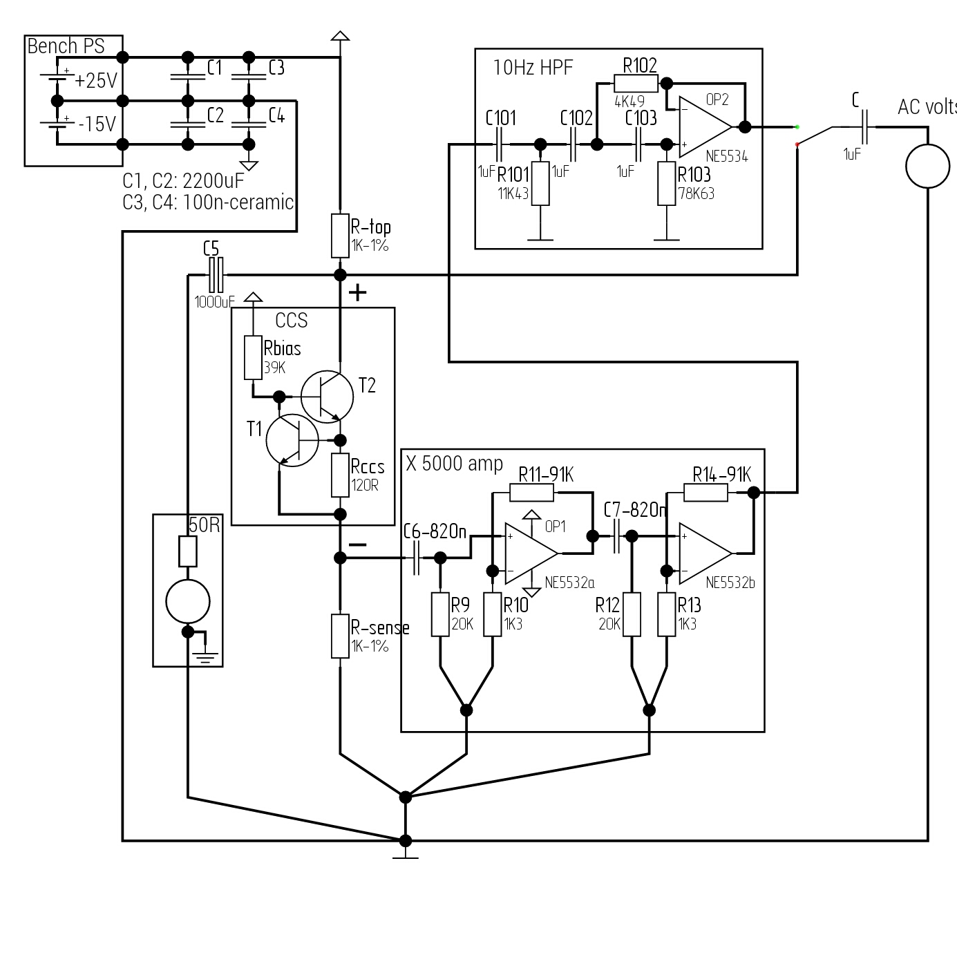

I have continued to refine my setup, it's now able to measure 10's of megohms without much difficulty. Continue to have a problem with a VLF signal superimposed on the CCS current ( the same 2 transistor 5mA CCS ) I have no idea why this is happening, but it is definitely originating in the CCS.
I have decreased the value of the coupling capacitors to reduce the gain of the amplifier at the approx 0.4Hz frequency of the problem signal. I think I'm going to have to build an additional active high pass filter with f(3db) around 10 Hz.
Elvee, did you find any evidence of this 0.4Hz signal from the same 2 transistor CCS?
Is there any chance it could be oscillating at this frequency? I know that this type of CCS can oscillate, but usually at much higher frequencies.
I have also measured the gain of the amplifier and it is within +/-0.1dB from 50 to 50 000 Hz.
Gordon.

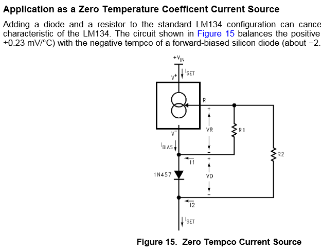

I also suggest you replace Rbias in the CCS subcircuit, with the four component "zero TC current source" circuit found in the LM334 datasheet and shown below. LM334 is rated for currents between 2uA to 5mA; luckily your ~500uA current thru Rbias is right in the LM334 sweet spot.
Or if you are reluctant to replace 1 resistor with 4 components, perhaps you would feel better about replacing 1 resistor with 3 components. Split Rbias into two series resistors, 20K each, and connect a 330uF bypass capacitor between the middle node of the 20K resistors, and the bottom leg of R-sense (at the intermediate star-ground).
Nothing of the kind, it seemed completely steady
No, only thermal oscillations are possible for these frequencies;
Another possibility is a beat between hum frequency and your test frequency: 50Hz and 500.4Hz for example (or the sampling frequency of your DVM)

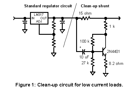

Returning to the theme of noisey voltage regulators, I found an interesting addendum to clean up noisey regulator output. See attached.
The concept could work, but not in the conditions shown: with these resistors values, that is just ordinary audiophoolery. At best, without higher order effects and neglecting the 1K(!) resistor, it could reduce the noise by a 15/8.2 factor, but in reality it will be even lower. To properly assess all the factors, it should be simmed, but do not expect too much, even if it is optimized. The transconductance of the transistor will be one of the limiting factors
It seems doubtful though as it persists over a wide range of test frequencies. Also it has been observed on 3 different DVM's and an oscilloscope. Can you suggest any other solution than the high pass filter?
The 1K resistor seemed ludicrous to me too. He shows a better circuit further down the page if you follow the link with an lm833 and a transistor. This guy makes his living as far as I know, designing and selling ultra low noise rf amplifiers and oscillators.

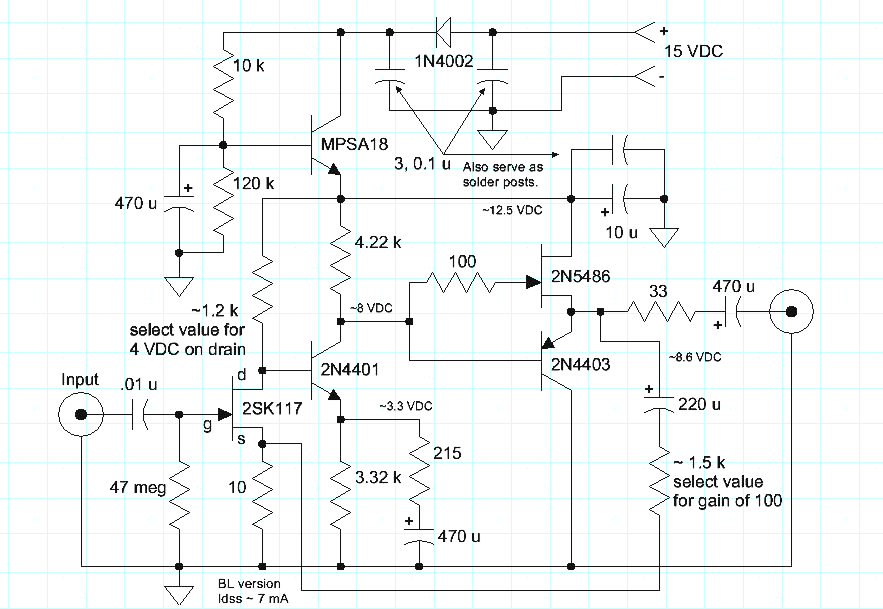

EDIT: I have attached a 40dB very low noise ( < 1nV/√Hz ) amplifier that he designed.

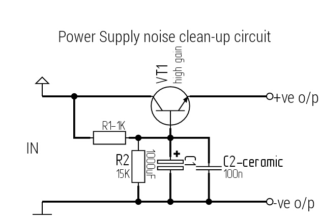

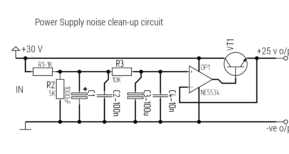

It's too late now to edit post #217, so I'll go ahead and contradict myself. Even though I said I was taking a day off from electronics, I couldn't help thinking about the attached circuit. It is intended to clean up noise from the bench PS. I'm worried though that it would increase the supplies output impedance. I think the circuits output Z is (C1||C2||R1||R2) / hFE+1, do you think that this would be higher than the direct output of the bench PSU?
Gordon.

John Walton, a prolific member of diyAudio, published an informative article in Linear Audio magazine. The editor has put several of John's color figures online for free download, including (Figure 8: Output Impedance vs Frequency for several positive voltage regulators)
As you can see, his measured result for the LM317 is 2.5E-2 ohms (25 milliohms) between 10Hz and 500Hz. Other voltage regulators were considerably better; they had considerably lower output impedance.
You can compare 25 milliohms @ 100Hz, against the output impedance of your capacitance multiplier circuit. (link 1) , (link 2) , (link 3) , (link 4) . Don't forget the (1/gm) contribution to emitter follower Zout!
Mark thanks for your detailed reply.
Yes I forgot about the 1/gm contribution, that brings us back to your idea of load resistors to increase the value of gm and hence lower output impedance, is that right?
I tried using a 7812 to improve the source impedance and hopefully to reduce noise, it failed teribley on the latter count, output noise was 800uV peak to peak, don't think the lm317 is much better in this respect. I was thinking about maybe augmenting the capacitance multiplier with a low noise opamp, see attached.
I forgot to include the output load resistor.
