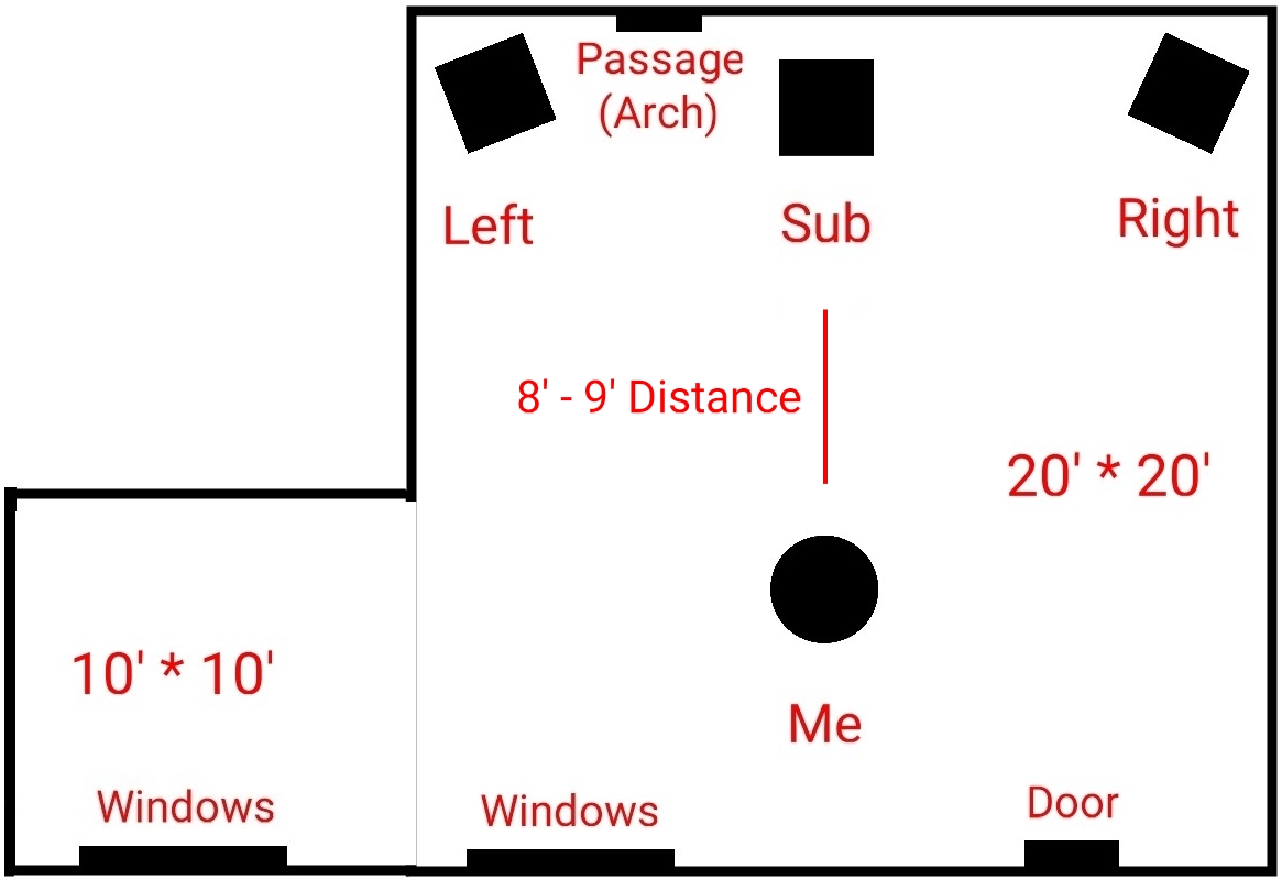

No mate, I'm gonna make a wholly new setup, okay, I'll tell you everything in detail, attached here is the living room under-construction, concrete floor and will be tiled, roof height is 10 feet, no ceiling yet, so 20*20*10=4000 cubic feet, a big room, bit complicated of a setup, most importantly there are no home audio professionals to hire in our country, we make all decisions by ourselves (which is very difficult since we aren't that knowledgeable), easiest is visiting a home audio showroom, buying a 1000W 5.1 (all-in-one including amp/receiver) for just 100 bucks, I know you won't be surprised, I'm not that silly, I'll make a custom or quit, that's why I'm here (and following many other forums as well)...OK, what's used in your stereo or what's available if planning one?

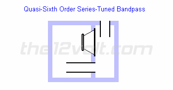

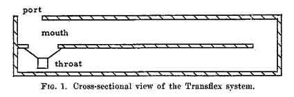

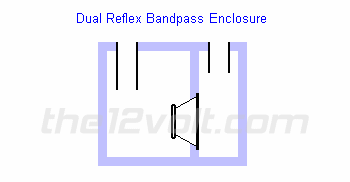

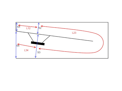

What??? Are TH and BP6 the same??? I'm feeling dizzy!!! 😀
TH = BP6S or SBP6 = series tuned BP6 (pic 1).
PBP6 or BP6P = parallel tuned BP6 (pic 2).

Well, since the "sub-bass" is generally between 20-60hz my plan is limiting the subwoofer to a narrow bandwidth so that it can optimally perform in that particular region, and looking for a design best within that 40hz range.True, but with such a low tuning combined with narrow BW it's moot due to our very poor hearing acuity [~65 dB down referenced to ~250 Hz where our hearing is getting pretty good], so the room completely dominates, hence where you want to concentrate damping since it's room Q that matters down low: Interactive Ear Sensitivity Chart - Independent Recording Network

I know 6BPs would be the best as they're intrinsically short-band performers, but while agreeing to your "human ear sensitivity" statement, most audiophiles claim they can be "one-note wonders" and transients in them are mostly "suffering" (unless it's a QWP-turned P6BP like you suggested).

I know BP6S, but nick-naming it a TH might be misleading since TH is kind of a horn-loading and horn-loading mainly has 4 neck shapes as parabolic/conical/exponential/hyperbolic but this BP6S as illustrated has none of those, and even if you're referring to the uncommon 5th shape called "stepped" both resonators shown here are similar-sized in breadth, what am I missing...? 😕TH = BP6S or SBP6 = series tuned BP6 (pic 1).
a TH [parallel BP6]
Haste makes waste! 🙁 Per BP1: TH = a morphed series BP6 [SBP6] everywhere I posted 'parallel'.

Correction: Your parallel BP6 = TH or T-TQWT = series [SBP6].
Yes in that the accepted most technically correct nomenclature is TQWT regardless of taper.
Well, if you listen to any true subwoofer with XO it will sound 'one note' regardless of box alignment and as Dr. Geddes noted it's the excited room modes that will determine how much 'one note' it is, so it's the proper integration with the mains that will determine how high an SQ it has as part of a full range system, which sadly is often a pretty poor one when a narrow BW sub system is used.
And if you can't accept this, then as he recommended, best overall to go sealed and use at least three to get sufficient power handling, good integration with the room and in any case, damp the room as much as practical; which yours being two rooms divisible by even integers it will 'ring like a ten penny nail struck with a ball-peen hammer', plus big enough for LF fundamentals to dominate the sub/woofer/lower mids BW all the way down to a ~1128/2/30 = ~19 Hz [notch/'suckout'], so don't envy you the amount of work ahead of you if you DIY with little/no help.
Re [multi] sub placement: http://www.wghwoodworking.com/audio/multsubs.pdf

I can (undeniably) accept it, low-passing @ 80hz (or even 100hz) isn't problematic for me, but won't that be more struggling for a ~ 20hz subwoofer to perform that far up (the only thing I'm worrying about)...?Well, if you listen to any true subwoofer with XO it will sound 'one note' regardless of box alignment and as Dr. Geddes noted it's the excited room modes that will determine how much 'one note' it is, so it's the proper integration with the mains that will determine how high an SQ it has as part of a full range system, which sadly is often a pretty poor one when a narrow BW sub system is used.
I studied a lot about the sealed (not literally "acoustic suspension") enclosure which claims to have the perfect SQ in many aspects, but to achieve that ~ 20hz I'm looking for at a desirable SPL level, as you stated, my 4000 cubes (out of 5000 cubes) big square room would require four 18"s at least, so would be too costly (besides amp/speaker/wire commitment seems to be impractical cos I have to do all that by myself).
Just by a quick browse-through that PDF (thanks for posting!), I gotta know the optimal placement would be (though still room-dependant and me having an L-shaped room) two/four placing mid-wall, but that research done on sealed enclosures right?

Its because of the use of the TH function in HR. ANY enclosure modeled with that function is a BP6S.
The principles stay the same with new Paraflex function in HR. It's still a BP6S.

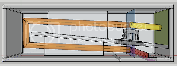

A Paraflex is a stepped TH that moves the mouth to the opposite end of a TH enclosure no matter if it's a single, double, or multiple fold enclosure. Just like a TH, a Paraflex can have a positive, straight, or negative flare.
Positive = SPL and big enclosure.
Straight = Easy build since the cross section area stays the same throughout the whole TH or Paraflex path. It's less efficient than a positive flare but more efficient than a negative flare.
Negative = low F3 and small enclosure.

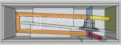

The first 3 pics are the 3 different flared TH's.
Move the mouth or exit to the opposite end of the enclosure and you have pic 4, Paraflexes.

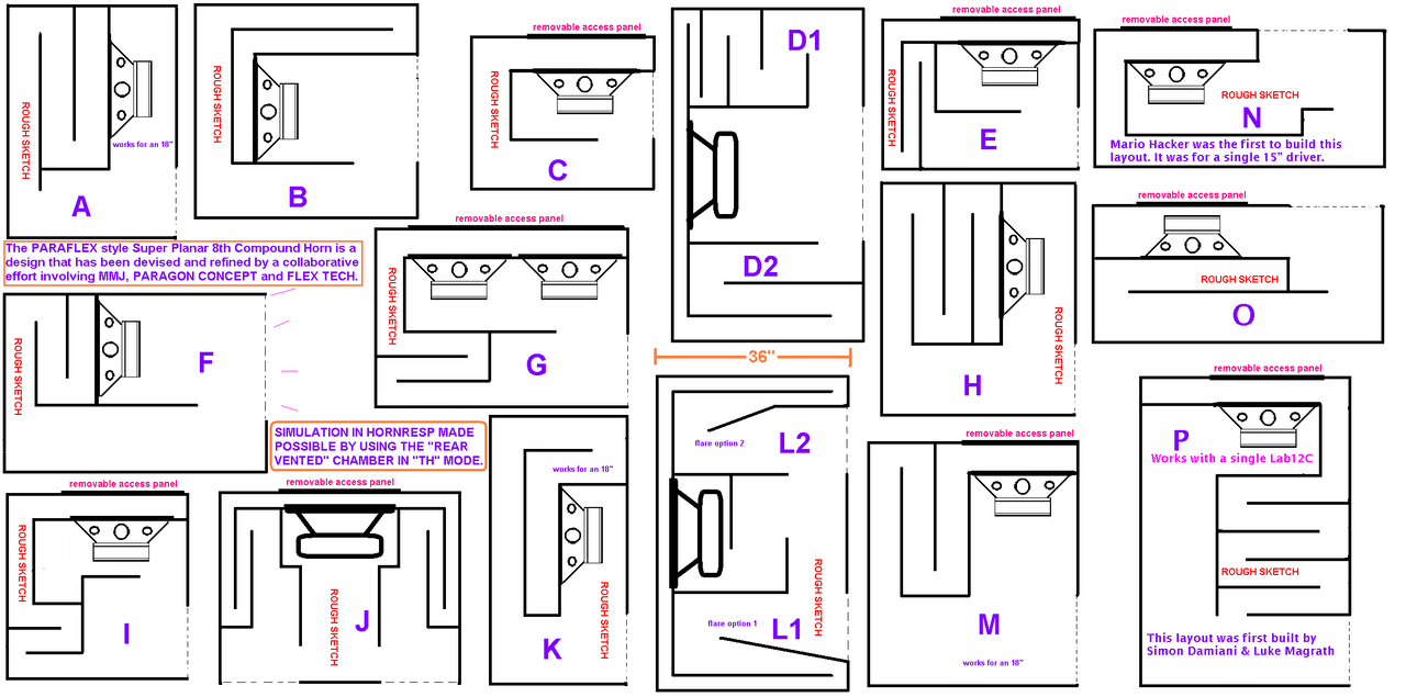

When you split the pAraflex up as 80 cm in a 240 cm pipe 3 times and an
80 cm pipe off the polar opposite side output;(compound pipe). You can see how pressure phase in each of the 80 cm chunks is ‘90 degrees’ phase at the Fb pipe and 1/3 Fb ( in qw) pipe from 0 or meet at 160 as 180/-180 degrees(delay is weird in TH)... So Then 360 degrees at imaginery 320 cm combined pipe which can be observed as 160 cm(the fullcrum point between pipes and opportunity to fold as well as a csa change, etc. And thus 360(720) degrees all the way out from the full wave shape pressure node/antinode of 960cm. Or, the reality of 160 cm as the center frequency between pipes and 60’degrees in the location in an imaginery halfwave pressure phase sum so to speak? But using 0.5,1.0,1.5,1....2.0 pi is a lot better visual IMhO.
A horn doesnt do this, it cant. Only a pipe. Or a proper pipe step expansion used as described? the same 80 cm is seen if a person must use a 40 cm offset to place a second driver in the long frequency pipe. And also 120cm becomes viable to use in many ways in the long pipe. It too shuffles around the pressure phase between the pipes and their imaginery middle/fulcrum/node/antinode of harmonic shared.
A ‘perfect’ paraflex is in that or a similar use of the stepped pipe expansion. You cant have a negative flare or even a flare rate if you want perfect? It seems this is mother nature waving hello from the pipe maybe. See what you think?
